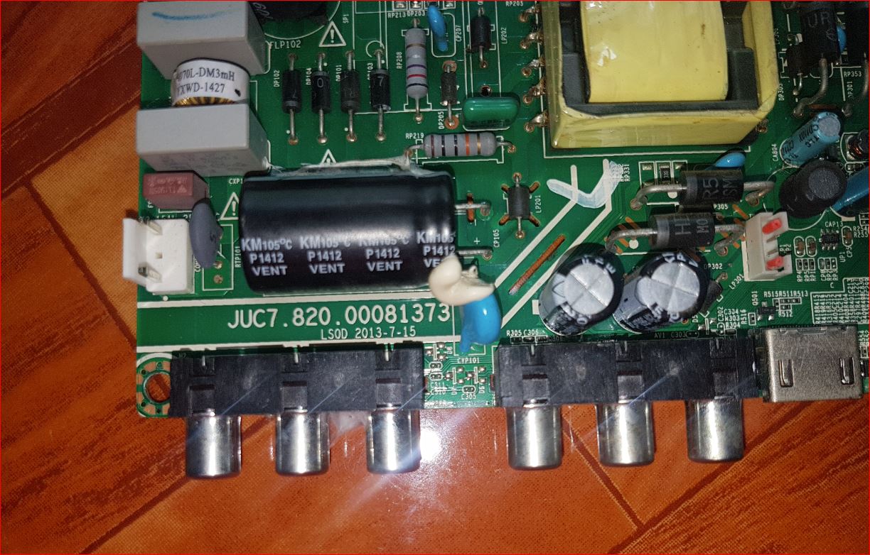

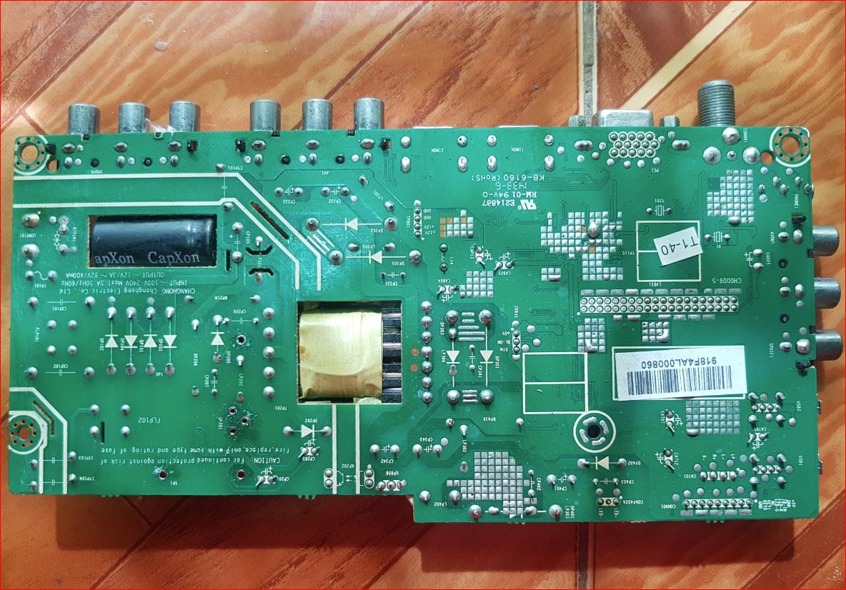

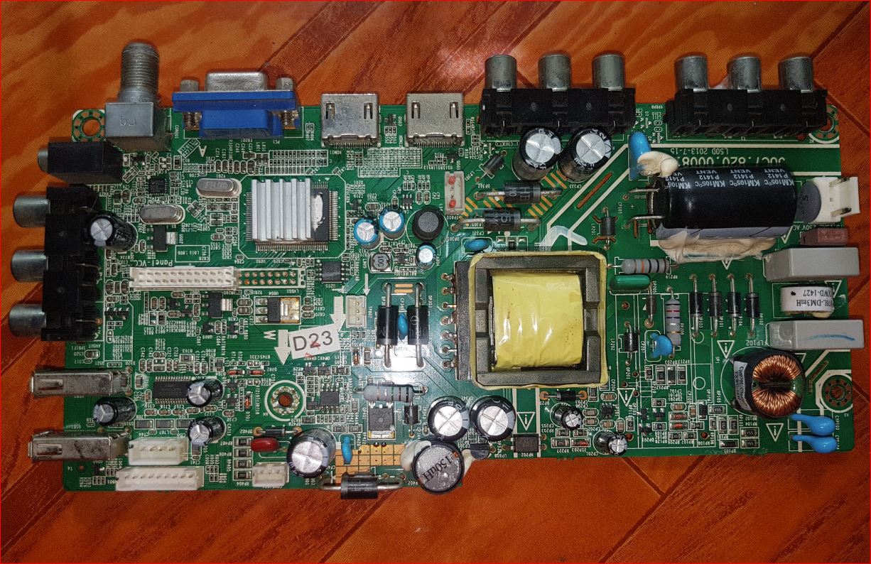

    Hi Guys,
    I need schematic for CHANGHONG LED32C2000 Board No. JUC7.820.00081373 with no power.
    I googled a lot for the fast few days but unfortunately no luck on that particular board. Thanks in advance.

    You will get more help if you upload good clear pictures of the whole top and bottom side of the board.

      Re: Help, schematic for CHANGHONG LED32C2000 Board No. JUC7.820.00081373
      Photo attachments, thanks
            Apply the AC power source to just the board then cjeck the DC V between the two legs pf the main filter cap (big black cap laying on its side) in the hot deadly side of the circuit, do not touch anything in the hot side with your hands, to see what DC V you have on that cap.
            BTW, you did check the main AC fuse, red rectangular shape, correct?

              Dear my2k2,
              I need your help to identify the up1 part, because it has burned out.. Could you help me?
                Dear my2k2,
                yes i have this board and if its not turn on standby light check its cpu voltages if present then heat cpu
