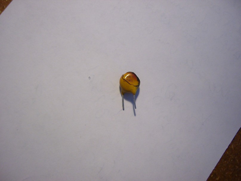

the tv hes a very much blown up cap on the power supply board 3138 103 6282.1 in position 3069. what was left of it was labelled only TVR 07561. can anyone help me with replacement values? thanks - i've fixed several led monitors with help from here but this is my first tv. BTW all other caps etc still look good

Not a cap. An MOV for surge protection.
Datasheet (page 4) :
Digikey only has this one in stock.
http://search.digikey.com/scripts/Dk...&name=F3446-ND
It's "close enough" but not a direct fit. The disc is also 20mm in diameter.

I knew I saw TVR somewhere before that's because it's a series here is the datasheet:
https://cdn.badcaps-static.com/pdfs/...bfffdf4a67.pdf
In the PDF Search
07561
There are the specs.Elements of the past and the future combining to make something not quite as good as either.Comment
