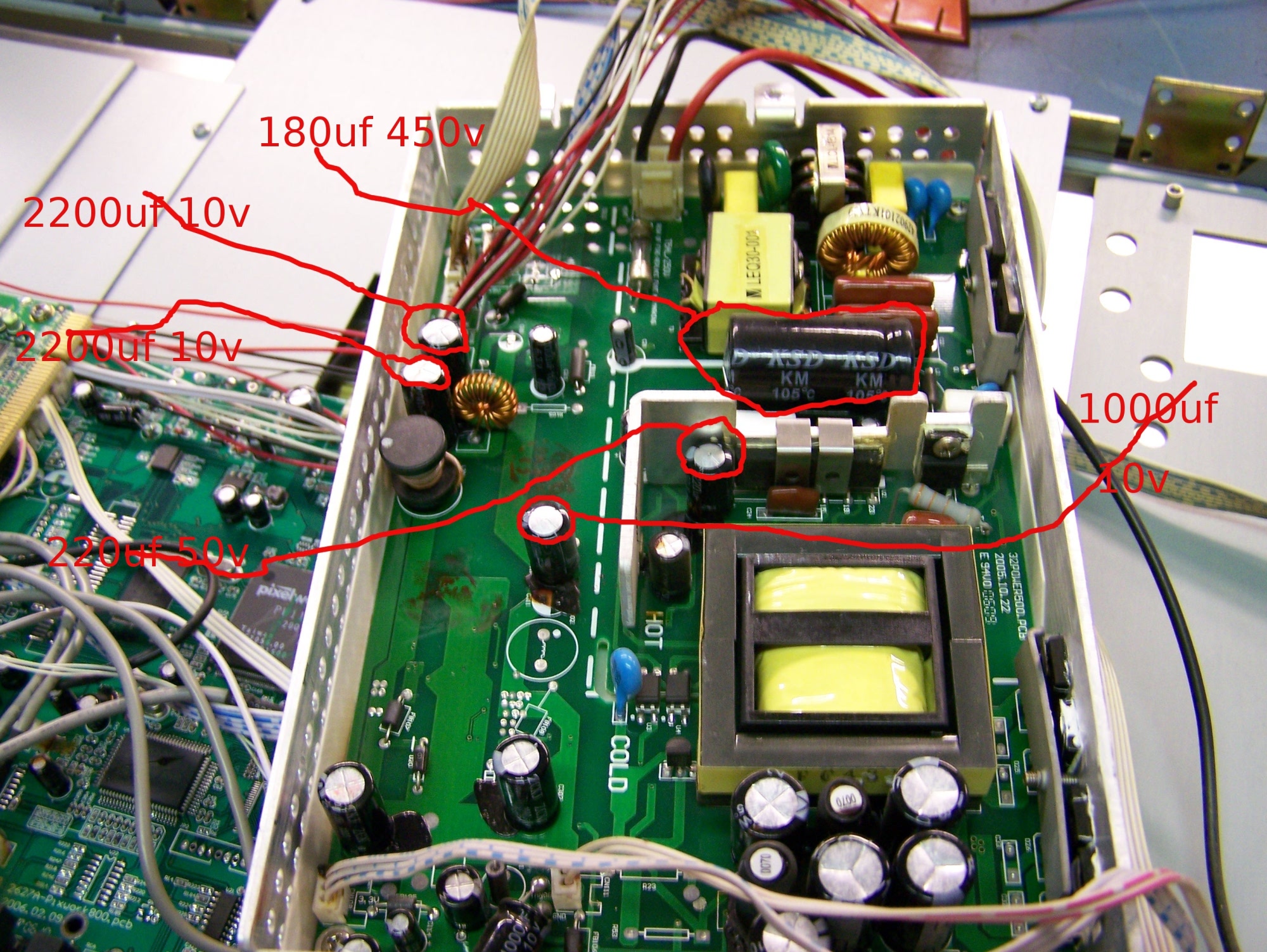

    i'm having trouble finding the right caps for a astar ltv-32bg lcd tv, the power supply has a few budging caps, 32power500 is the pcb # for the power supply. the caps are ksd km and kw. can these be crossed over to another capacitor? the tv would power up and the screen would flash , i'm thinking the lamp tube protection circuit was going out because of the caps.
    180uf 450v 1 45mm H 27mm dia. ksd km 105c
    2200uf 10v 2 26mm H 16mm dia. ksd kw 105c
    1000uf 10v 2 21mm H 15mm dia. ksd kw 105c
    220uf 50v 1 20mm H 15mm dia. ksd kw 105c
    22uf 100v 1 19mm H 13mm dia. ksd km 105c
    1000uf 16v 2 25mm H 15mm dia. zckj lr +105c
    2200uf 16v 2 26mm H 18mm dia. ksd kw 105c
    1800uf 35v 3 31mm H 18mm dia. aishi cd288 +105c
    i can't find out what the km and kw series cross over to or a replacement for them?

    KSD is a known bad cap.
    If the original 450V unit is a snap-in unit (thick leads), use Nippon Chemi-Con KMM. Otherwise (if original cap has thin leads), use KMG.
    For all the other units, use Nippon Chemi-Con KY.
    For the 100V unit, use Nippon Chemi-Con LXV, because this voltage and capacitance value is not available for KY.

        Pictures help.
        2 - 2200uf 10v 16x26mm - KZE - http://search.digikey.com/scripts/Dk...me=565-1650-ND
        2 - 1000uf 10v 15x21mm - KZE - http://search.digikey.com/scripts/Dk...me=565-1646-ND
        2 - 1000uf 16v 15x25mm - KZE - http://search.digikey.com/scripts/Dk...me=565-1665-ND
        (1200uF)
        2 - 2200uf 16v 18x26mm - KZE - http://search.digikey.com/scripts/Dk...me=565-1667-ND
        3 - 1800uf 35v 18x31mm - KZE - http://search.digikey.com/scripts/Dk...me=565-1701-ND
        1 - 220uf 50v 15x20mm - KZE - http://search.digikey.com/scripts/Dk...me=565-1710-ND
        (270uF)
        1 - 22uf 100v 13x19mm - KZE - http://search.digikey.com/scripts/Dk...me=565-1732-ND
        1 - 180uf 450v 27x45mm - TS-HB - http://search.digikey.com/scripts/Dk...name=P10161-ND
        (Snap-In leads)
        Diameters are less in most cases than the originals. KSD site is down/gone so x-ref is not likely to original specs. These UCC caps are superior in any case and should do very well in your TV.
        I increased those 2 in value to keep you in the same series of caps. It will not cause any problems by doing so.
        On the last one, you'll need to solder the wires from the existing cap to it. These are difficult to find with leads. Cut off the leads as close as you can to the base of the old one. Make sure you mark them so you'll know which is positive and which is negative.

          Re: ltv-32bg (32power500 power supply) bad caps
          ok thank
          i have just ordered the caps
