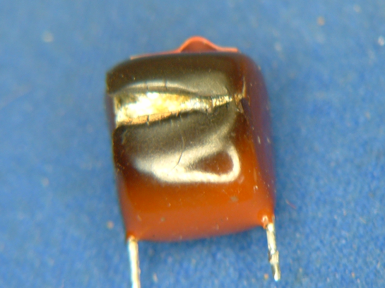

ltv-32bg (32power500 power supply) bad caps

    Is it a lytic?
    Is it radial or SMD?
    Some nice photos can help.
    Metalized Polypropylene Film - X-cap?
    Also enter your location into your profile.
    Listing UK sources if you aren't in the UK wastes time and posts.

      Re: ltv-32bg (32power500 power supply) bad caps
      I'm thinking...
      Metalized Poly[whatever] Film
      22000pF [.022uf] 1000V.
          Hi, Thanks for the help. Your right, a picture would help. I hope this works because I am new at this forum. I live in Tacoma, WA. Hope it shows up in my info.
            Polypropylene Film Capacitor
            [Link for the type only...]
            http://www.alibaba.com/product-gs/21...capacitor.html
            This should work.
            http://www.mouser.com/ProductDetail/...2f98dn0BHZM%3d
              Thanks PCBONEZ,
              I ordered from Mouser per your link.
