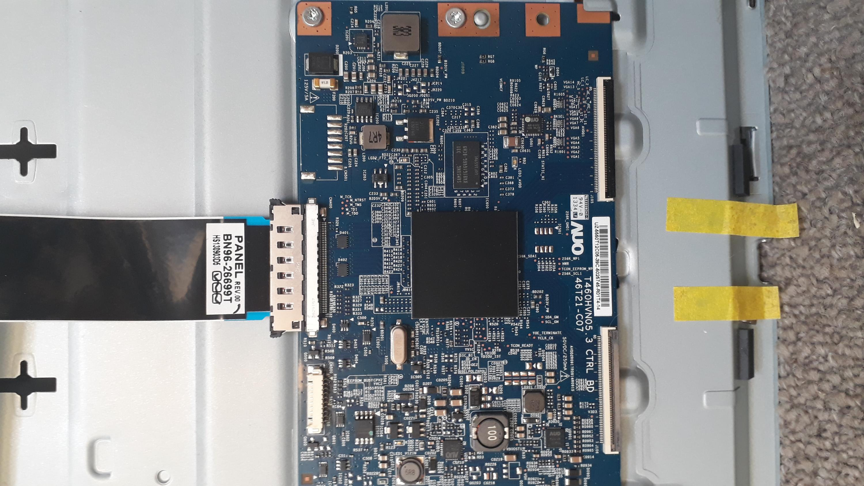

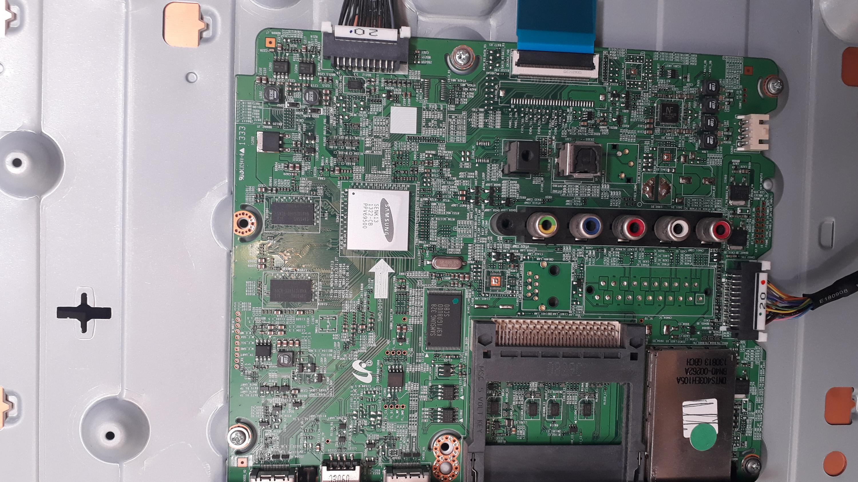

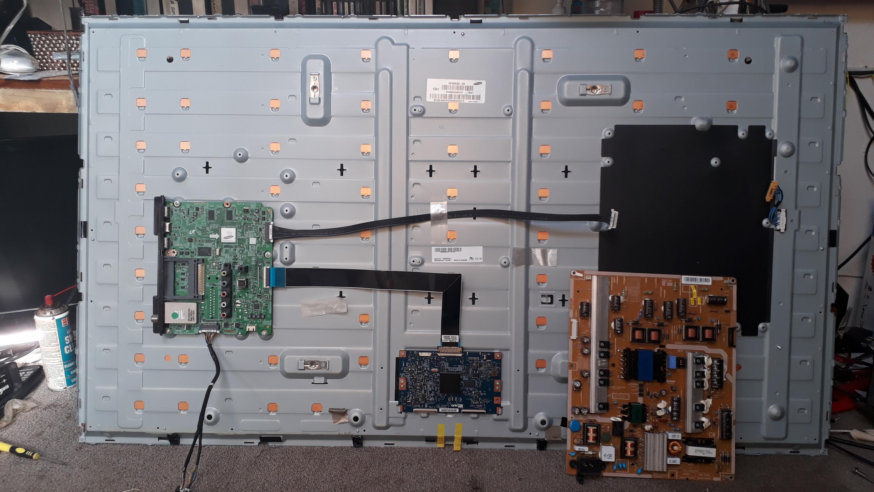

    Re: Samsung UA50f Backlight problem
    Can you post good clear straight shot pictures of the whole back and each board.
    • provider10
      • Mar 2016
      • 52
      • South Africa
      Hope these pics help. I think the model in UK is UN50F
            You have FOUR LED drivers so you need to check the Boosted Voltage output of each driver when you first turn on the TV.
            Your pictures are too blur to be able to read any prints on the boards.

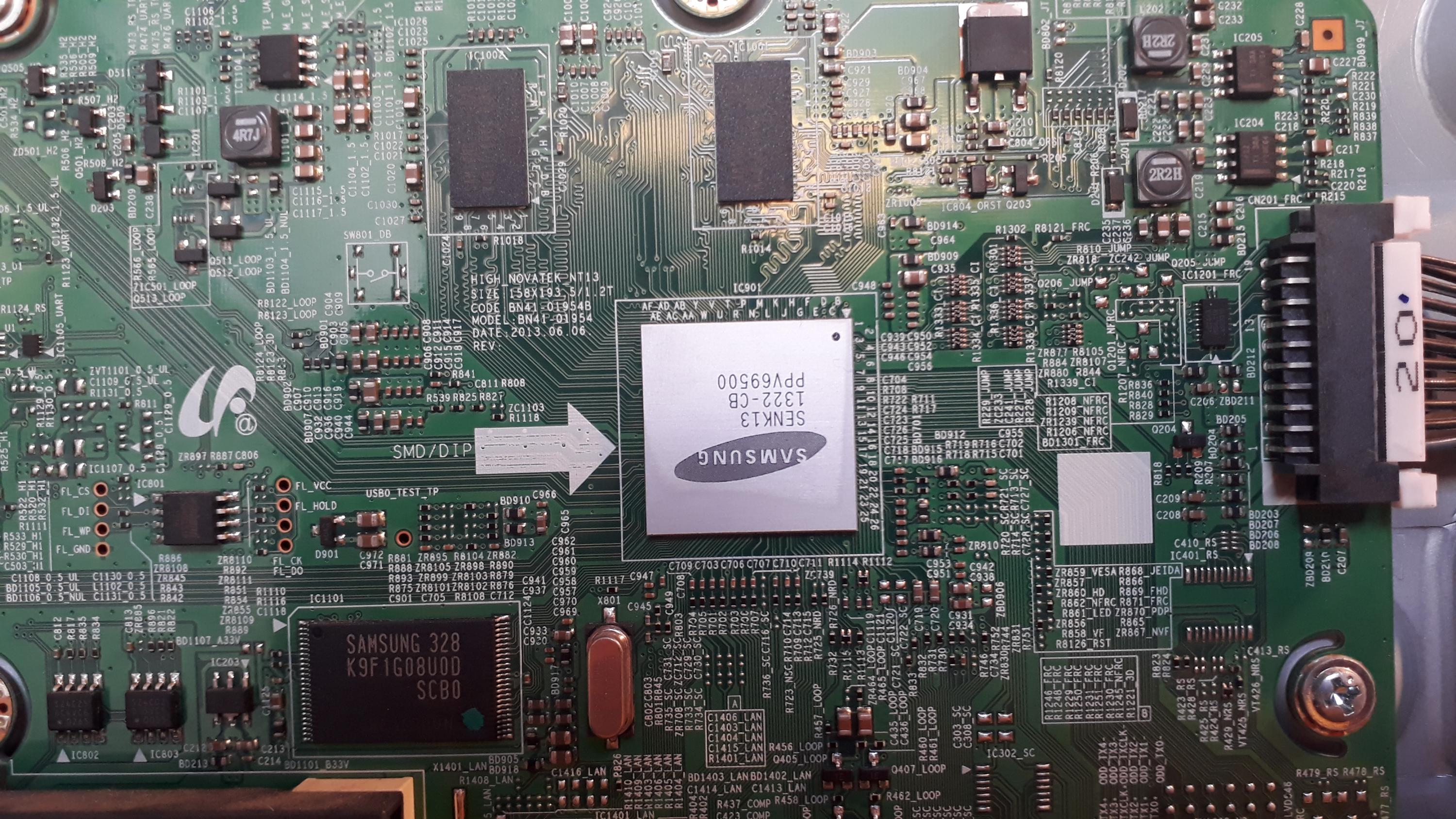

              Hope these pictures help. The problem is the set does not stay on long enough to make any measurements
              James

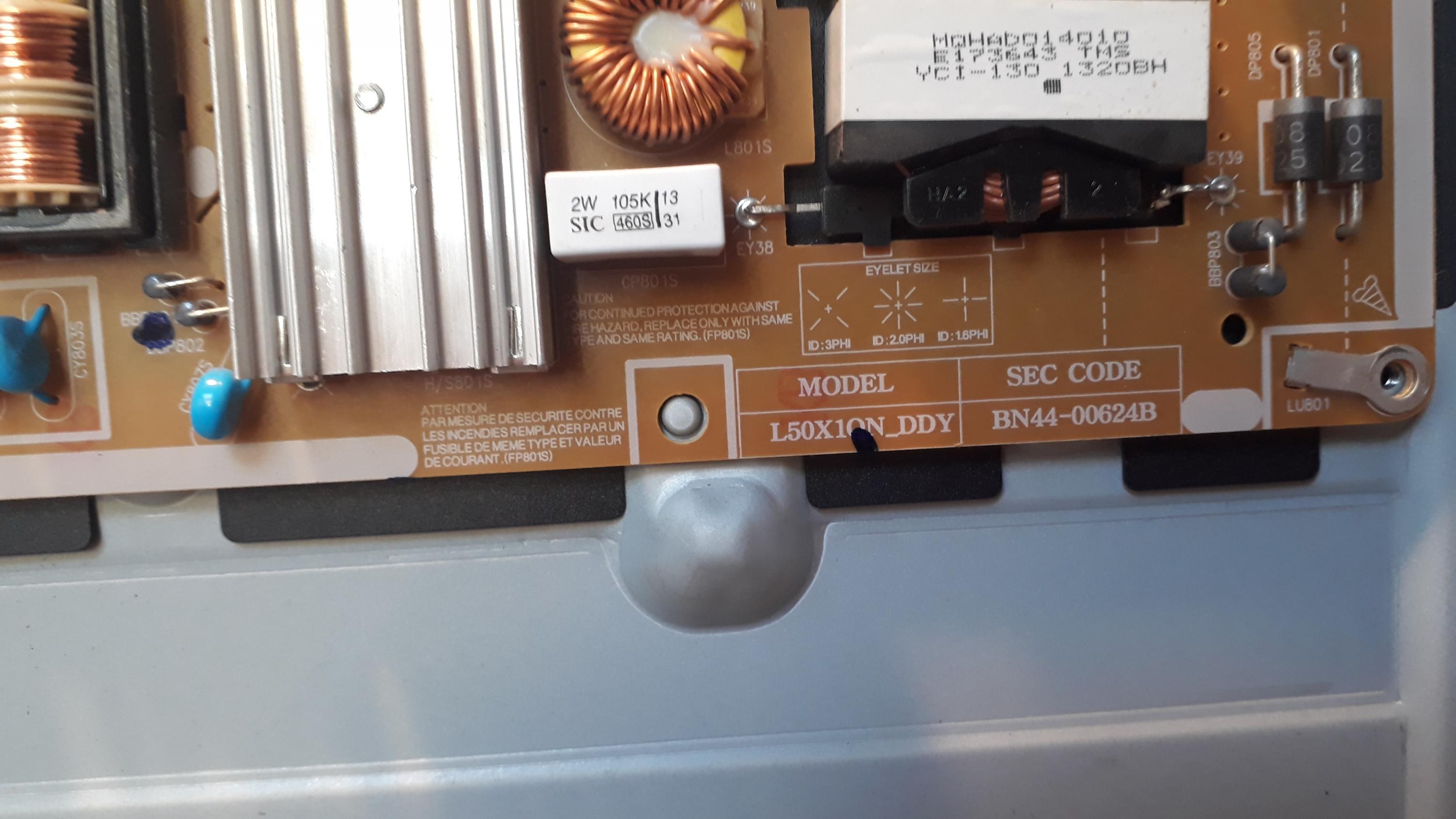

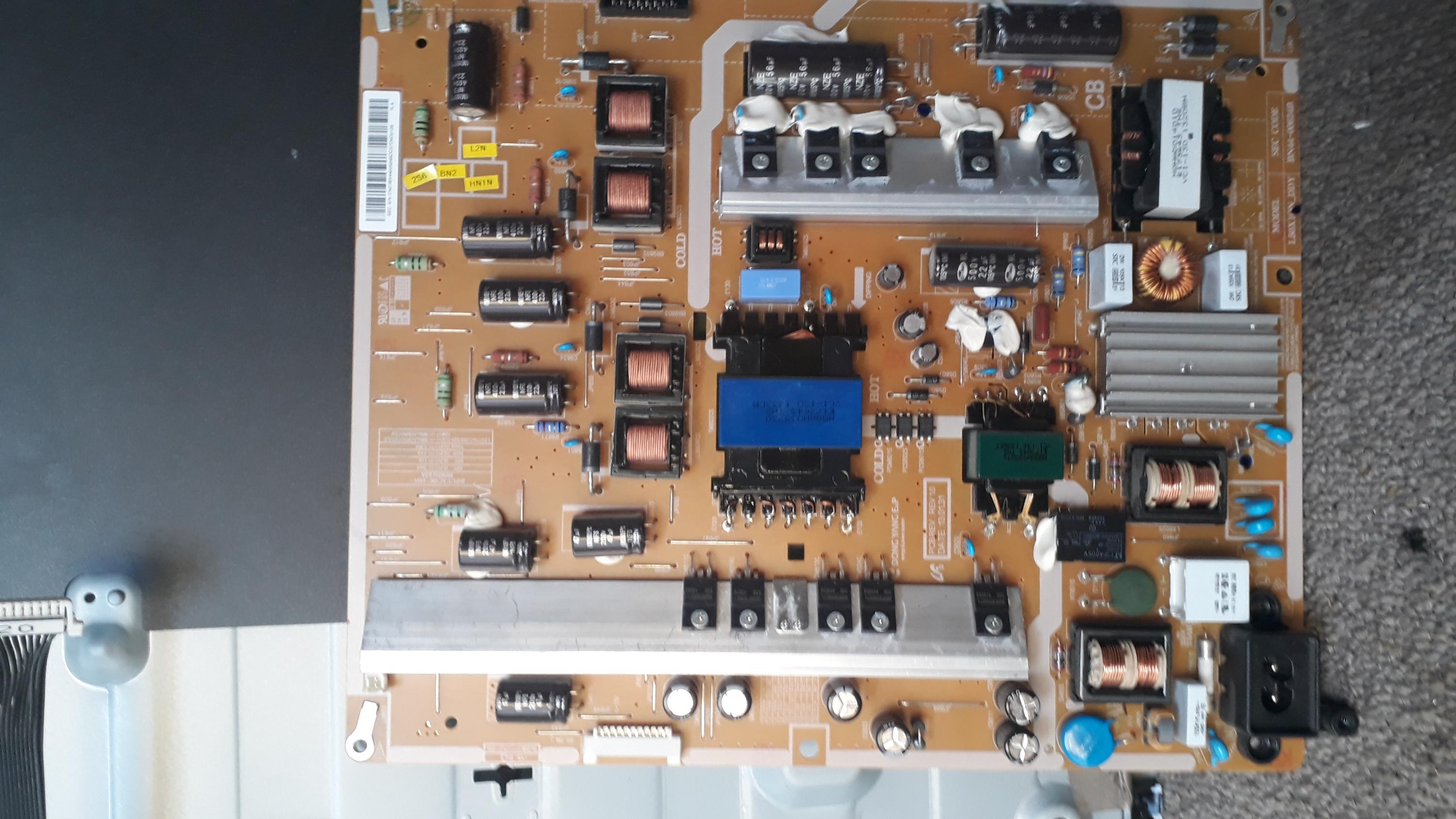

                  You are looking to see how high the LED drive Voltage jumps up to when TV is first turned on, so you will have to repeat the test 4 times to see if they all jump up to the same level or not before the protection circuit kicks in. Set meter to 200 Vdc scale or higher.
                  What is the power supply board P/N? BN44-?????.
                  There is Voltage chart printed on the board.
                  EDIT: I now see the board P/N BN44-00624B.
                  Can we get good clear straight shot of the whole top and bottom side of the power supply board?
