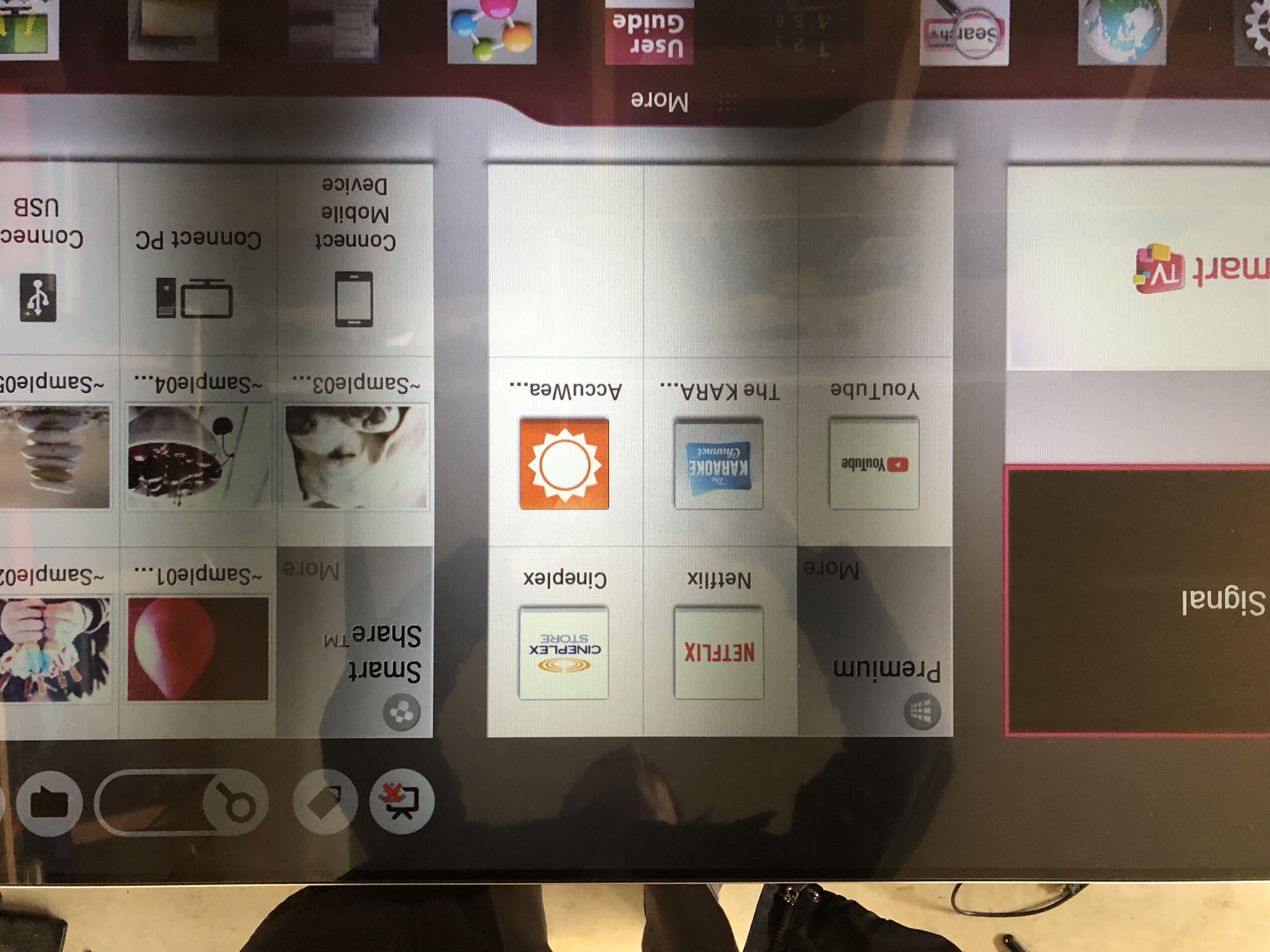

    Lg 55la7900-ua
    Good day guys

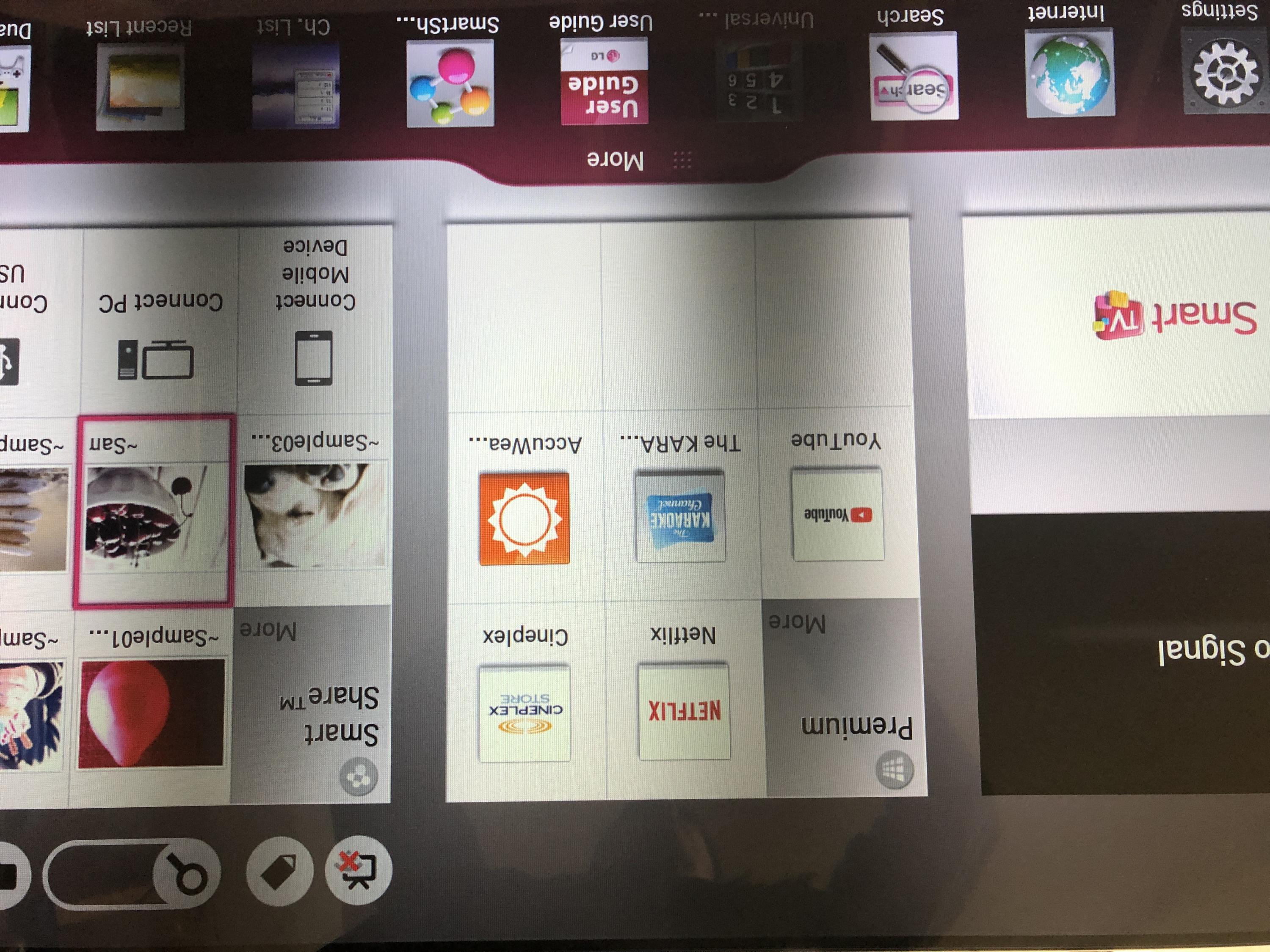

    I got this 55" LG TV from a friend. The TV functionally works as it should, but for the two vertical darker bands on the display. I've read a lot off threads, and it seems as if it might be the panel. The bands are consistent, even when the backlights are turned down to around 10%.
    Thanks for any help. On the second photo the backlights are turned down to 10%. 3D is turned OFF

    Re: Lg 55la7900-ua
    I would suspect there are a few led's that are bad on the strips along the bottom in the panel. Shopjimmy lists the strips (2) for $54.95

      Re: Lg 55la7900-ua
      Thank you guys
      I replaced the backlight edge strips in my TV, and my TV is working 100%.
