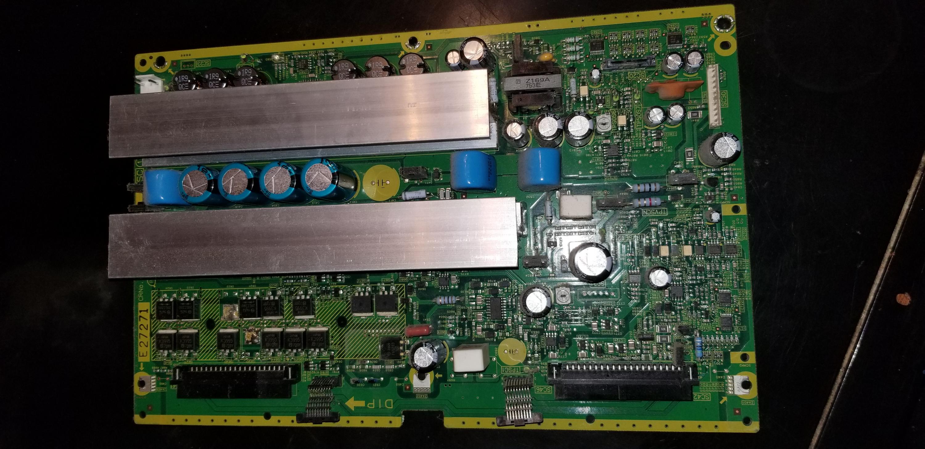

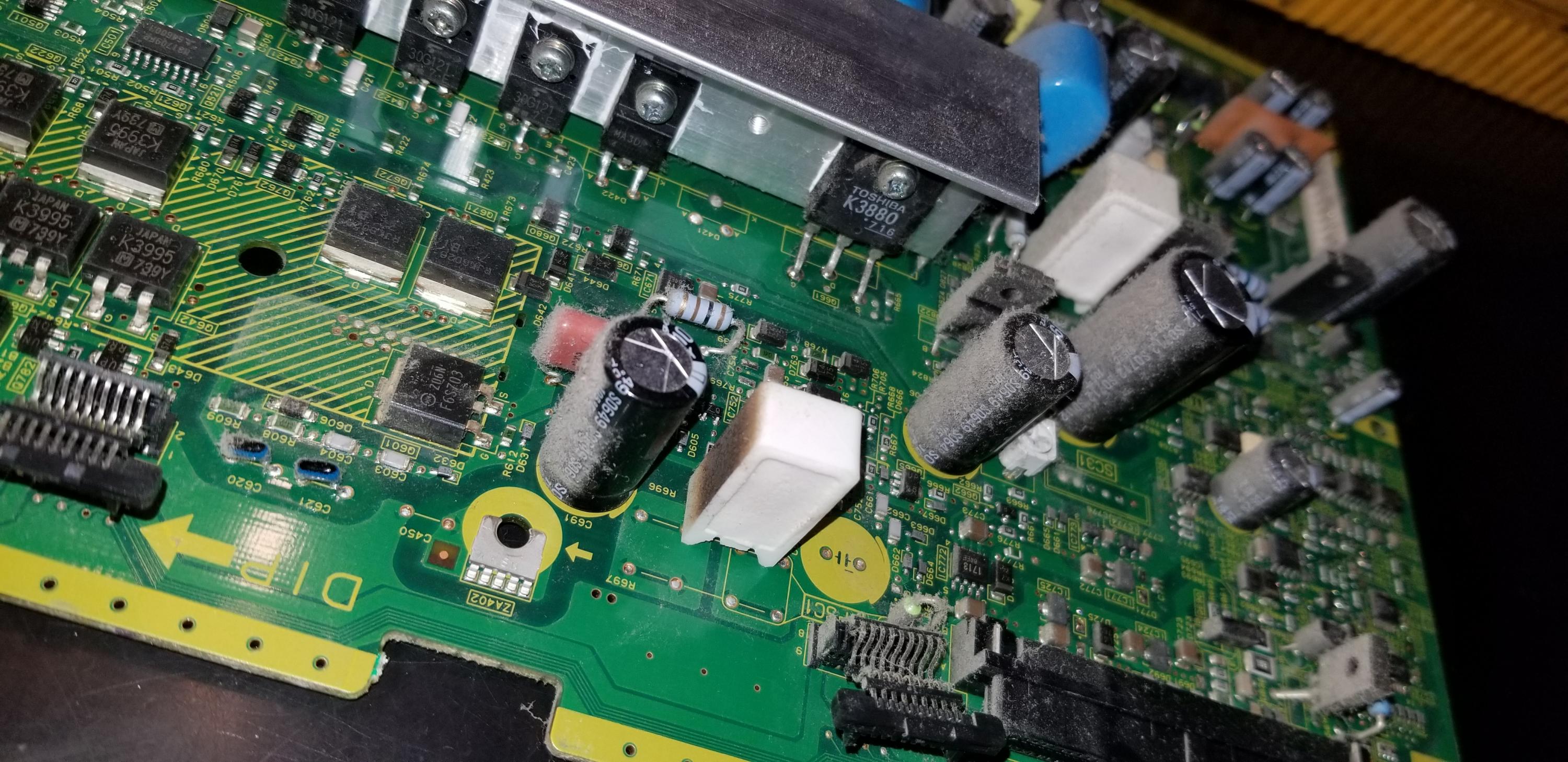

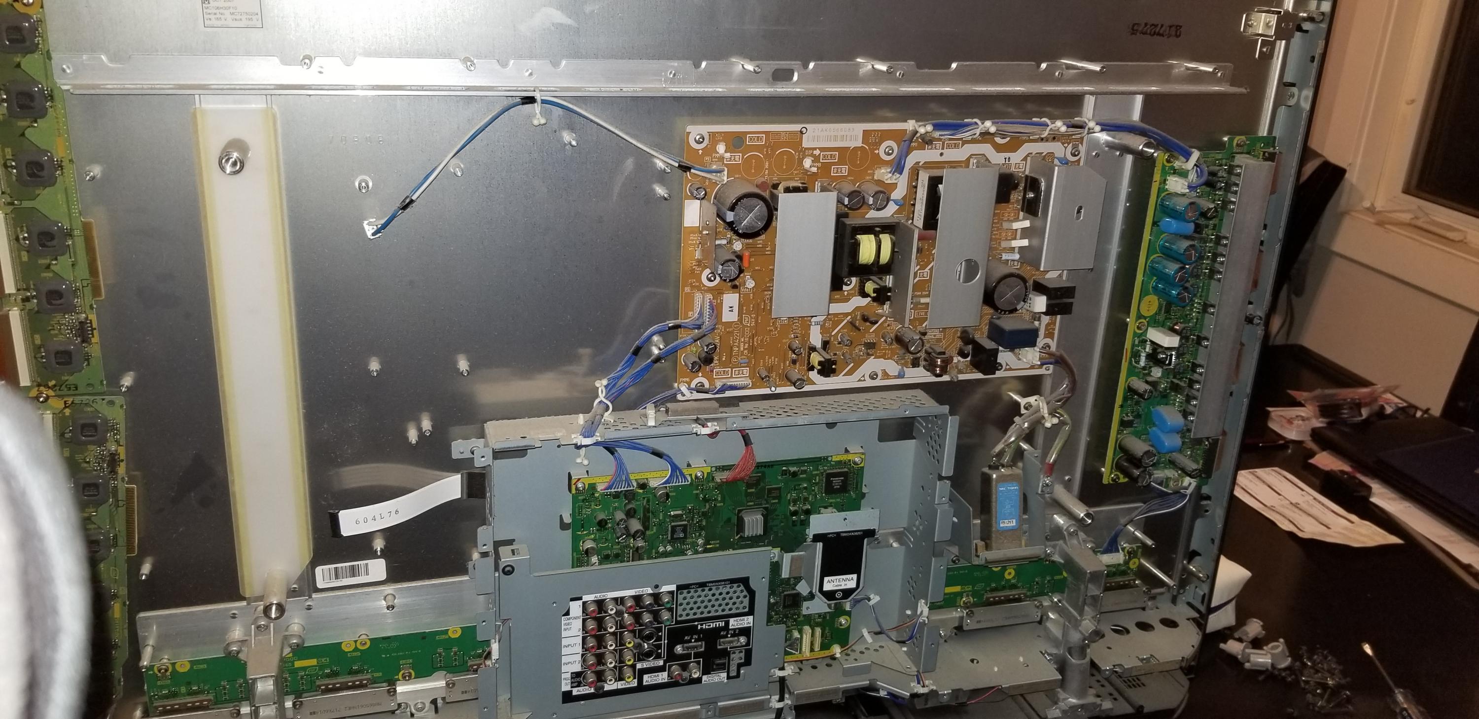

    Panasonic Th-42px75u top half white washed
    I have a th-41pc75u top half screen washed out can see menu etc vaguely in the whitewashed top half and fine in bottom half. Tv shuts off after few seconds 7 blinks. I disconnected one of the panel ribbons for top half tv will stay on still white washed except for the disconnected ribbon thats black. I tested the su board but cant find a short maybe tested wrong. In the sc board i did notice the white ceramic 2.2k ohm is burnt would this cause this issue or is it still buffer issue.
