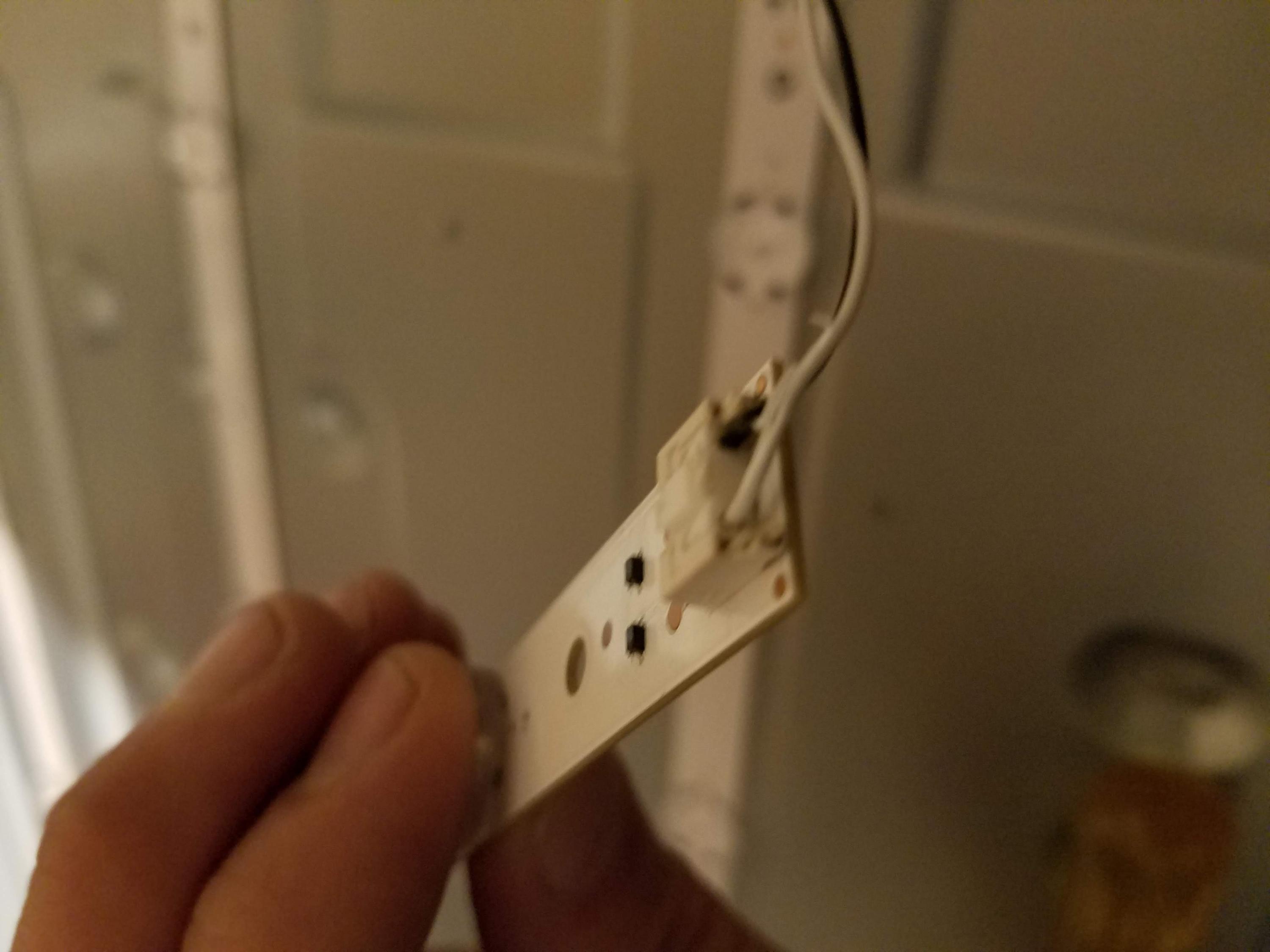

    So I have an LG 55UH6090 where the backlights faded over time and progressively become bluer, I adjusted for this but ultimately knew that I would be replacing the backlights.
    So I tore the TV down to the backlights (I could see that the actual lights were blue) and things were going well, I have the correct backlight replacement strips. and...

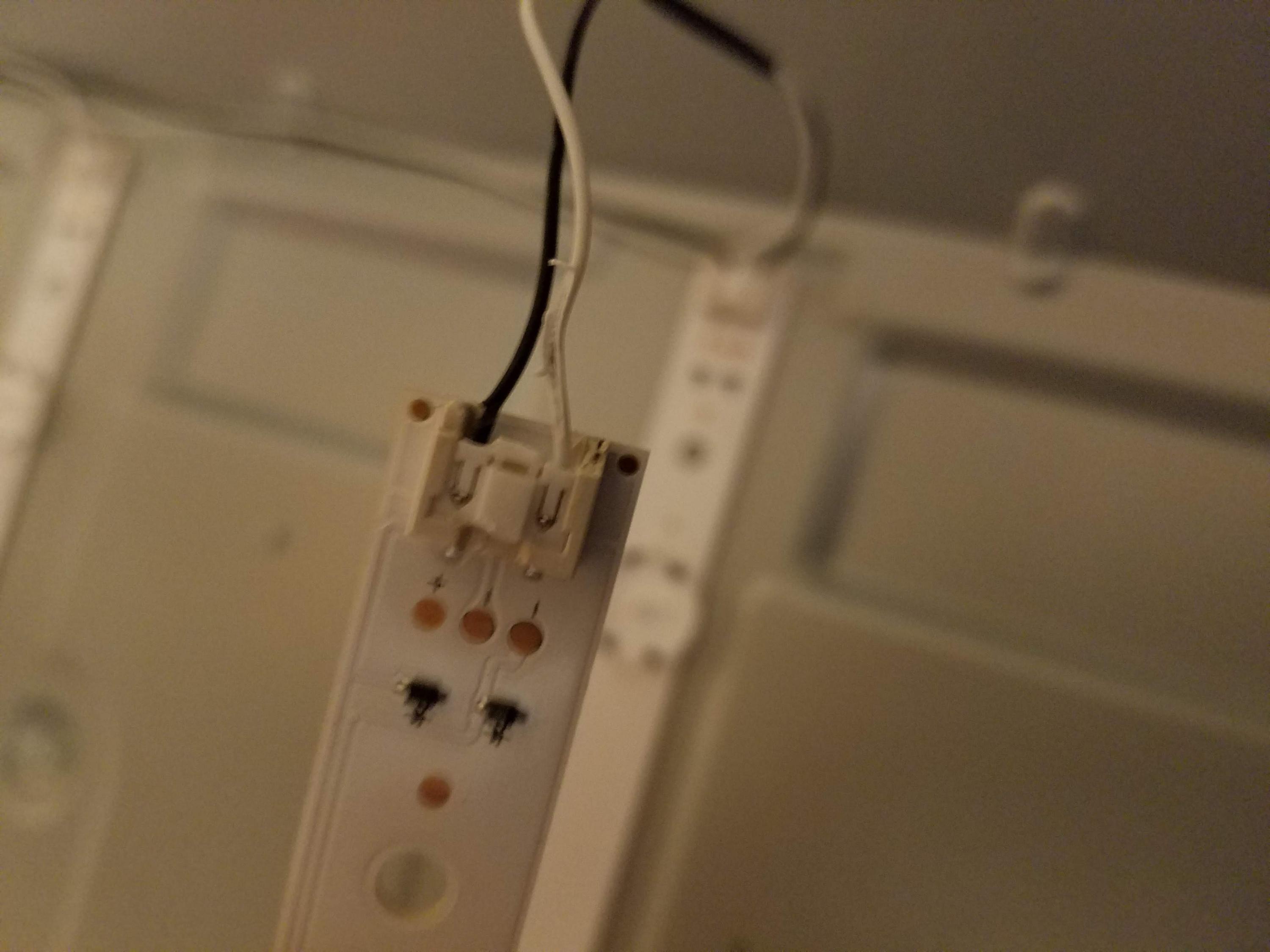

    How do I get the bloody wiring harness off the strip. I've watched the shopjimmy videos and he just like wiggles it a little and it comes off effortlessly. I've depressed what looks like a retaining tab down and even tried squezzing it, and I've wiggled a little with needle nose pliers even but I can't it to budge. So obviously i'm missing the trick here.
    I'm not seeing what it is that I'm supposed to be depressing to get these to release, i had to walk away from it before I just conan'd these things apart

    those pop off from the top. there should be little tabs. squeeze and pull straight up.
      i feel even dumber now lol. They came right out once i pulled the right direction, new backlights in and tv buttoned up and works great.
      thx!
