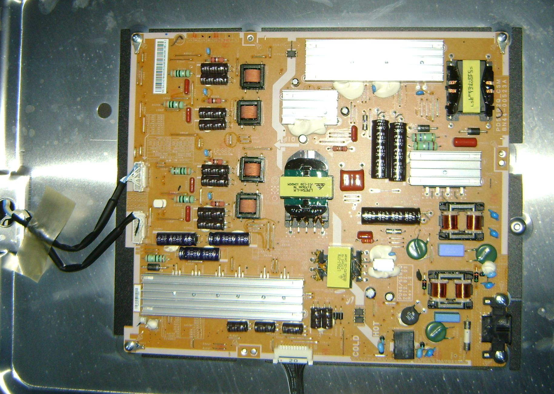

    The big caps on PSB are behaving themselves. 160 volts and change in standby, 380+ volts at power on. Takes plenty of time to drop back as the panel is switched off and main power cord disconnected.

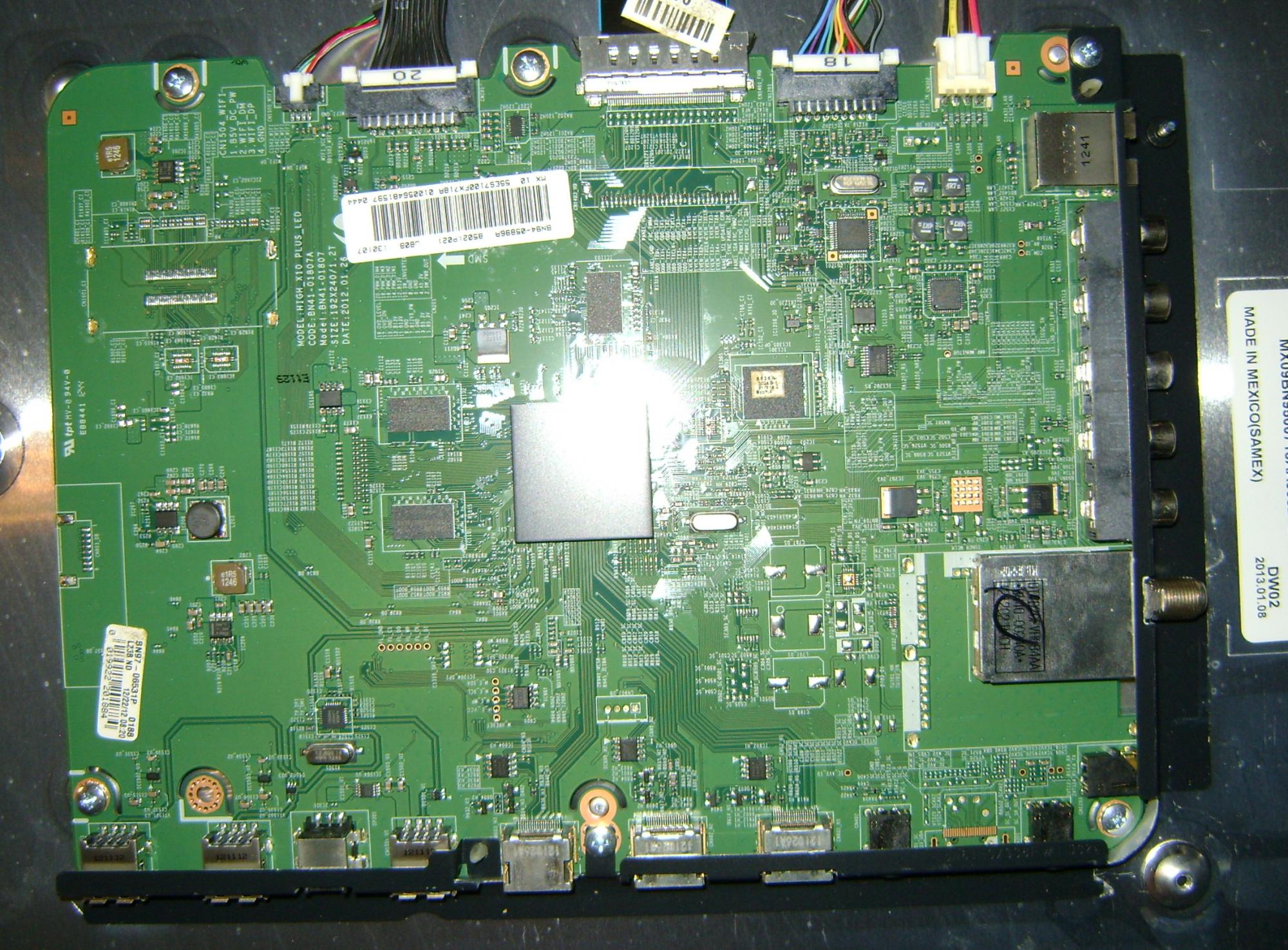

    The PSB > Main board cable is 20 pin. I can get to the odd stack simply enough and B5v and B13v are right there. A bit over on the 5V and just a bit under 13. (I know there are routinely suggestions to supply all voltages, my assumption was to disconnect at the Main and probe the female connector the for the even stack. And then I didn't.)

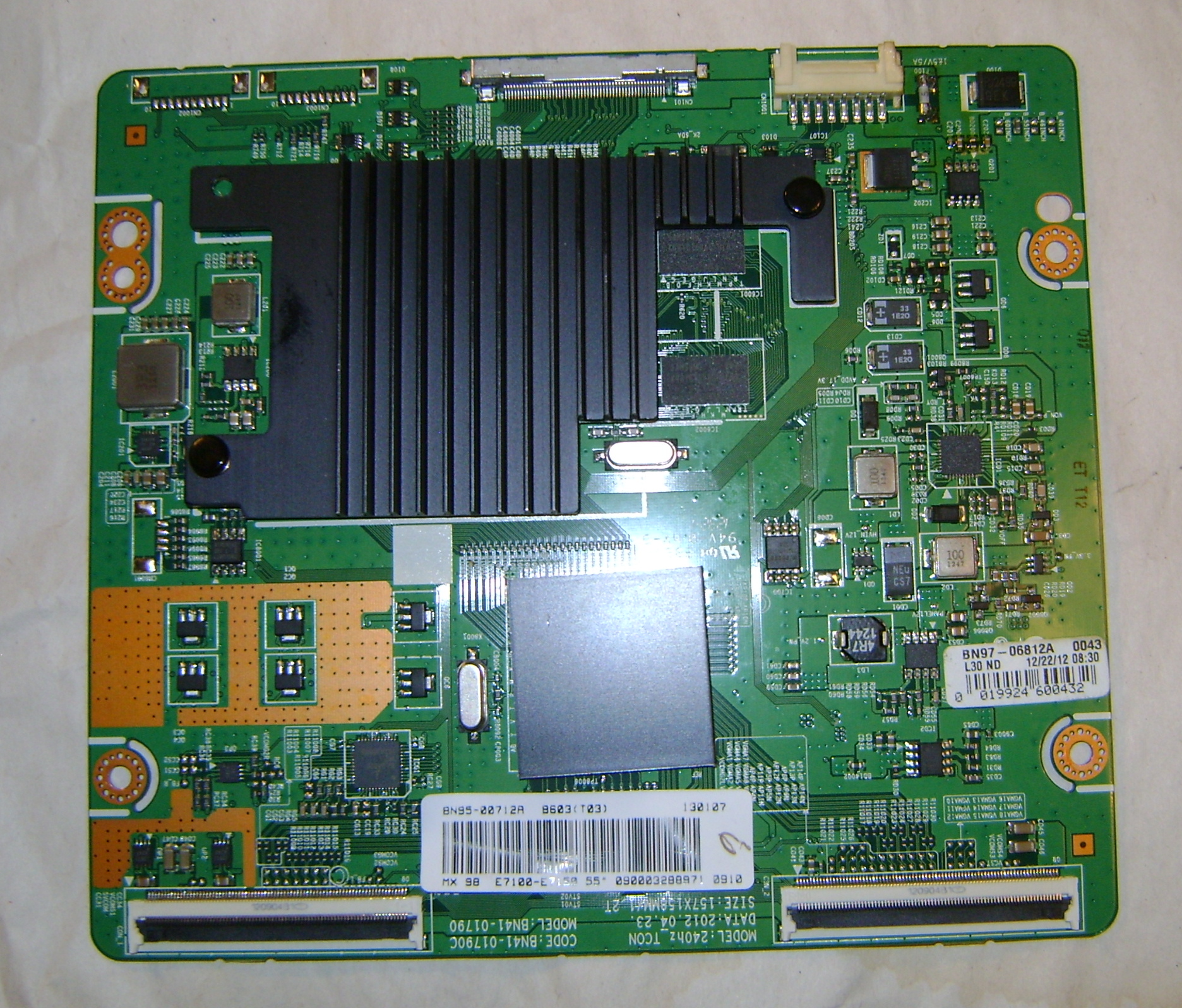

    In any event, my search fu was suggesting this was going to be Tcon or worse, so I headed south.
    I disconnected the (I assume) LVDS cable from the Tcon. In that configuration, on power up attempt I HAVE my backlights.
    More reading and I locate and test F100 to see it's served it's purpose. The original 125V, 5A is blown.

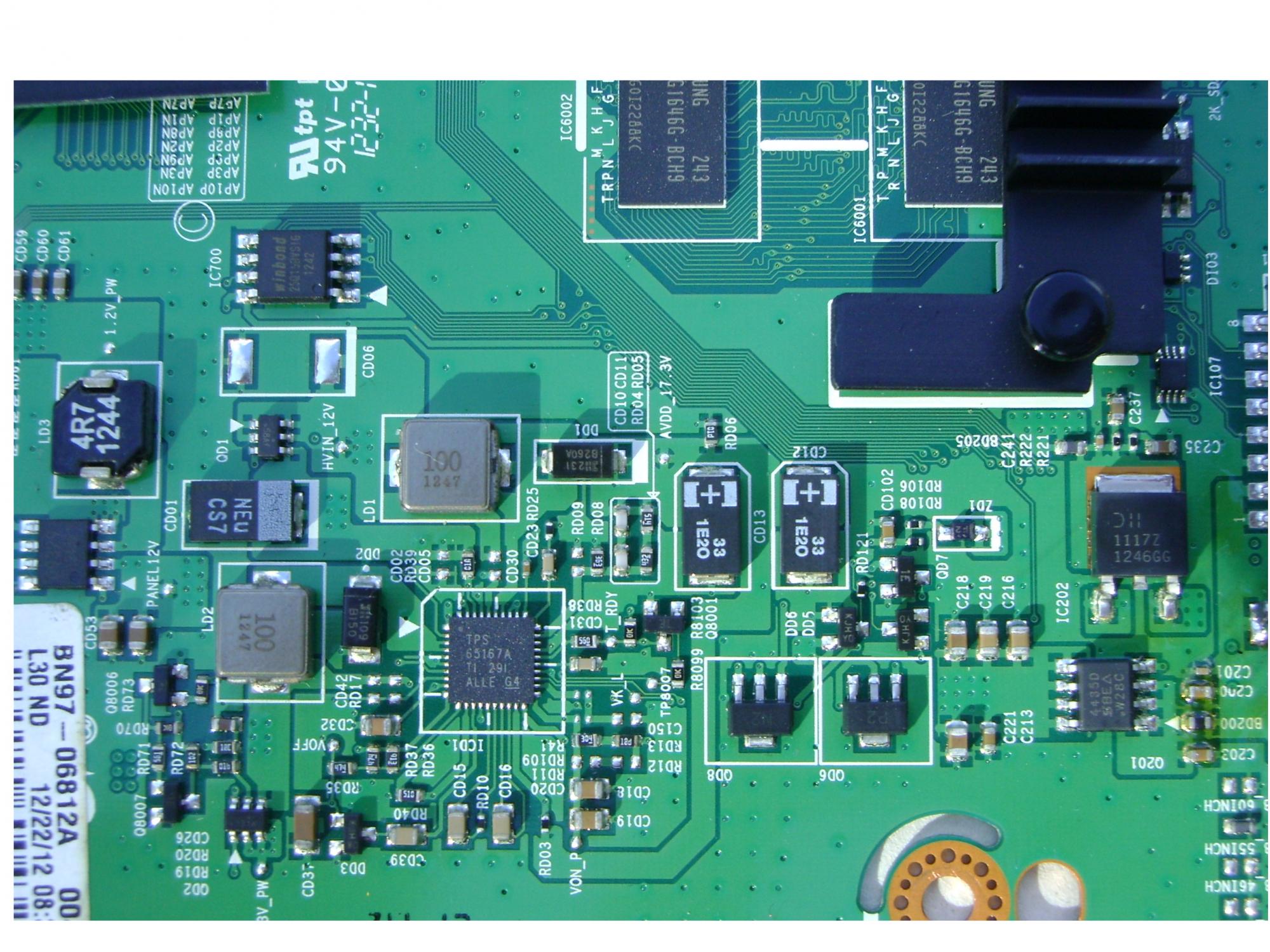

    I have attempted to look for Tcon SMD cap shorts to ground. I did most of the top side. Just about all acted as I hoped with ONLY the ground plane side beeping continuity at about 1 ohm.
    Then I realized, I was ignoring some things that looked like tantalum caps. They are a CD prefix rather than C, and I apparently can't find that definition either.
    Both CD12 and CD13, marked 33-1E20 have continuity to ground on both ends. They are about an inch and a half below the almost 13V IN fuse.
    I have no idea if that is their behavior.
    The Tcon board model is BN41-01790

    33µf/25v Conductive polymer chip tantalum capacitor, Either the cap is dhorted or something on that line is shorted
    When you say "have continuity to ground" I hope you are not basing that on the meter BEEPING

      If you don't have backlights, the first step is to unplug the cable from the main board from the ps. Backlights should come on because of internal pullups. If they don't you have bad backlights (most likely) or bad ps (bad backlights on Samsungs can damage the ps). You may have multiple issues.

        I finally managed to get enough light for a better resolution photo of this area.
        (The third shade of green is shadow from the taller components.)
        I did some more continuity testing, then decided to pop off CD12 and CD13 since my testing didn't mean much to me.
        All four pads for CD12 and CD13 are going to ground, now. The caps are not showing continuity at room temperature.
        So, what I have seen heading down from there. The 2 pak of cap over resistors: CD11 and RD05 each have one leg to ground and the other side is open.
        CD10 and RD04 are all open relative to ground. Looks like a series run.
        DD1, a two legged diode I guess, is grounded on the top pad in the image and open on the other side, LD1 is reading open on both ends, and that looks like it could be series too?
        The IC that I think the QD1 label is for, I figured the board triangle, and the IC dot was pin 1, so I thought I'd see ground at the opposite corner, which I thought should be 6. That's not the case. No beeps on QD1 at those pins.
        The last bit I probed was LD3. Each side gave me a beep at 213 ohms or so.
        (I kinda hope that's bad.)

            QD1 is a mosfet, pins 1,2,5,6 are the drain, 4 is the source and 3 is the gate, none will be ground, It could be the boost regulator that boosts the HVIN_12V via LD1 (coil) and DD1 (diode) to get the AVDD_17.3V
            I suspect the short will be on that 17.3v line somewhere
            Check if those caps (CD13&CD12+) connect to RD03, and ICD1 pin19, the ic could be shorted?
            I asked about the continuity testing because some people here the meter beep and assume a short, but most meters with the continuity/beep will beep between 0 and 150Ω

              RD03 is where I made it to, trying to run that trace, last night. I looked at that little booger and said to myself... “I hope not”... , since I promised myself not to try and interpret resistors or diodes anyway.
              I didn't understand what the probes were telling me, and turned around and pulled the tantalums off.
              _____
              Yes... they are all singing the blues this morning.
              Both sides of RD03 and then Pin 19 on the 40 legged spider, are all communicating, as my medical friends say, with each and every one of the four, still blank, pads associated with CD12 and CD13.
              Two of the pads to Pin 19 are .1 or .2 ohm and probably dropping. Two may have stopped at .4 ohms.

                Between CD12/13 and the ic's pin 19 is RD03, That should be quite easy to remove and see which side of RD03 has the short.
                • Renovator
                  • Jun 2019
                  • 38
                  • US
                  Re: Samsung UN55ES550F Tcon Fuses
                  Well... the little, I mean pretty little... guy took more time and flux than I would have thought.
                  It's off and the short stops at the CD12/13 side of the resistor.

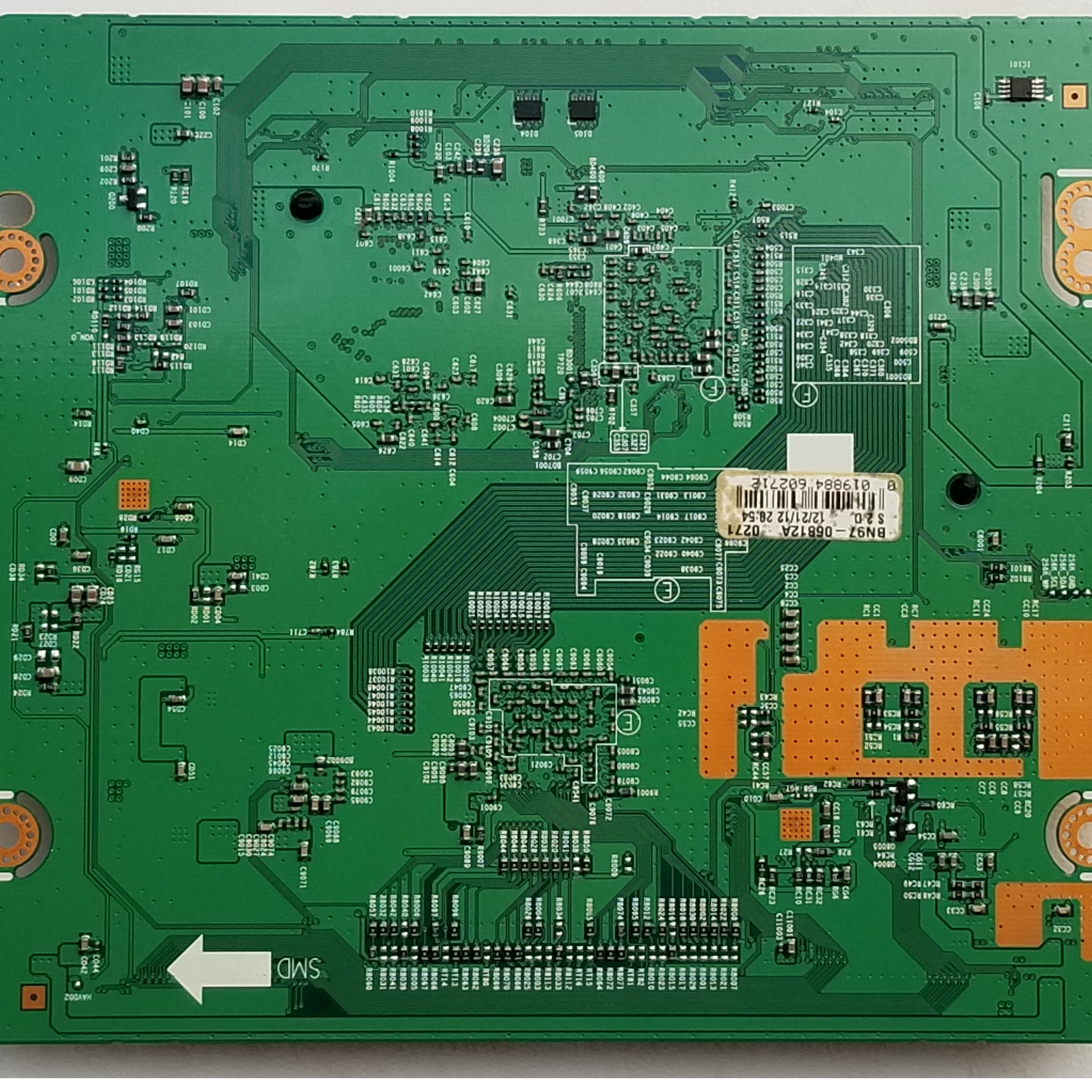

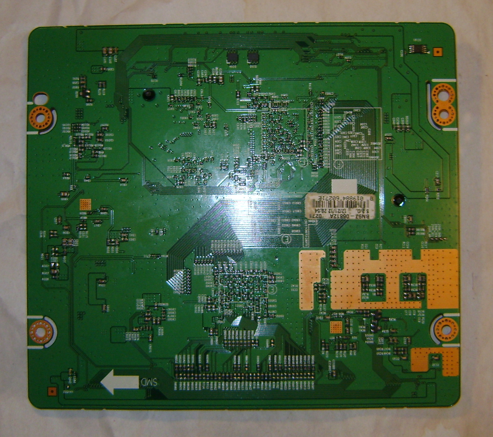

                  Back side of Tcon.
                  That pic isn't so good, but southeast from the northwest chassis hole is a lone ranger CD14 (… really) .
                  It looks to be straight under DD1 on the topside.
                  I'm reading .1 > .2 on the east pad (relative to the pic.) And 1.0 > .9 on the west side.
                  (I'll upgrade that photo.)

                                      To the budm query:
                                      Those guys. You're right I didn't think they were shorted, since they were not listed above. But there was something different about the original pass, compared to the others.
                                      This Morning, using Auto-Ranging seems to give the most consistent, repeatable results.
                                      The four larger form factor:
                                      CO45 0.7 Ohm
                                      CO46 0.7 Ohm
                                      CO47 0.7 Ohm
                                      C048 0.7 Ohm
                                      The smaller stuff:
                                      CO41 6.3 kOhm
                                      CO43 6.3 kOhm
                                      On the left ribbon side, (their labels may be off camera).
                                      CC34 0.7 Ohm
                                      CC31 0.7 Ohm
                                      (The meter is a Klein MM600.) (I've got plenty of lightweight, little red meters, to double check with, if things look goofy.)
                                        I would remove those that show 0.7 Ohms one by one and see if the low Ohms readings will go away. You should be able to use 200 Ohms scale to look for low resistance readinsg in both direction.
