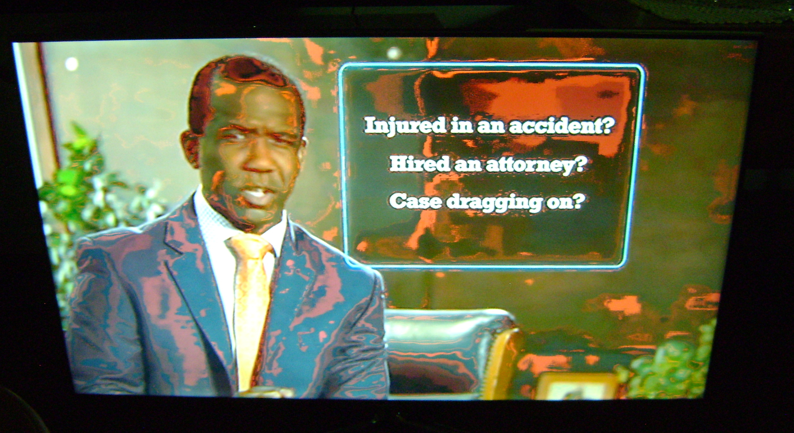

    The list:
    VGMA 1 11.26
    VGMA 2 9.53
    VGMA 3 8.96
    VGMA 4 8.55
    VGMA 5 8.28
    VGMA 6 7.99
    VGMA 7 7.78
    VGMA 8 7.58
    VGMA 9 6.23
    VGMA10 5.43
    VGMA11 3.63
    VGMA12 2.66
    VGMA13 4.05
    VGMA14 3.35
    VGMA15 2.09
    VGMA16 3.85
    VGMA17 3.04
    VGMA18 0.37
    There was no input connected, so it auto shutdown during the run.
    I let it stabilize after reboot and read the exact same values.
    The picture above captured more light than one would see.
    IOW's these images are real dark, with no green. Not solarized as most gamma examples about the interwebs.
    ____
    I'm not going to have an IC for gamma, am I?
    Do Those traces run to the processors with the funky heat sinks?

        The Voltages do look bad from 11 to 17.
        https://www.badcaps.net/forum/showth...&highlight=VGH

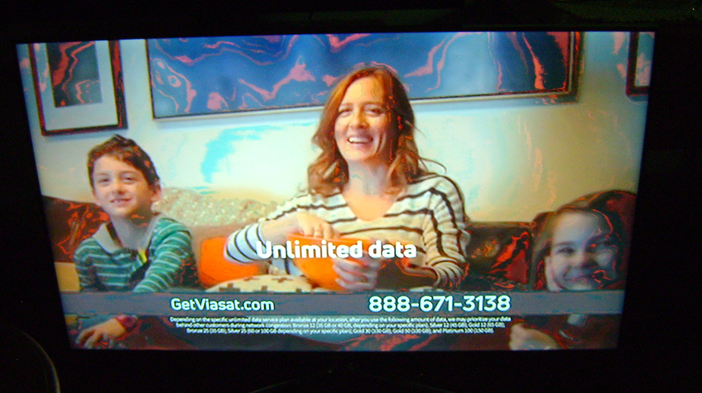

                I decided to wander out further on the diminishing return limb, and obtained another Tcon, with heatsink seated.
                It made a significant change, but there is more to be done.
                The boot screen with 'Smart TV' has always been fine and still is.
                Now, the OSD menus are also displayed properly. (Previously they also showed the dark posterization.)
                Now I have what more nearly looks like other solarization examples about the net. (These seem less to moderate in intensity.)
                It is not localized. It is screen wide.
                Yes, I simply installed the new board, and started her up. I have not checked any voltages, yet.
                This is my first dance with an LCD, and I have only passing TV image knowledge.
                My plan is to go back and hit all the labeled test points from the PSB onward, and adjust any pots to voltages listed.
                If need be, I'll have to pull the stand to get to the Tcon, and hit those TP's and then the gamma string to verify this new board quality.
                In recap, I have done nothing with the main, but wiggle connectors.
                Should I be looking for main problems, related to the 5A Tcon fuses blowing?

                  Lovely:
                  VGMA 1 16.3
                  VGMA 2 13.8
                  VGMA 3 13.0
                  VGMA 4 12.5
                  VGMA 5 12.0
                  VGMA 6 11.6
                  VGMA 7 11.3
                  VGMA 8 11.0
                  VGMA 9 9.0
                  VGMA10 7.9
                  VGMA11 5.2
                  VGMA12 3.9
                  VGMA13 5.9
                  VGMA14 4.9
                  VGMA15 3.0
                  VGMA16 5.6
                  VGMA17 4.9
                  VGMA18 0.5
                  (When I get a better gamma curve from a future board I'll let you know.)
