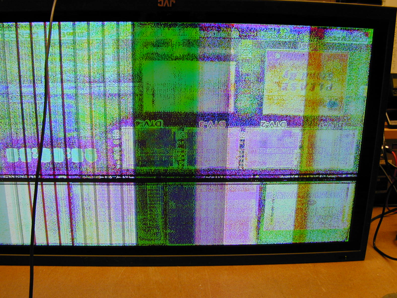

    Hi all. New to the board and new to plasma tv repair. I'm wondering if someone can have a look at the picture of my plasma screen below, and tell me which board might be bad. I've ordered the service manual and looked over the circuitry. I found no blown caps. Any ideas much appreciated.
    Also, in the picture ignore the lines at the top. This is an old vcr on pause.

    Upper Y-drive IC failure in that band. Count your ICs of top and bottom Y-drive boards. is it 12 chips or 10, 8? Only fix is replace upper Y-Drive board. This is long narrow circuit board with square ICs, sometimes have heatsinks on each IC.
    Hint: this is on your left side when viewed from behind with back cover removed like you are working on it.
    BIG warning: this is highest voltage at enough current. Be careful.
    Work on this with power cord *unplugged*. Don't touch any adjustments till this problem is fixed *first*. Then we can instruct you how to adjust if NECESSARY if you getting sparkles (usually red or green, rarely blue or dark sparkles in odd manner).
    Cheers, Wizard

            Now I'm not sure the Y-upper board is the problem. The problem I'm having is the colors are all psychedelic looking, not the horizontal lines across the top. Those are caused by the vcr. I just wanted to clarify. So the Y-upper failure would cause the color and pixel problems across the whole screen range?

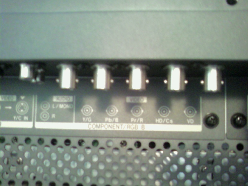

                    It's labeled component but the connector is like none I've used before. Picture below.
                    • Wizard
                      • Mar 2008
                      • 2296
                      Re: JVC GM-V42UG plasma monitor problem
                      These are called BNC connectors.
                      Bit spendy. Obtain five BNC to RCA adapters.
                      Cheers, Wizard

                          I tried the component inputs and there's no change. Still grainy, washed out colors. Question, when a pdp is near the end of its life, what does the picture look like? The monitor has a lot of hours on it, however its labeled "Professional". Does that just mean the internal circuitry is more rugged or should the pdp last longer?

                              Attached is image of my JVC monitor.
                              I have no -70 volts at Vsca with Y-buf-upper and Lower PWB's connected.
                              all other voltages good replaced bad caps on SMPS PWB (Main power supply)
                              R5117 & R5118 are burnt up on Y-Main PWB.
                              With R5117 & 5118 removed -70 volts comes back but picture still looks bad
                              R5117 & R5118 measure 13.6Ohms in circuit & 27Ohms out any idea what they should be?
                              • skisabeth
                                • Jan 2013
                                • 3
                                Now have -70 V back on Y-Main PWB by changing bad caps:
                                C5080 100@35V
                                C5081 100@25V
                                C5090 68 @250V
                                C5062 100@160V
                                But picture still the same.
                                  Looks like Y-buffer fault.
