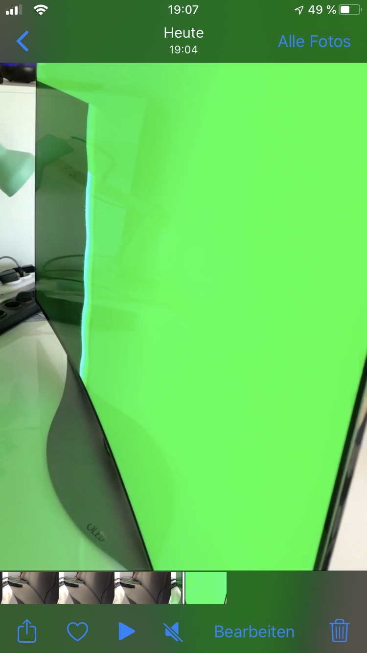

    Hello guys,
    In both a defect LG55EC930v with the hope to repair it but till now no success.
    The Panel looks perfect it has no cracks or other deterioration. The Tv starts and after 2s turns off no image just black. After reading some Posts i i understood how to check the PSU and the Values look ok, did the checks like in the service manual with light bulb and all was ok. After reading the Posts from freakaftr8, Billsy and Diah i bought a Service remote to get out of the protection mode and i could start it for 1s and received the image in the Photo.
    Could you tell from it if the panel is broke? The left corner is black.
    I appreciate any help or suggestions.
    Br,
    Adrian

    post please photo on yours T-CON driver boards.
    also unplug the first right ribbon cable ( when you look at the set from back side )which it goes to panel. inspect its pins from both side. keep it out and tun on yours TV and immediately press power on RC check if the set goes to stand by mode...
