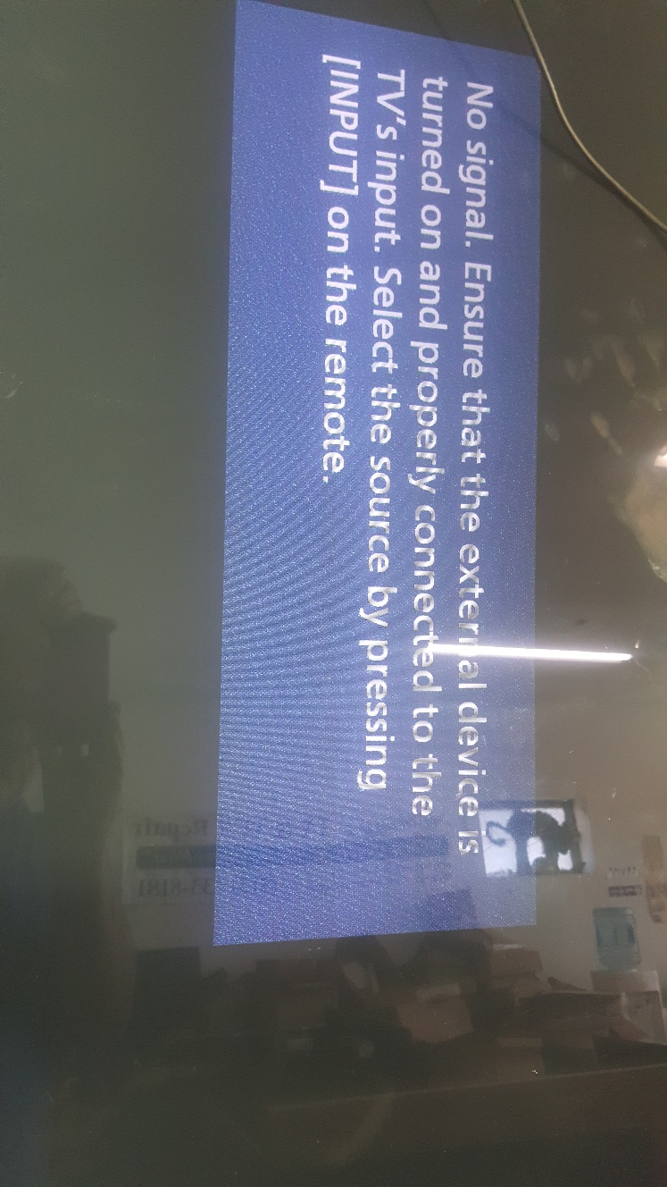

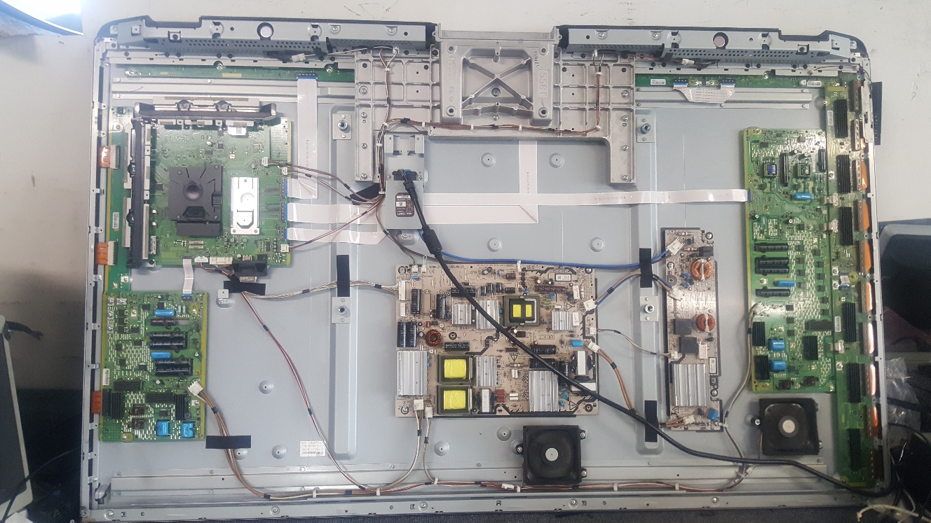

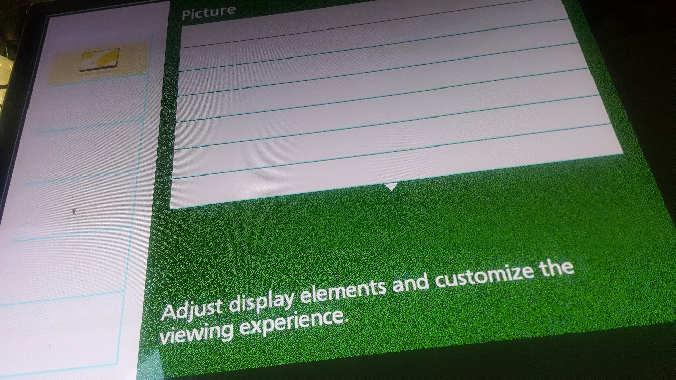

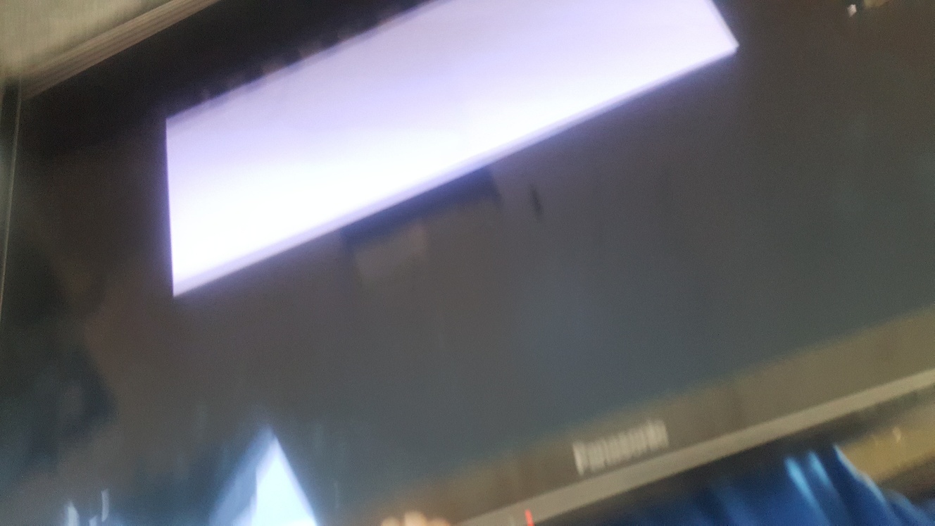

    I just bought this board off ebay the old one blown fets so i put this one in TV runs but picture is negative looking like a voltage on the plasma panal is way off
    so i check everything i can VSUS 210 from power board
    voltage across C842 148V DC voltage across C813 204V

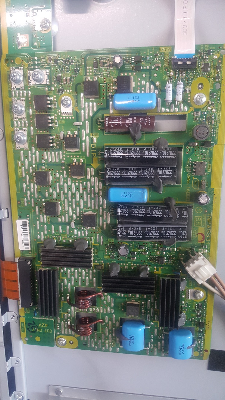

    Evrything looks noraml tv runs no errors so I start looking at SS board 135 v DC Ve I CHANGED the SS board and the power board becuase I had them there is no difference Im hoping I got a bad SC board but Im not sure how to verify that since the voltages I read you are good against VFG the tv is missing a panal sticker to tell me what this panal wants to see to run so I dont know the SS voltage to the screen is 109V against ground Ill atach a few pictures in a few

              Re: Tnpa5335
              Q101 and Q102 on the SS board.
              • anthonystv
                • Jun 2014
                • 73
                Re: Tnpa5335
                they seem ok and I replaced the SS board they are not shorted and read like a diode in circuit I see wavforms on the gate and voltage out put seems like something on the SC board but since all voltages seem right .. im not sure where to go ?
