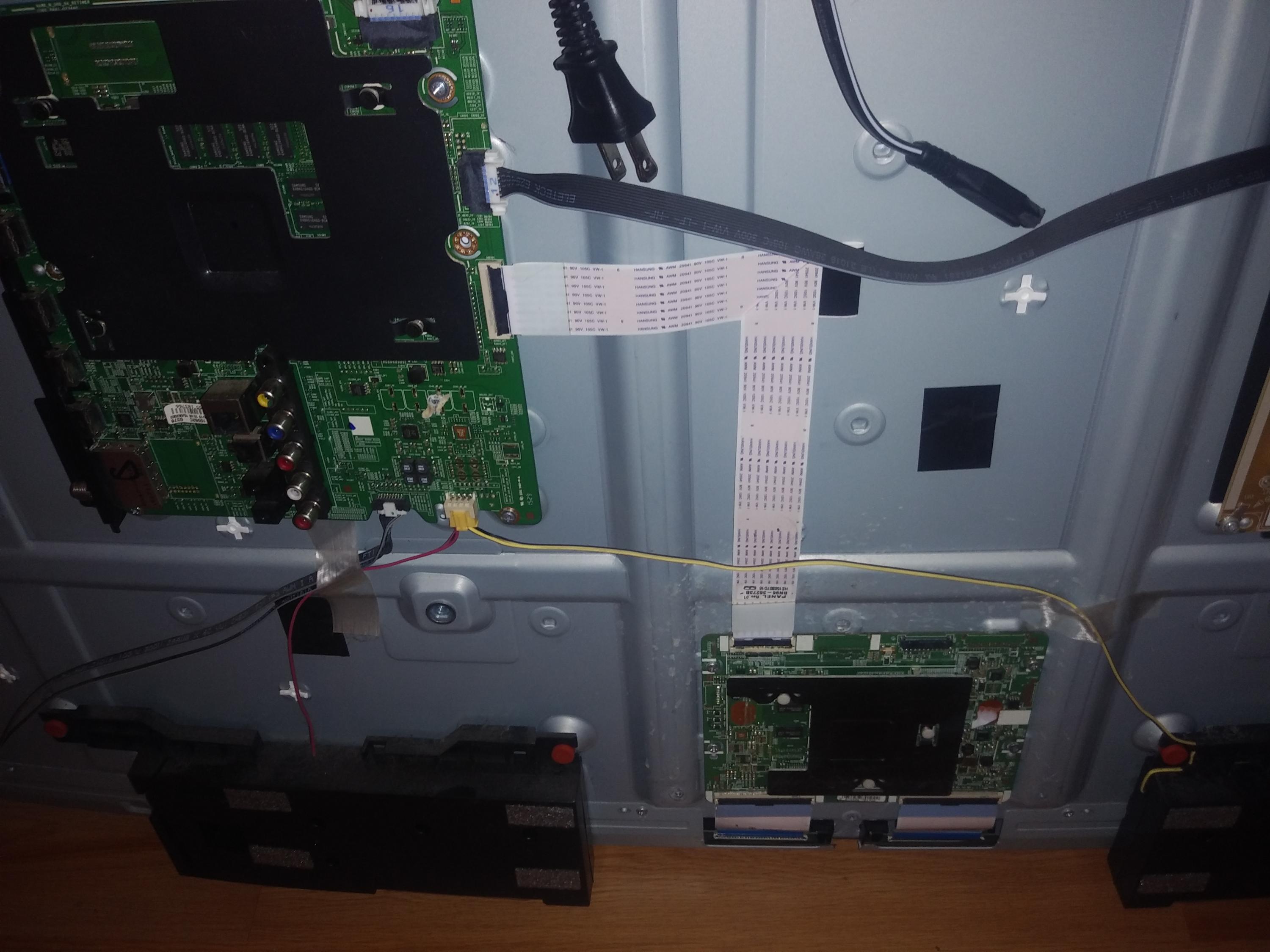

    Hey guys,
    I have a Samsung un55ju6700 that will turn on with a picture for about 2 minutes, then I get a green screen. Next I hear some clicking on one of the boards then the backlights shut off. If I disconnect the LVDS cable from the t-con, the backlights stay on with no problem. I tried disconnecting the panel then connecting the t-con to see if backlights stay on. Backlights shut off anytime t-con is put into the circuit whether or not the panel is connected. Anyone have a similar problem?

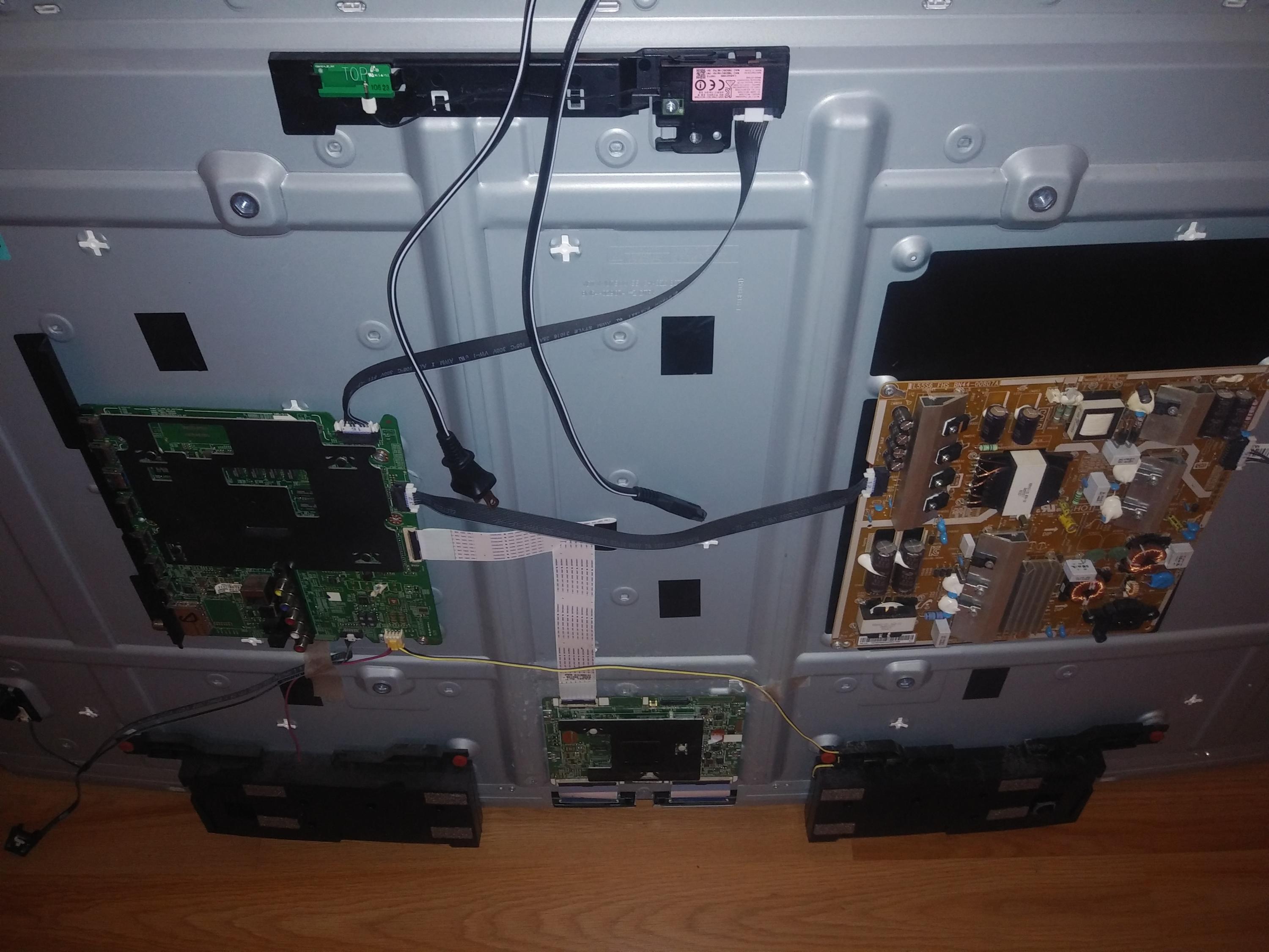

      You will get a lot more help if you upload good clear pictures of the whole backside of the TV showing all the boards and how they are connected together, that will be the starting point so we can see what we are dealing with.

        Re: Samsung UN55JU6700
        Pics of the board alignment is attached, I'm thinking t-con but don't want to guess. I checked the t-con fuse, it is good!
