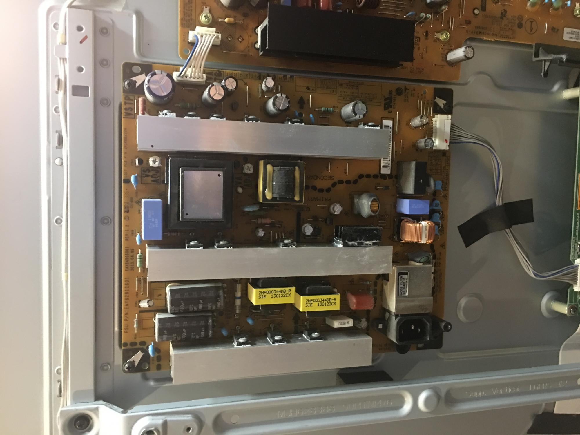

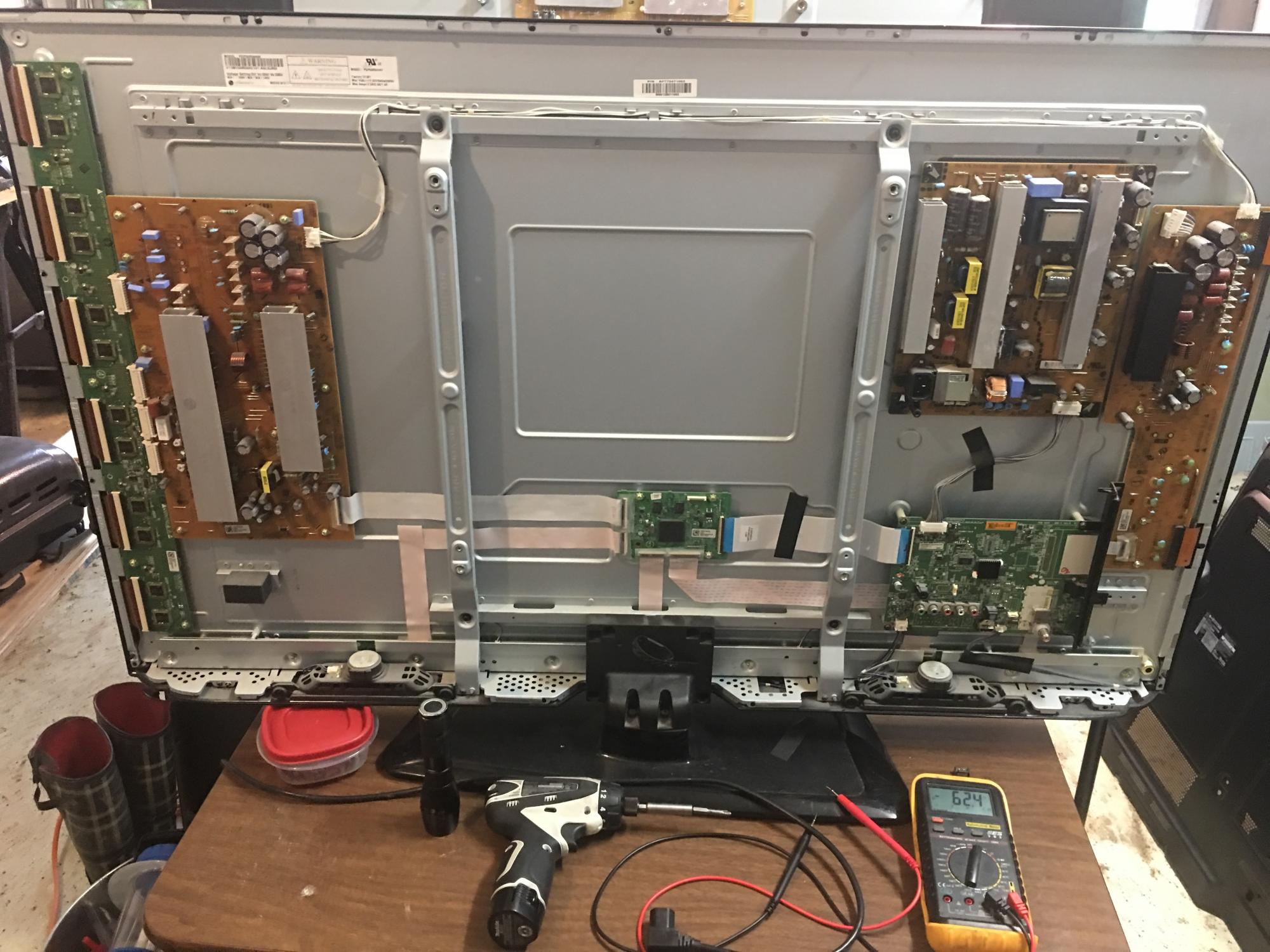

    I was asked to take a look at this tv by a friend because it just stopped coming on, all of the sudden. It is a 50PN6500. Once I got the back off I did notice there is an hdmi port that came off the board. I saw another post where same issue but he had a resistor that came off. This boards resistor is still there and appears just hdmi port affected. The owner said it continued to work long after the port was knocked loose. When power applied to set the red light on the front comes on but buttons and remote do nothing.

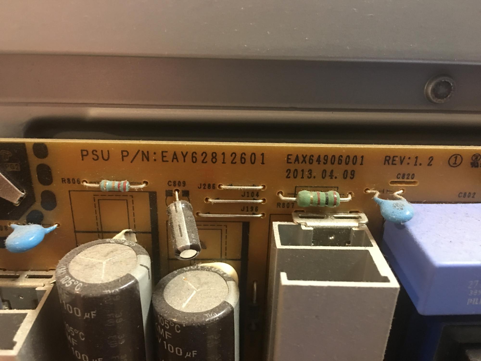

    Power board number is EAY62812601 - EAX64906001 REV:1.2

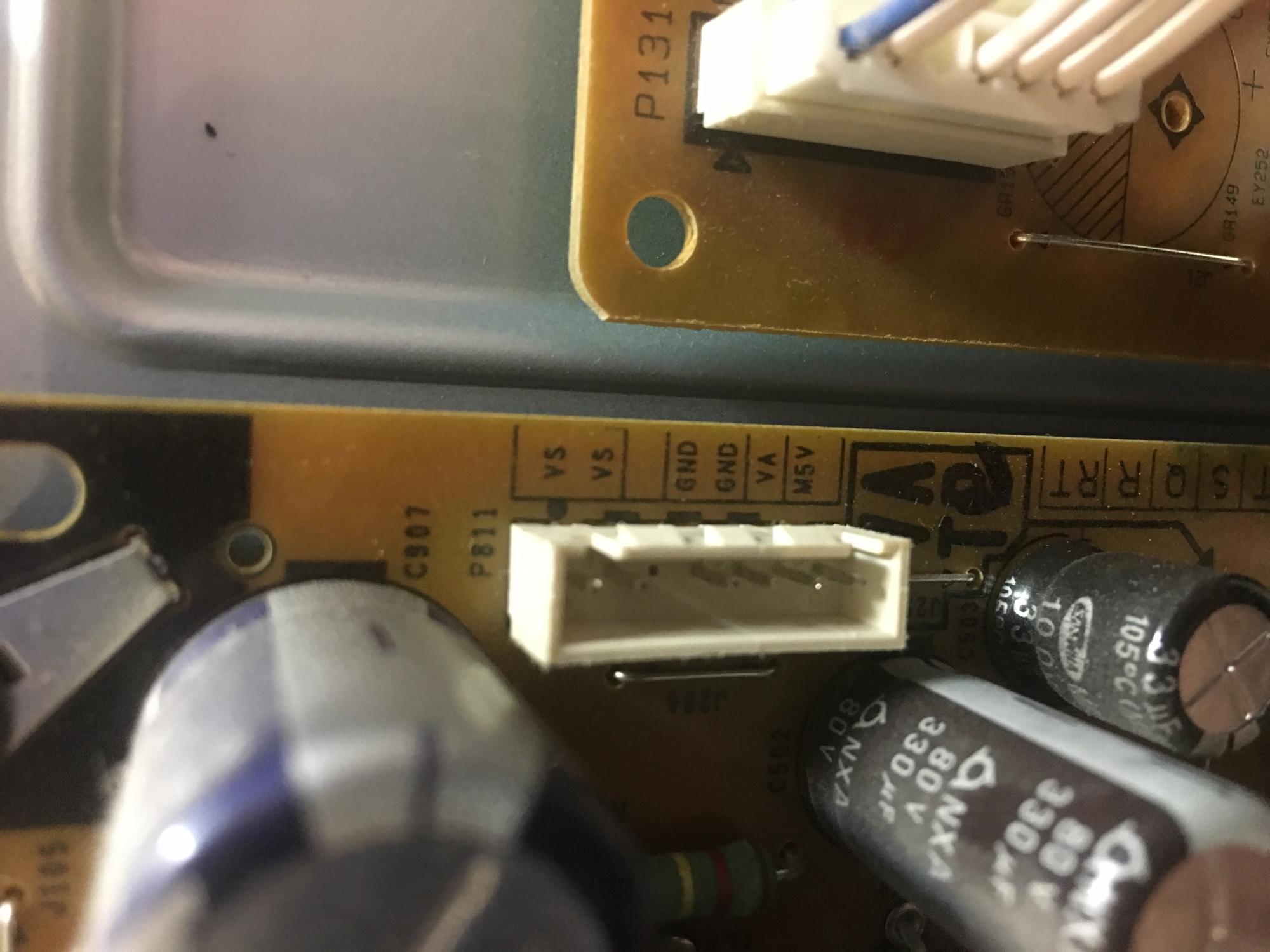

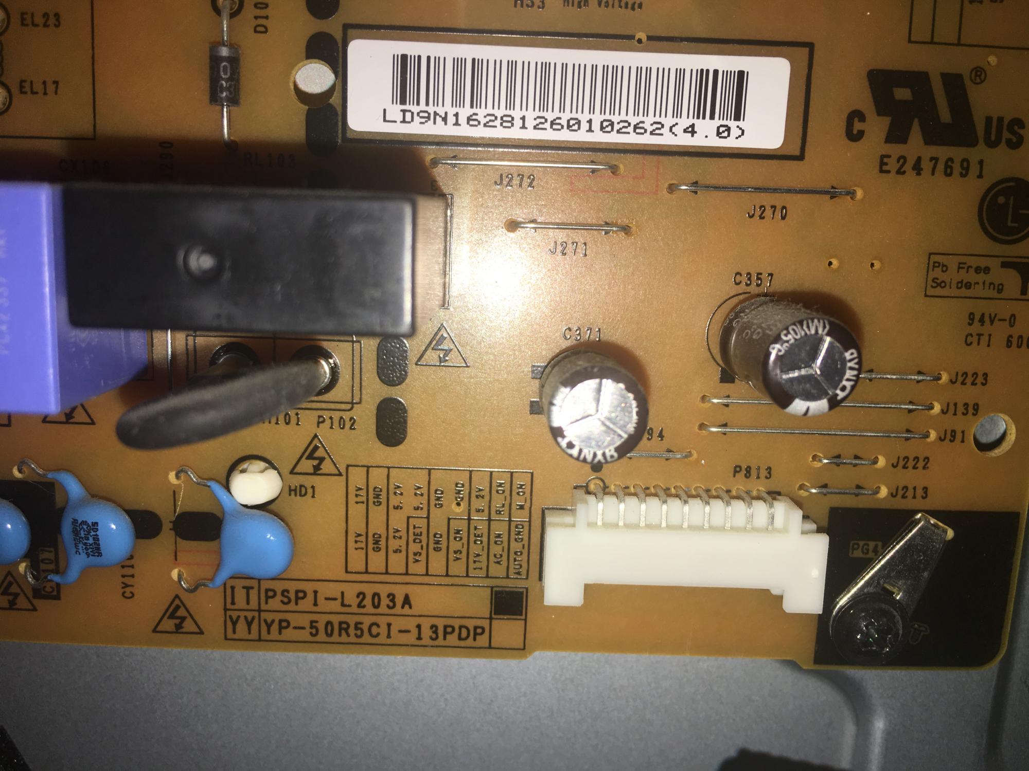

    There is no stand by voltage at connector P811 (to Zsus) or P813(to main)
    At main fuse I get 60volts either side.
    Control board has an LED on it but does not light up.
    Any help with diagnosing this one further?
