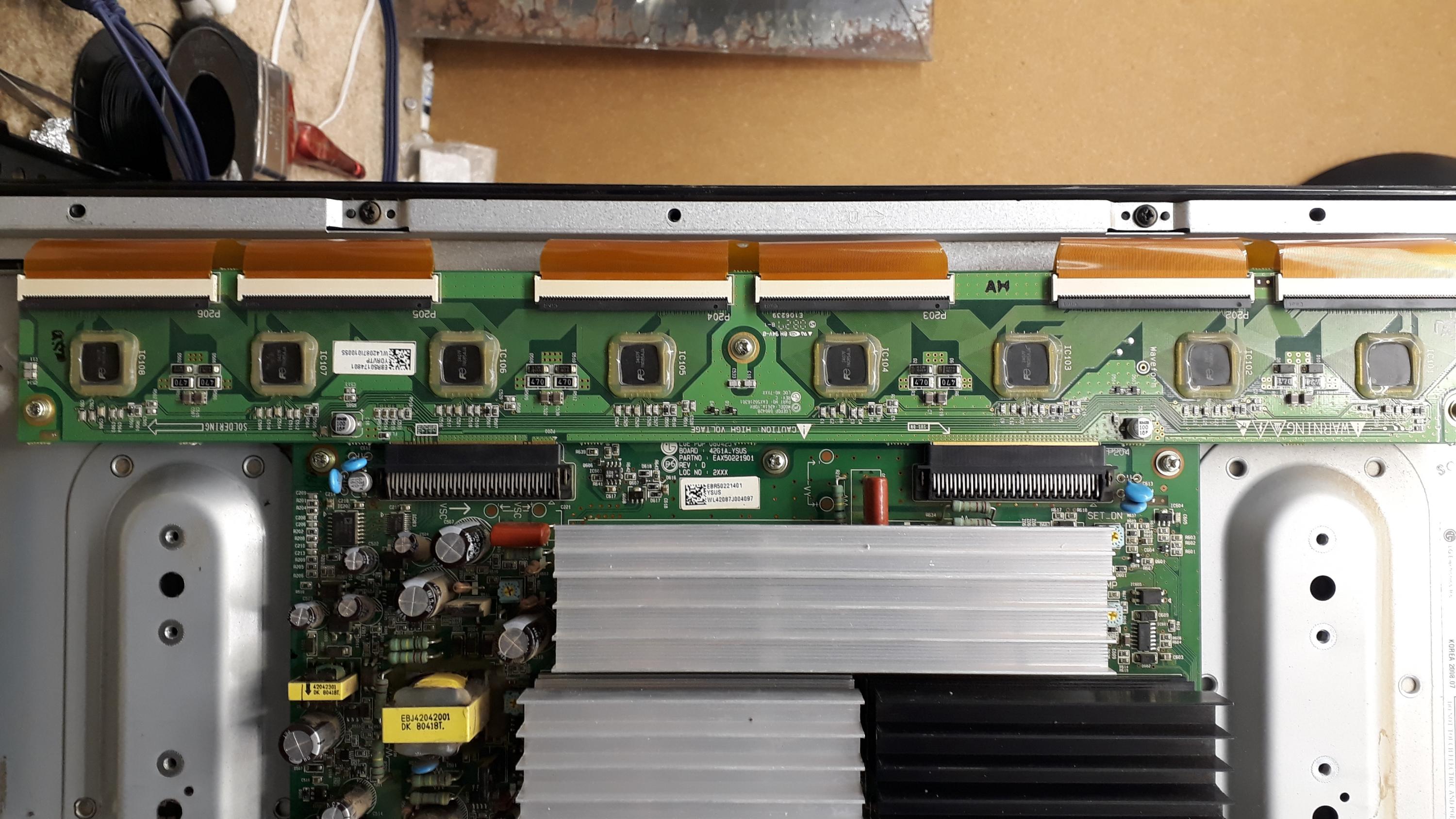

    When starting this TV you hear a click and Vs and Va come up as per plasma label but there is no pre-charge and no picture. As a matter of fact the Y-SUS and Z SUS boards are not getting the slightest heat on the heat sinks meaning they are not being driven at all.

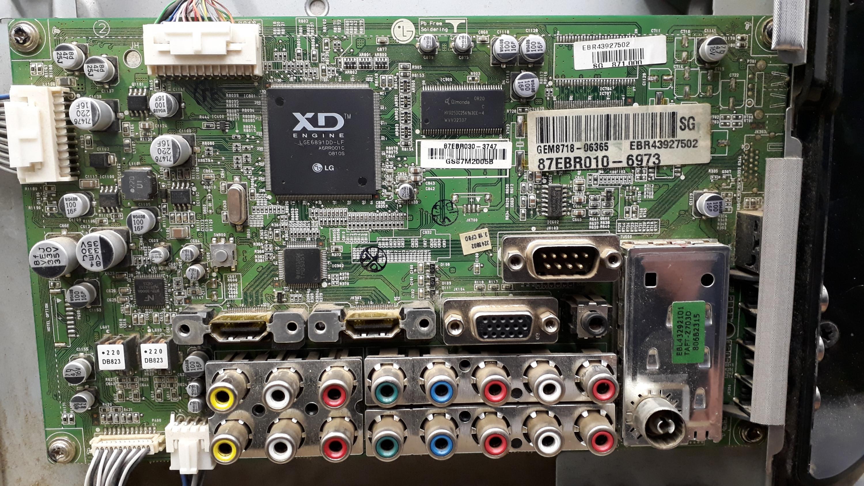

    The led on front panel shows TV is in the on state and when I press vol+ or Vol- the standby light flickers indicating that the main is at some extent operating.
    At this point i can suspect any board especially the logic control board which has only one green light with the other two being off or perhaps something wrong with the main board.

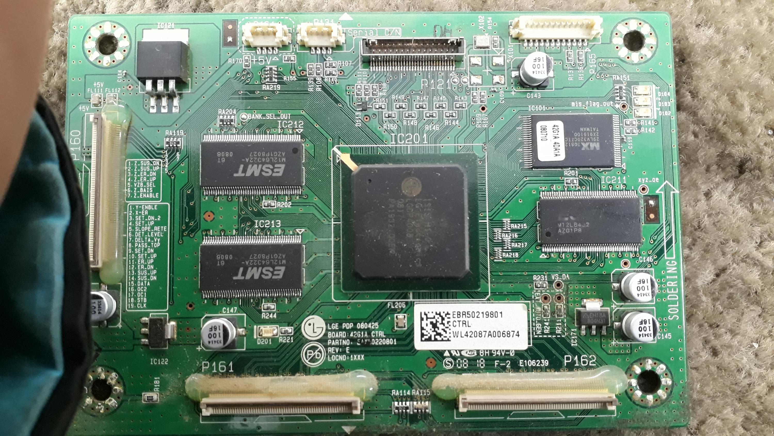

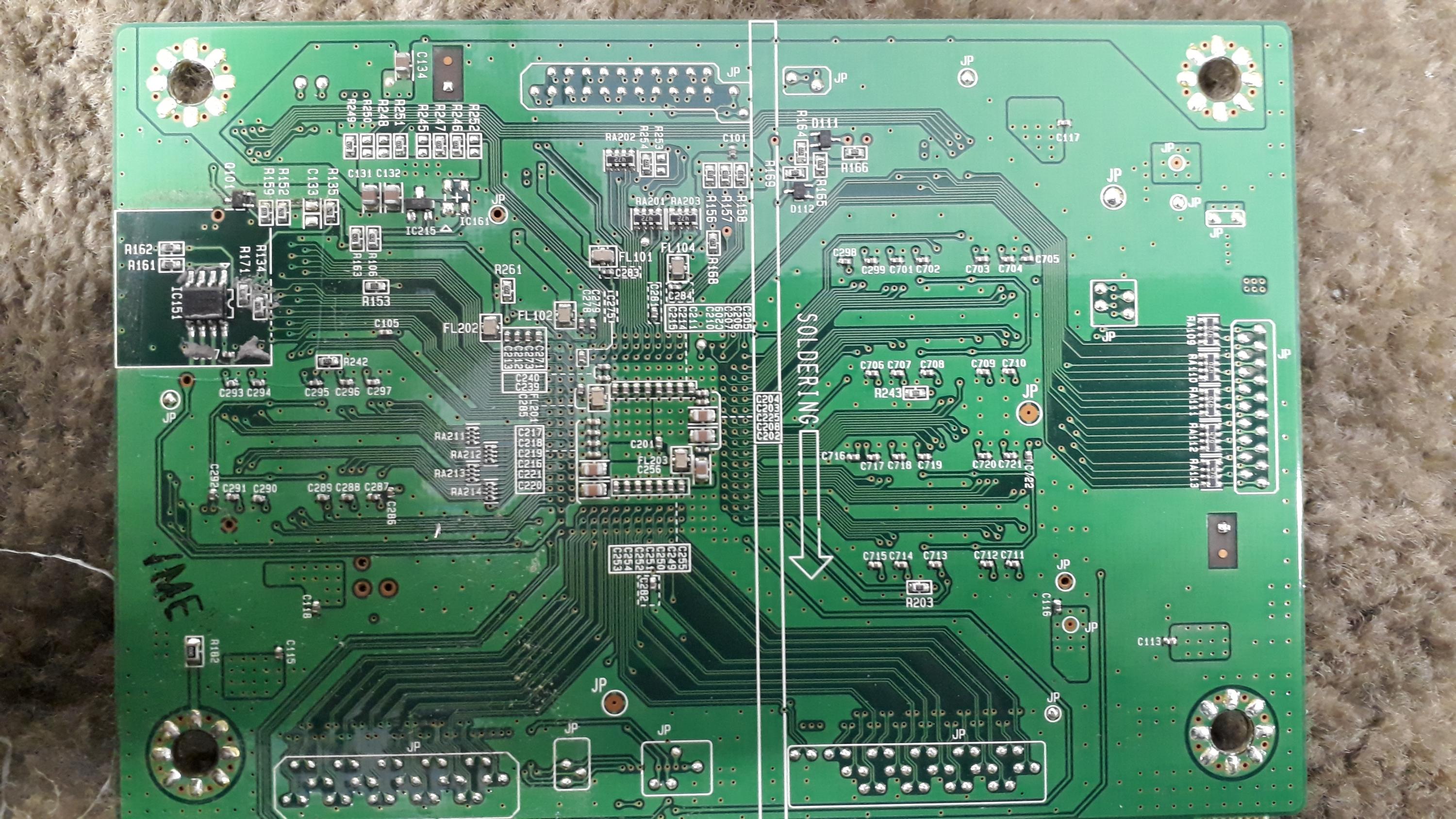

    A photo of the logic board, there are usually a couple of holes that are bridged for the test pattern.

          Re: LG 42" Plasma Model 42PG20R-AFB (No picture)
          Here are the picture of both sides of the logic board as discussed.
            Just to the right of the sticker, EXT_AUTO_GEN.
              Great. I will bridge the two pins and see what happens...
              • tvtimmy
                • Mar 2015
                • 1160
                • usa
                You also have to unplug the ribbon cable from the mainboard to the logic control board.
                    Ok, i shorted the auto gen pins and removed the LVDS cable to the logic board. Switched on set and nothing still no panel drive.
                    Where do i go from here? I measure no shorts on Vs, Va etc. Those mosfets i tested all had no shorts on their pins.

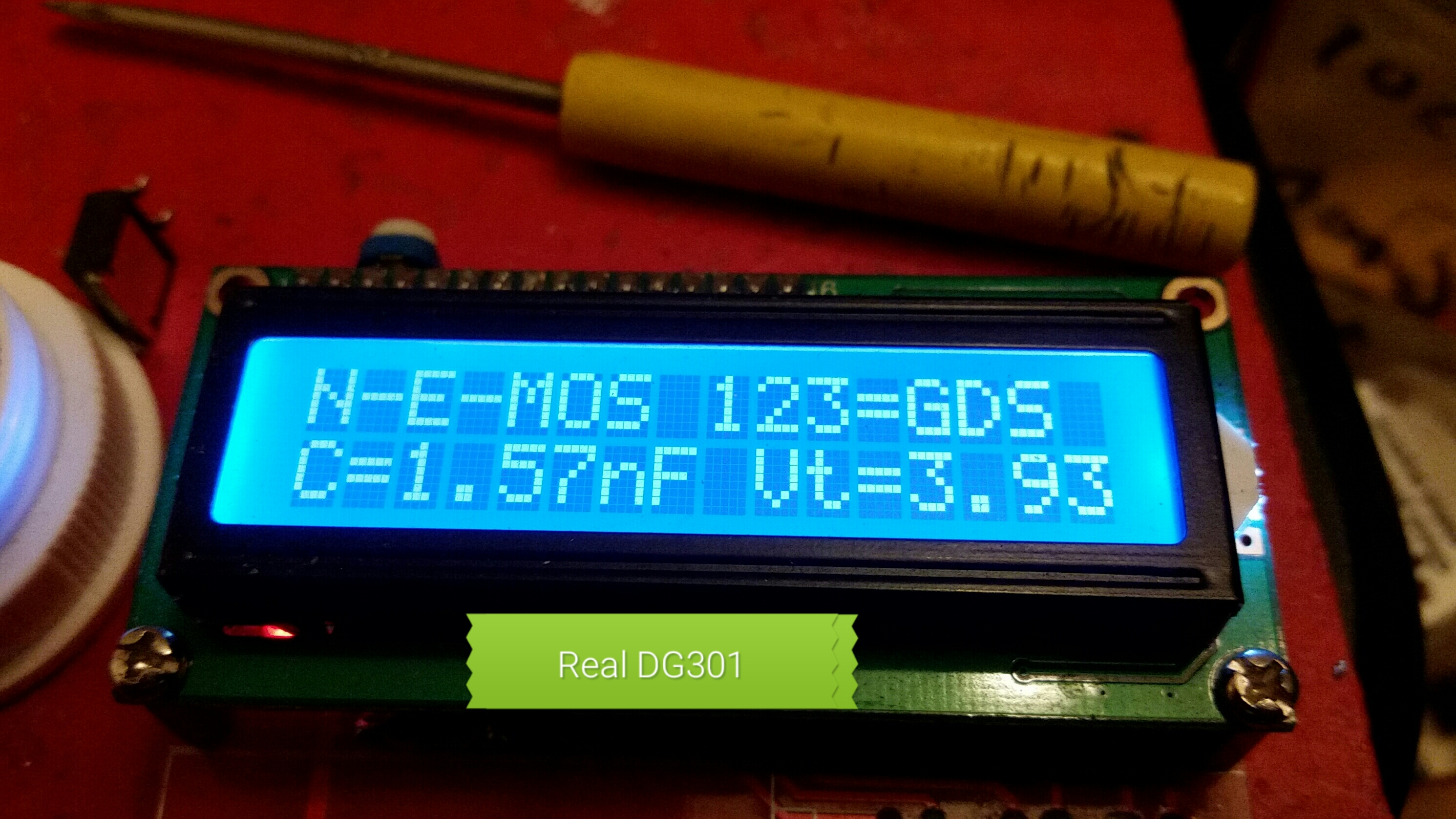

                        Have you had an igbt go open circuit? How do we test those since some transistors do not get triggered by the small voltage the multi metet produces or am i wrong?
                        • tvtimmy
                          • Mar 2015
                          • 1160
                          • usa

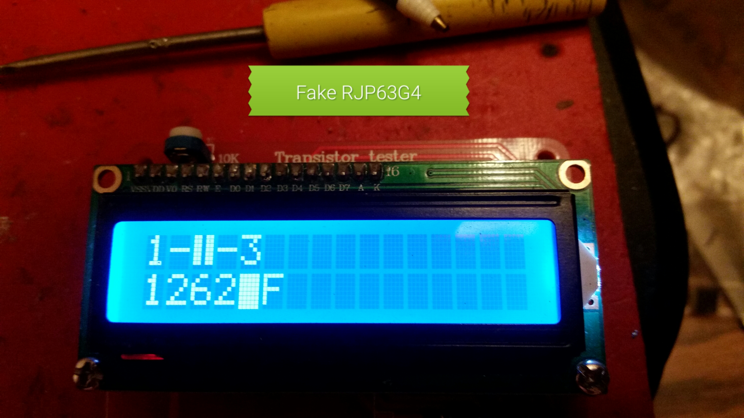

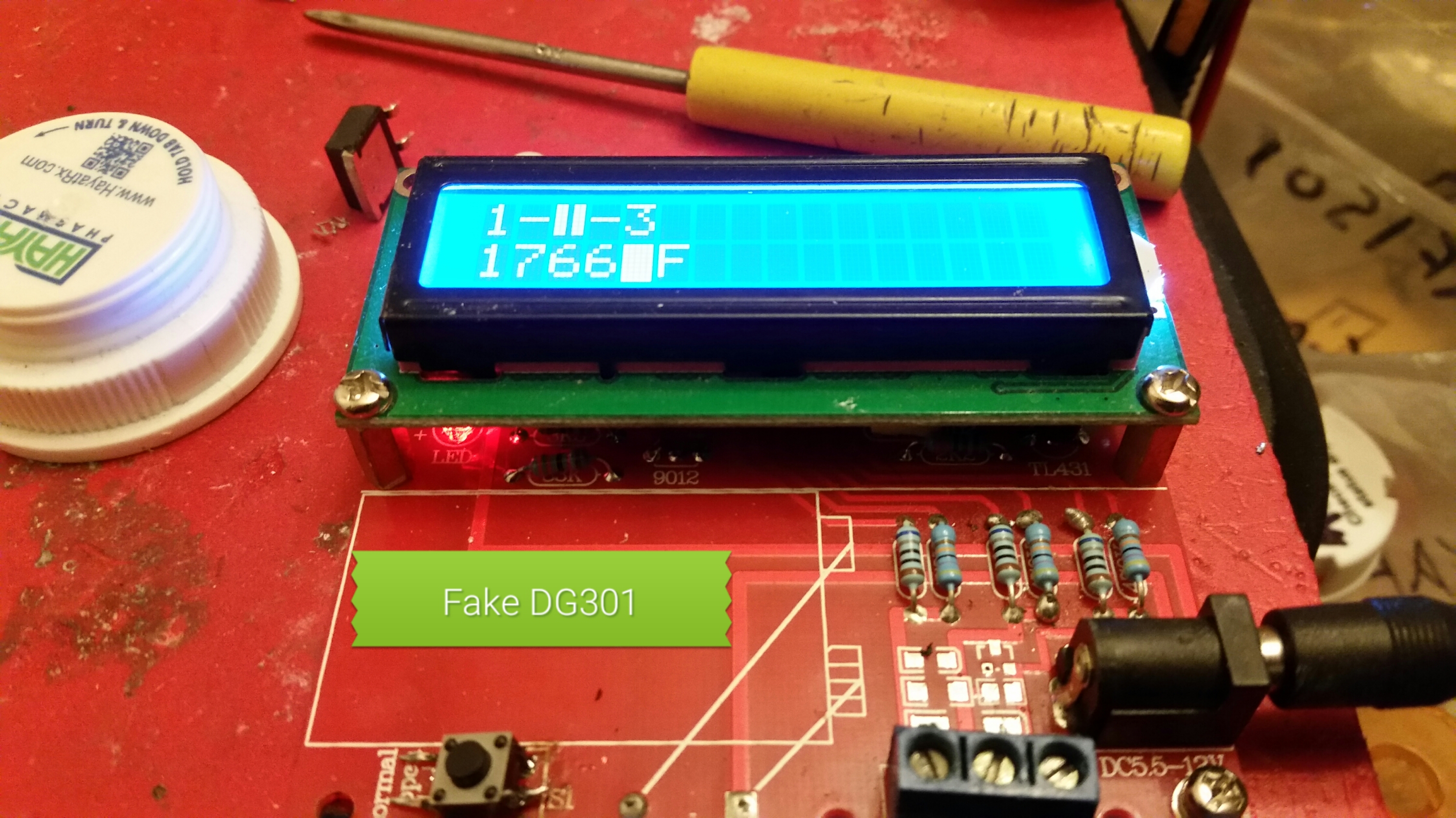

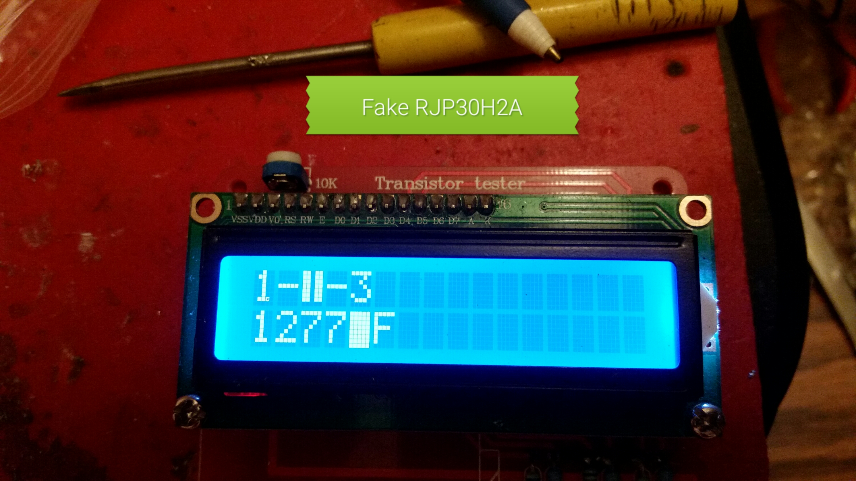

                          Yes, I have. I have a cheap transistor tester that I use, after testing with my DMM. See pics.
                          Sometimes original bad igbt's read like this too.
