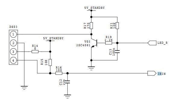

    Hello All!
    Would anyone have a schematic/service manual for an insignia ns-50d550na15 ?
    I have some wires detached from the infrared sensor plug and need to identify their locations to reattach.
    Many Thanks

    Re: insignia ns-50d550na15
    Does this help ?
      Originally posted by diif
      Does this help ?
      That should work.
        Thank You
