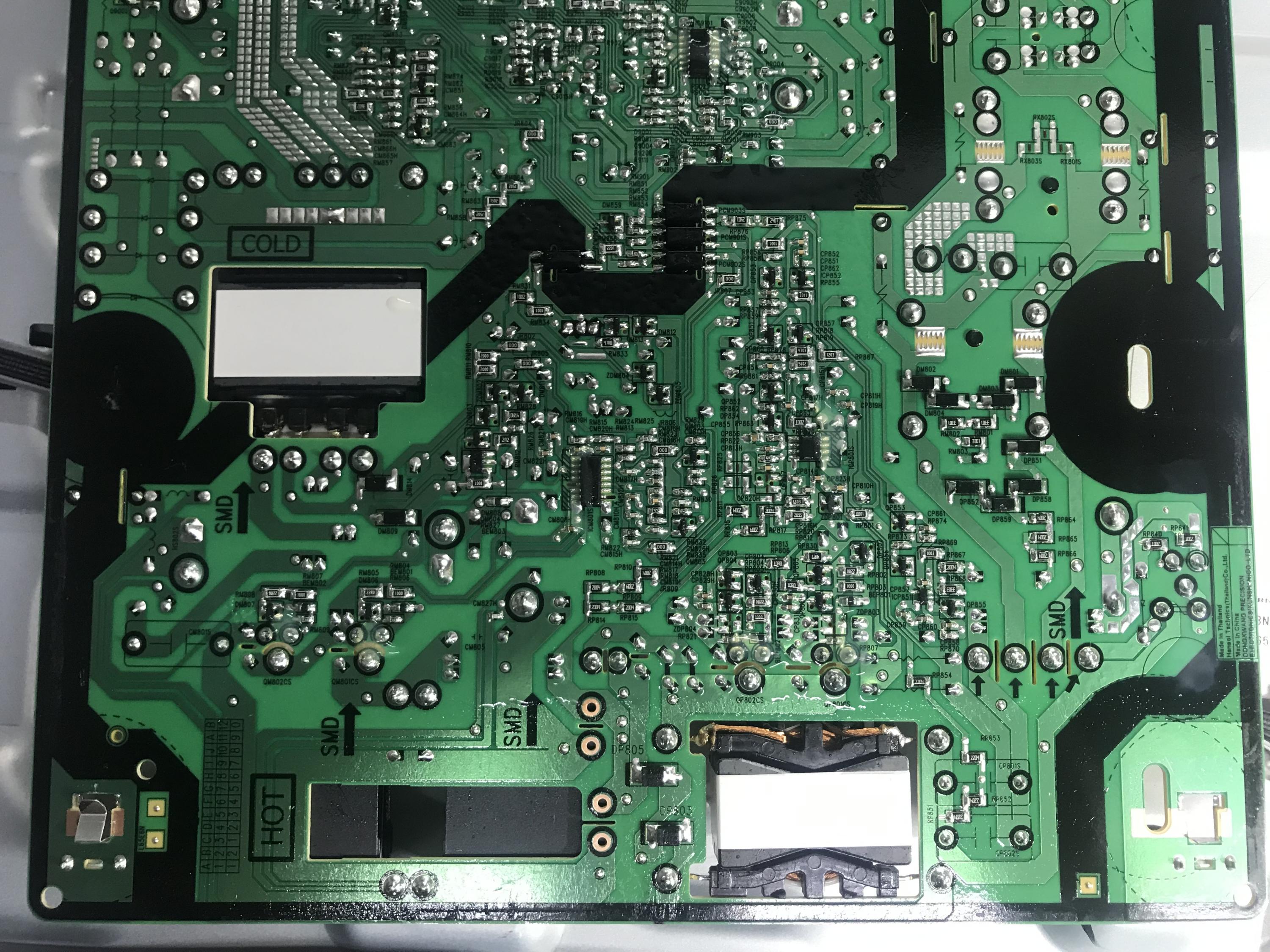

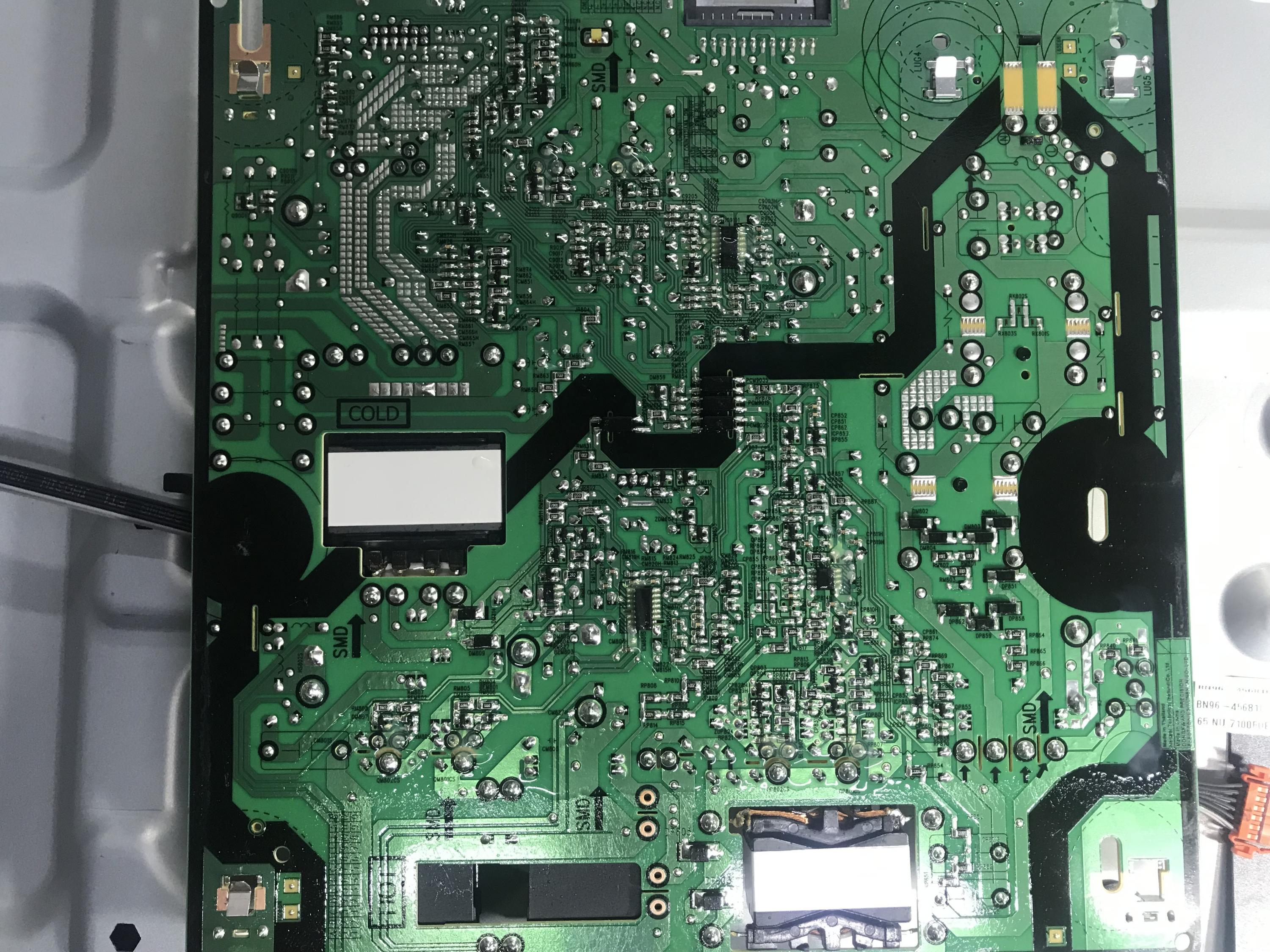

            it look bad news.. but let do this..
            plug it out from wall socket.. and plug the LVDS only from MB side.
            take out the PWB out. and the MB too. discharge all Caps on the PWB start from hot area the main big caps and to the cold area.. all caps.. by shorting the pins pf caps +&-

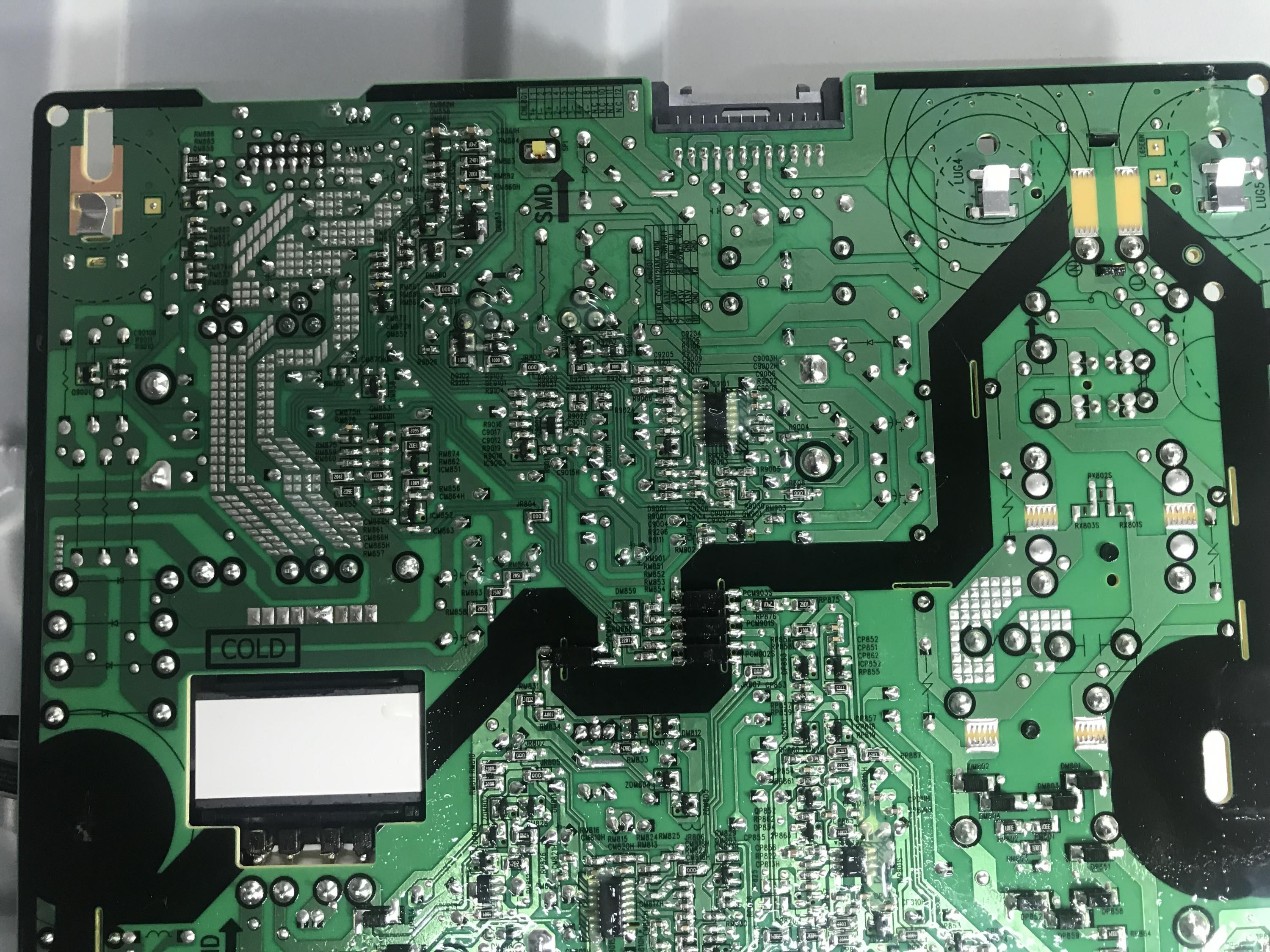

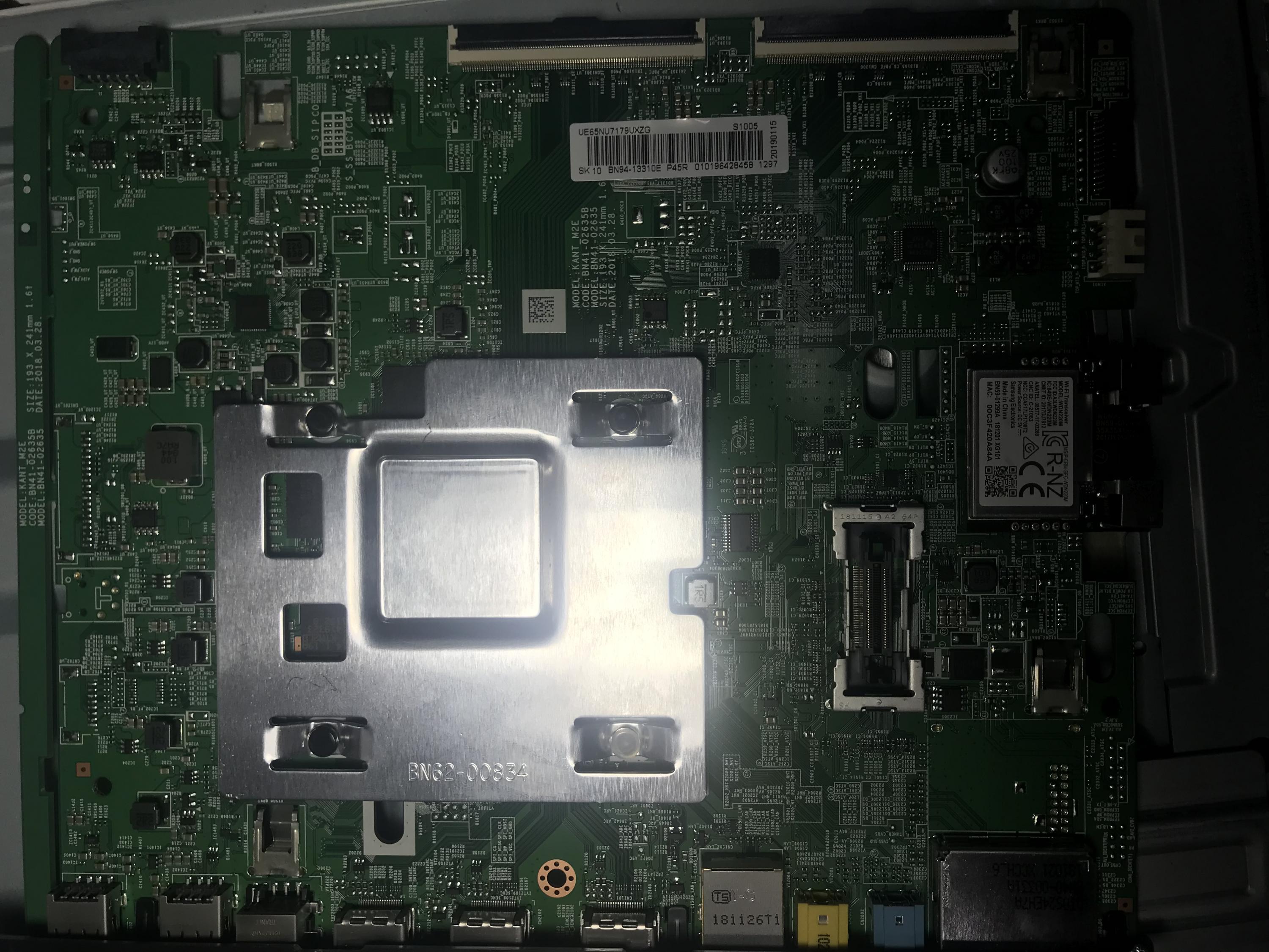

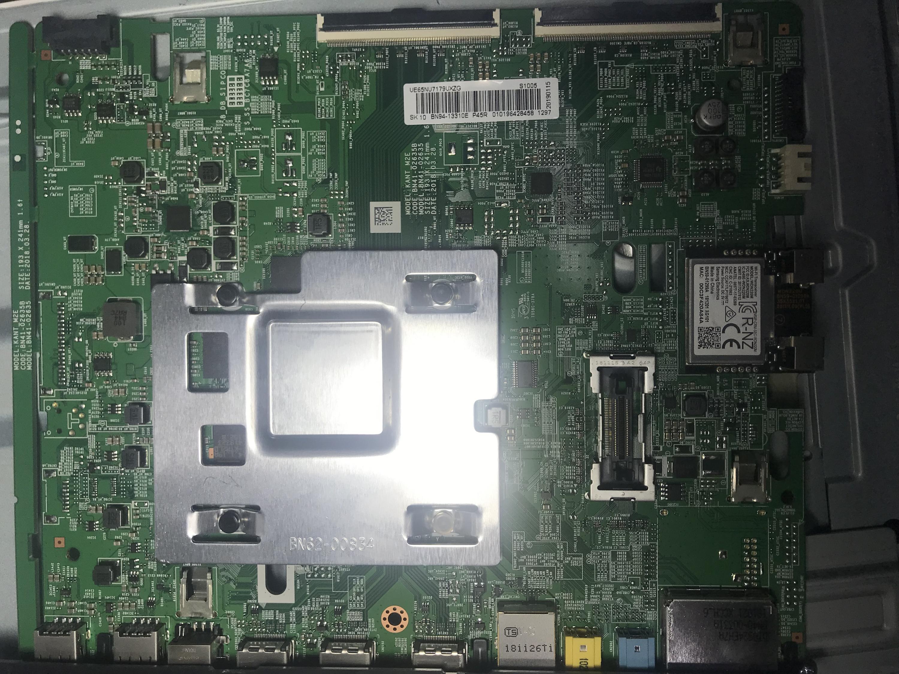

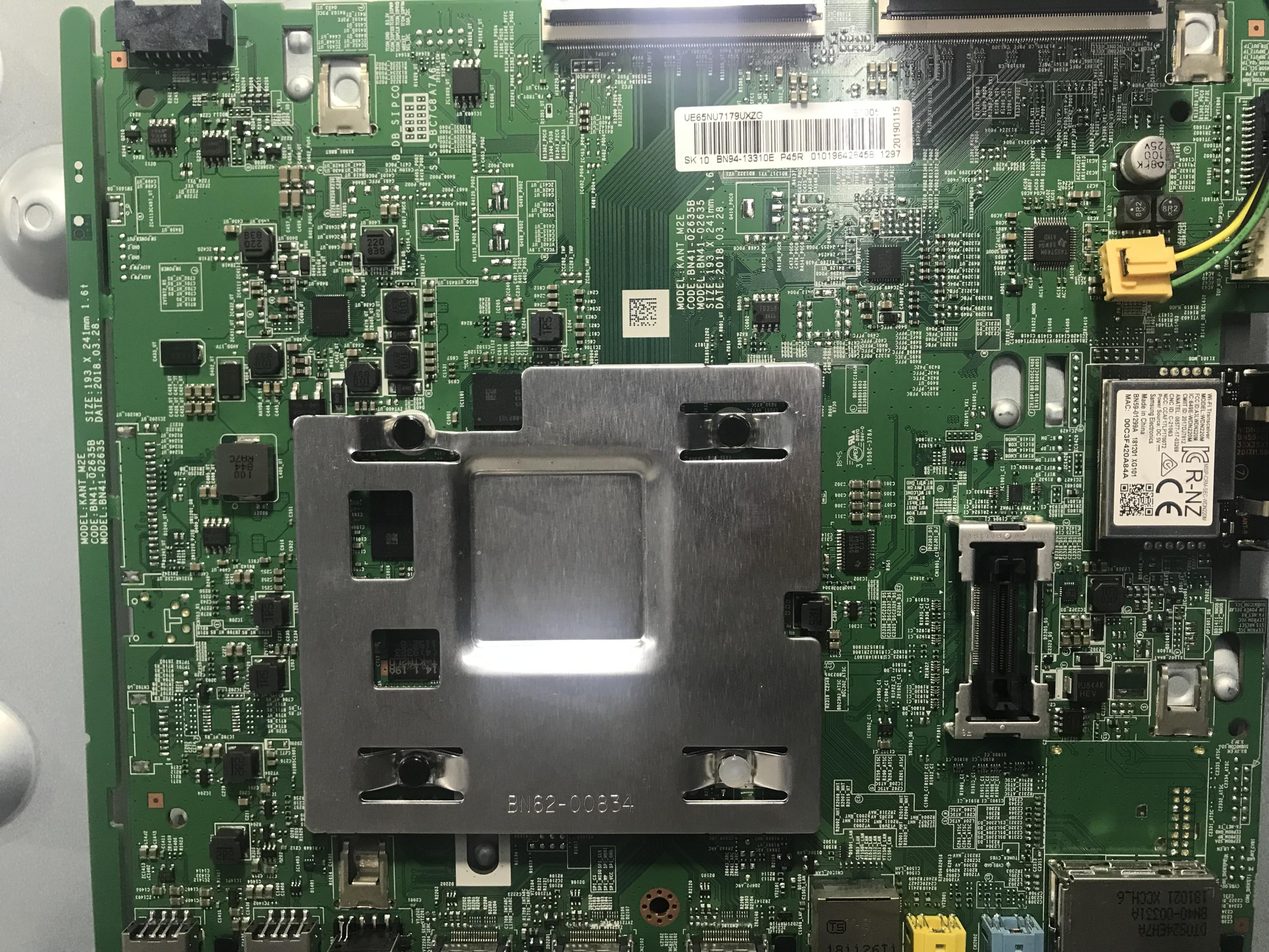

            also please post clear high resolution photo on the MB of the down side. waiting for your photo and the discharge process

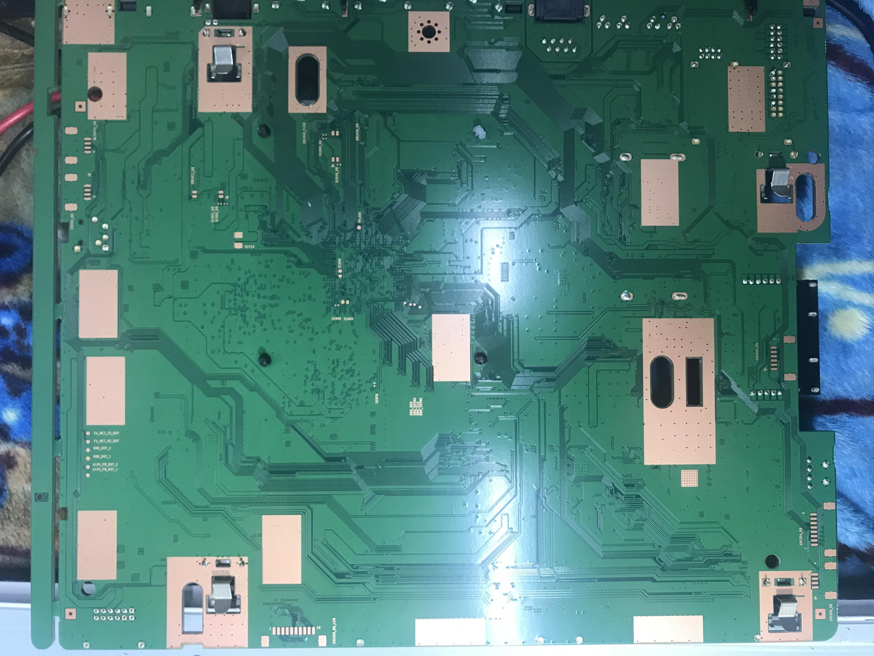

              Re: Samsung 65MU7350 problem
              i did as you told me discharge cap and connect main board TV switched on and stay on and can here sound but no picture , when switch off then on by remote its back to repeat booting
              forum reduce resolution
