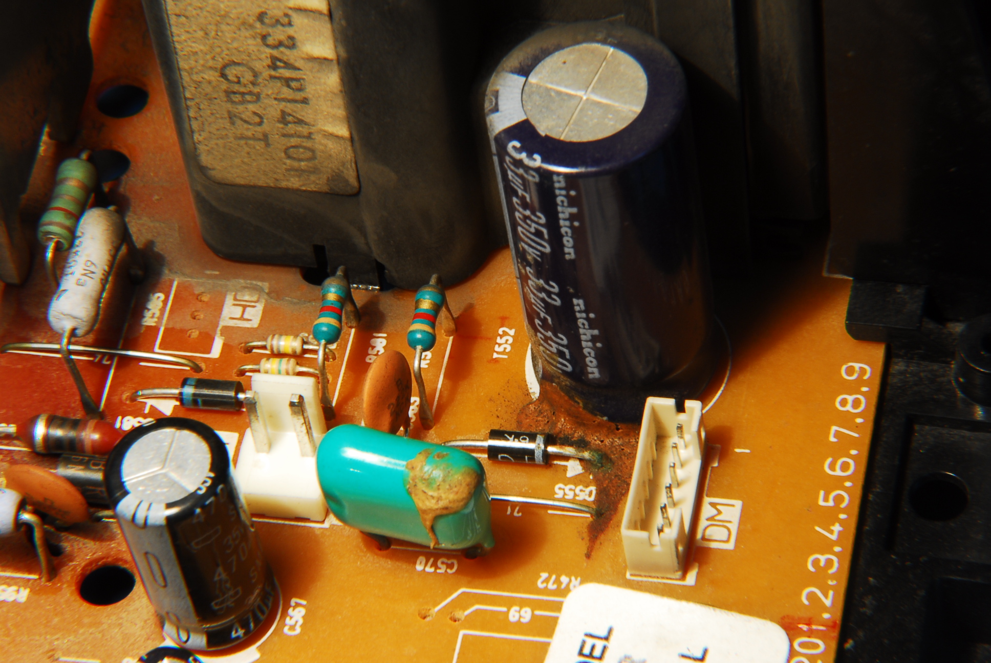

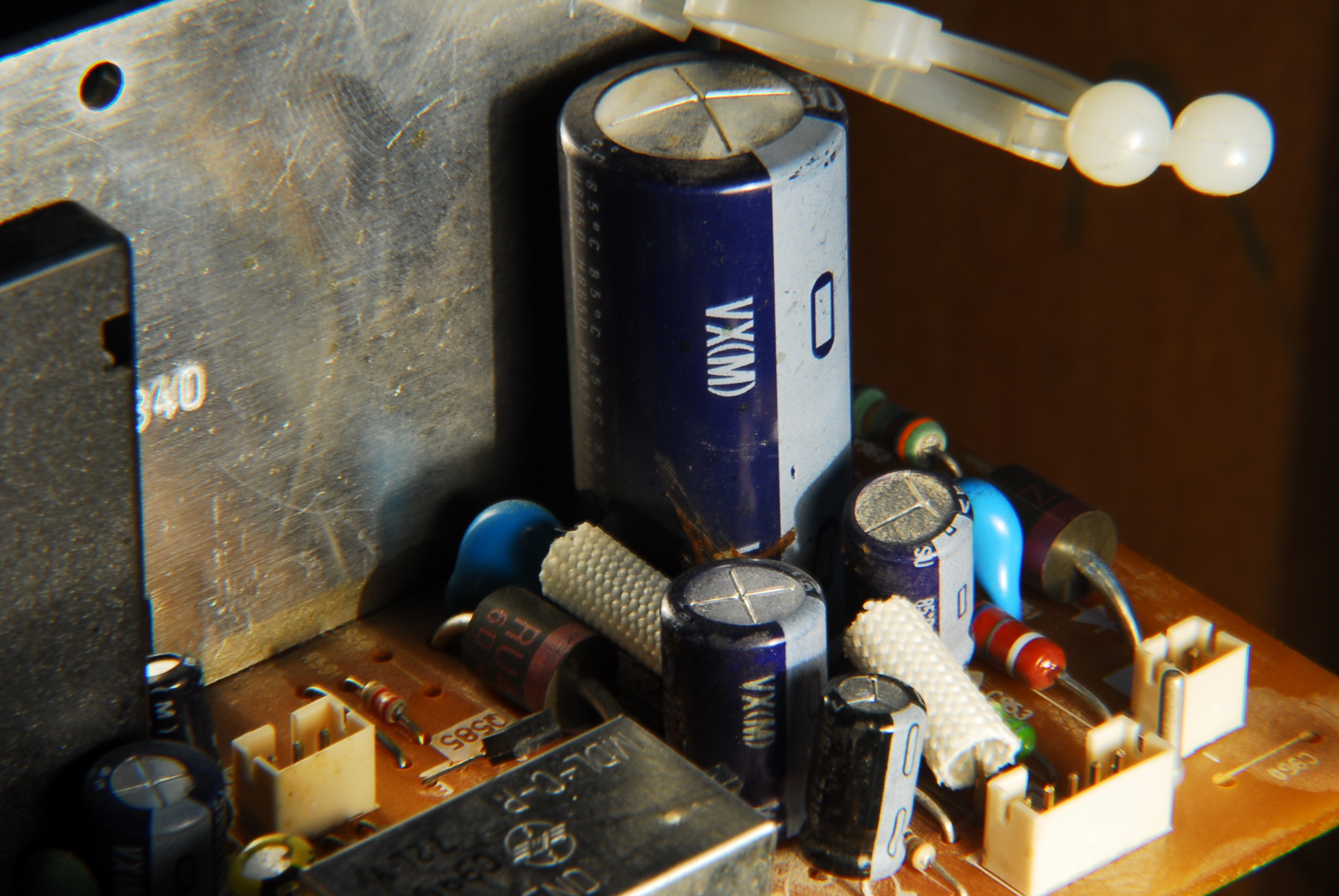

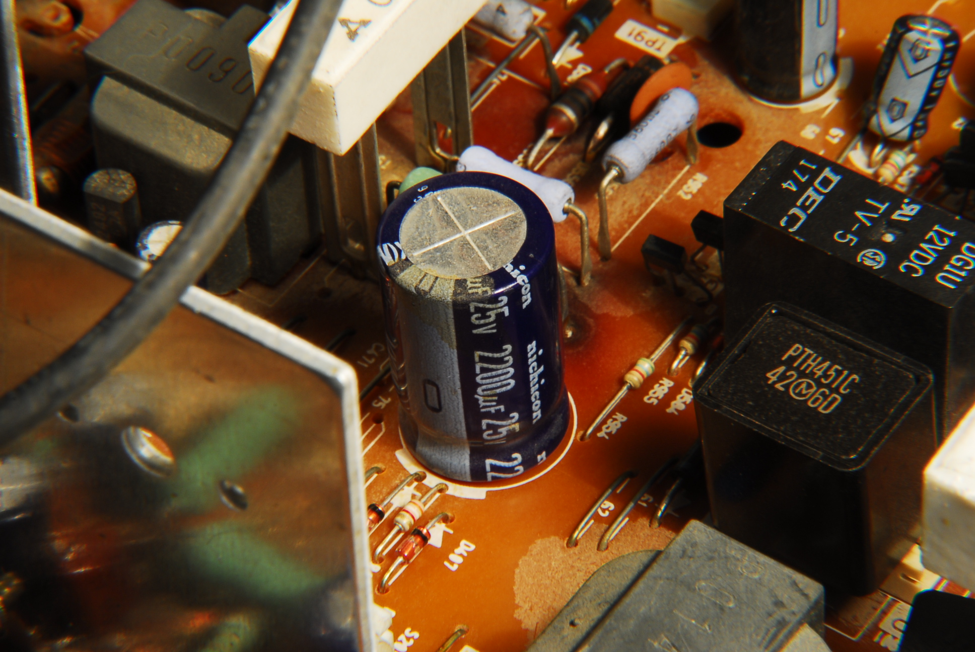

    I have two of these TV sets. Identical model. One was given to me by a client, the other I bought new in 1987. Mfg date is May, 1987.
    Both have bad caps: Nichicon 50v/2200uF.
    There are two main boards in each TV. One 50/2200 on each board.
    One TV has the 1st cap bad, the other TV has the 2nd cap bad. Bulged.
    I don't know squat about TV servicing other than lethal voltages are present, so I will take both to a local shop for service. I'm curious as to how the TV tech will take me pointing out the bad caps. I will also specify that premium replacements will be installed.

    I decided to not be a chickenshit, and recap these boards myself.
    The OEM caps are VX series radial.
    Funny thing is, the only VX data sheets I have are for the axial series. Go figure.
    Mouser offered the choice of LXV or Panasonic FC. I chose the FC series.
    Both have higher ripple specs than the installed VX, so I figure to be OK.

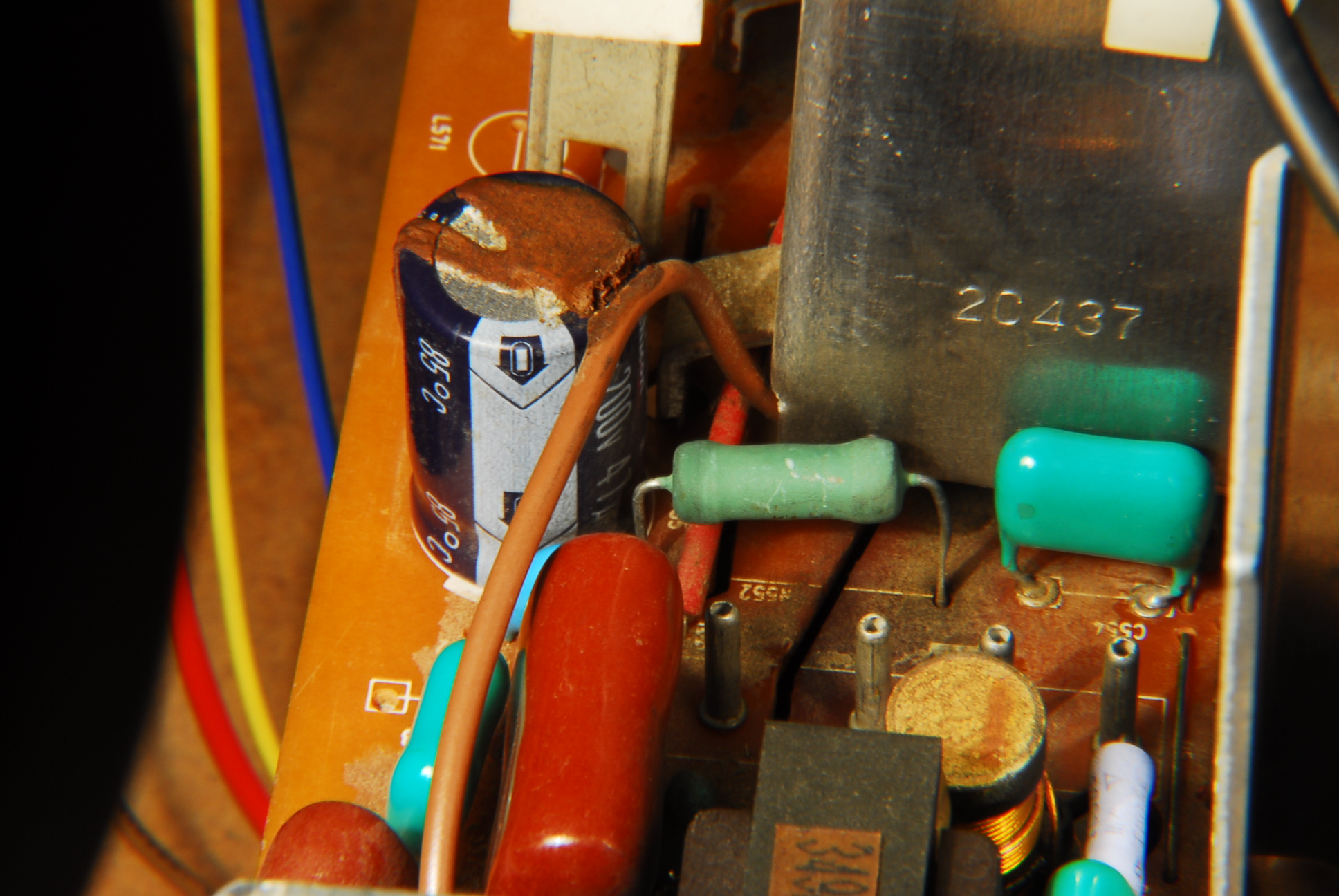

                    I pulled the board as much as I could for inventory and photos.
                    I don't know how to separate the HVPS from the rubber boot at the CRT, so I left it connected. It's probably simple, but I don't want to screw something up.
                    There are a lot more bad caps on this board than the one I could see at first.
                    A number of these have barfed up their brown guts.
                    I looked closely at the board surface, and see numerous trails that look like moisture trails or leaks.
                    I'm wondering if the whole board is fucked up...
                    Considering the price of a new set, I supposed I can invest in a recap first.
                    Photos enclosed. I have 21 hi-res photos in the parent directory.

                      Re: Bad Caps in Mitsubishi CK-2690R TV
                      much of that is glue.
                      the dead giveaway is the bad ones will stink when you desolder them.

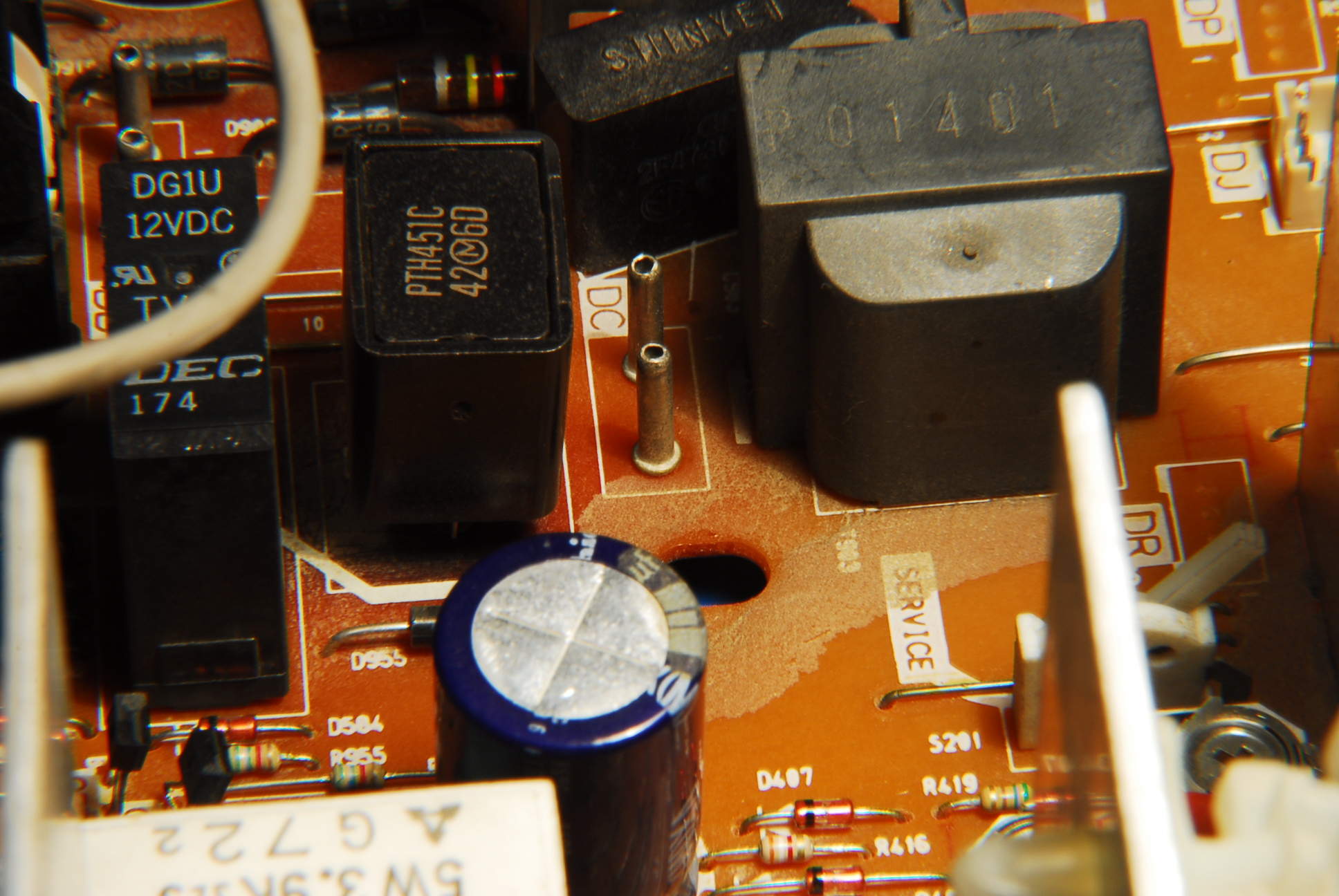

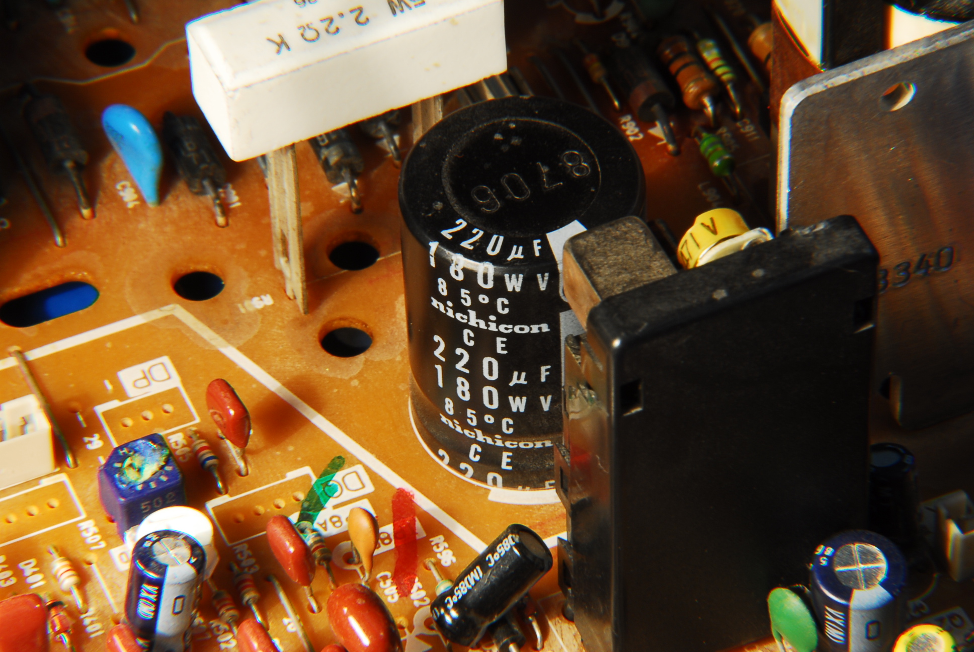

                                  Brown goo
                                  Is the brown goo above glue or cap puke? One of those caps is bulged at the top, so I know it is bad.
                                  I chased it through the schematic, and found it has a 50/2200 mate on the other board. I will replace them both.
                                  I've inspected the board pretty carefully and only find a bit of evidence that indicates a cap leak. A few have film on the surface, so I will replace them also. I really don't want to replace a hundred caps unless I have to.
                                  What I don't know about is the black can cap . Somebody made a comment about "fish cans." Are these what you mean?
                                    The brown goo is GLUE. Used to be tan, age and heat turned these brown and *corrosive* and short circuiting where you don't expect. Scrape those off.
                                    On capacitors topic:
                                    We're talking about *small* capacitors scattered across the all boards. .47uF, 1uF, 4.7uF, 10uF, 22uF, 47uF. I also often find bad 100uF (usually found in vertical amp circuit) 220uF, 330uF, 470uF, and 1,000uF are not as problem unless you find "dark stain" around them on PCB and stink up when heating the solder joints.
                                    You are still focusing on power/deflection section which is good but we do want you to investigate rest of the boards with simple checks. Heating solder joints for these after mentioned small caps will alert you to the stink!
                                    Oh yes, Mitsubishi chassis is also full of bad solder. Watch out for that.
                                    The mitsubishi tv I last fixed this year were full of duff and stinking small capacitors for signal paths and processing (audio IC processor uses bunch of caps around it). This was necessary to get audio to sound right (was just doing silent unless I turn up volume then you hear spitting/pops/crackles and video was POOR. After that, MUCH better.)
                                    Audio paths uses small caps in pairs in series and for video stuff on basic tvs that only processes composite video one cap or poly but on decent TVs probably yours uses two capacitors in series in video paths (Y/C) your schematic will show which type of video signal are especially at jungle IC.
                                    Cheers, Wizard
