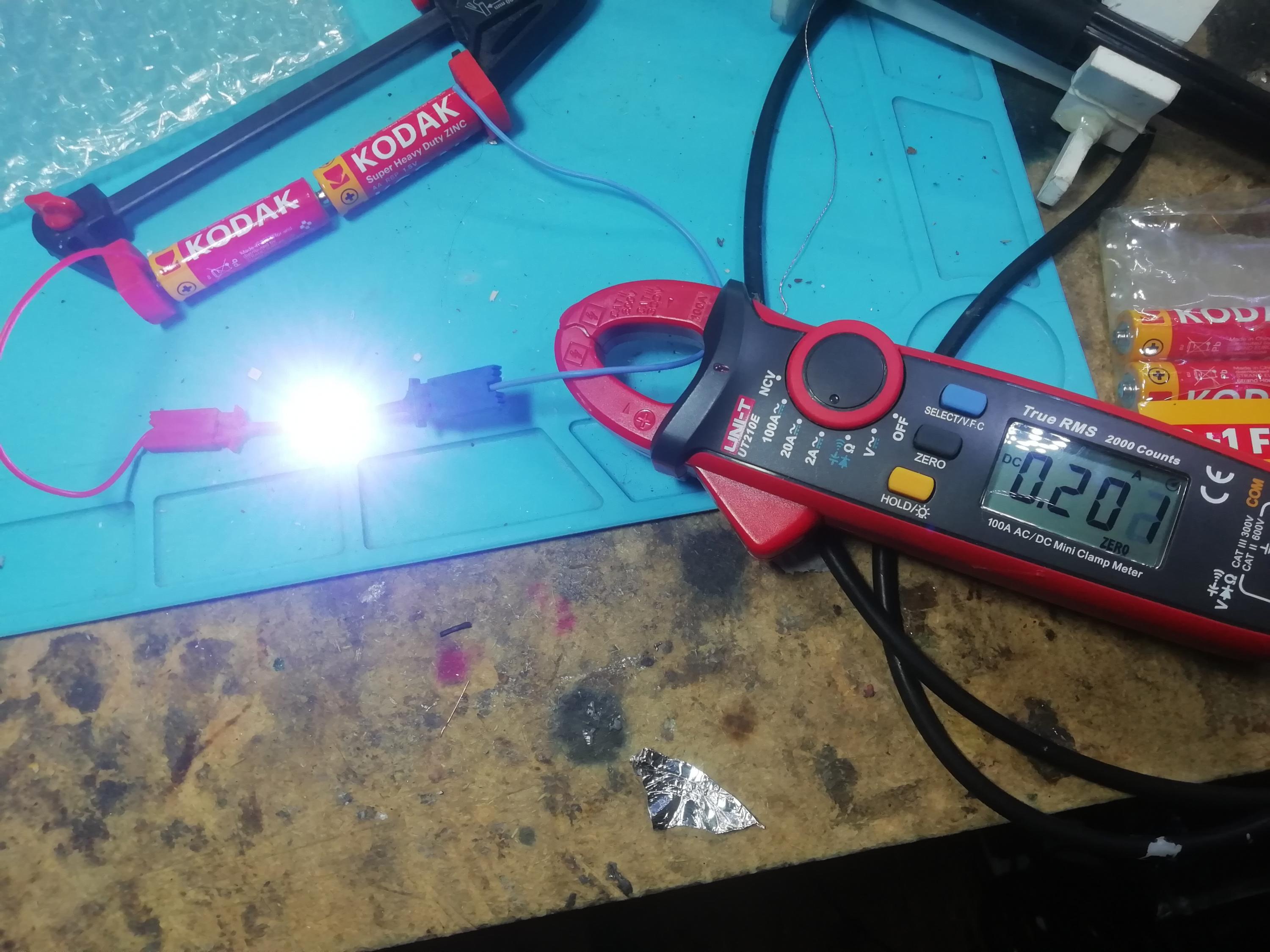

        Re: How to diagnose whether a TV LED is bad (without using an LED tester)?
        Wire two AA batteries (or any 1.5V battery) in series with leads. There are usually bare test points on LED strips near all devices. Just touch the two leads to the test points to see if it lights up.
        Most TV LEDs are 3V devices, but there are 6V devices also. If your make-shift tester doesn't light up any devices, increase the batteries to four in series. You can look at the device with a magnifying glass and usually tell that there are two devices in series in the diode, thus making it a 6V device.

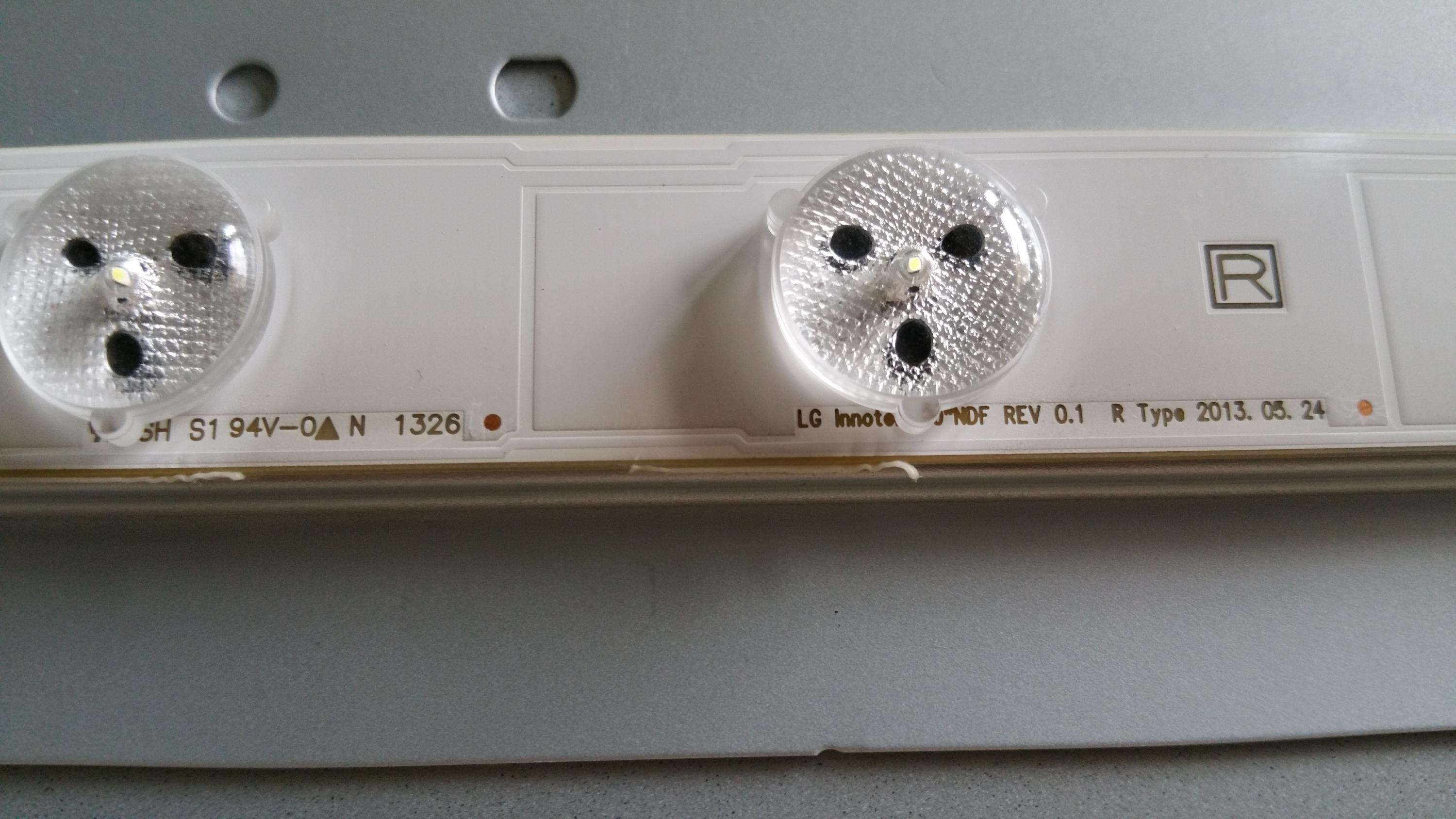

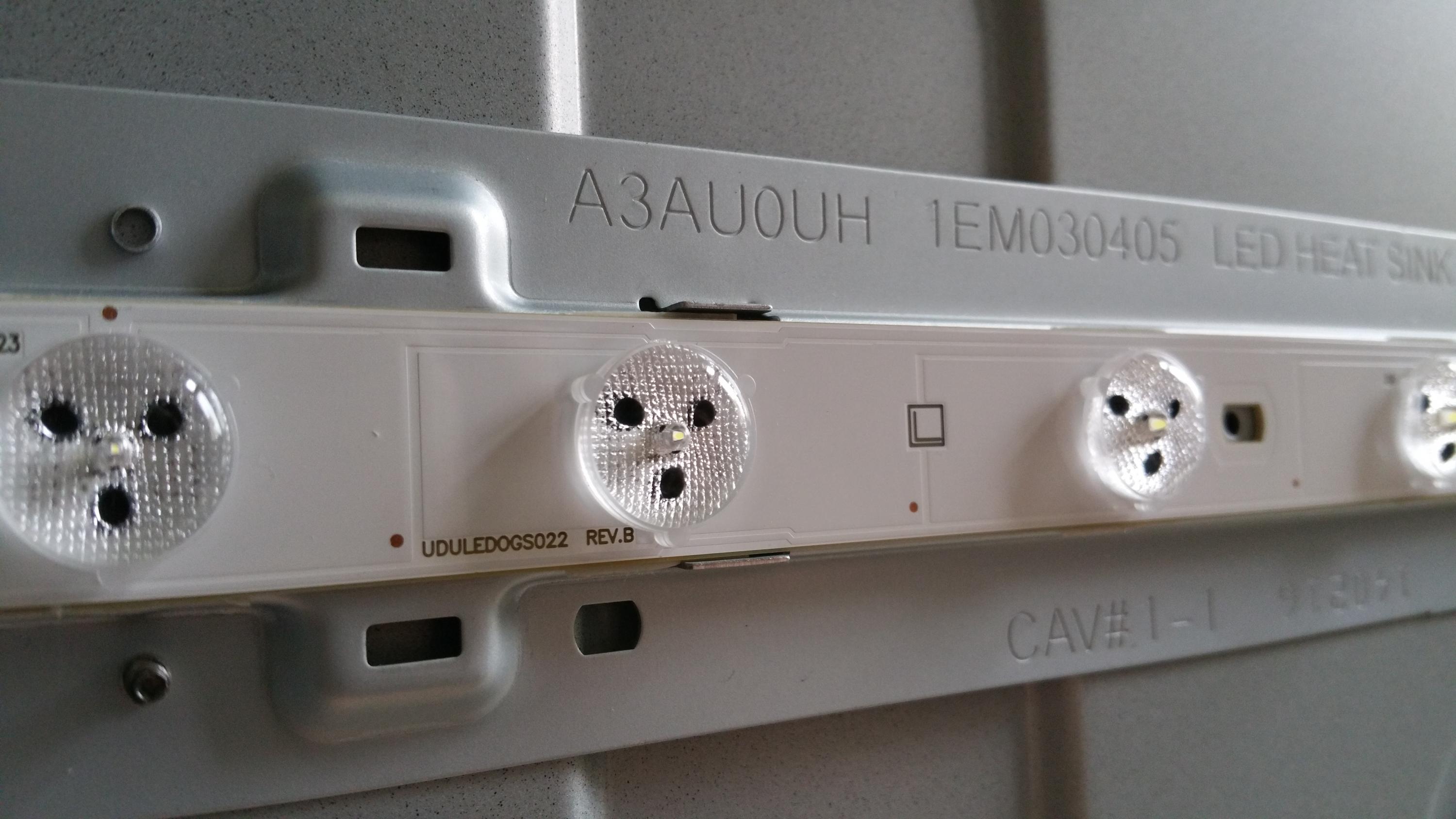

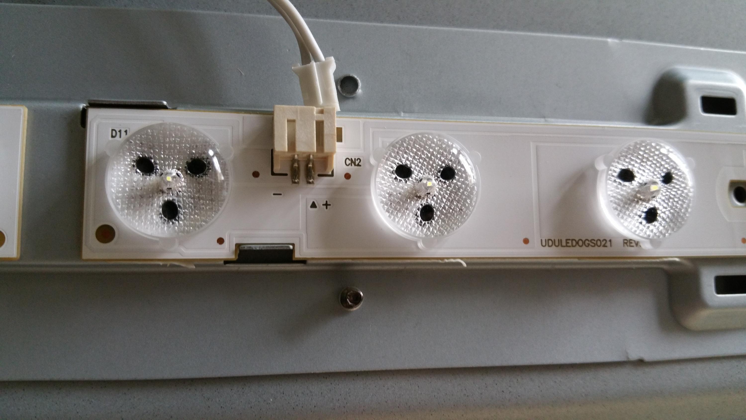

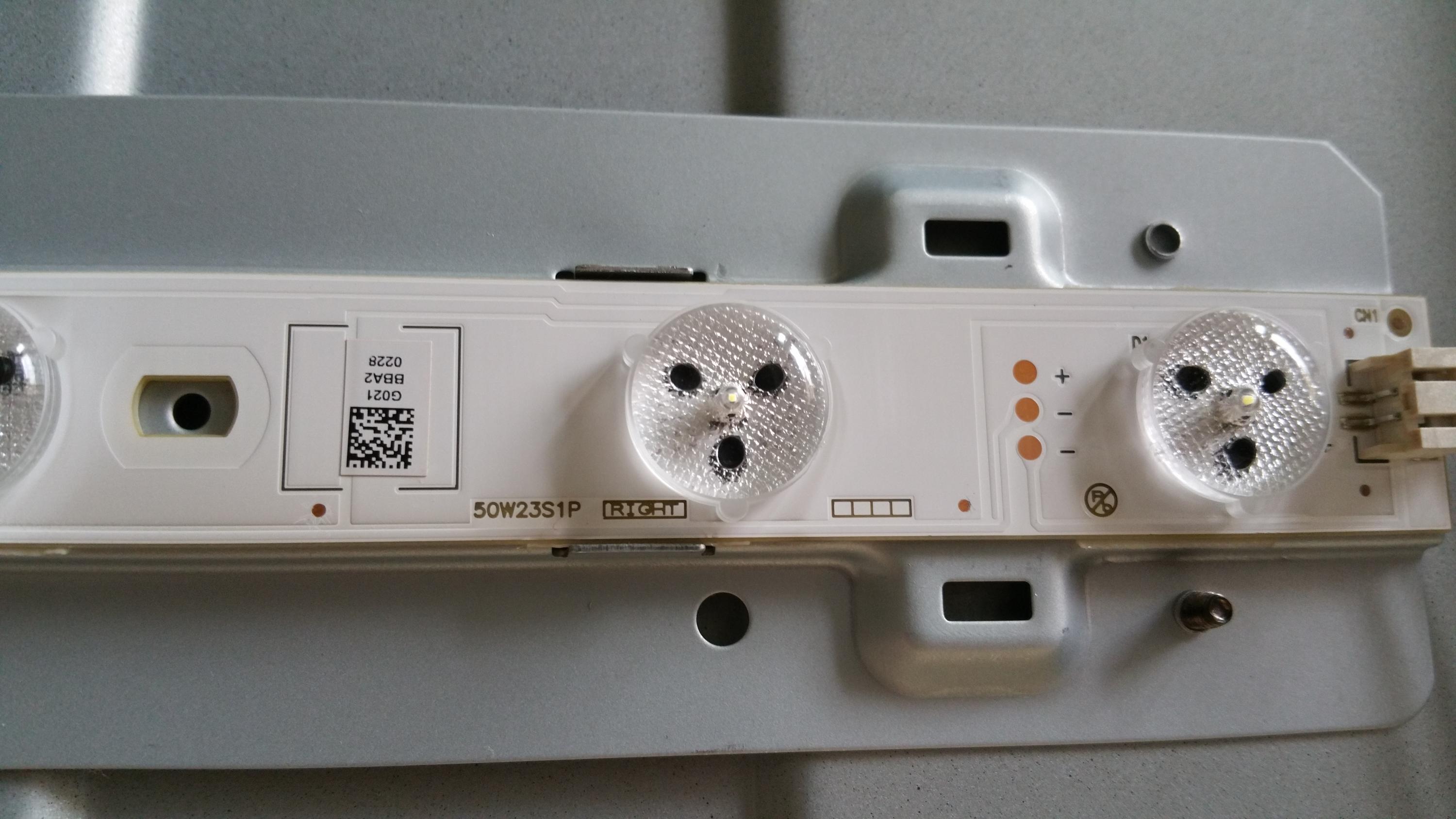

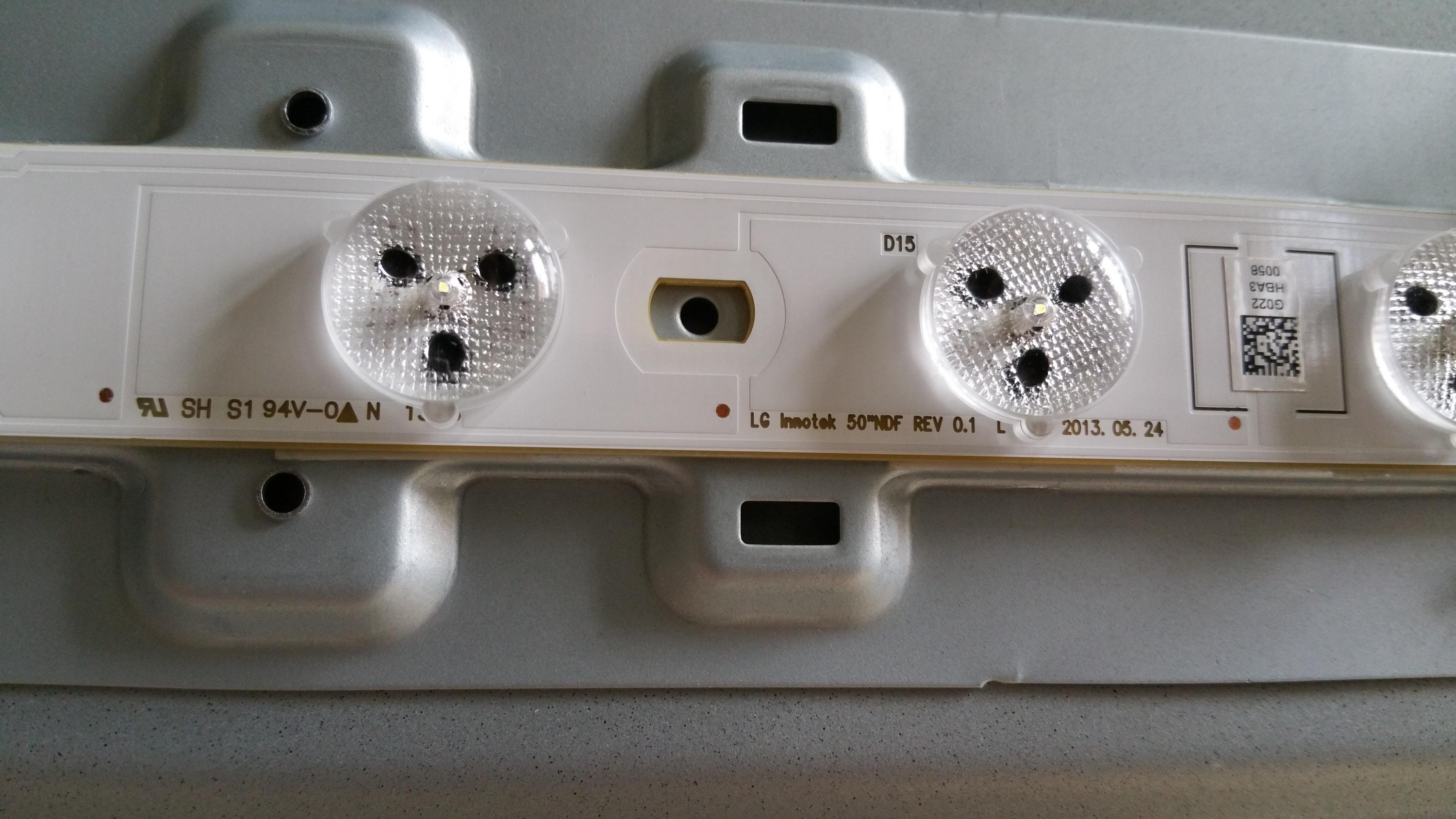

          Thanks guys. My hesitation was there seems to be a general warning against willy-nilly sourcing unregulated power to test an LED, at least for "specialized" TV LEDs, versus powering through the LED's constant current driver -- the (seeming) risk, as far as I understand, being inadvertently burning or damaging the LED because it's not powered through its current-regulated driver or at least a regulated power supply like an LED tester. Some of the comments here, for example. Is this the case? Will I potentially damage any of these LEDs by using two AA's, since it's not current-regulated?
          I've also been hesitant because I can't find a datasheet for these LEDs, either (LG Innotek). I can find other datasheets for LG Innoteks, but can't find one with any of the seeming part numbers on these strips. Any suggestions on where I can find the datasheet?
            A clever idea using batteries. Draws around 200mA.
