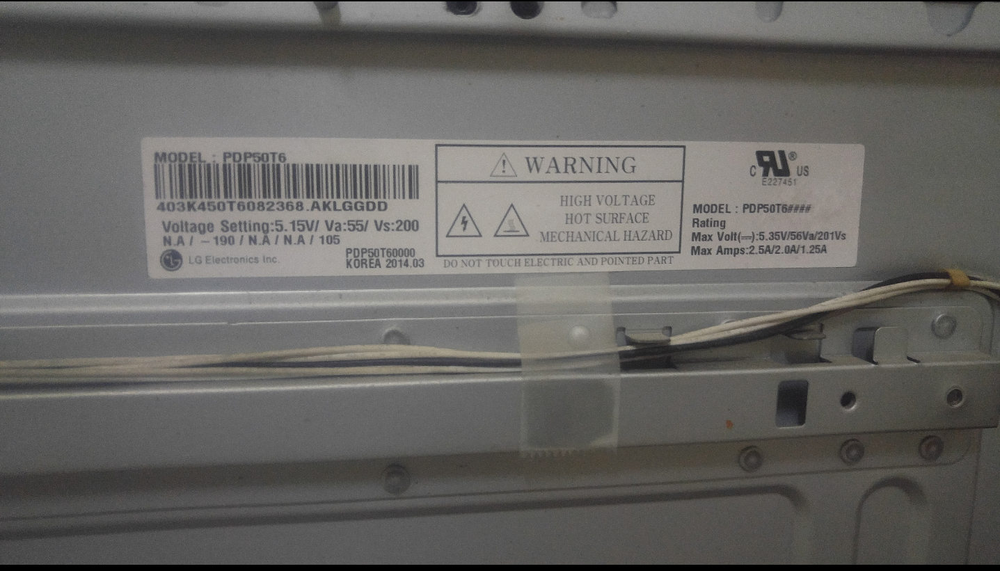

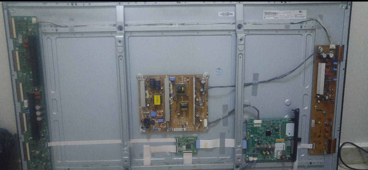

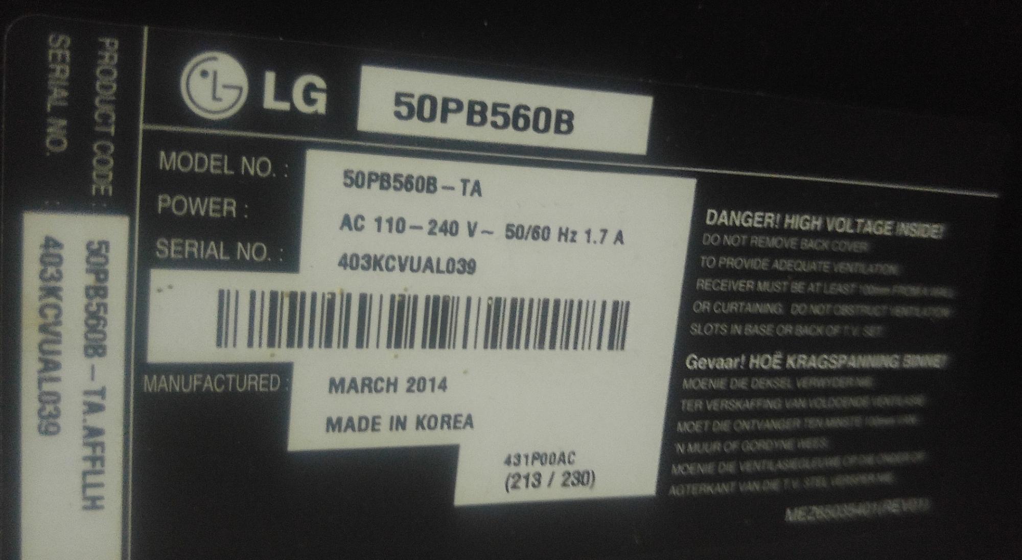

    Good evening, I have a plasma TV LG 50PB560B that did not light anymore. There was just the red LED on when I turned it on. I suspected the Y-SUS card. Indeed, controlling, I found a transistor 30F133 shorted. I replaced it with IRG7R313U. When I turn it on again, the screen lights up and then stops almost every second and it's repeated. No OSD display, no sound either. The voltage Vy oscillates between 0V and 5V. Here are the few pictures of the TV that I could take.
    Thanks for your help.

    Photos of the back of the tv
