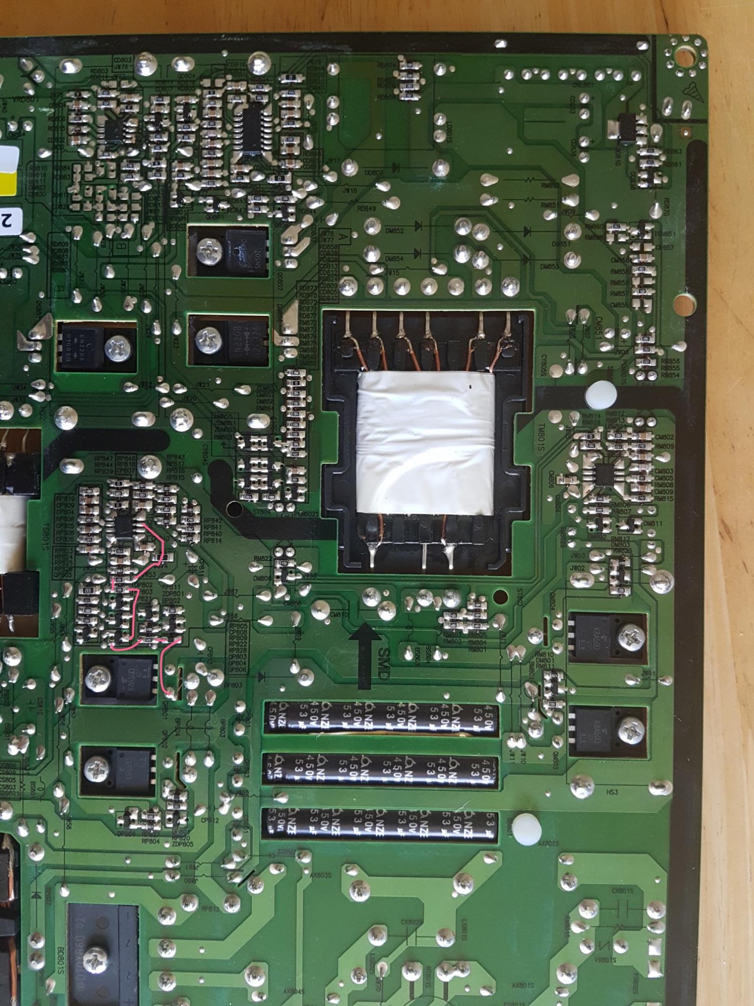

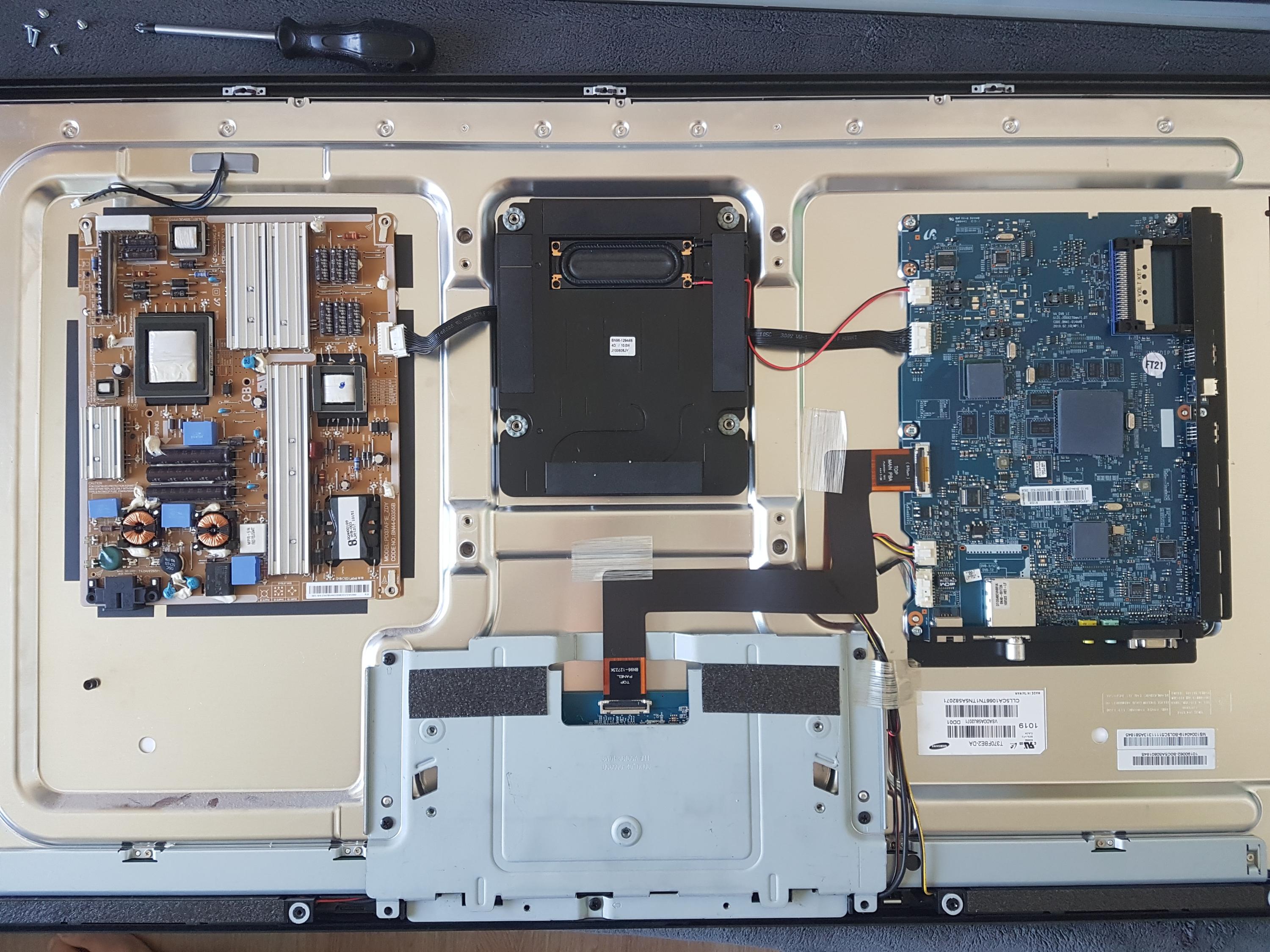

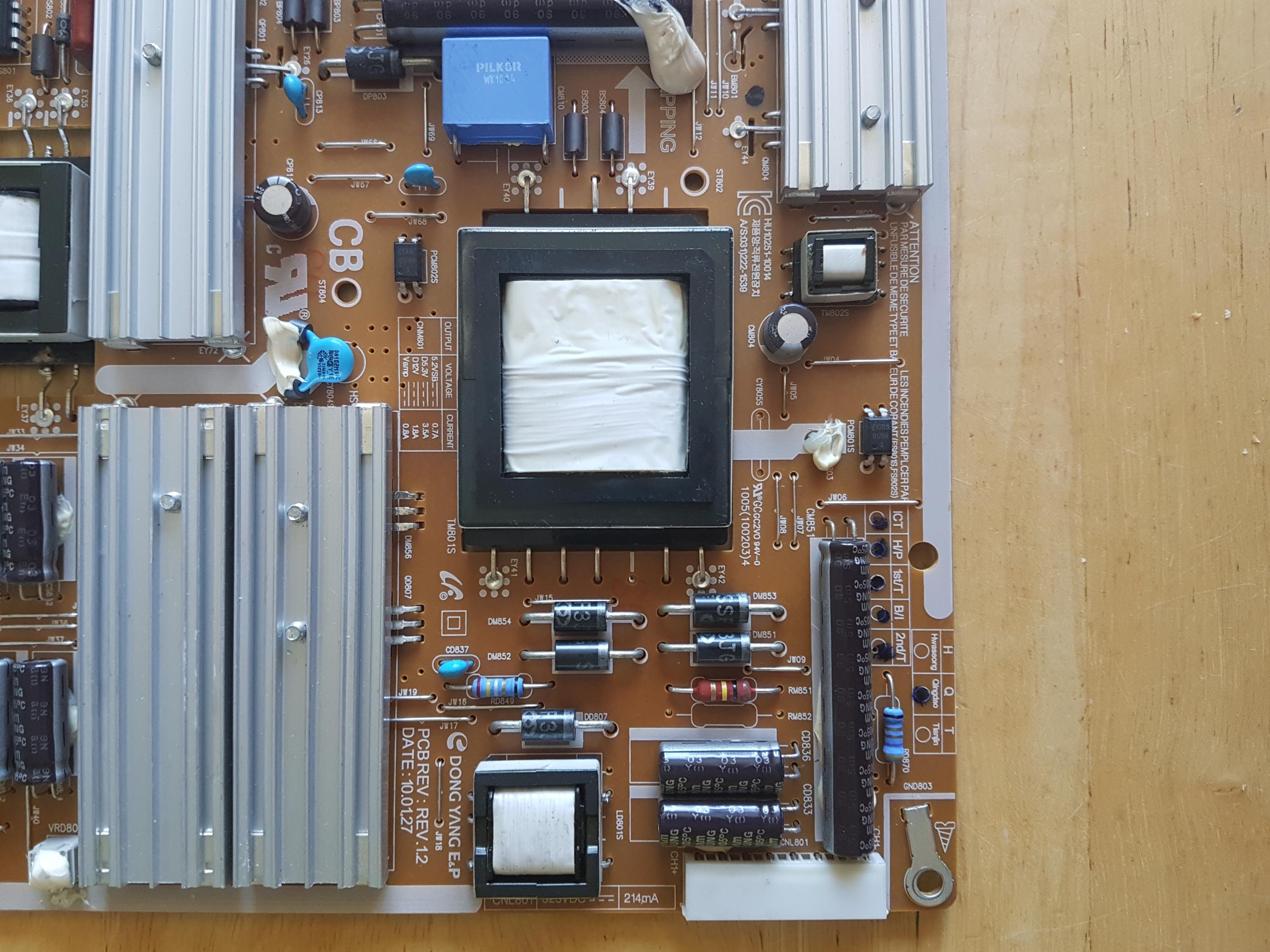

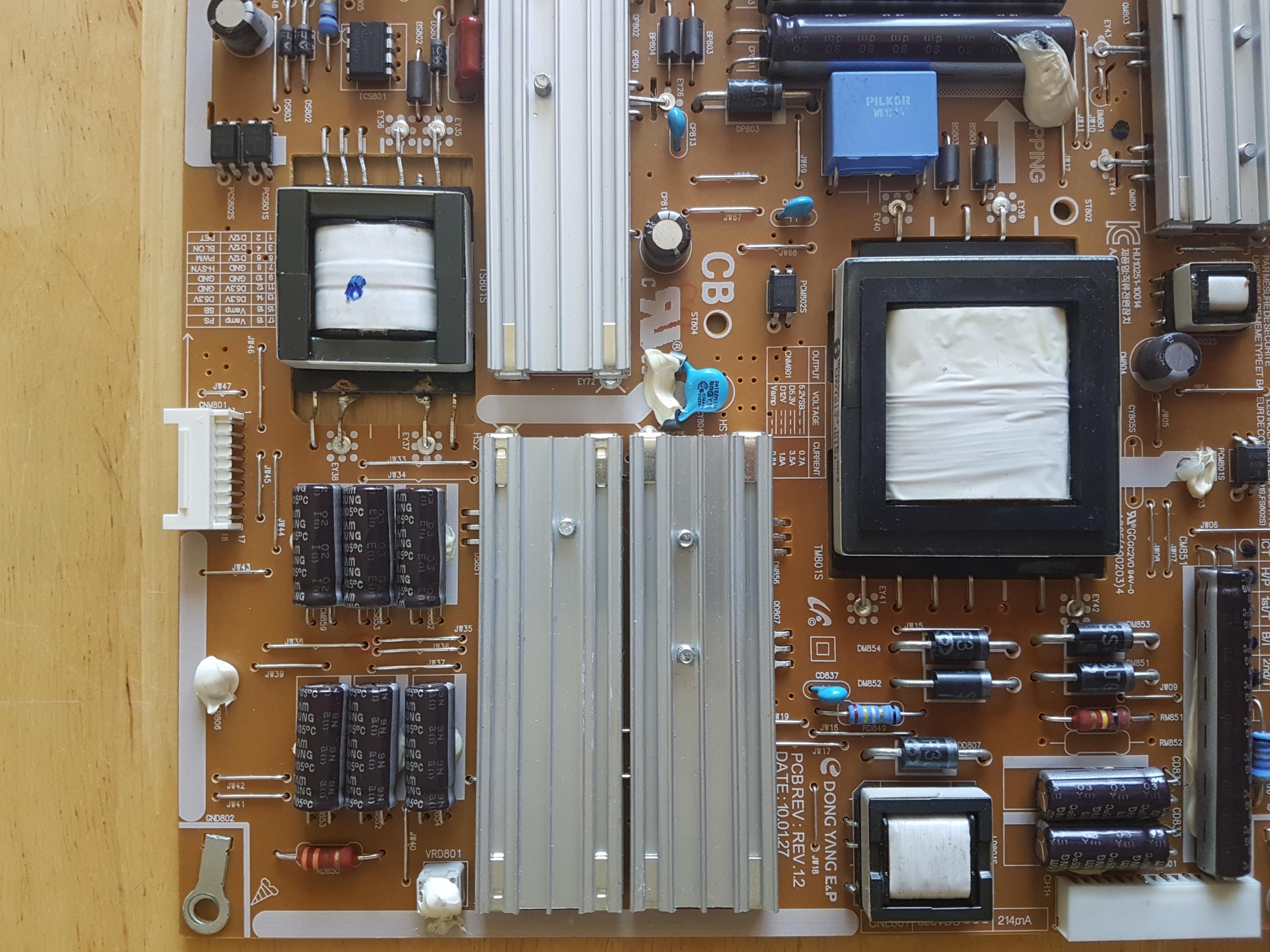

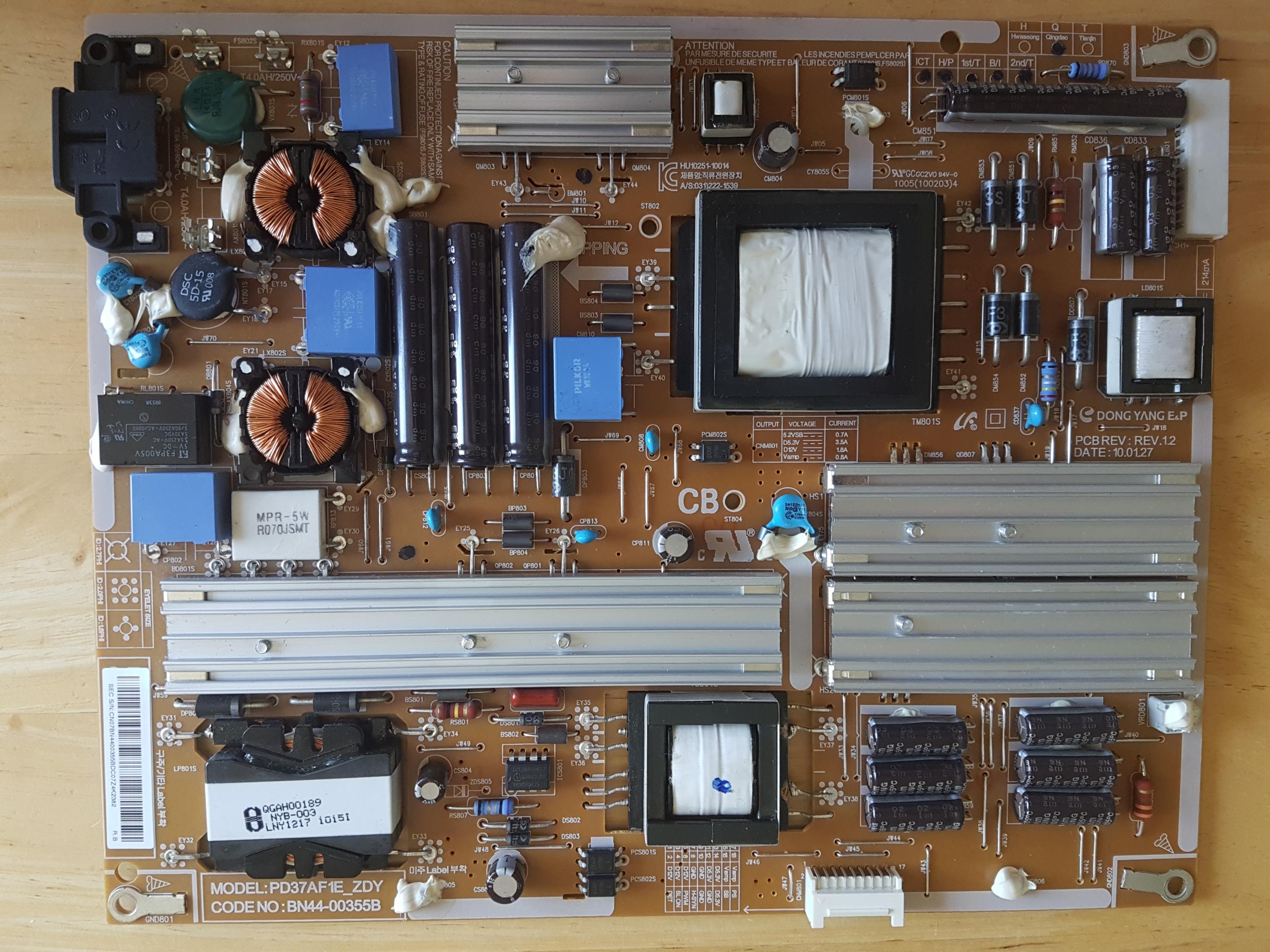

    Hey guys, my Samsung LED TV UE37C6000 went black a few days ago. I found out that the 2 fuses of the power supply board PD37AF1E_ZDY were blown. I got new ones and both immediately blew again when I plugged the TV in.
    I do not see (visually) any burnt components or any bad caps.
    I have never identified such problem so I am rather clueless what to measure where and how to find the broken component(s). I guess it is some short circuit.
    I hope someone can give me a hint. Thanks!

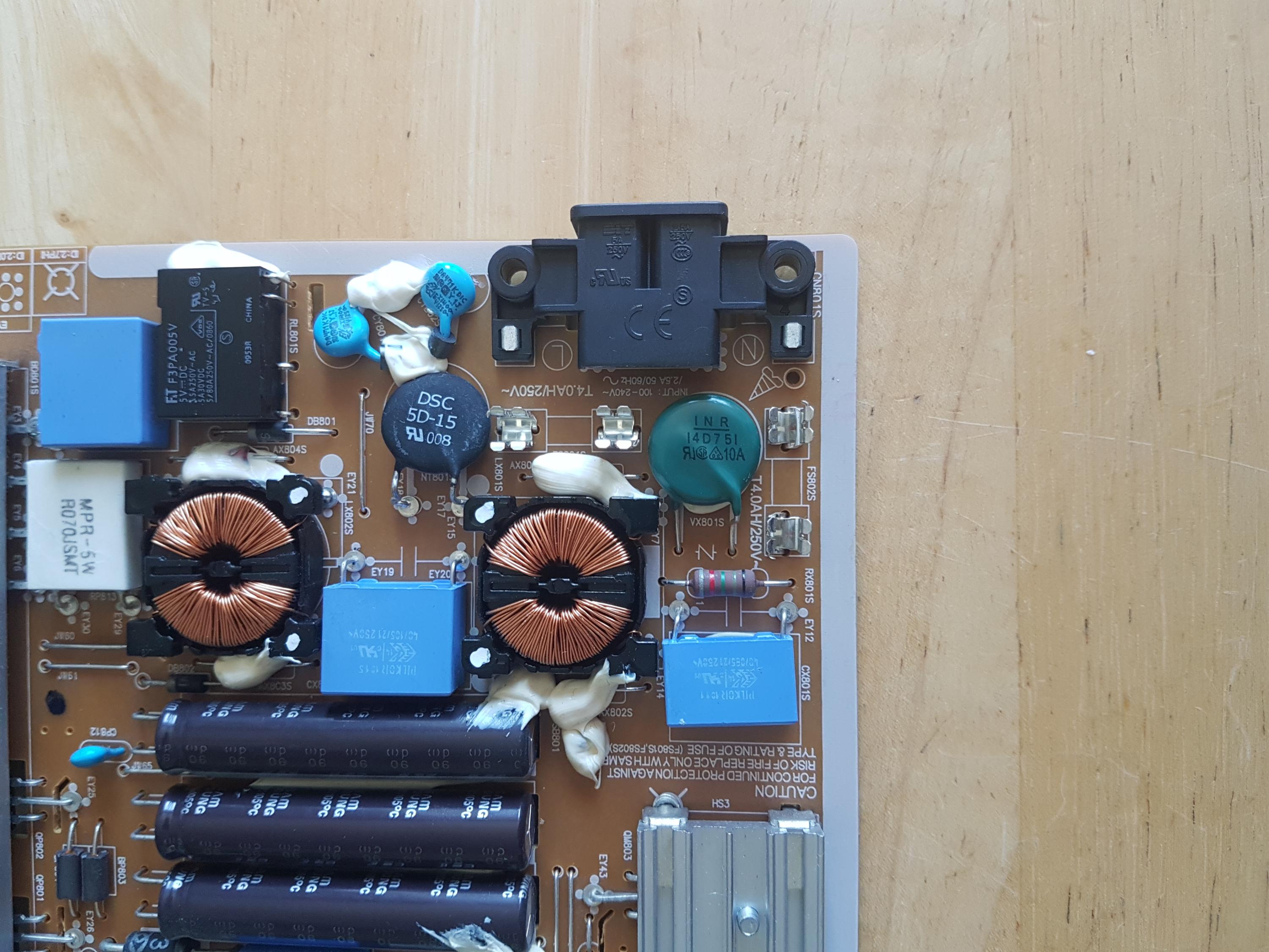

    Check the resistance across VX801S MOV. The resistance should be high and not a short, I would then check the 4 diodes in the bridge rectifier BD801S

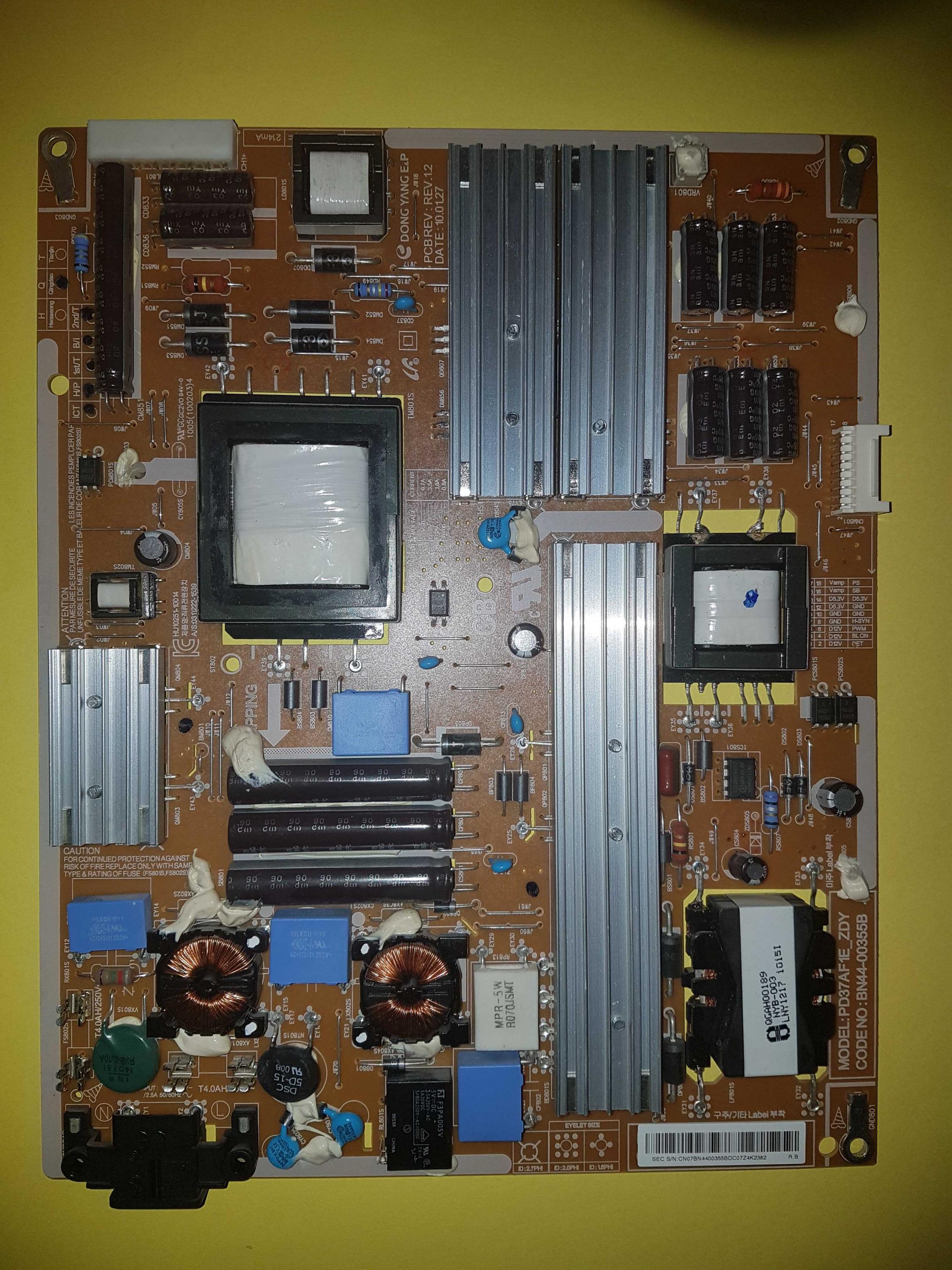

      Samsung BN44-00355B power supply board.
      Check the bridge rectifier BD801S, MOSFET's QP801, QP802, QM803, QM804 for shorts.
      Check the resistance between the two legs of those 3 main filter caps laying on the side.

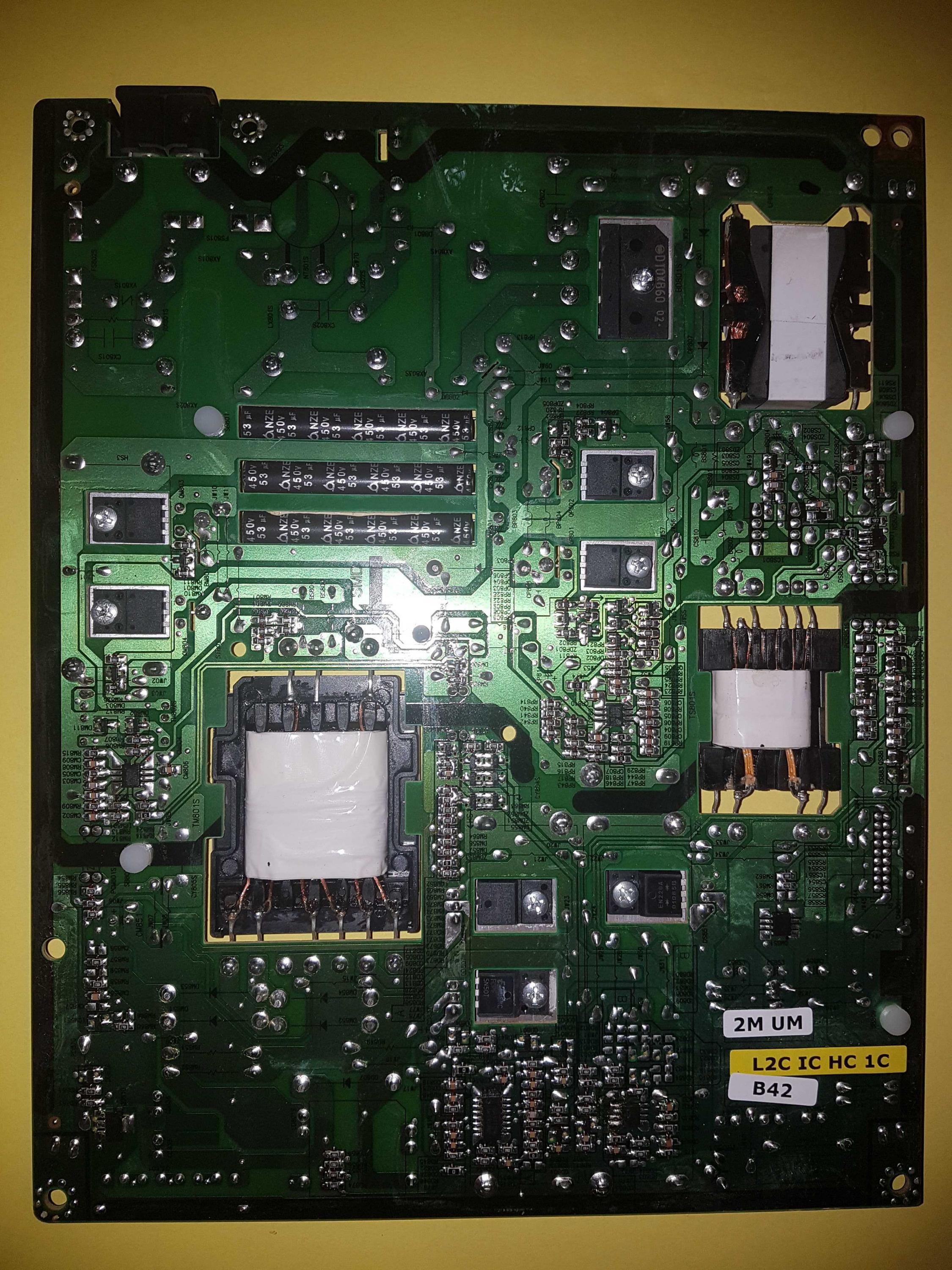

      Provide the straight shot of the whole bottom side of the power supply board, the pictures of the whole back side of the TV showing all the boards.

        Re: Samsung UE37C6000 blows fuses
        Thanks for the hints. Very appreciated!!! I took some more pictures.
        I checked the components (without desoldering):
        Resistance across VX801S MOV is high.
        The diodes of the bridge rectified BD801S all have a resistance of around 600 ohms, in both directions! I guess this is already a bad sign!? But I haven't desoldered it.
        MOSFET QP801 has a short on all 3 pins
        QP802 has a short on pin 2-3
        QM803 and QM804 do not have any shorts
        The 3 main filter caps:
        CS801 is fine. CP803 and CP801 both have shorts
        Should I already order some parts and replace all of those where the shorts are?

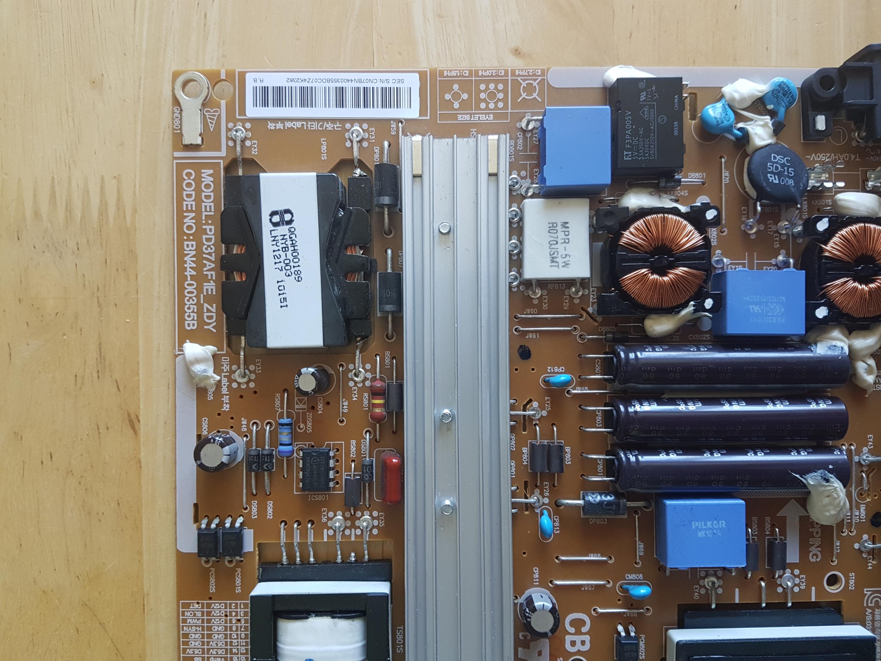

                            The numbers on ICP801 were really hard to read. I believe it said 5591 and I found https://www.alldatasheet.com/datashe...JI/FA5591.html which is also a PFC. So maybe correct, but I am not 100% sure.
                            That one has it's output on pin 7. I think there is no diode on the path from pin7 to the blown FET's gate pin. I drew the path onto the attached image. I havent found any shorts in that area
                            I removed DP803 and it was shorted.
                            What do you think? Should I give it a try with the new QP801 and DP803. Maybe with a light bulb as current delimiter?
                                https://www.badcaps.net/forum/attach...9&d=1561063940
                                Looking at the picture, you can see that QP801 and QP802 are basically connected in parallel as far as the Source and Drain are concerned, you can see the Gate pin of QP802 is connected to diodes and resistors and then it goes to the IC which I cannot see the traces well, I see DPxxx around the Gate circuit of Q801 also.
                                You can try just replacing the MOSFET and see what happen.

                                      The furthest I got was reading these numbers for the PFC IC ICP801:
                                      either it is
                                      1D10123
                                      5591
                                      or
                                      1510123
                                      5591
                                      or
                                      1010123
                                      5591
                                      when I google for any of the first numbers, i cannot find anything meaningful. If i search for 5591 PFC i find this: https://www.alldatasheet.com/datashe...JI/FA5591.html
                                      So I believe this should be it.
                                      • R_J
                                        • Jun 2012
                                        • 9588
                                        Yes, its a FA5591, the top number is the mfg/date code
