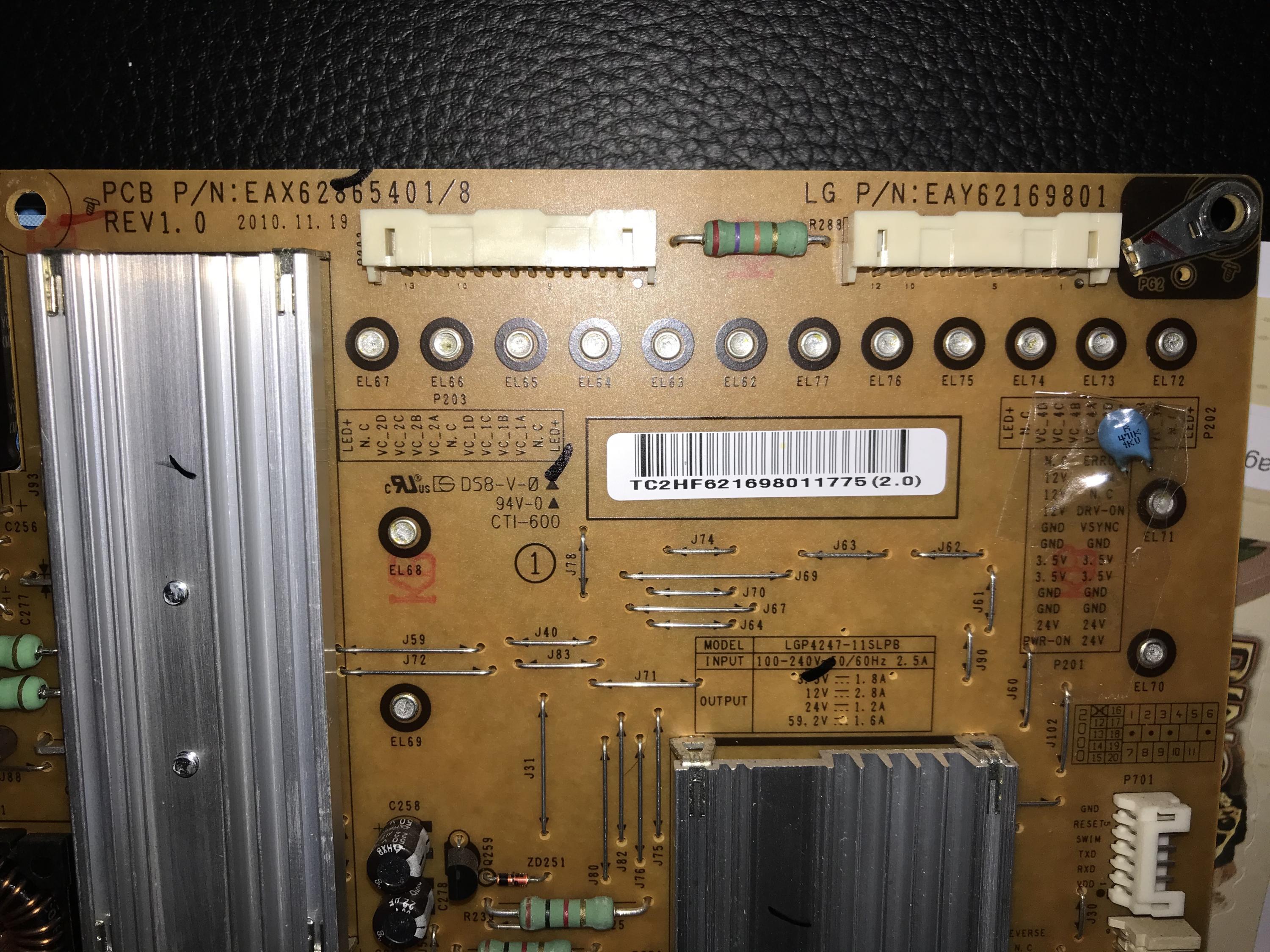

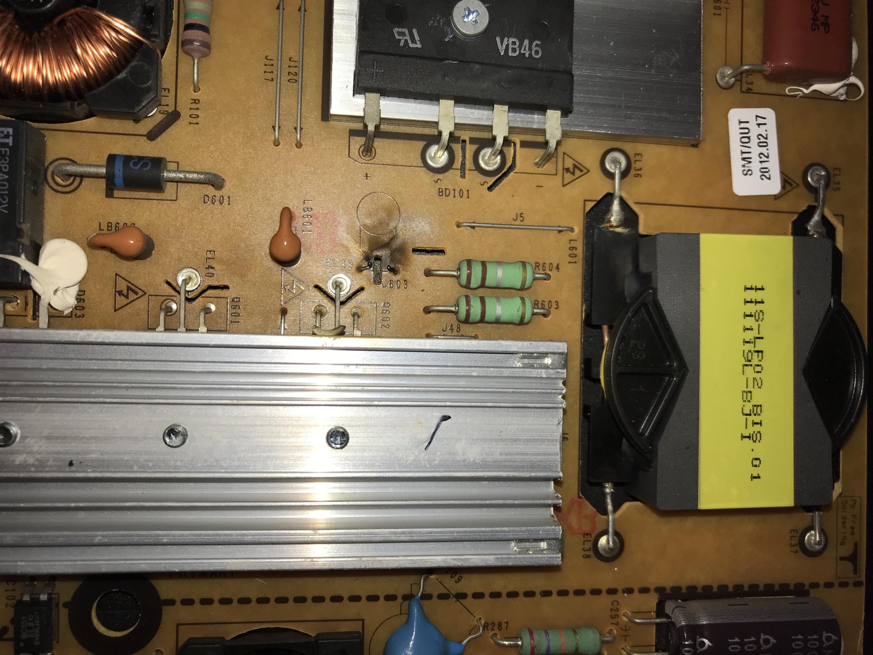

    My LG 47LW6500 went dark all of a sudden.
    Tried power cycling it and the standby light comes on.
    When I try to turn it on, the lights blink in the usual start up sequence but there is no backlight.
    Took it apart and immediately noticed the C603 capacitor had burnt out. I am hoping replacing the cap will fix the issue.
    Complete novice at this, so I was hoping for some advice.
    • It's a ceramic capacitor with labels "R / 471K / 1KV" -- which I understand as 470pF, 10% tolerance, 1000V
    • But the board data sheet lists C603 as 50V and 13pF
    Should I be bothered by the mismatch? Or just find a like for like replacement for the cap?
    Thanks in advance!
  • diif
    • Feb 2014
    • 6978
    • England
    Re: LG 47LW6500 powers on but no display
    C603 in the service manual is on the mainboard.
    470pF 1000v or upgrade to 470pf 2000v.

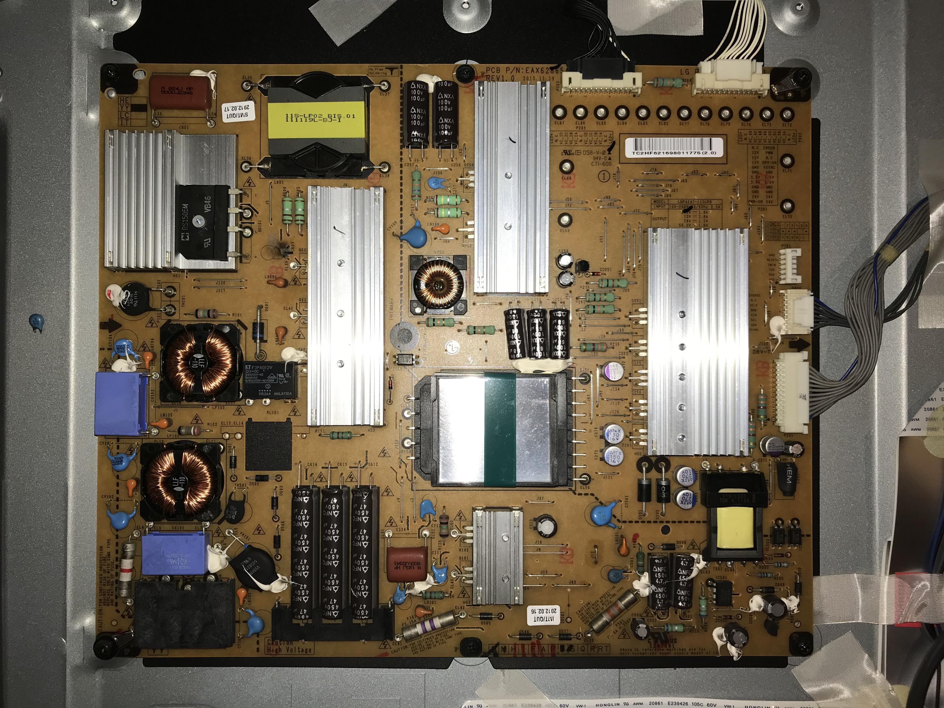

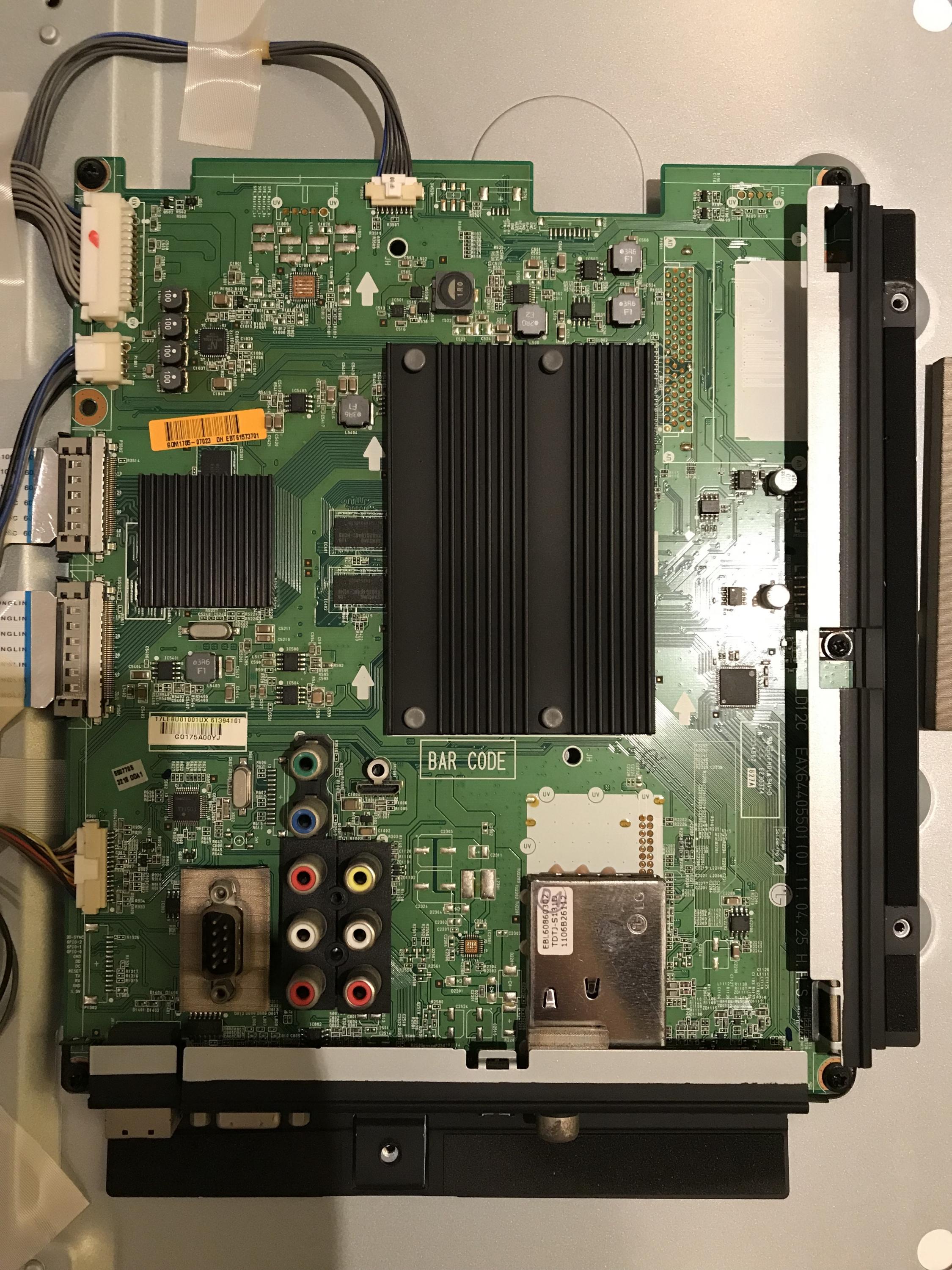

        Adding full pictures of power and main board for reference.
        Will be reporting back with results after testing P201 as well.
