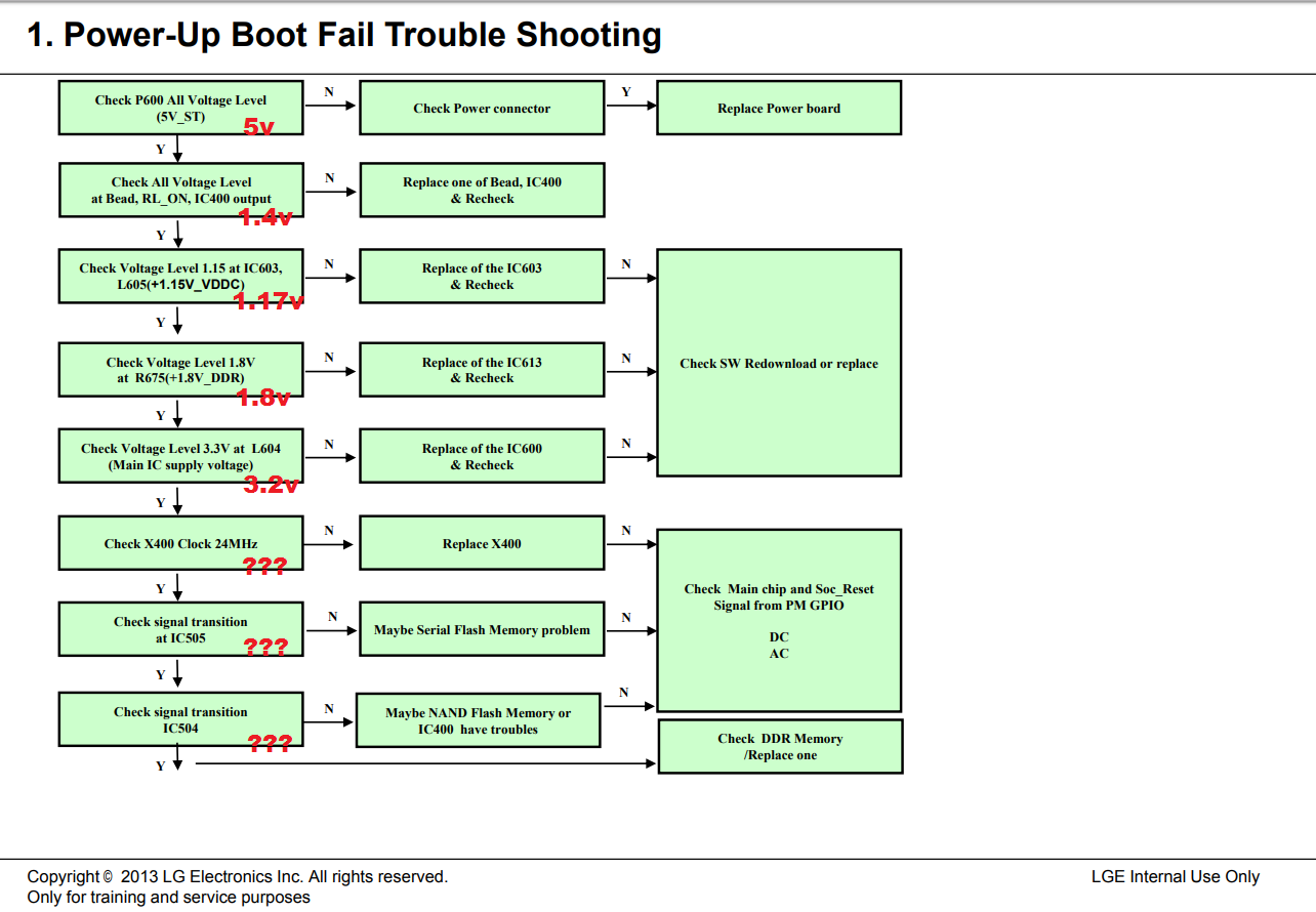

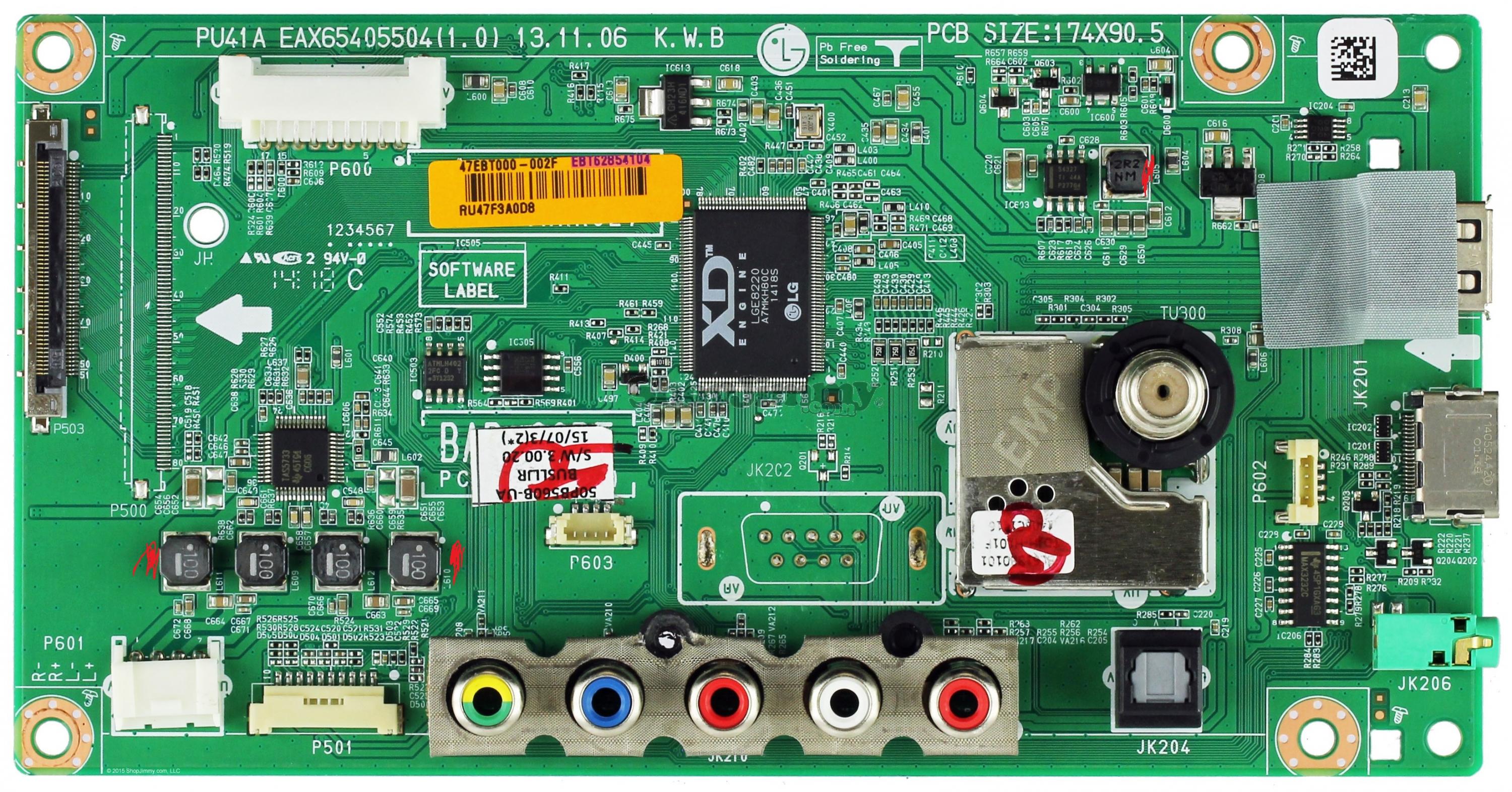

50PB560B -LG common problems?
  • diif
    replied
    Re: 50PB560B -LG common problems?
    It looks like you need an oscilloscope for those last three tests.
    Leave a comment:
  • Demonata08
    replied
    Re: 50PB560B -LG common problems?
    Dont suppose anyone has any wisdom for me at this point? I realized my pictures didnt upload so here they are
    Leave a comment:
  • Demonata08
    replied
    Re: 50PB560B -LG common problems?
    I really hate to keep posting but im not getting any replies. And im still trying to actively repair the board since the replacements are stupidly high. So i double checked the panel and all other boards are good. I got the test patterns on and it was working well.
    In the attachment is troubleshooting steps from the LG, Since the IC replacements ive gotten all the proper voltages on everything on the list except maybe to the main IC. it was showing 3.3v but i got 3.2v which i think is close enough? I checked the regulator and its putting out a perfect 3.3v.
    Ive made it down to checking the clock speed at X400 for 24mhz. I have no idea how to go about that. the other two are to check signal transitions at different places which i dont know how to do that either.
    So what component should i be looking at? Theres a few on here that i suspect and would like to test. I'll mark them on a reupload of the main. its the ones between the red lines.
    I feel like theres so many of these TV's with main board issues. Every time i search its model the majority of them have the same issue but no solution. With the schematic i feel like we can figure this out.
    Leave a comment:
  • Demonata08
    replied
    Re: 50PB560B -LG common problems?
    Originally posted by Unspun01
    You could try this repair kit for your 50" LG plasma model 50PB560B:
    https://www.shopjimmy.com/lg-ebt6285...0pb560b-ua.htm
    I have a similar problem with 60" LG plasma model 60PB5600... My 60" model has only one rear HDMI port, and they were notorious for poor solder. The HDMI port broke off completely when an HDMI cable was inserted. As a result, something was shorted out and damaged the main 156-pin IC LGE8220. I suspect you may have same problem.
    Try holding your finger on top of the large LGE8220 IC and see if it gets hot.
    You could try replacing the main IC, or buy the kit and replace all 3 ICs.
    I doubt reflowing will solve your problem.
    Tried the repair kit. No dice.
    replaced all three IC's in the repair kit. cant even get an error code of any sort unless there is no power to the main.
    when its all plugged up it does nothing when you hit the power button. That repair kit had a new eeprom, a chip for what i think is audio, And the new main IC.
    the ic doesnt get hot or anything. i checked to be sure the button was having a voltage fluctuation when pressed and it was working.
    These mains are way to expensive to really be worth it. anymore tips? I went through the the voltage regulators both were working i believe. it 5.2 to 3.3 and 5.2 to 1.8.
    Leave a comment:
  • Demonata08
    replied
    Re: 50PB560B -LG common problems?
    Another question, Is there anyone that might know what voltage the RL_ON line would suppose to read? Im tracing the issue right now, the specs on the p board dont say. just says rl_on where it normally says voltage. The schematics i linked dont say either. under troubleshooting it just says to check the voltage
    I'm getting .35 volts on that line. On some of the IC's that say it should be receiving 5volts its also getting .35 volts which leads me to believe that maybe needs to be 5volts. But im not sure.
    thanks in advance
    Leave a comment:
  • Demonata08
    replied
    Re: 50PB560B -LG common problems?
    Thanks for pointing me in that direction man! I agree that i believe it might be the main IC. But is there anyway to test? I feel like i should be able to since i have the actual diagram in front of me. But my hands are way to shaky to test points that small. Ill link the diagram below, and the manual also, if anyone smarter then i could follow through to a test point that might be a little easier, I would greatly appreciate it
    Main IC
    Service Manual
    Leave a comment:
  • Unspun01
    replied
    Re: 50PB560B -LG common problems?
    You could try this repair kit for your 50" LG plasma model 50PB560B:
    https://www.shopjimmy.com/lg-ebt6285...0pb560b-ua.htm
    I have a similar problem with 60" LG plasma model 60PB5600... My 60" model has only one rear HDMI port, and they were notorious for poor solder. The HDMI port broke off completely when an HDMI cable was inserted. As a result, something was shorted out and damaged the main 156-pin IC LGE8220. I suspect you may have same problem.
    Try holding your finger on top of the large LGE8220 IC and see if it gets hot.
    You could try replacing the main IC, or buy the kit and replace all 3 ICs.
    I doubt reflowing will solve your problem.
    Leave a comment:
  • Demonata08
    started a topic 50PB560B -LG common problems?
    50PB560B -LG common problems?
    Hey everyone again, Been a few days. My newest project is an LG 50PB560B. Which actually has a very easily accessible service manual(which was nice).
    So the initial problem is no power on. This model doesnt seem to even have a standby light. Tested all the power points and everything matched perfectly. Unplugged power board from main and the screen will come on. (i understand theres some way to get test patterns up but i havent figured that one out yet)
    I'm highly suspecting the main. The board itself is a pretty simple looking board. but its going for 300 on ebay so not worth it. Im looking at reflowing it, i have everything i need to do that although im not experienced at all at that(Gotta start somewhere?)
    Anyone know of the common chips to be looking at on this one? I have the diagrams to actually trace the problem but the test points are so tiny im sure ill short something. If anyone has any idea of the best plan of attack for this one id greatly appreciate the support
  • Rene77
    GTX 680 problems, Wrecks main board
    by Rene77
    i tested this Asus gtx 680 which came with a bunch of computer stuff.
    When i only connected the 8 pin, the PC still started and gave the error on the display that also the 6 pin needed power.
    when all connectors where powered and both leds were green, the PC did not boot, Fans where running, but nothing else.
    Even when removing the GTX this failure kept on the main board.
    No boot, no beeps, only the fans running, nothing else.
    main board was a Asus B85m-G, PSU 650 Watt.
    Tried a second (old) main board with a dual core, same...
    12-29-2022, 02:18 AM
  • cmlewis89
    LG 47LB5DF blown power supply board
    by cmlewis89
    Hi folks,
    I'm new to this forum. So my trusty 17-year-old LG 47" LCD recently died. As I was booting it up, I heard a hum followed by a loud bang, sounds of pieces flying around, and loss of power to the unit. Inspecting the PSU, I saw two obvious problems: a blown thermistor (bang + flung pieces) and a visibly bulging main cap. Inspecting as many components as I could with my Fluke MM, I diagnosed that the following components on the "hot side" of the board were also bad: one of the 2 main MOSFETs, main 8A fuse, small cap (25V 47uF) connected to main caps, and a blown...
    09-03-2024, 07:50 PM
  • Dani_2024
    by Dani_2024
    10-28-2024, 05:06 PM
  • cheeky2
    by cheeky2
    05-25-2024, 03:27 AM
  • Matthieu vK
    repairing 360 s6 vacume cleaner robot with stuck radar
    by Matthieu vK
    I got my hands on a 2e hand 360 s6 vacuuming robot i wish to repair.
    Unfortunately, a common (and mine) problem is that the radar, used for navigation is not working.
    a second unfortunate thing is these problems seem to have many different causes, from dirty lens, to stuck hairs so it can't move, to broken down radar module to a faulty PWM (mosfet?).
    the issue I am dealing with is what I believe to be a faulty PWM.
    I have come to this conclusion as this seems to be an issue that others have dealt with also, but I have not found anyone...
    04-29-2024, 05:32 PM
