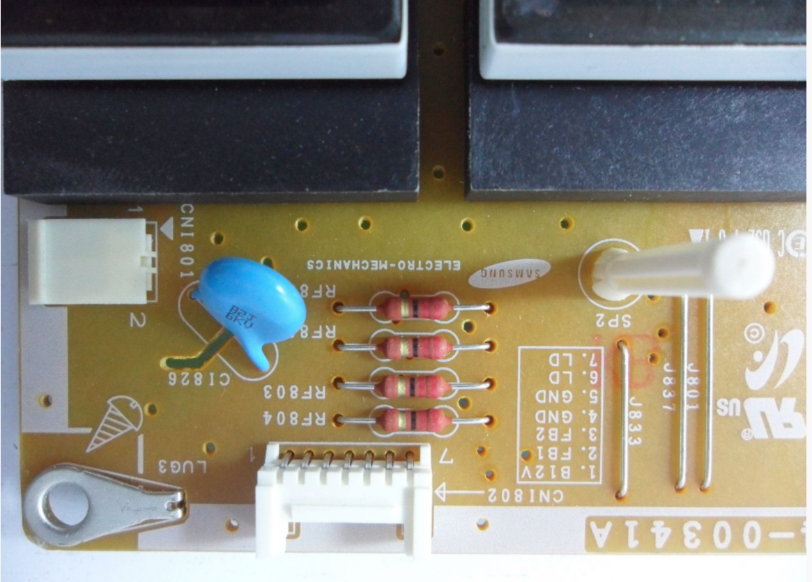

BN44-00341A (CI826 - 82pF 6kV)
BN44-00341B (CI802 - 47pF 6kV)
Good find! i was looking for a zoomable picture to find correct value odd though no a version schematic.

I can't find a place who sells 82pf 6kv.
Is it an option to place 2x 33pf 6kv and 1x 15pf 6kv parallel?

i wonder if its worth taking a risk on going up too 100pf 6kv

Then the voltage divider is no longer correct and it either goes into protection too quickly or it reduces the lamp current.
I'm going to try to place 2 x33pf and 1 x15pf 6kv in parallel, then I'm pretty close at 81pf.
