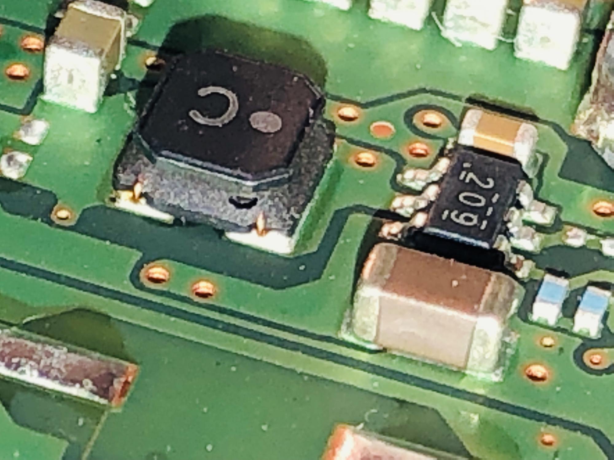

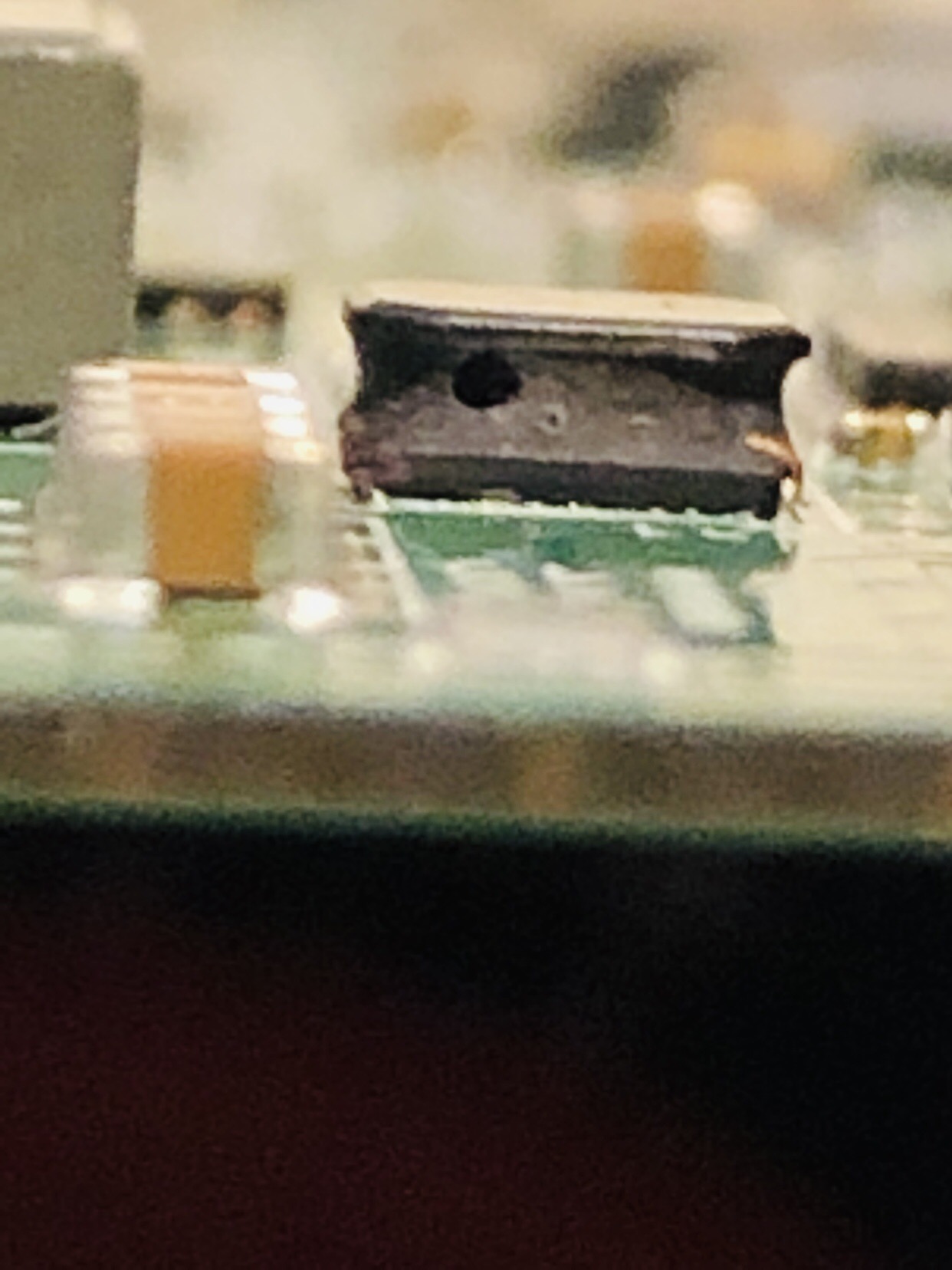

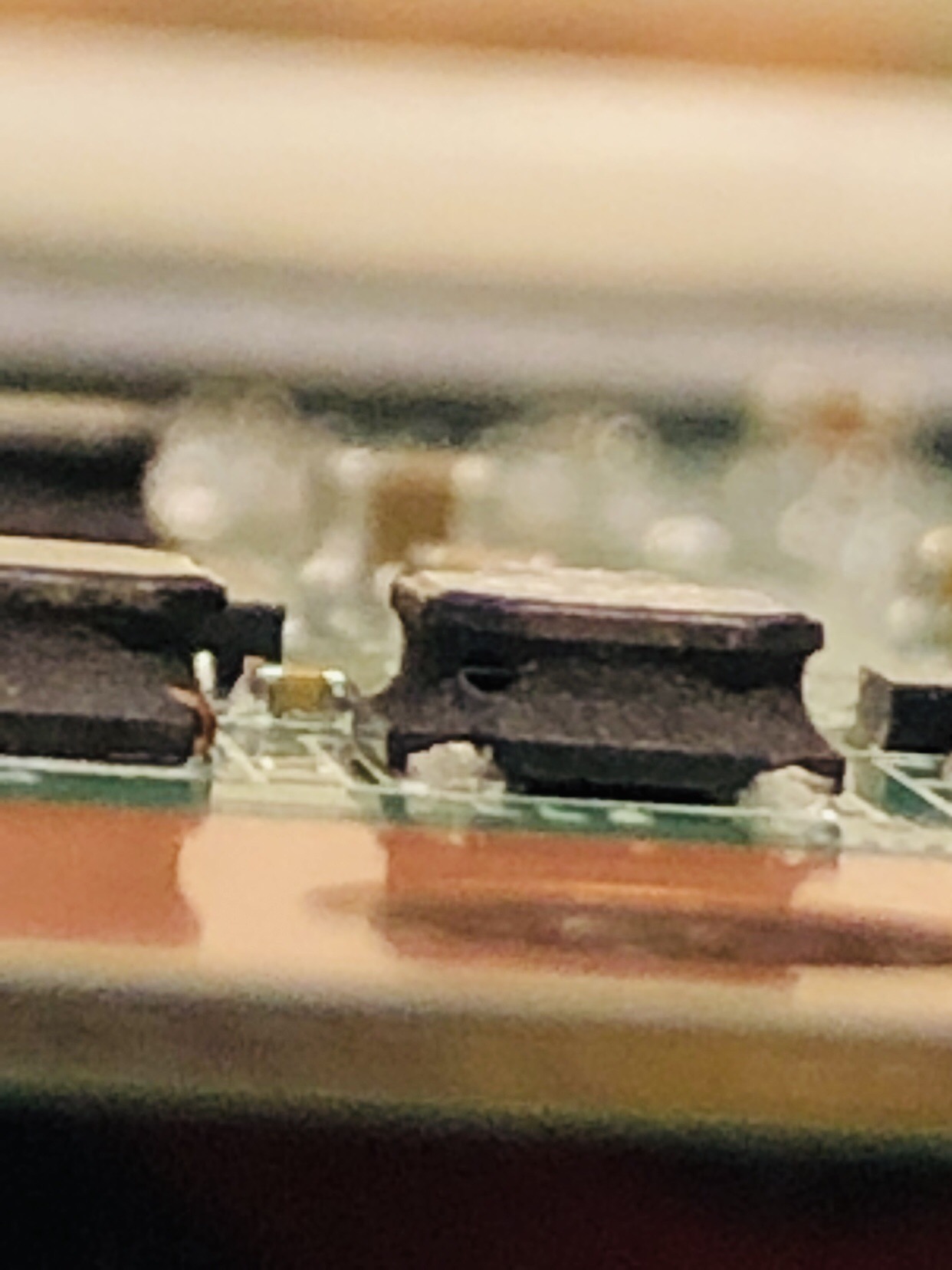

          These are pic from the tcon board is this normal?
          • Diah
            • Feb 2013
            • 6357
            Re: SONY XBR65x900E no image
            this look not good, before you spend on this set by replacing T-CON inspect the panel bonds they may also toasted .
            about hard reset. it mean this set was rested before and its on first install menu music,
            • charlie555
              • Feb 2018
              • 76
              • usa
              Thank you will Order and check before installing tcon board.
