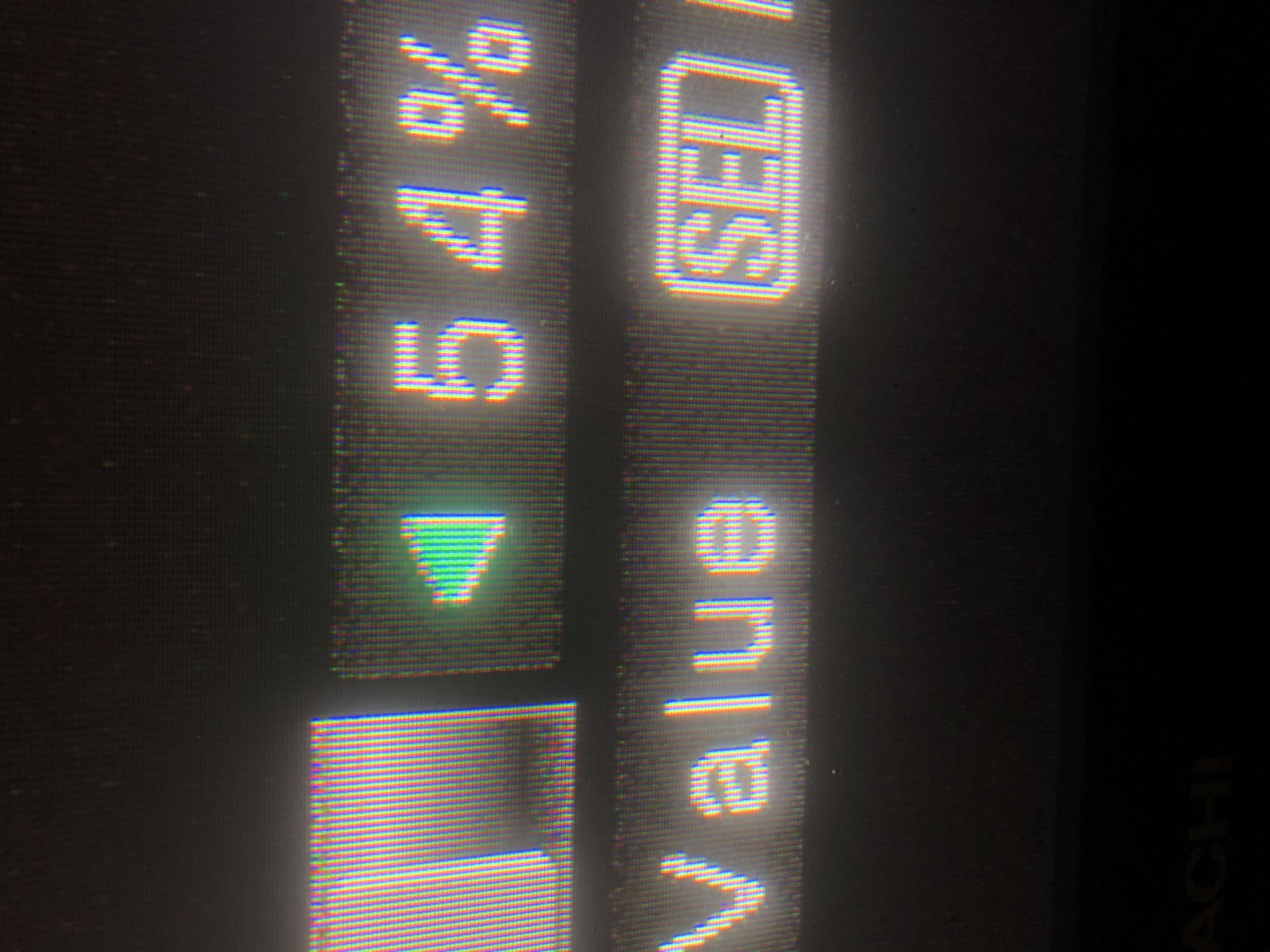

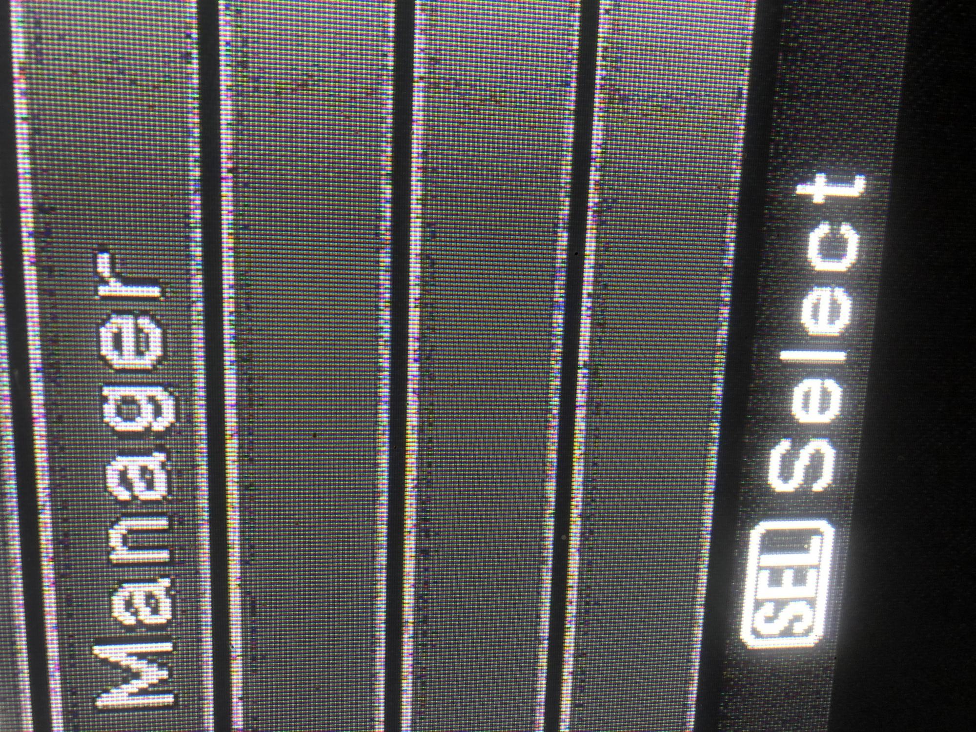

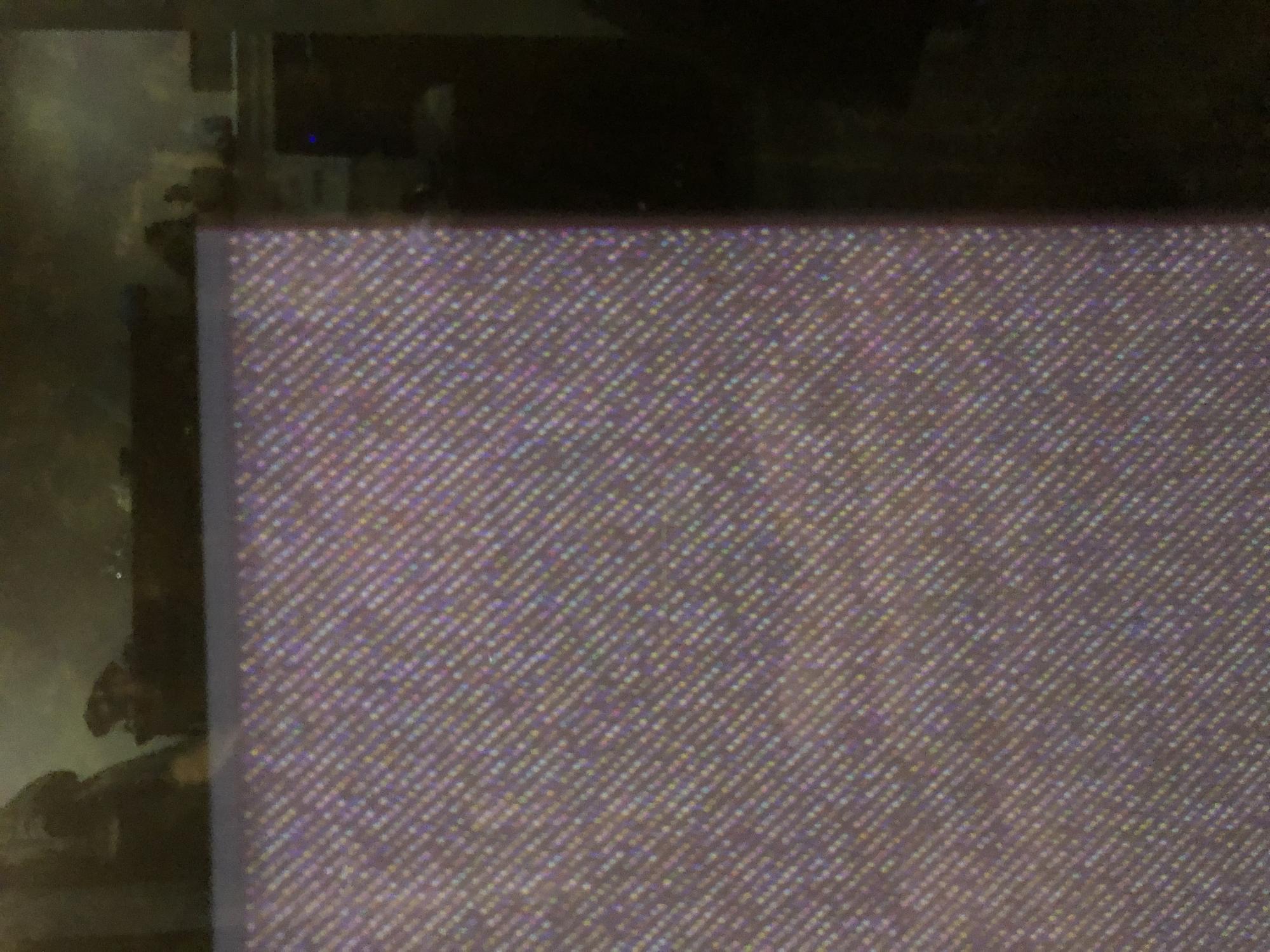

    Hey all.
    I have a 42HDT52A Hitachi tank of a plasma. Yes it's old but I have a thing for old plasma TVs.. Lol.
    Panel is bright, and colours are nice and sharp, but there's a static or noise on the screen, particularly where the colours are changing brightness. Happens on the menus as well. (See pics). Adjusting the brightness has this weird dithering look to it as well (pic attached) Checked voltages and are ok as far as I can tell. Attached a couple pics. Examined all caps and everything looks ok. This seems to be a well built TV.

    Try heating up Y and Z sus, Power and Logic boards one at a time with a heat gun (not a paint striper) or use a hair dryer

      Re: Old plasma help.
      Ok I can try that. I have noticed after its been on a while it does improve.
            Put the set in Test Pattern mode and see if the same anomaly shows up. This will at least rule out the main board as a suspect.
                  I dont have the service manual nor can I find one online, I also dont have the remote.. Any ideas on how to do the test mode?

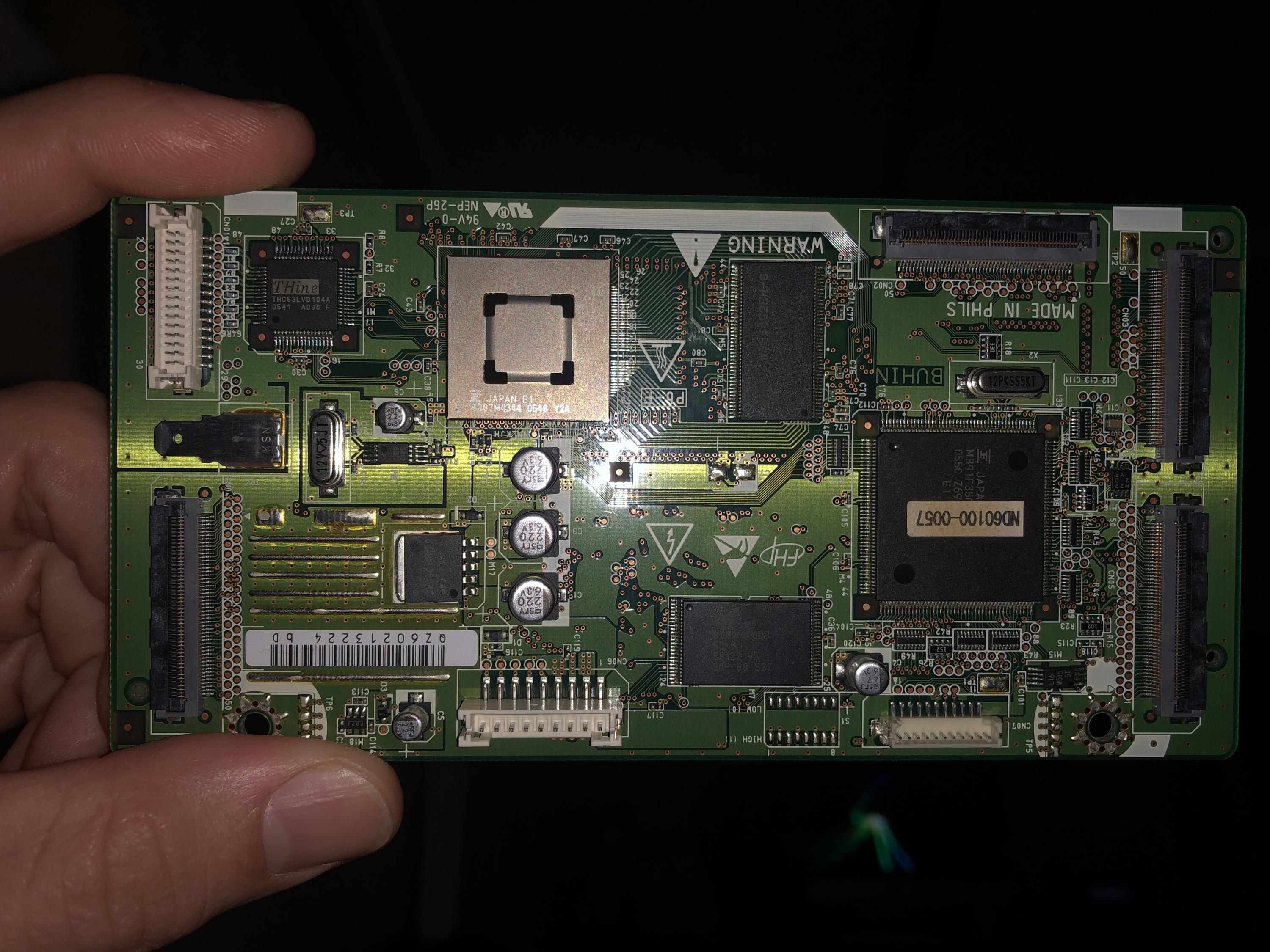

                          Thanks for the info and assistance up till now.
                          I had to stop troubleshooting but I had a look through the pdf and saw a spot about troubleshooting and came across “steps of gradients are missing, logic board”. This describes exactly what the picture is doing. Steps of colour/BW gradients are definitely missing.
                            You have to place a jumper between two pads on the control board and unplug the main board lvds cable. When you power the set it will cycle through test patterns on its own.
                              Yes I read that can be done, but I don't believe it can with this board, and if so, there is no info that I can find to enable this test mode.
                                    Similar enough to that. Different form factor.
                                      I don't see it either. Nothing in the SM about it ?
                                        Nothing.
