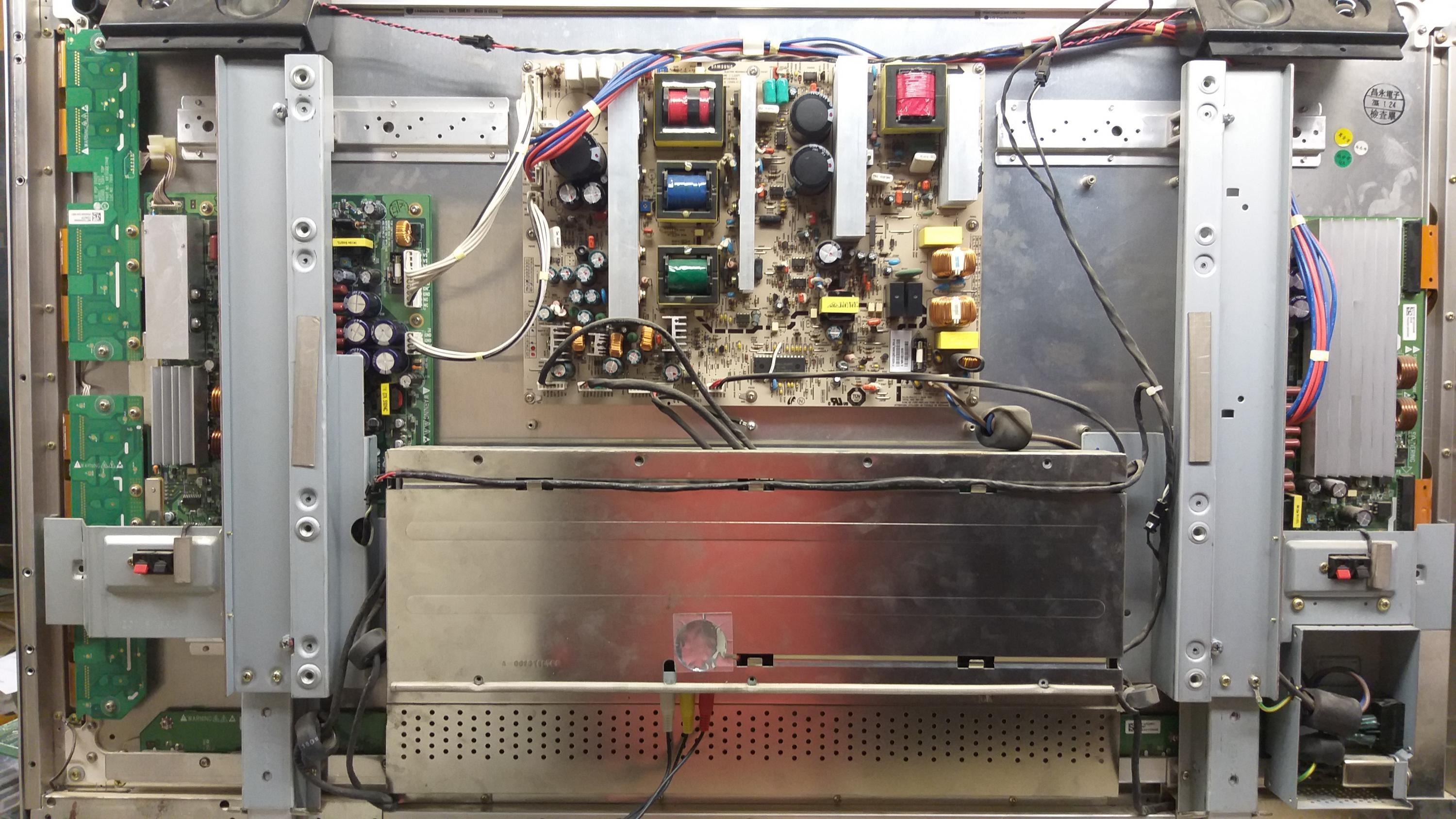

    Hi guys,
    I got in this set with a faulty Y-Sus board but i have brand new boards for this set so i swapped out the Y-Sus and tv started up perfect except for this.....
    On various inputs the TV it is in "burn in" mode, cycling through a red, green, blue image and displays burn in at the bottom. If however i give it a input like my DVD on AV1 then the burn in image goes away and the DVD picture shows up perfect. If however i switch to "TV" input (RF, VHF & UHF) then i get a perfect picture straight away.
    It is as if it has been set up in service mode to go to burn in when there is no input. Is there a way to disable this burn in test, service mode entry?? I don't know how to enter service mode on this dinosaur.
    PS: Photos attached

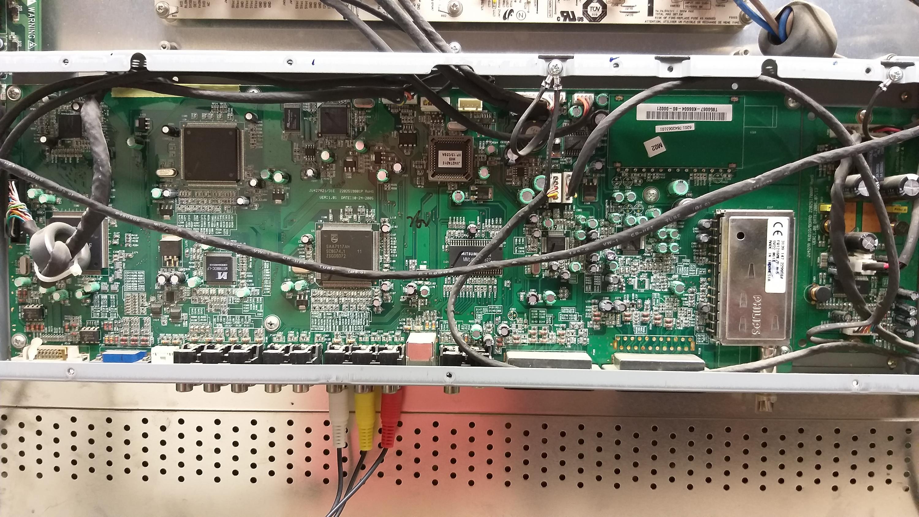

    Re: Proline 42" Model JV427A Plasma (PDP42V7)
    The main board looks like a philips board so maybe try with philips service codes.

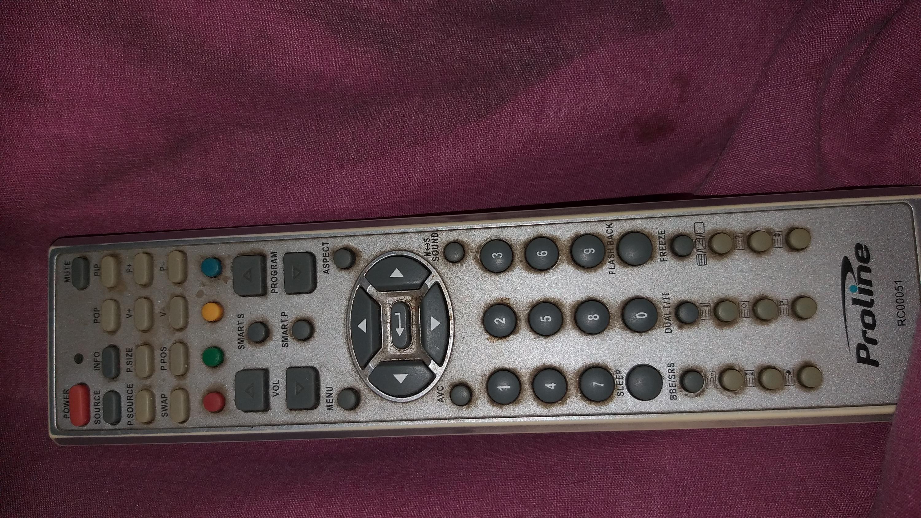

        I finally got the remote. Check photo.
        Unfortunately i dont know philips service mode entry codes. Could you elaborate so that i can try.
          here are a bunch of philips codes, I doubt they will work.

          here is the Haier service menu:
          Press V- , turn volume to 0
          Press "menu" on tv
          Press "menu" on remote control
          Press and hold V- for 3 seconds
