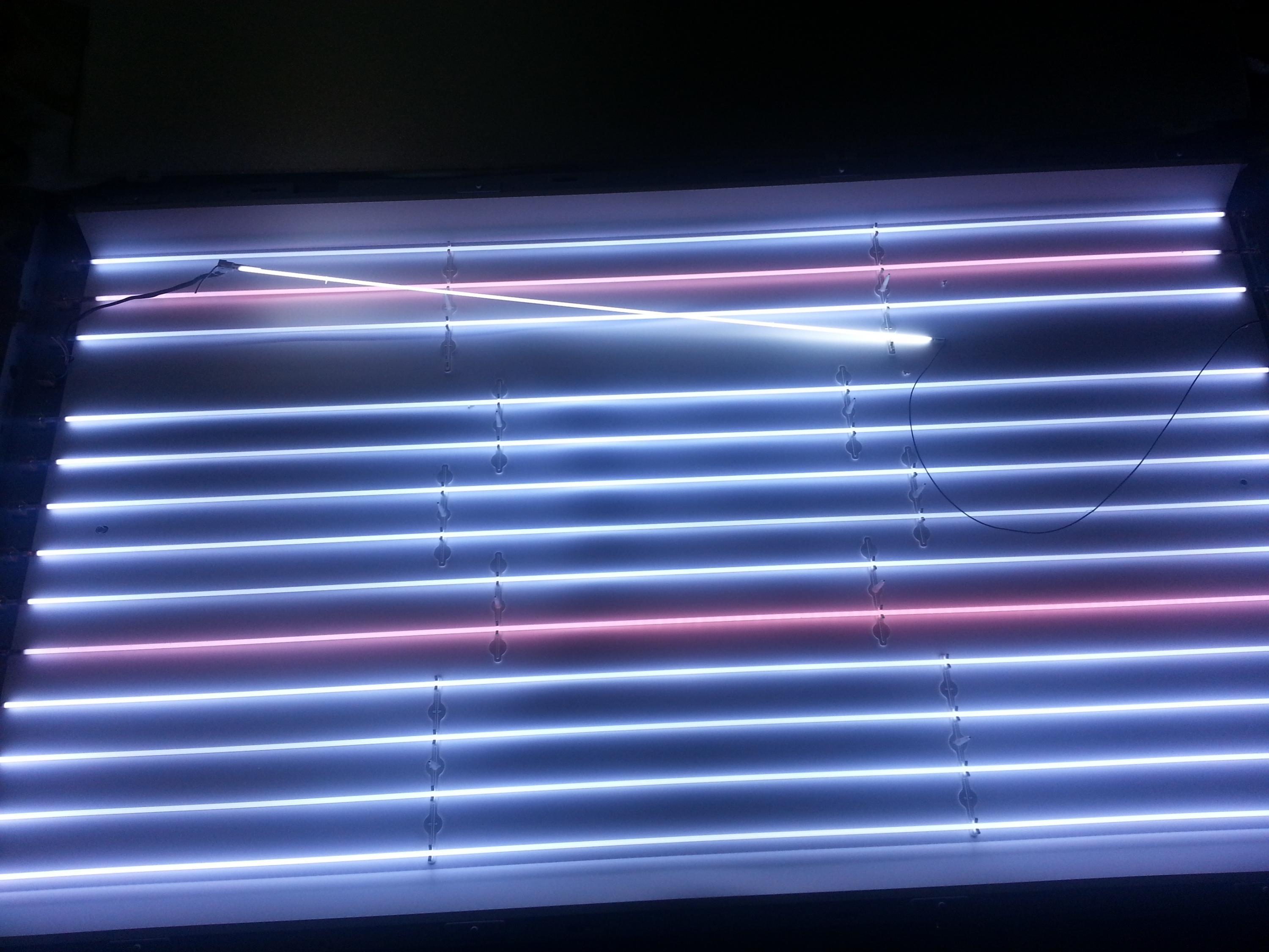

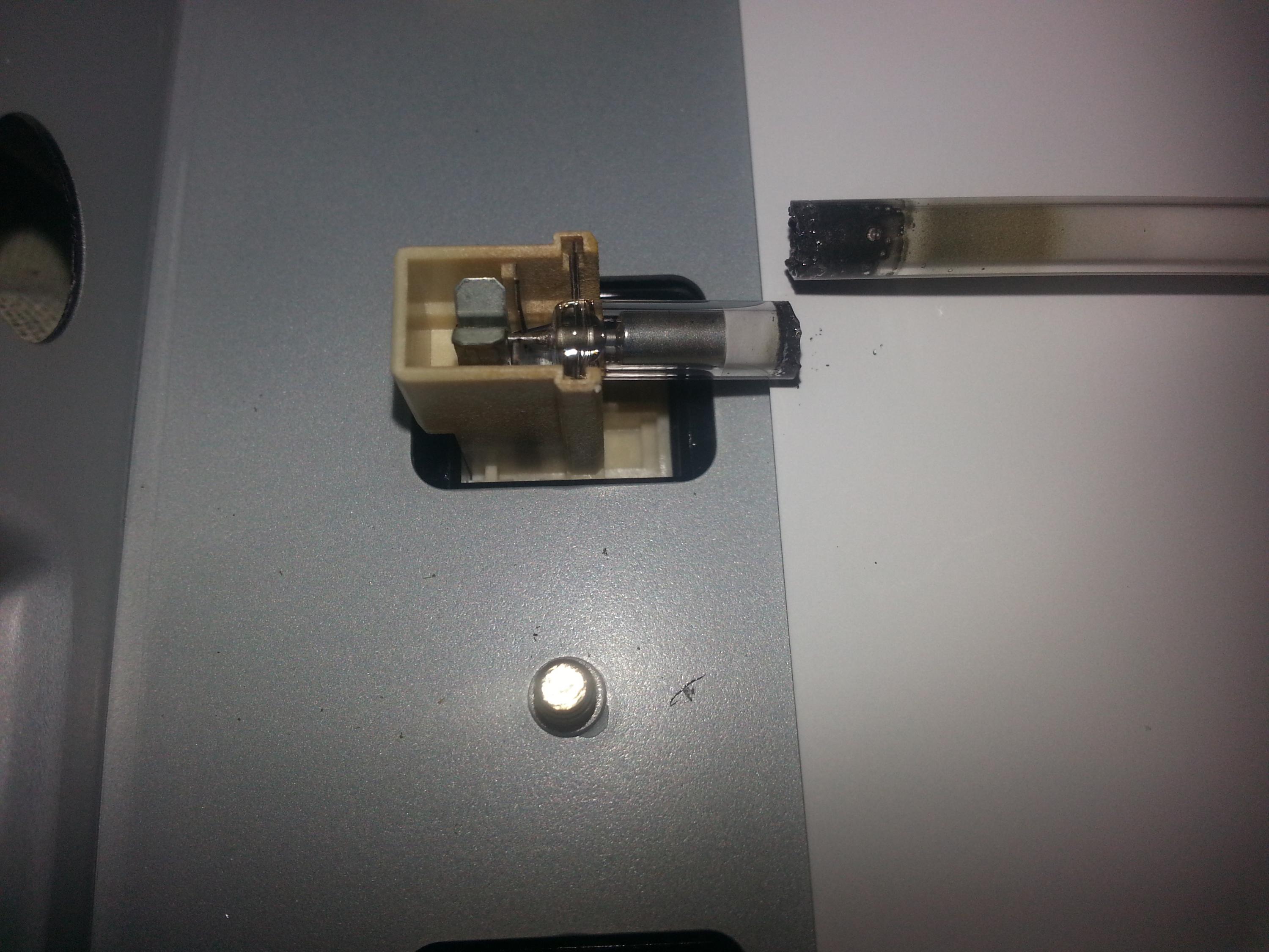

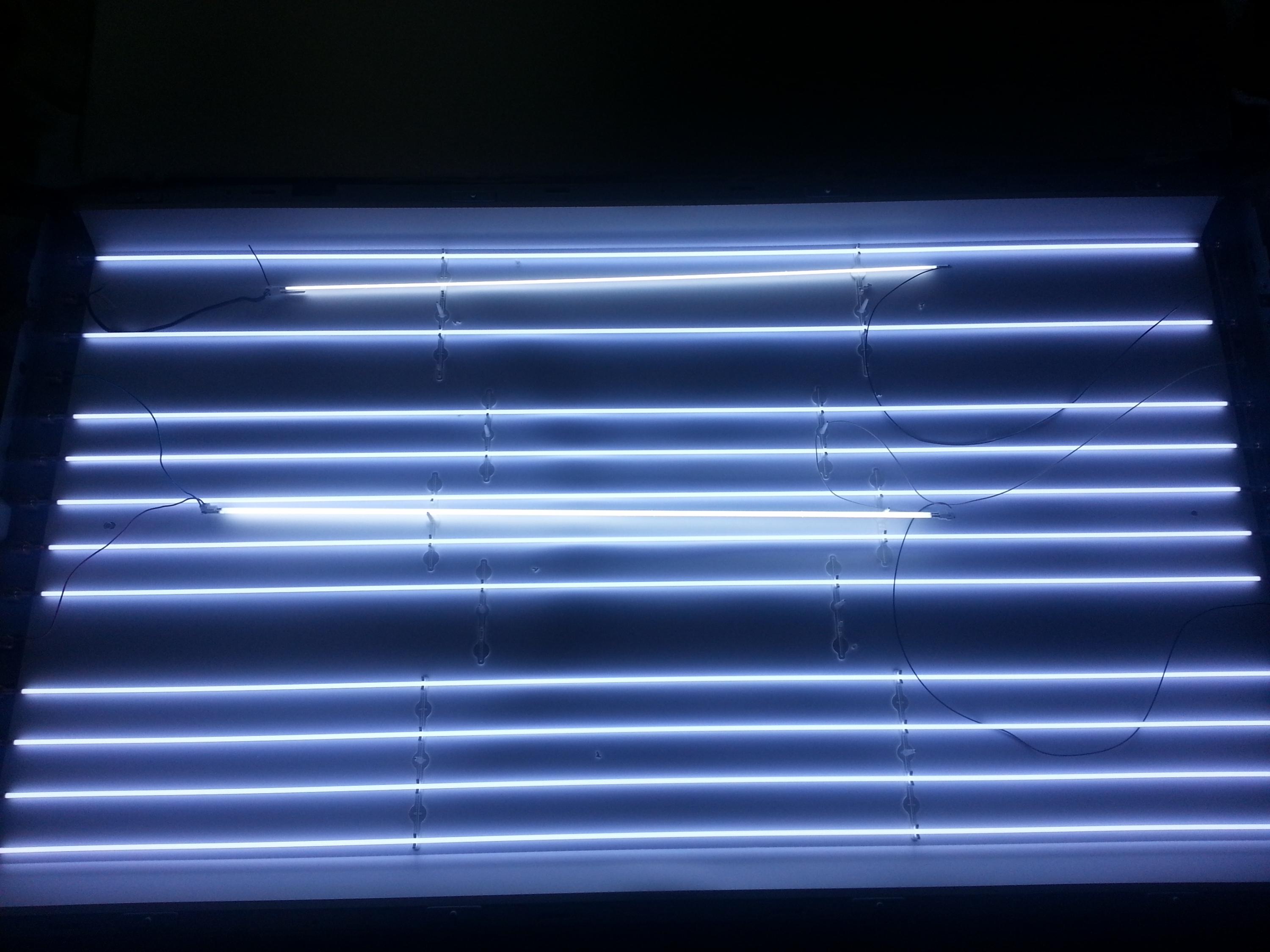

                Sister's TV back light finally quit today.
                Took the panel apart. Found one of the tubes finally snapped. Two others glowed pink until they warmed up.
                I jumped in some tubes from a monitor to replace the defective ones as you can see in the pics.
                Can somebody suggest a source for replacements? They are 4.0mm X 900mm
                  Re: Samsung 40" LCD tv model LN40B610A5FXZA new problem
                  https://www.badcaps.net/forum/attach...0&d=1558561106
                  How many of the lamps have blackened ends like that? Blackened = worn out lamps.

                    There are 3 or 4 that are blackened but not nearly as bad as that one.
                    I'd replace all 14 if it wasn't cost prohibitive. Only tube sources I've found so far want $20USD plus shipping each so wouldn't really be worth it. Going to keep looking for a cheaper source.

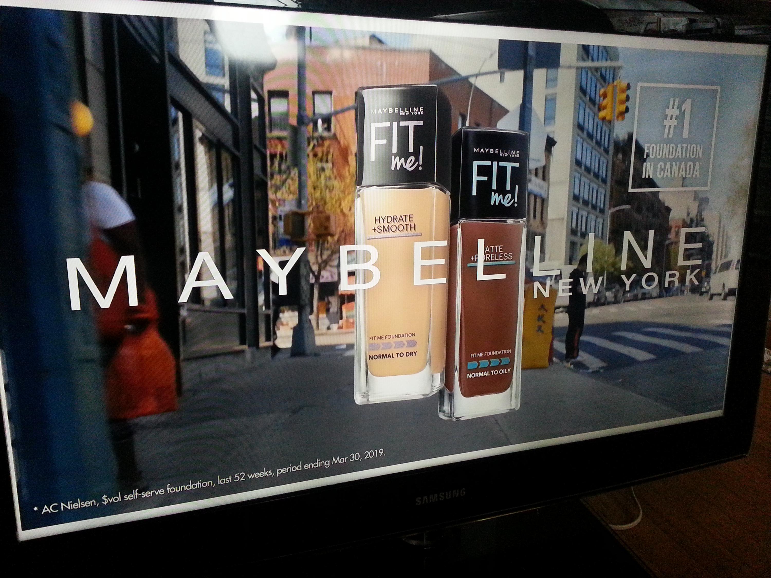

                                    Just coming back to close out this thread.
                                    I received the led strips and inverter about a month ago. Unfortunately the smoke got out of the MOSFET on the inverter a couple of minutes after it was powered on. The seller was excellent and sent a replacement right away. I installed it today. It's plenty bright but on certain screens you can see the leds, just a little bit...but it works.

                                        My original intent was to mount the strips vertically but they were too long.
                                        I thought where the leds are doubled up in the middle might have an adverse effect but it's not particularly noticeable.
                                        It was lucky that the 13 volt supply to the inverter section of the Samsung power supply board was fed through a jumper so it was easy to snip and connect the 13 volts to the LED inverter. I took the inverter on/off pin out of the power supply board connector and hooked it to the on/off of the led inverter. So the leds turn on/off with the set. I didn't connect the TV dim control to the led inverter. The led inverter uses an analog signal to control brightness and I didn't want to take a chance connecting it to the PWM dim control that the TV uses. I set the led brightness using the trim pot on the little control board included in the kit.
