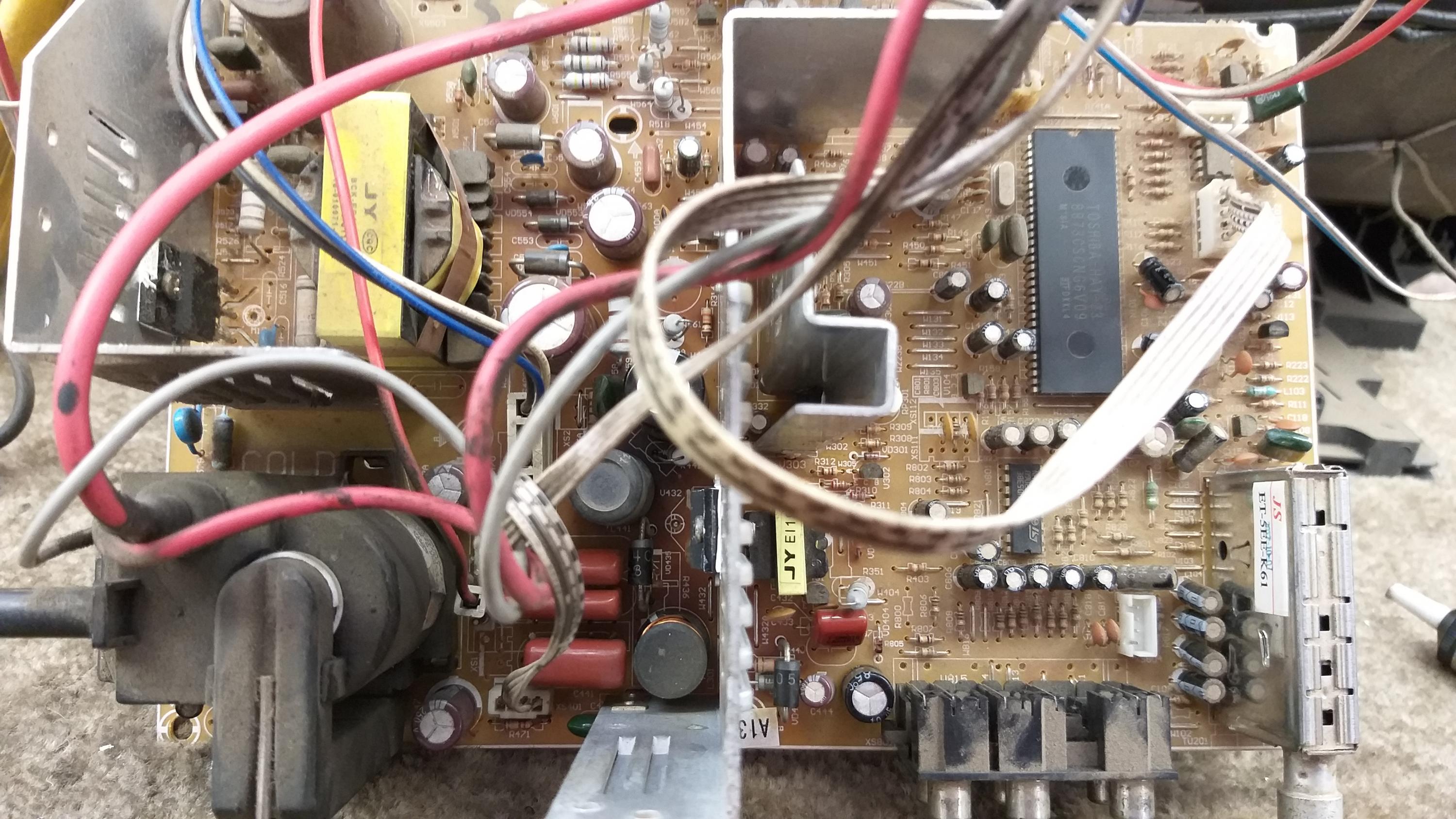

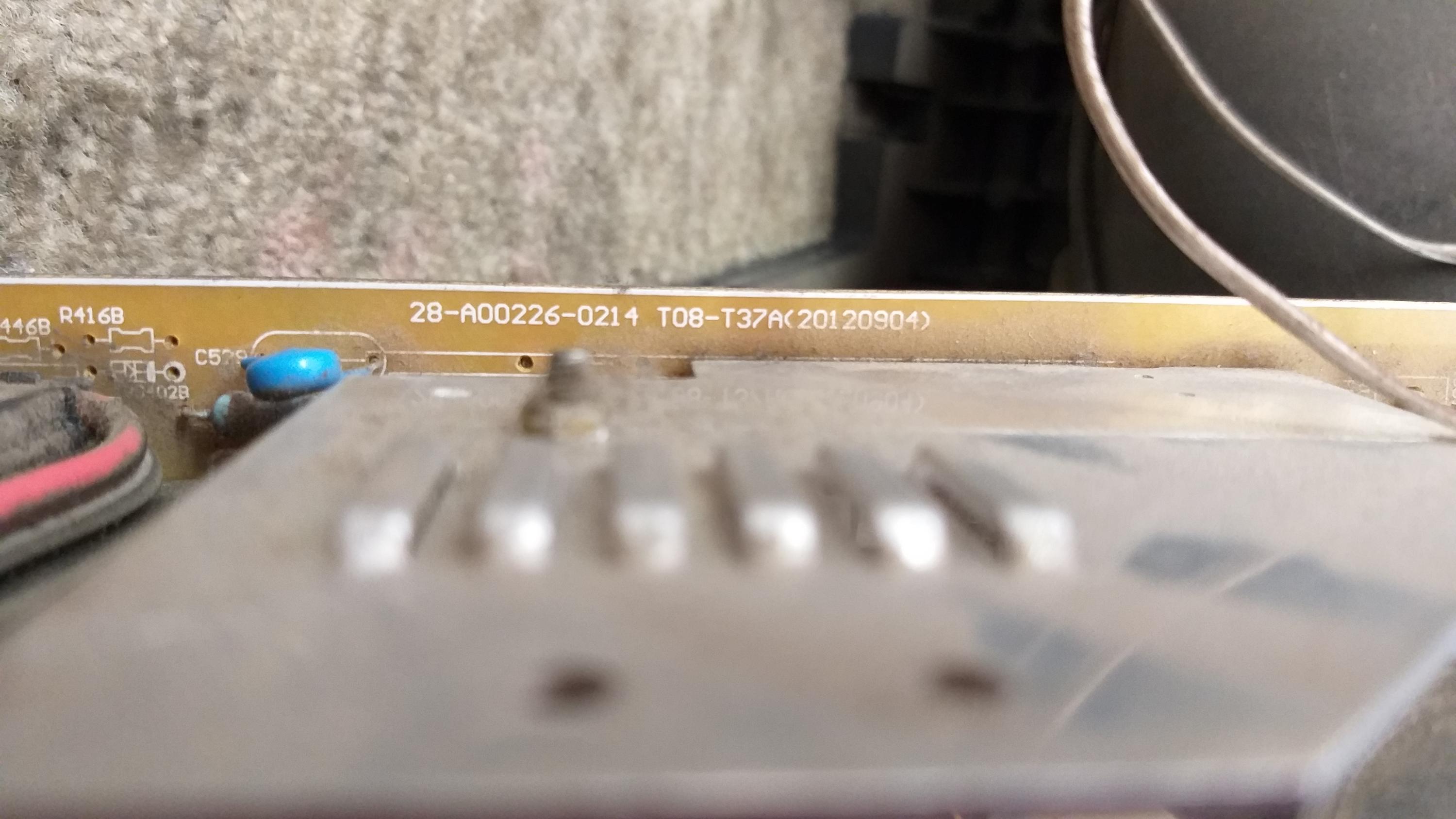

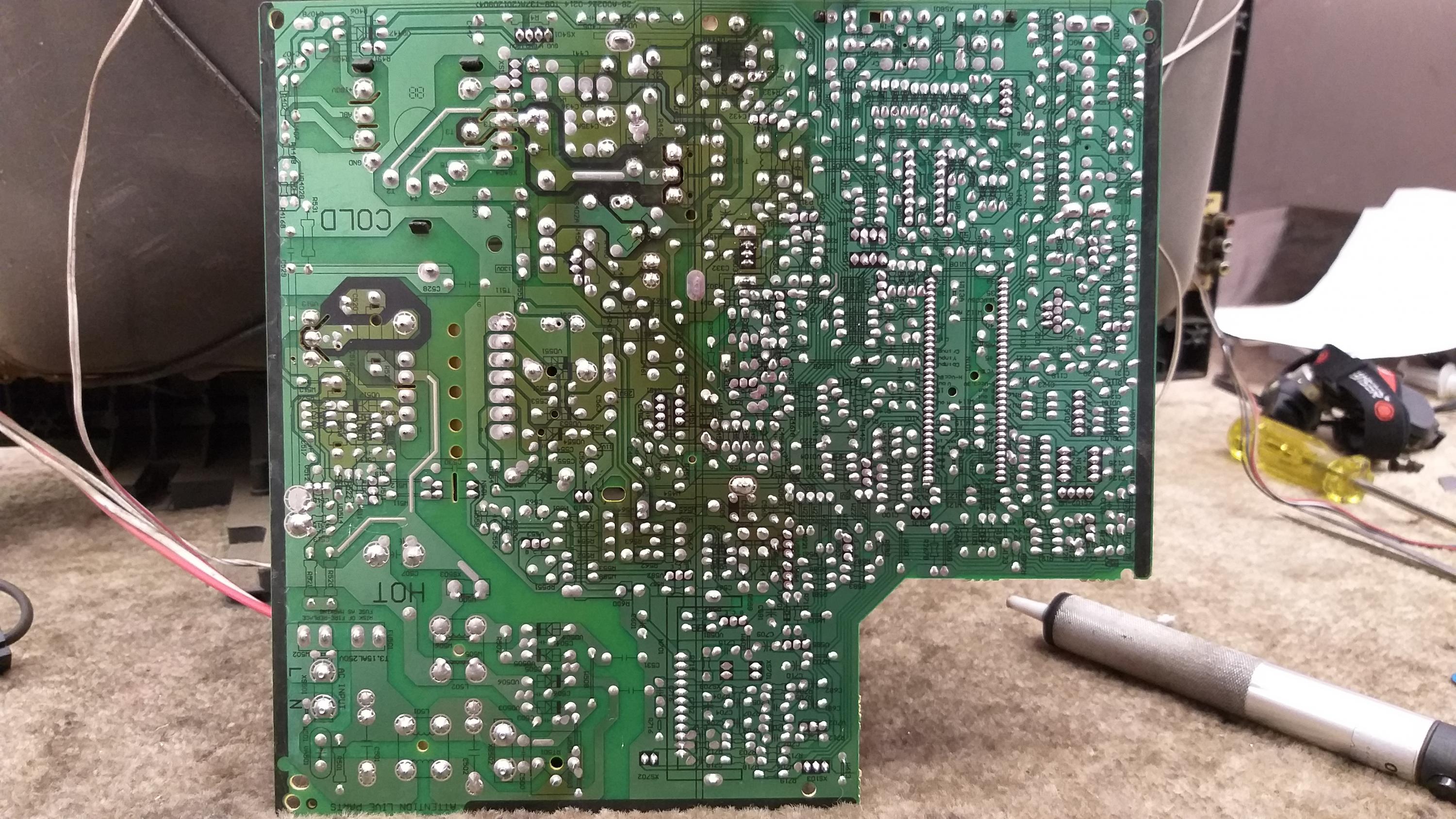

    Firstly i cannot get a diagram for this TV, its a Chinese chassis number T08-T37A. I have attached photo's for you to look.
    The symptoms were PSU no secondary outputs due to short circuit on +B line to HOT.

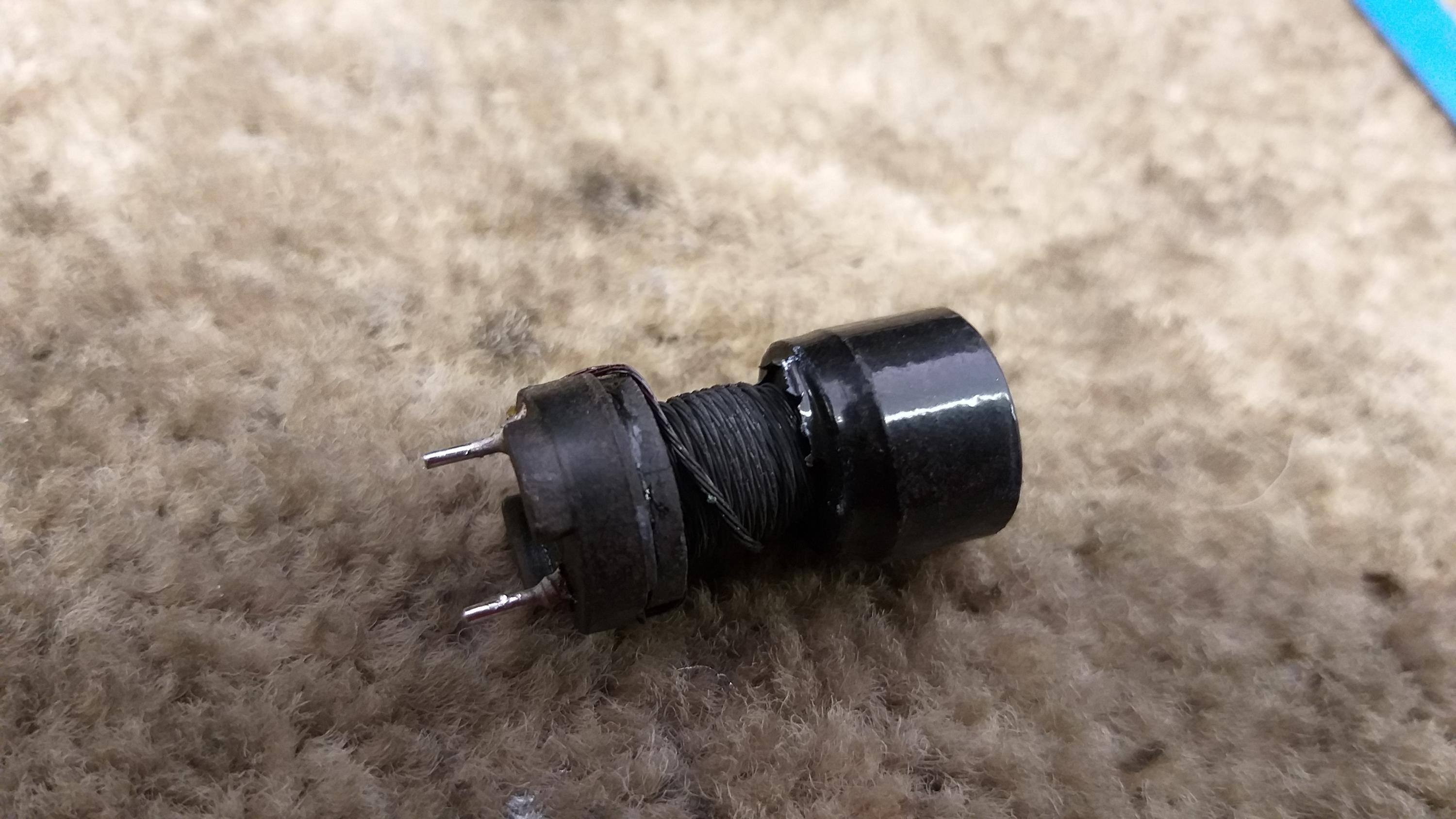

    Replaced line output transistor D5036 with new one, replaced supply resistor 1.8 ohm 1W. Checked around line stage for faults saw a burnt coil marked 37uH. Tested it measuring 45uH so i changed it out with a scrap part which i measured with my LCR meter to be exactly 37uH. Just not sure of the polarity of this coil since the original wrapping had burnt off and i know that they are polarity specific. I matched up the coils vertical line on the side with the dot on the board. Found E/W transistor shorted 2SD2012. Replaced it.
    Found a fat diode shorted on the line stage close to the HOT, RU4DS, don't have something like that so i used a RU4C, lower spec, hope it is compatible, i just thought that the RU4DS was perhaps over specced.
    Checked all non polarized caps on line stage, i think they were 470nf 800V, 9.1nF 2KV and 8.2nF 2KV, all checked good. I then decide to power up the set. It started up but i noticed that there was a frame fold over on the right hand side vertically. Was still looking to see what it could be when D5036 HOT shorted out again. Excessive heat perhaps being driven wrong??
    Checked pre driver transformer but i don't have a number like that (Y119)
    I checked scan coil for shorts by removing it from the tube neck. All checked good.
    Now my issue is what can be a suspect for causing this frame fold over, LOP
    T? I cant test that? Also i cannot trust the D5036 since it could be fake spares.
    I could upload a circuit diagram of a similar chassis if necessary just to show what we are dealing with. I have a oscilloscope to measure the HOT waveform, what i can do is remove the line HOT ans scope it's drive,BTW the+B is 132V DC which is correct on these 29" sets.

    I might also try replacing the old horz. lin coil, even though it burnt it might still be ok and your replacement could be causing the foldover.

      Replacing H- Lin coil made no difference to the fold over.

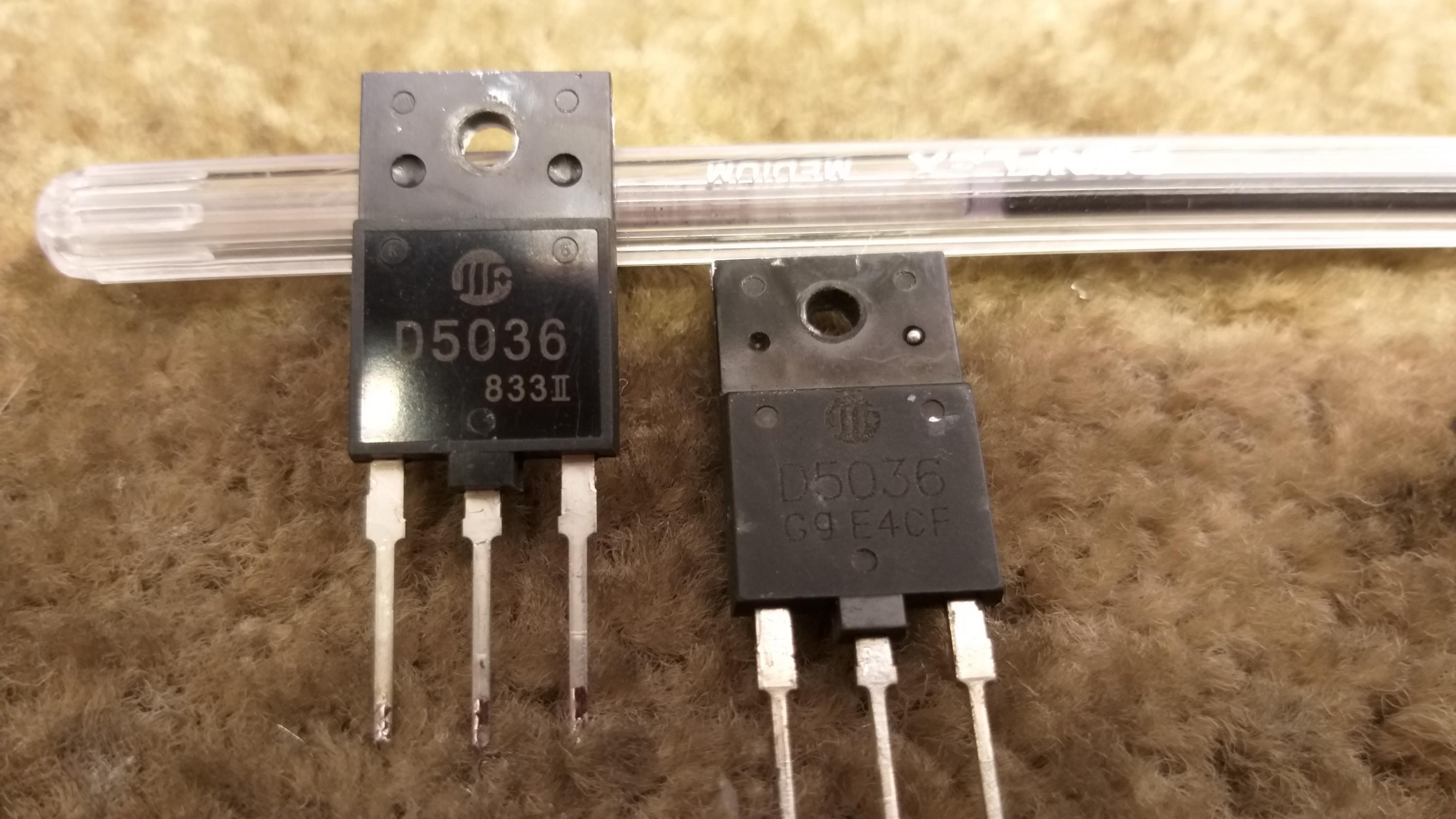

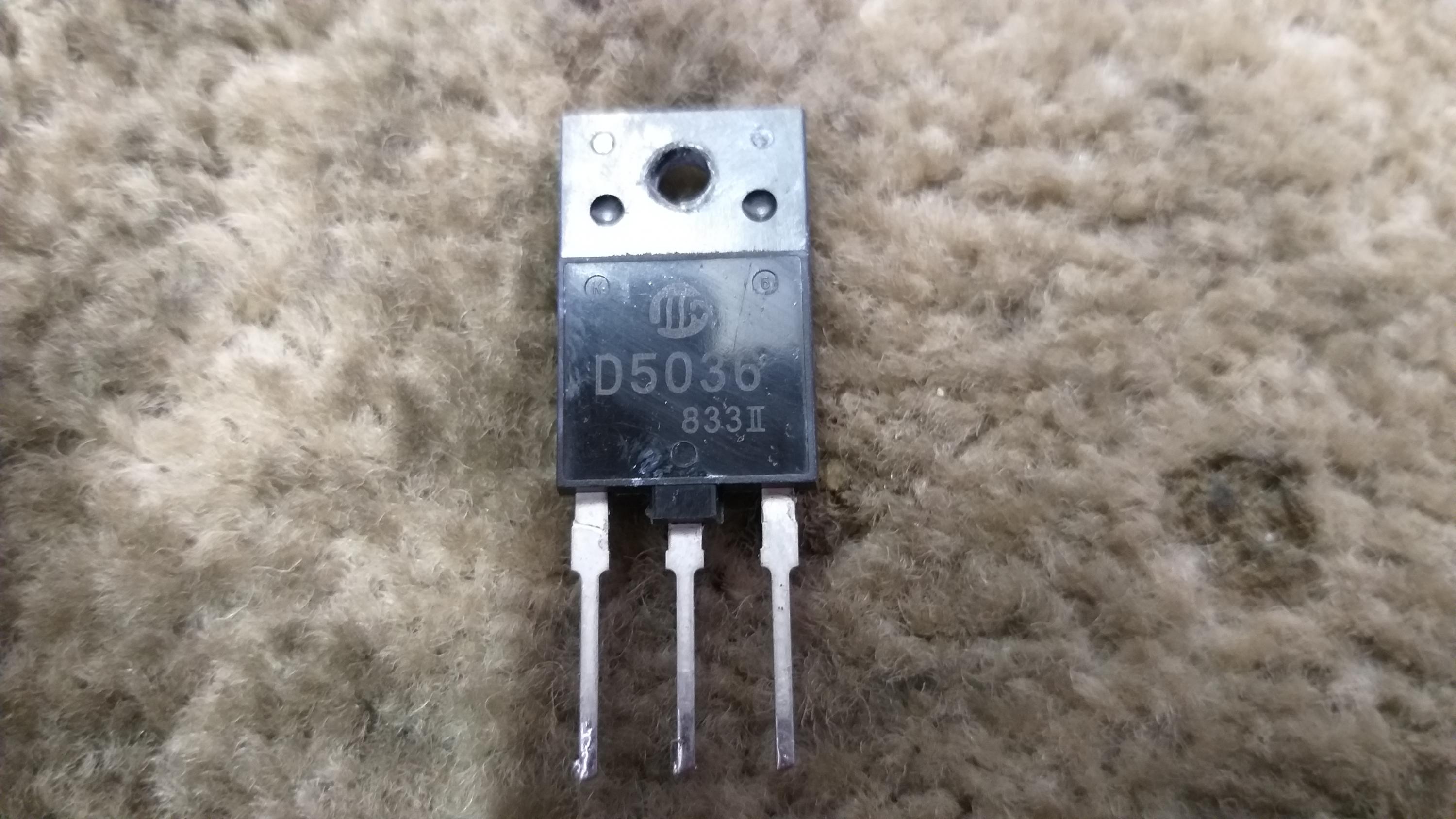

              After pondering on what Andrew said in the previous post i started by changing out the cap that smooths out the voltage going to the pre drive coil. Then for good measure i removed the D5036 transistor and went to my scraps and looked for a 2SC5296 and stuck it in. Problem solved, no more frame fold over.
              Dealing with crap supplied by our local suppliers who source this from China and all their illegal chop shops.
              Unfortunately RS components does not keep stock of tv related transistors, pity.
              Those who have Farnell, Mouser etc, you are very fortunate.
              Dead trade.......
              Check the pic for the fake part.......
