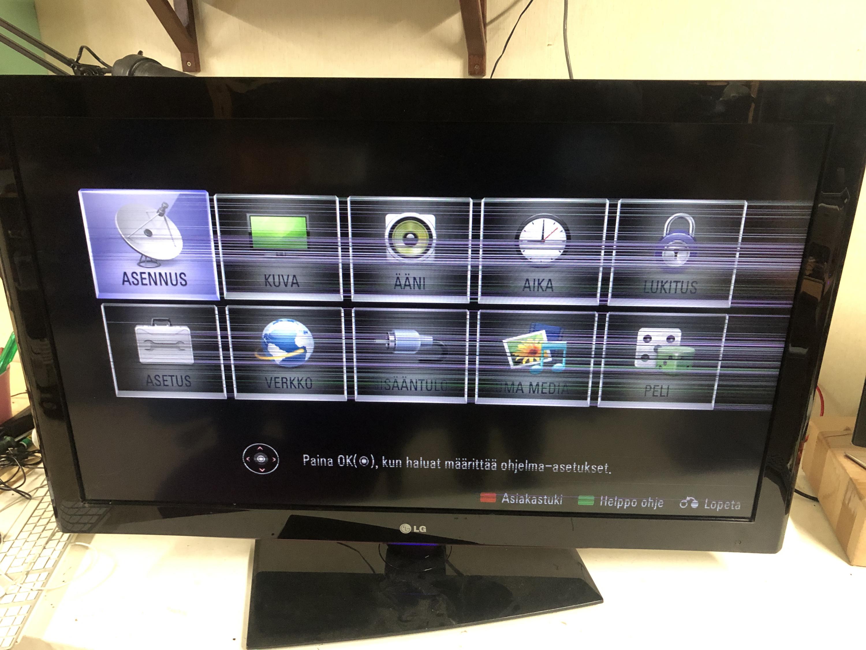

LG 42LD750N * Vertical lines flicker + screen flickers - VIDEO
  • busigkille
    • Nov 2017
    • 21
    • Finland
    Any opinions on this one? T-Con or bad panel?
    Video:
    https://www.dropbox.com/s/edcr6geh78...57.47.mov?dl=0
  • Diah
    • Feb 2013
    • 6614
    Re: LG 42LD750N * Vertical lines flicker + screen flickers - VIDEO
    reset all ribbon cable and LVDS then check again
    • busigkille
      • Nov 2017
      • 21
      • Finland
      Reseated and cleaned. Picture is completly normal now, going to leave it on for a while and hope for the best.
      Thanks for fast and good answer!
      • busigkille
        • Nov 2017
        • 21
        • Finland
        Update.
        Worked good for a while, same issue when it warmed up. Think the problem is the t-con board as it reacts when tapped on. Already ordered another one as i found one cheap.
        Pressing along the sides of tv or touching lvds cable shows no reaction.
        • Unspun01
          • Jun 2011
          • 349
          May still be the LVDS or ribbon cables, or the connections of these cables. Possibly poor ground connection of these connectors or poor soldering of the pins of these connectors. Ensure no dirt/dust/hair/lint is plugged in with the LVDS connectors.
