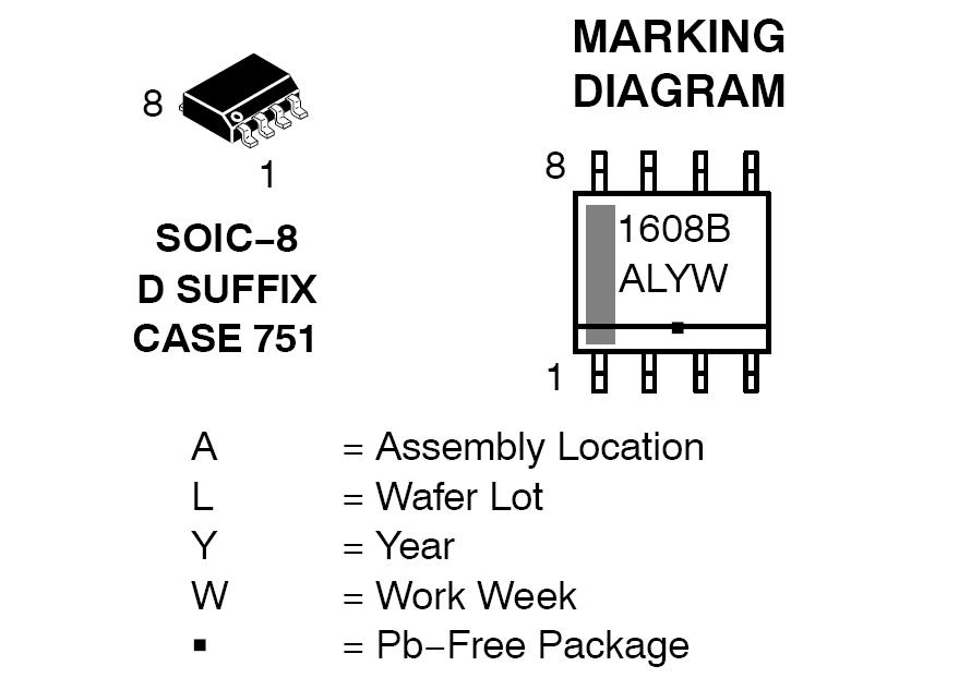

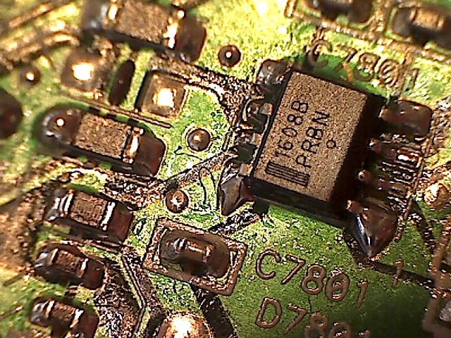

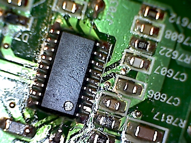

    chip orientation
    Do I have this chip in correct, I don't see a dot on it.
  • R_J
    • Jun 2012
    • 9558
    Re: chip orientation
    It looks correct if that's a 1 on the board next to the pin

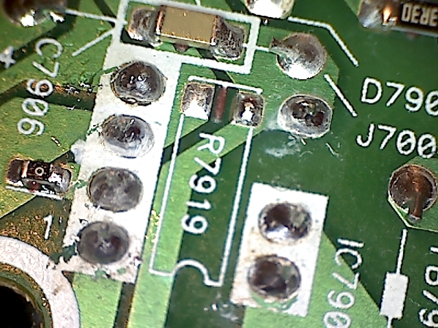

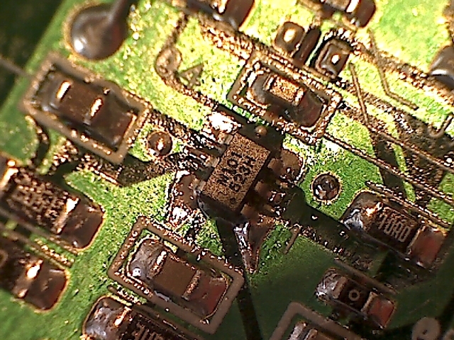

      I was hoping it was wrong because the other 2 look right and I smoked a resistor. I replaced 3 transistors they all look correct. They can go in either way right?
      • R_J
        • Jun 2012
        • 9558

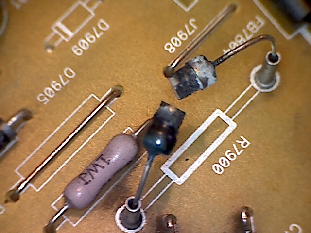

        That ncp1608 is the pfc ic, it likely drives a mosfet that is shorted, What's the board used in? Is this a Sharp power supply board by chance?
        If it is, and that R7900 is blown, IC7903 shorted.
        As for transistors, they only go in one way, the correct way.
          Yes Sharp DPS-162KP. I did replace 7903 and joints look good but it fried also now that I looked at it.
              Which ic are you talking about? What mosfet are you refering to?
              the ic in post #1 has nothing to do with the ic pictured in post #5
              What number are you replacing IC7903 with? IC 7903 is the standby controler ic. It has nothing to do with any mosfets,
              The blown resistor in post #3 picture 3 is the fuse resistor for the standby ic IC7903
              You have likely caused more problems by installing parts backwards
