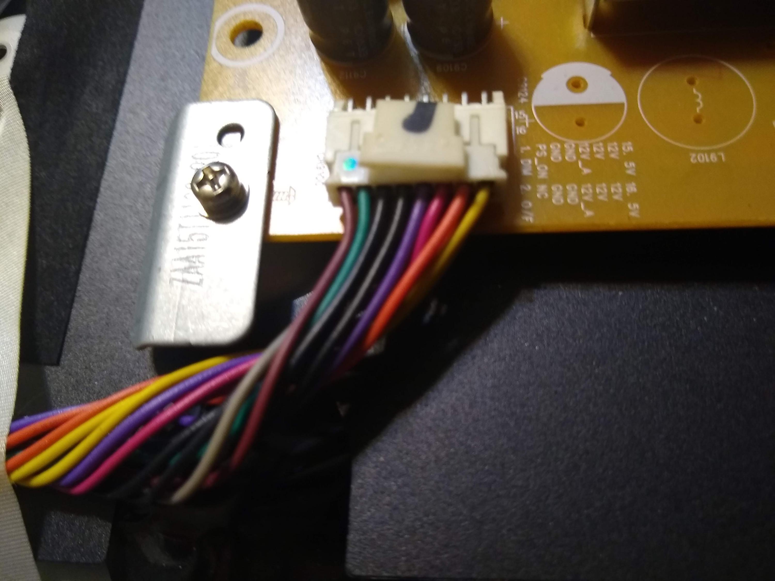

    I have a LG 55LF5700_UA LED tv
    The standby light is on, I can see the picture with the flashlight test, and there is no back light. I test the standby power at the power board and there is no power. The 2 Led+ test points are only showing 30.3 V.
    I can not find schismatics for this board but is it possible that there is a separate ground for the standby voltage? Thanks
    Power Supply Board ((X)PLTVEW401XAT9) Voltages:
    1. DIM: 2.33
    2. O/F: 3.34
    3.PS: 3.36
    ON
    4.NC 0.00
    5. GND
    6. GND
    7. GND
    8. GND
    9. 12v_A: 11.96
    10. 12V_A: 11.96
    11. 12V: 11.95
    12. 12v 11.95
    13. 12v 11.95
    14. 12v 11.95
    15. 5v 0.00
    16. 5v 0.00
    LED Voltage
    +Led 1: 33.3V
    +Led 2: 33.3V

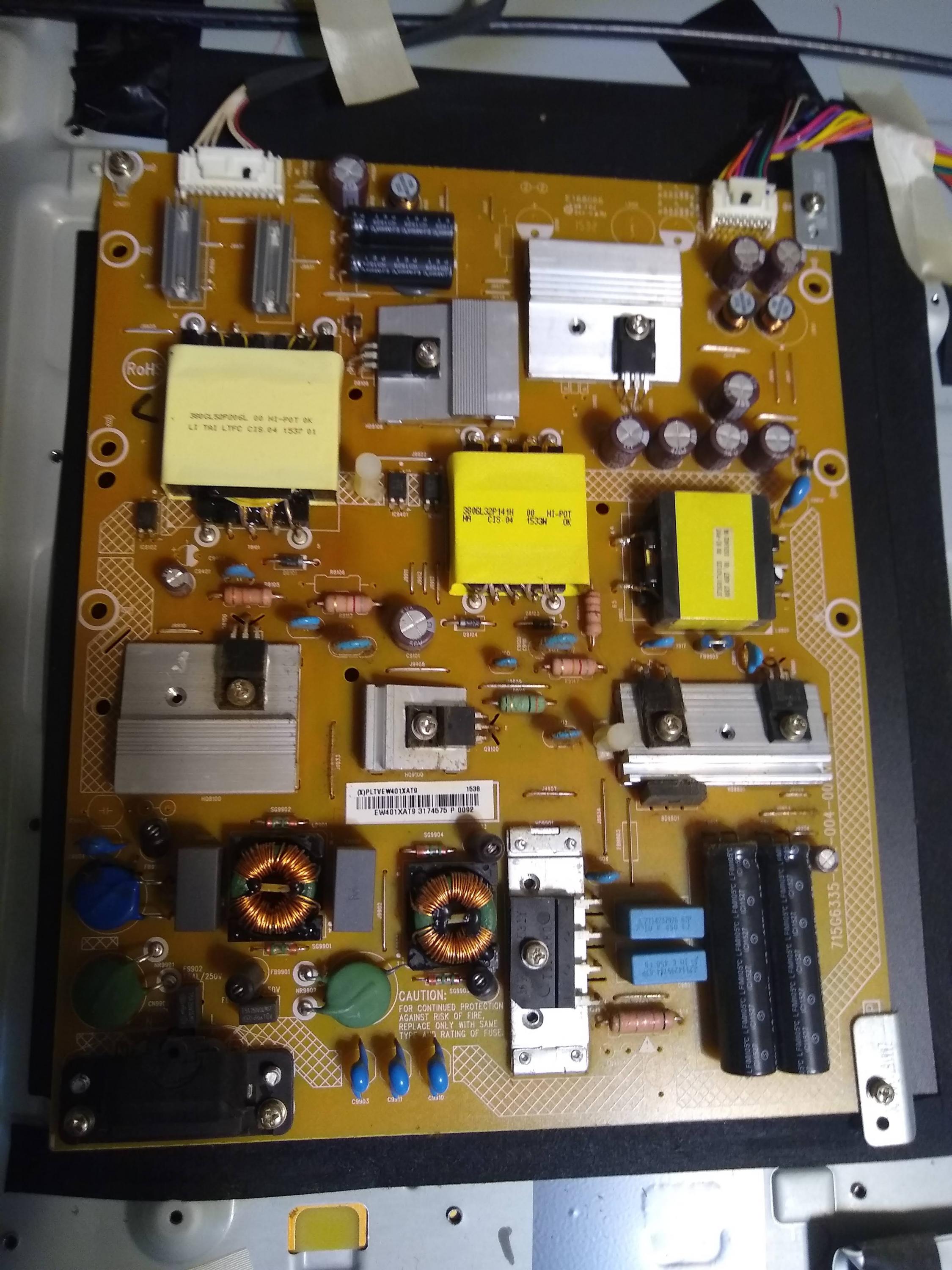

    Re: LG 55LF5700-UA.CUSDLH - Black Screen, can see image with flashlight test
    We need to see the pictures of the backside of the TV showing all the boards and good clear straight shot of the whole power supply board so we can see what we are dealing with.
    • Jermo133
      • Feb 2019
      • 12
      Sorry I forgot to add these. Thanks again for the help.
          Maybe try unhook cable from powerboard to mainboard and see if your standby voltage comes back.

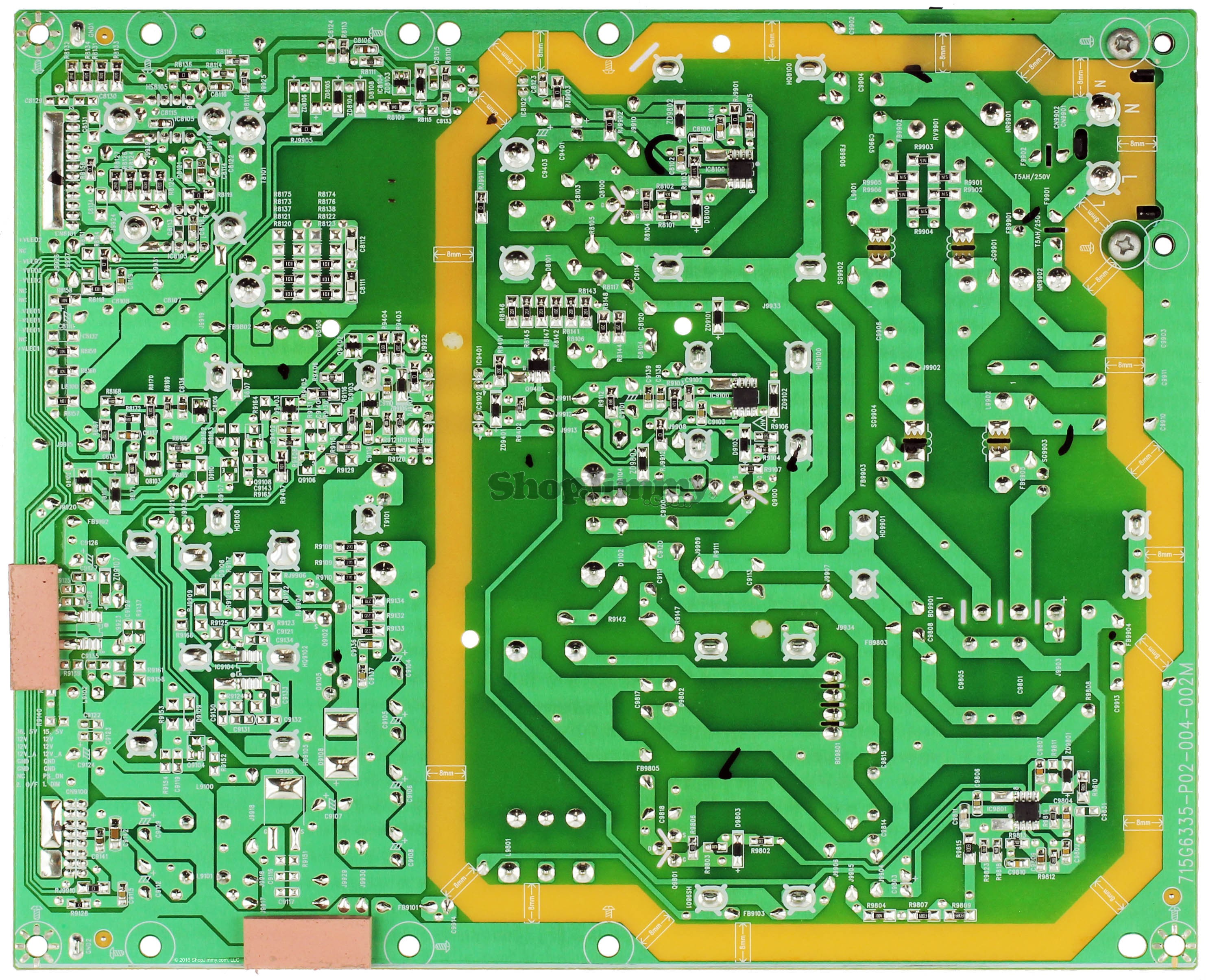

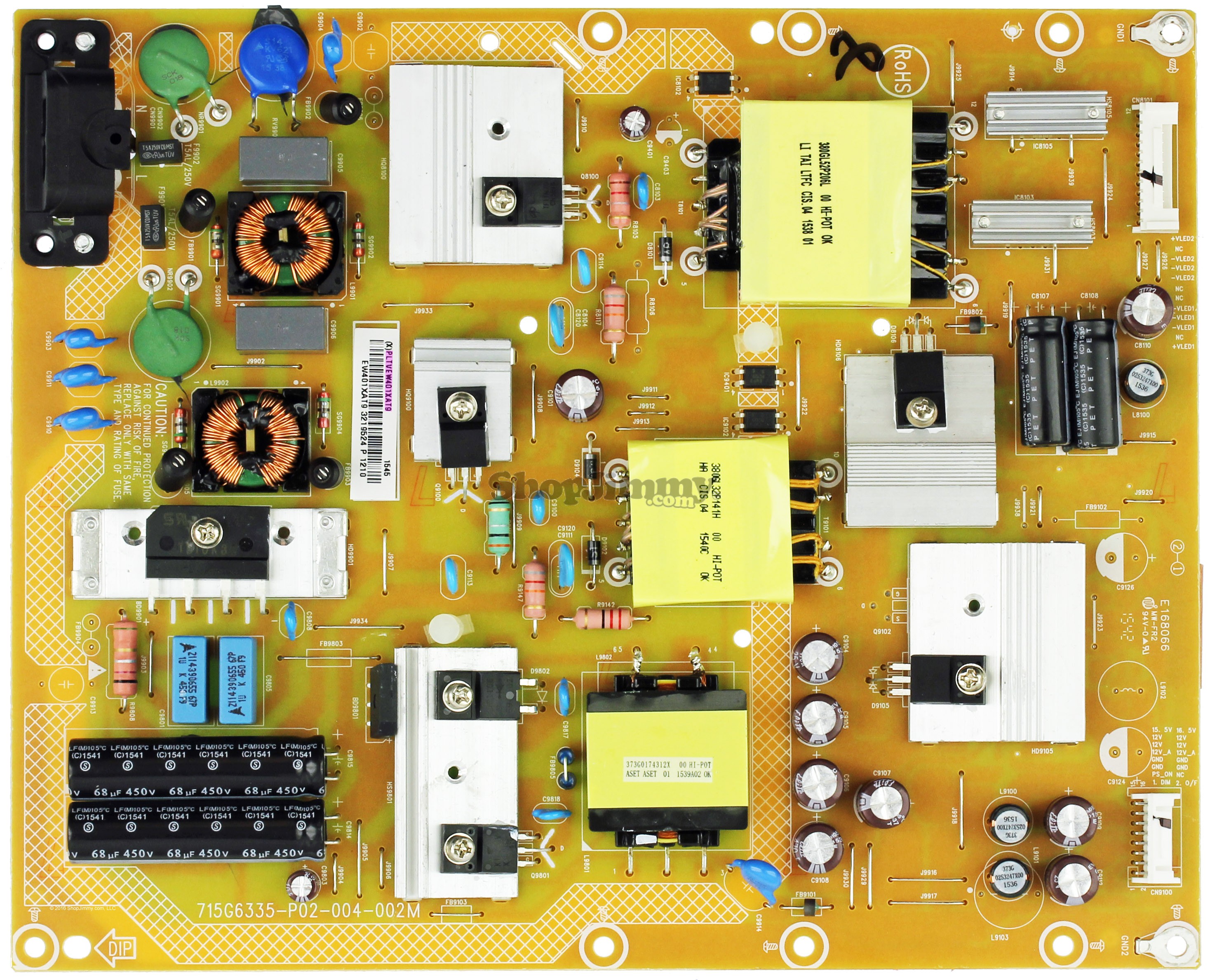

            1) The power supply PCBA for your TV does not have 5V standby section stuffed with parts that is why there is no 5V (as you can see from the board layout https://www.shopjimmy.com/lg-pltvew4...ply-board.htm#), it use 12V as standby.
            2) All the control signals are normal.
            3) Put the Volt meter (set to 200vdc scale) probes on the two legs of capacitor C8107 then turn the TV on while watching the meter to see how high the Voltage jumps up to and then wait 10 seconds to see how low it goes down too.
            4) To probe the Even number pins, you can use skinny probe to probe from the wire entrance side of the connector.
            5) Taking the panel apart is the last thing you want to do after all the testings are done.
            Pictures provided by shopjimmy: LG PLTVEW401XAT9 Power Supply Board

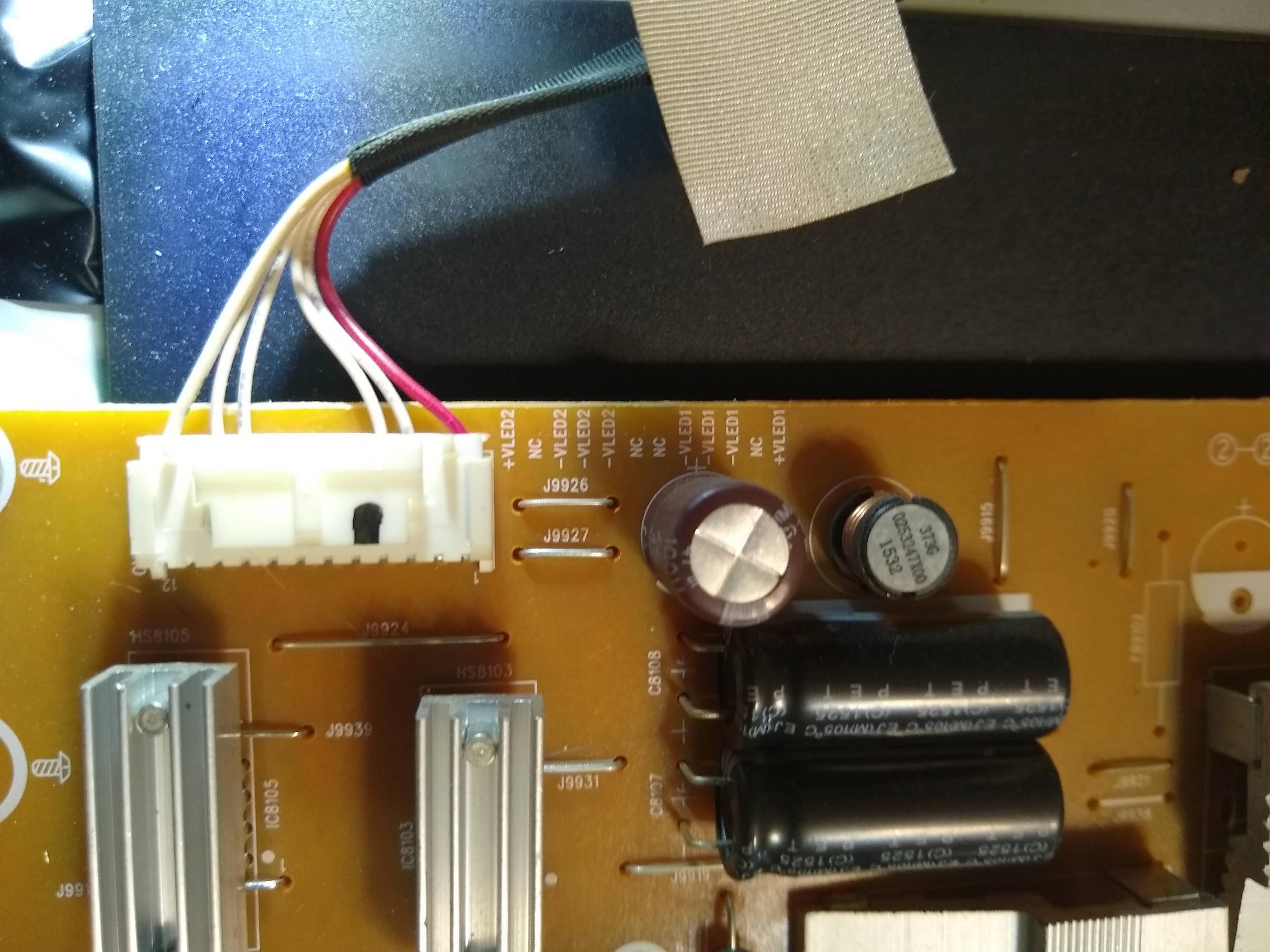

                        OK so the Voltage did get boosted up to 52V (seems kind of low) but then it goes into protection mode and drops down to 33V.
                        You have 4 LED strings so we need to fine out what Voltage you have on the Cathode return pin of each LED string when you first turn on the TV.
                        1) Leave the TV off, meter set to DCV mode, keep black probe on the chassis.
                        2) Put red probe on any one of the -VLED1 pin, then turn on the TV while watching the meter to see how high the Voltage goes up to then wait 10 seconds to see how low it goes down to.
                        3) Repeat step 2 but with red probe on -VLED2.
                        BTW, what is he LCD panel model number? The LCD panel spec may provide some info about the LED's.
                        I am not sure if your LCD uses these LED strips or not: https://www.shopjimmy.com/lg-insigni...5dr420na16.htm
                        • Jermo133
                          • Feb 2019
                          • 12
                          budm,
                          I get the same reading on the +VLED1 and +VLED2 52.5 when I power it on and drops 33.3v
                          I get no voltage when I test -VLED1 or -VLED2
                          Where do I find the LCD panel model number?
                          I was looking at the same LED strips in your link and I am pretty sure they are the correct ones. I am also looking at a SID LED Lamp and TV Backlight Tester. I hope to start working on more tv's instead of everyone in the family just going out buying new ones all the time.
                          Thanks!
                            Originally posted by Jermo133
                            budm,
                            Thanks!
                            You did leave the red probe on the -VLED1, or -VLED2 before turning on the TV, correct? It is kind of unusual to have all 4 LED strings with open circuit on all four.
                            • Jermo133
                              • Feb 2019
                              • 12
                              Yes sir, I left the probe on and turned on the tv. I get no voltage at all on the
                              -VLED1 or -VLED2
                                What Voltage do you have between the two legs of cap C9815 (68uf 450VDC) when TV is turned on?
                                • Jermo133
                                  • Feb 2019
                                  • 12
                                  Originally posted by budm
                                  what voltage do you have between the two legs of cap c9815 (68uf 450vdc) when tv is turned on?
                                  388v
                                    388v
                                    OK, that is good, the PFC Voltage booster circuit is working.
                                    I am still not sure why you are see 0V on the -VLED return of all the LED strings.
                                    Having the LED tester in this case will help to tell us if you have open circuit in all 4 LED string or not. We do not want to open up the LCD panel unless we really have to.
                                    Looking at the LED strips and the way the LED connector is wired up, the panel has 72 LED's and there 4 LED strings, two strings are connected parallel so total of two pairs of LED strings, that means it has 18 LED's per string, so if they are 3V LED at 200 ~300mA, then the power supply output needs to be about 18 LED's x 3 = 54V + about 20V vdrops for the constant current control element, so output should be about 75V.
                                        BTW, can we see the pictures of the whole back side of the the TV showing all the boards?
                                        Did you find the LCD panel sticker model number?
                                        It is kind of sad that these new TV's only last a few years.
                                        BTW, what is the Voltage rating as printed on cap C8110?
