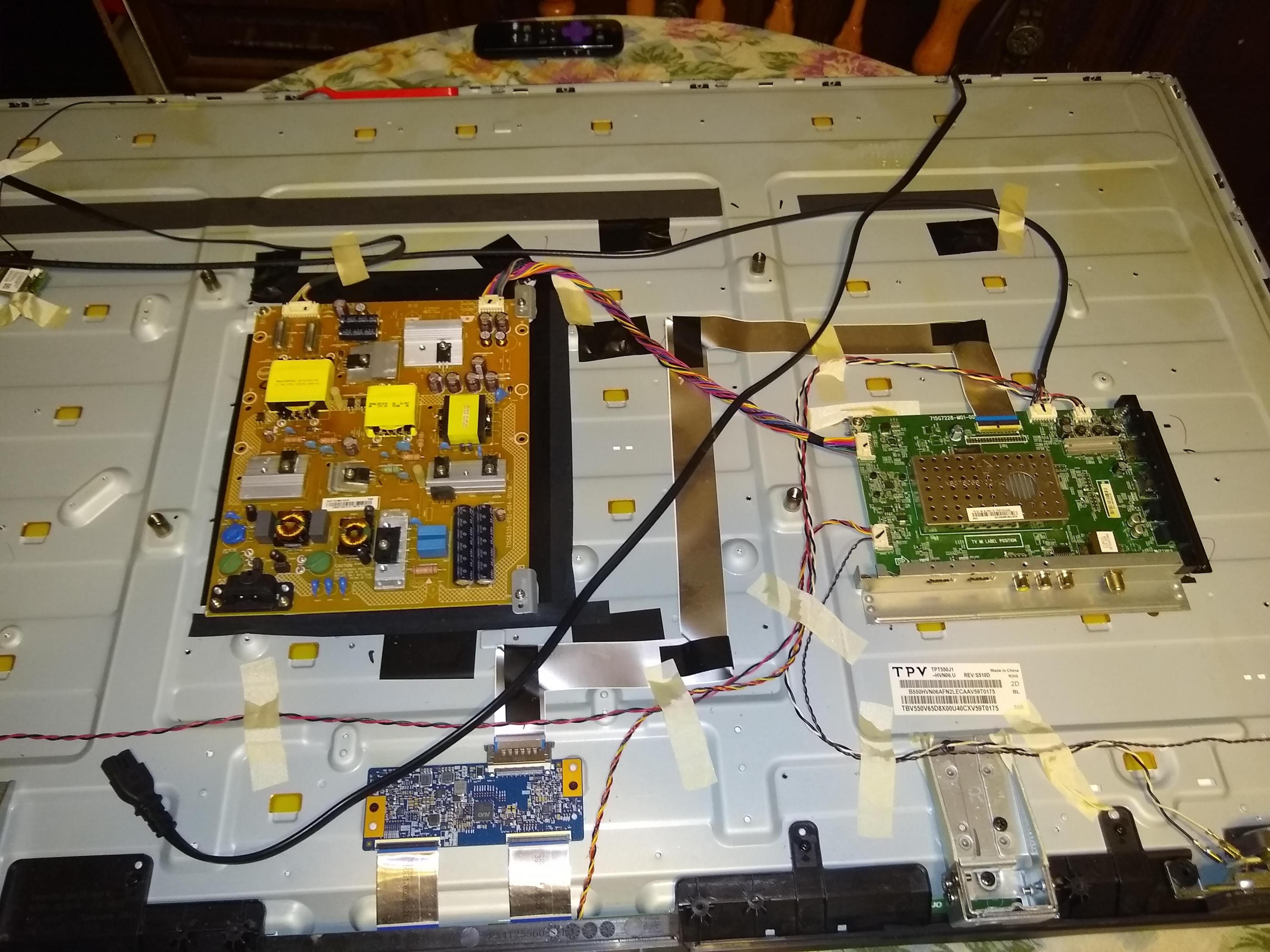

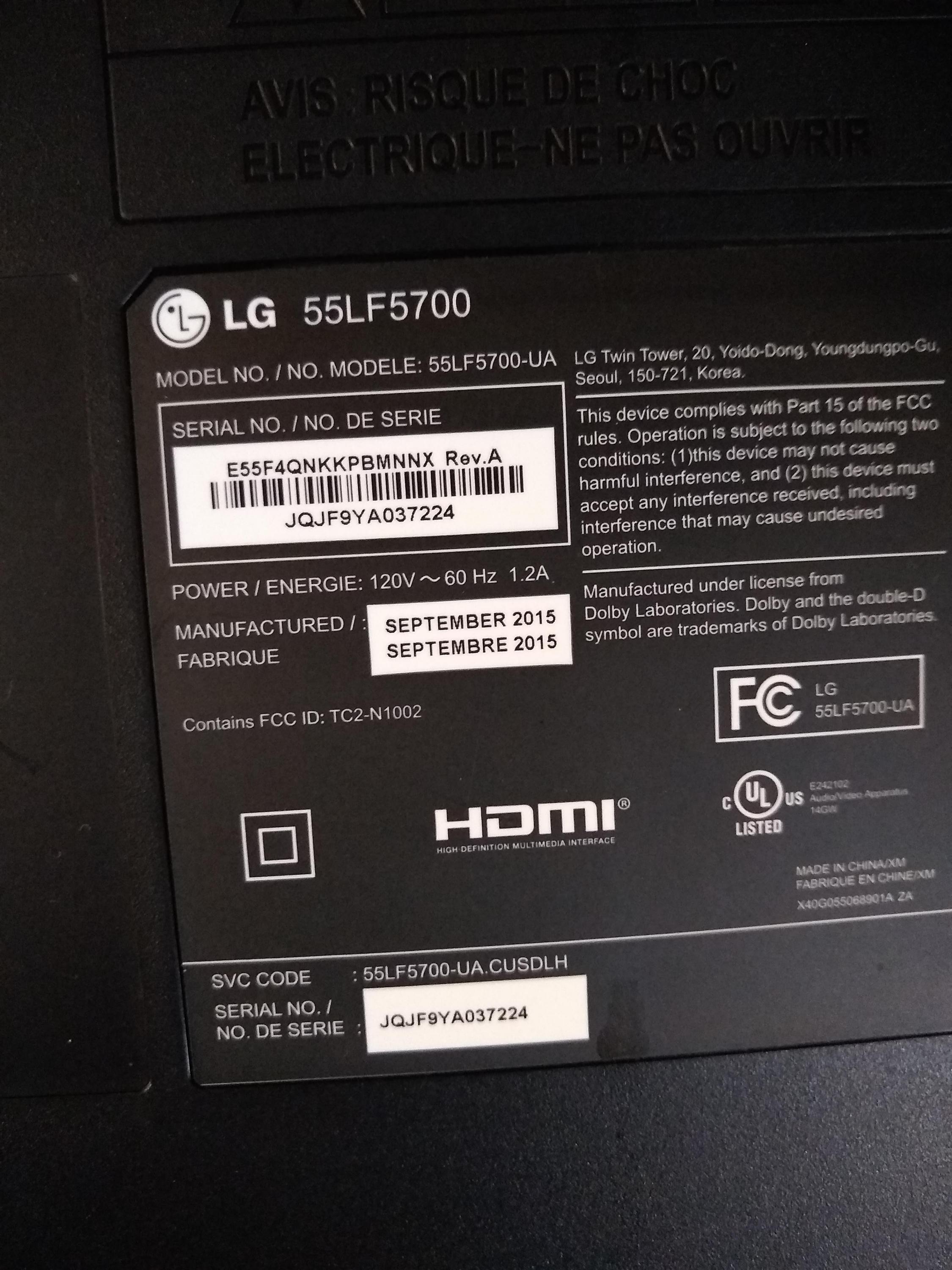

    Here is the picture of all the boards, and The model numbers I see. The rating on the C8110 cap is 100v
    Thanks!
      Re: LG 55LF5700-UA.CUSDLH - Black Screen, can see image with flashlight test
      Thanks!
      Thanks, at this just wait for the LED tester so we can find out what is going on with the LED strips.
