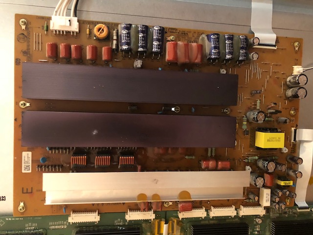

      Re: lg 60pz550 black screen, no power, etc
      Here are the pictures as requested. Thank you for helping me
        What did you re-solder? Just the coils on the y and z sus boards? There could be bad joints on the power supply. Check them out.
        • legonch
          • Feb 2019
          • 49
          I did just resolder the connections on the two boards. Tv powered up fine before i did that though. Dont see anything that i did that would cause the tv not to power up.
          i used an ohm meter on all the fuses. they all check out. I dont think i need to remove the fuses from the board to check them do i? They are soldered in type.
          • tvtimmy
            • Mar 2015
            • 1160
            • usa
            So to be clear , you only fixed the joints on these parts circled in red?

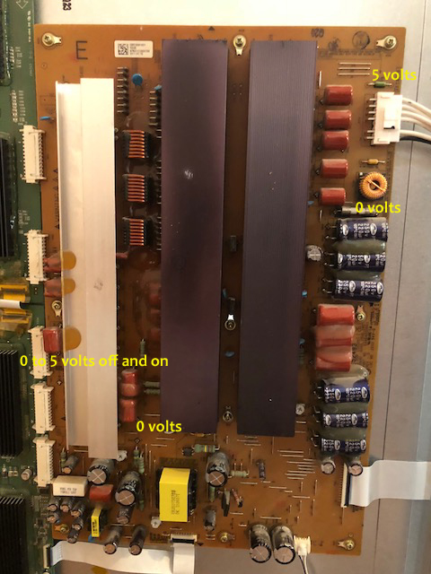

                • legonch
                  • Feb 2019
                  • 49
                  yes, thats all i touched. just disconnected the boards, resoldered the connections, and put back together. Nothing else
                  • legonch
                    • Feb 2019
                    • 49
                    I did some multi meter tests, pic shows where I have voltage and where I dont. One relay clicks when I plug it into the wall.
                    I have a long long short short pattern on the led light on the smaller board
                    I can not get tv to power on with the remote or by touching the button in front, this used to work before the solder as well.

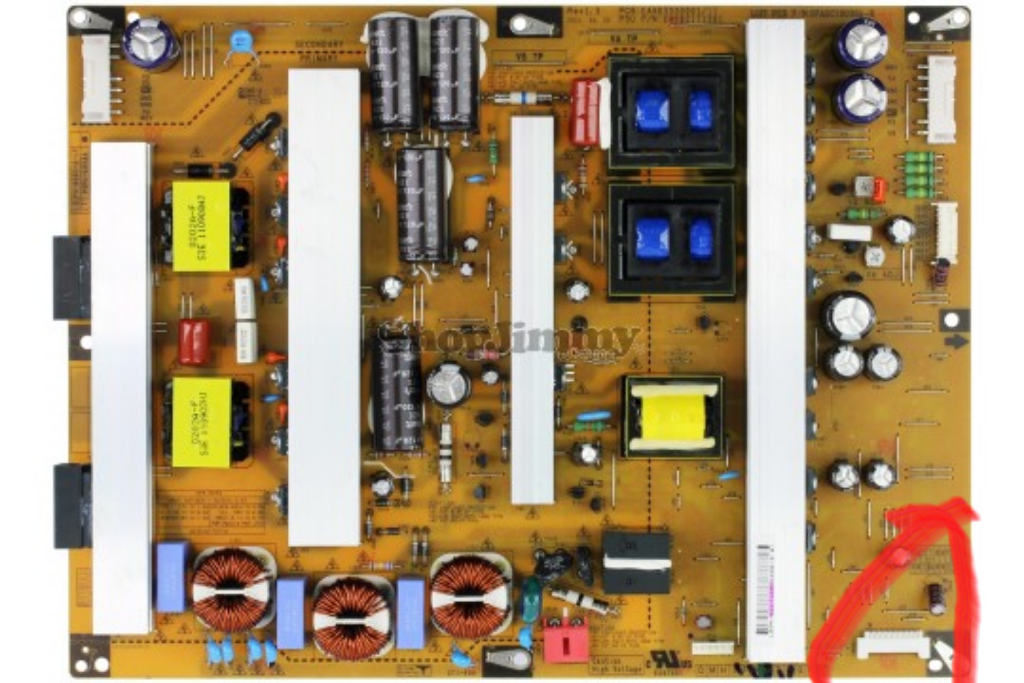

                      Here is a list of parts from a repair kit. Start with checking the 5v standby pin and then check the parts on the list.
                      • legonch
                        • Feb 2019
                        • 49
                        Im not sure where the standby pin is located. That the 5v labeled on the ysus and zsus boards?

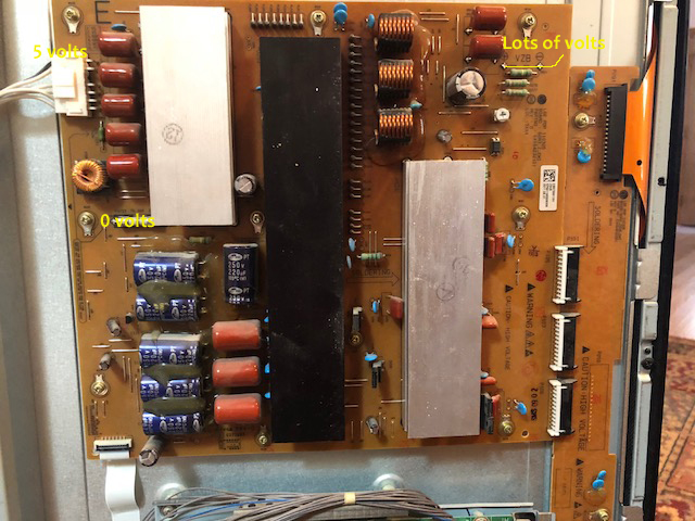

                          • legonch
                            • Feb 2019
                            • 49
                            Okay, got a new multi meter. Attached is the pictures of each board with the noted voltages. I do have 5 volts on both the sus boards. on the left board, on the left lower side, the place to test voltage, i get 0 volts then 5 volts, and repeats.
                            Any ideas?

                              • legonch
                                • Feb 2019
                                • 49
                                found some of the mosfets are grounded.
                                the second heat sink up from the bottom on the left board gets smoking hot, the rest do not. That mean anything?
                                Ive got the correct voltages going to each sus board.
