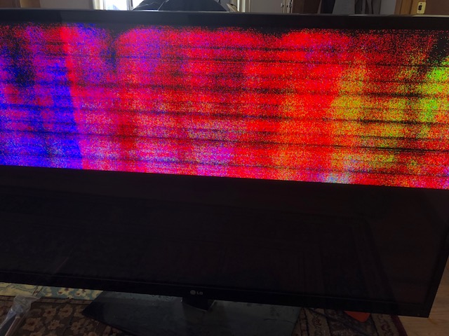

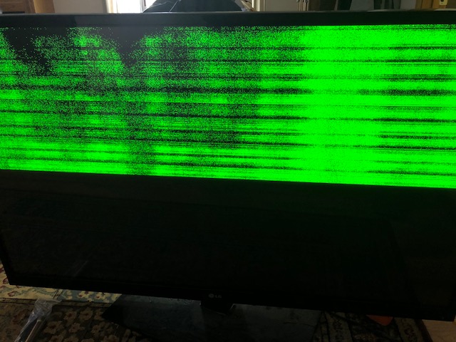

                                    Further testing continues. I removed the upper buffer board on the left side of the ysus board. TV remained the same. Reinstalled this board.
                                    Middle heat resistor on the lower buffer board has been getting super hot. Removed the lower buffer board. TV now will run a test pattern type on the upper part of the screen. Attached are the pics of the test pattern.
                                    The two chips under the middle heat sink have heat damage on the back side of the board. Im suspect this is the issue. Recommend just replacing board? Or try and just replace the chips? If just the chips, can you tell me how to diagnose via volt meter?
                                    • Unspun01
                                      • Jun 2011
                                      • 349
                                      #78
                                      Re: lg 60pz550 black screen, no power, etc
                                      legonch:
                                      You are our eyes and ears on your TV so I'm glad you noticed the burn marks on lower buffer board. Definitely sounds faulty.
                                      With lower buffer board removed, and since an image on screen - you have a functioning YSUS board (as we suspected since your fuses were good and no shorted parts)
                                      Regarding the buffer board:
                                      Replacing the individual chips on a buffer board is difficult, requiring delicate and precise work.
                                      After seeing your soldering on the YSUS and ZSUS coils, I do not feel you have the tools or level of skill required to perform buffer board repair so I think you would find it easier and be successful with complete lower buffer board replacement.
                                      Your photos tell me you still have mal-discharge issues that suggest ZSUS problems so we may have to come back to that board. However, try replacing the lower buffer board and then we will see what can be done for the ZSUS board.
                                      Did you ever adjust voltage potentiometers on the power supply by accident?

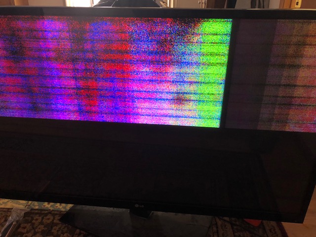

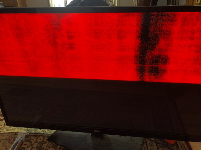

                                        I ordered a lower buffer board. I agree the screen still seems like there is an issue somewhere, all the pixels arent lit up. They seem to move around if that makes any sense. Like some coming on some shutting off.
                                        I will check in when the board gets here. Thank you again for all your help so far!
                                        • legonch
                                          • Feb 2019
                                          • 49
                                          #80
                                          lower buffer board came in today.
                                          installed it. TV went into the test patterns. Most of the screen looked great. However there were two horizontal lines on the bottom third of the screen that were black. One line was about 1/2 thick, the other, looked to be just a single pixel.
                                          So, went to remove lower buffer cables to make sure they were all hooked up correctly. Noticed this crack in one of the brown flat cables that hook up to the lower buffer board.
                                          Also, the black locking tab on the ysus board, the bottom left, flat cable, broke, now there is no way to keep the flat cable tight.
                                          When it rains it pours.
                                          I need a new lower buffer flat brown cable, and a flat cable locking thing. Where to go from here?
