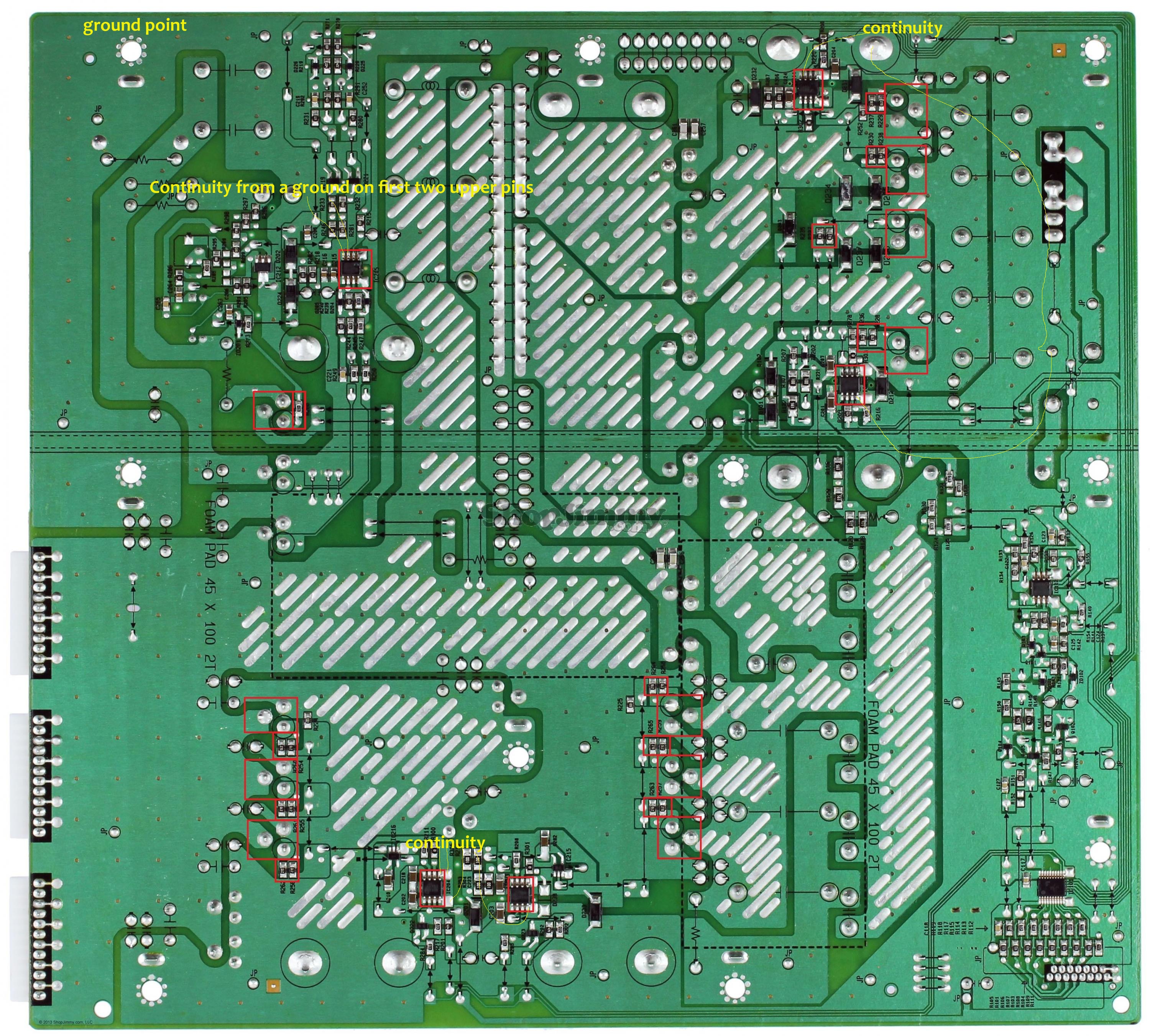

              ok, thanks. this is the zsus board. I took it off the tv, bench tested it. nothing attached to it.
              There are three rows of these of these igbts. looking from the front, far left row, installed on a silver piece, no continuity on any of the four diodes.
              Middle row of these under a long black piece, i get continuity on pins 1 and 3 for the top 7, the bottom three, i get no continuity
              the last row, installed on a silver piece, no continuity to any of the six installed
              I have continuity through the fuse, reading .3 ohms.
              will wait for a reply before testing ysus board. Thank you for your help

                I attached a markup photo of the bottom of the ZSUS board. I highlighted in RED each IGBT transistor and their gate resistors, and their gate drivers.
                The red highlighting in my photo is:
                Upper right area (the 4 parts are attached to small silver heatsink)
                Lower left area (the 4 parts are attached to larger silver heatsink)
                Lower middle area (the 3 parts are attached to large black heatsink)
                I did not highlight the diodes on the heatsinks.
                From your observations:
                1) The 4 diodes look ok.
                2a) The top 7 parts you measured are diodes. Pins 1-3 are physically connected together for each of them. If you have no short between pin 2 and 1-3 they are ok.
                2b) The lower 3 IGBTs look ok if you do not measure short-circuit from 1-2, 2-3, 1-3.
                3) The 3 IGBTs look ok if no continuity on all 3.
                4) The fuse looks ok.
                I think your ZSUS may be ok. Can you test between pins 2-3 on the white topside connector P102?
                If you do not measure short-circuit here, then let's move on to the YSUS.
