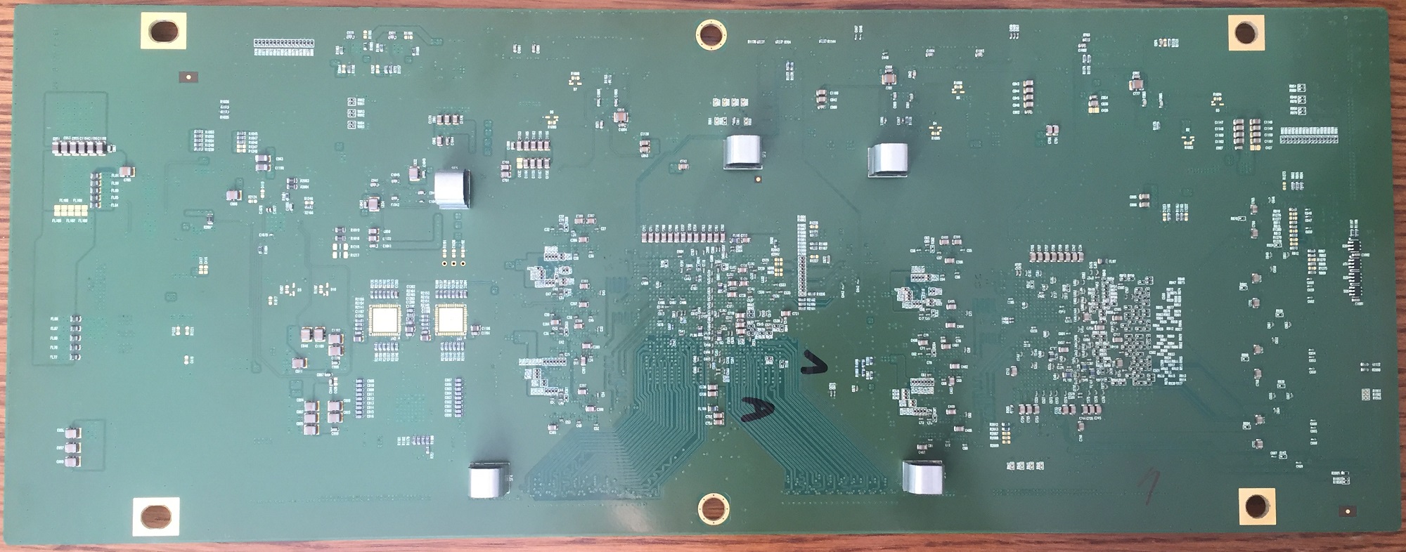

    This is my first repair of new digital TV, I've only repaired mobile phones, notebooks etc. so far and some old TVs.
    Symptoms: no picture; power on normally, joystick key and remote control works ok, tv is programmed with cable tv, changes channels, play sound normally, etc. TV has been working normally, but just picture disapearred one day.
    TV has 4 boards:
    - power supply
    - mainboard
    - some kind of OSD+Video mixer board (called URSA9 in service manual)
    - T-con board.

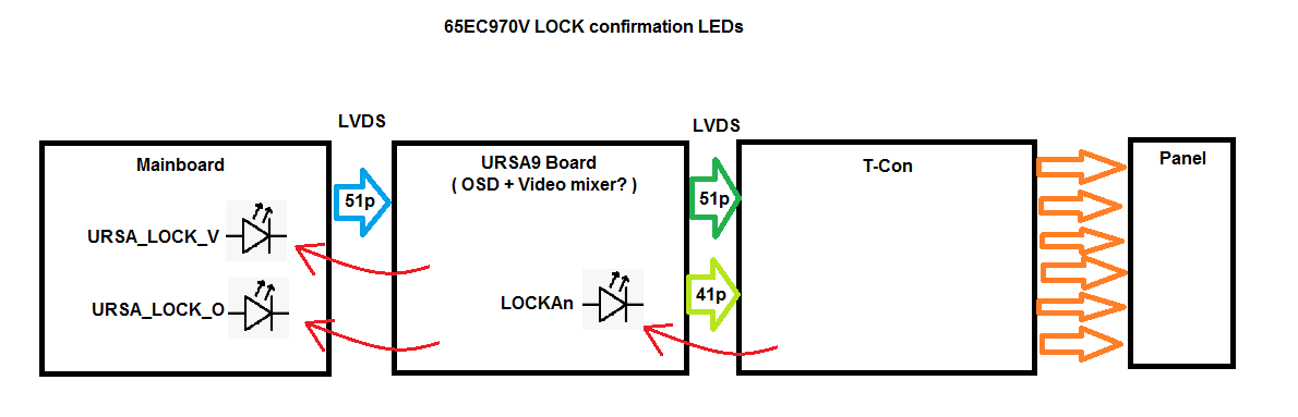

    Video signal goes like that: mainboard -> 51 pin LVDS cable -> URSA9 board with -> 2 LVDS cable (51 and 41 pin) -> T-con board. Mainboard ans URSA9 board have diagnostic "VX1 lock LED" which indicates that next board in chain has good signal connection and integrity receiving. Eg. URSA9 after receiving data calibrates and checks it, and if all is good, sends back to motherboard "LOCK" signal, and led on motherboard just lights on. Same situation with T-con -> URSA9, all lock LED lights on. So I assume video signal is properly going to T-con board.

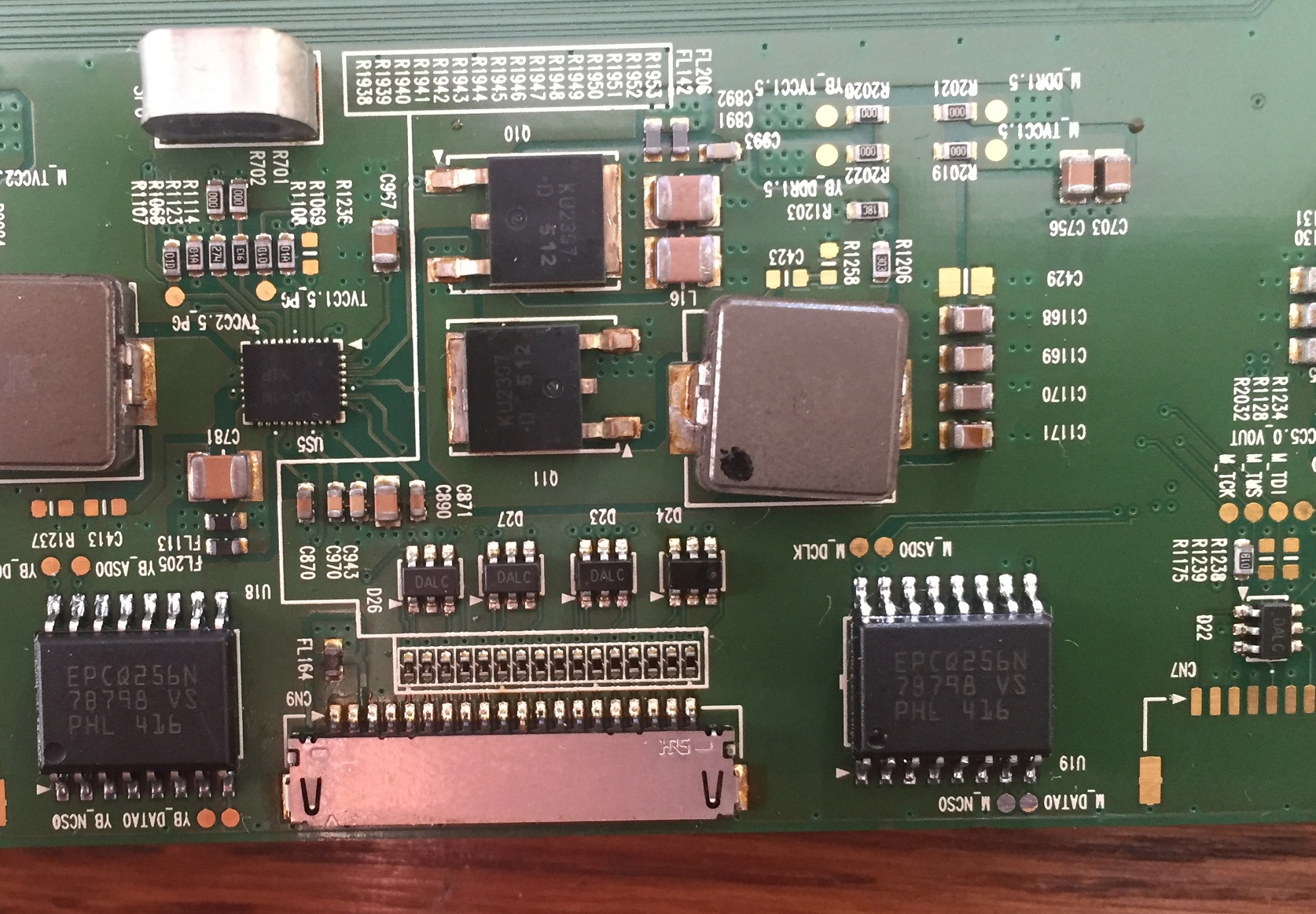

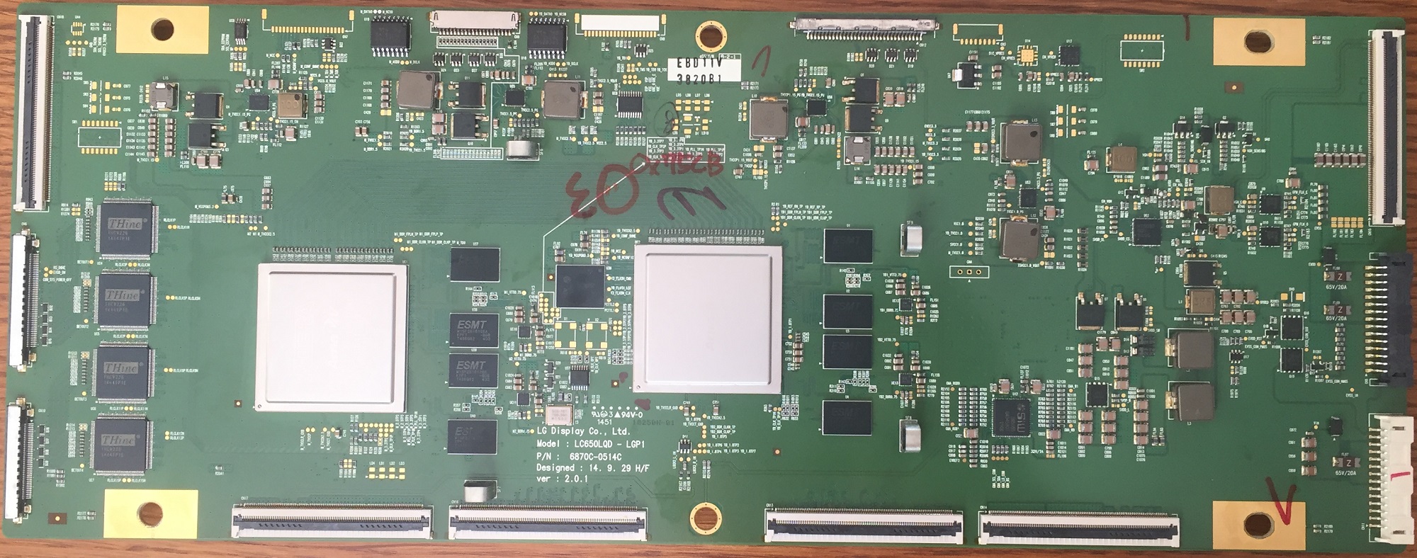

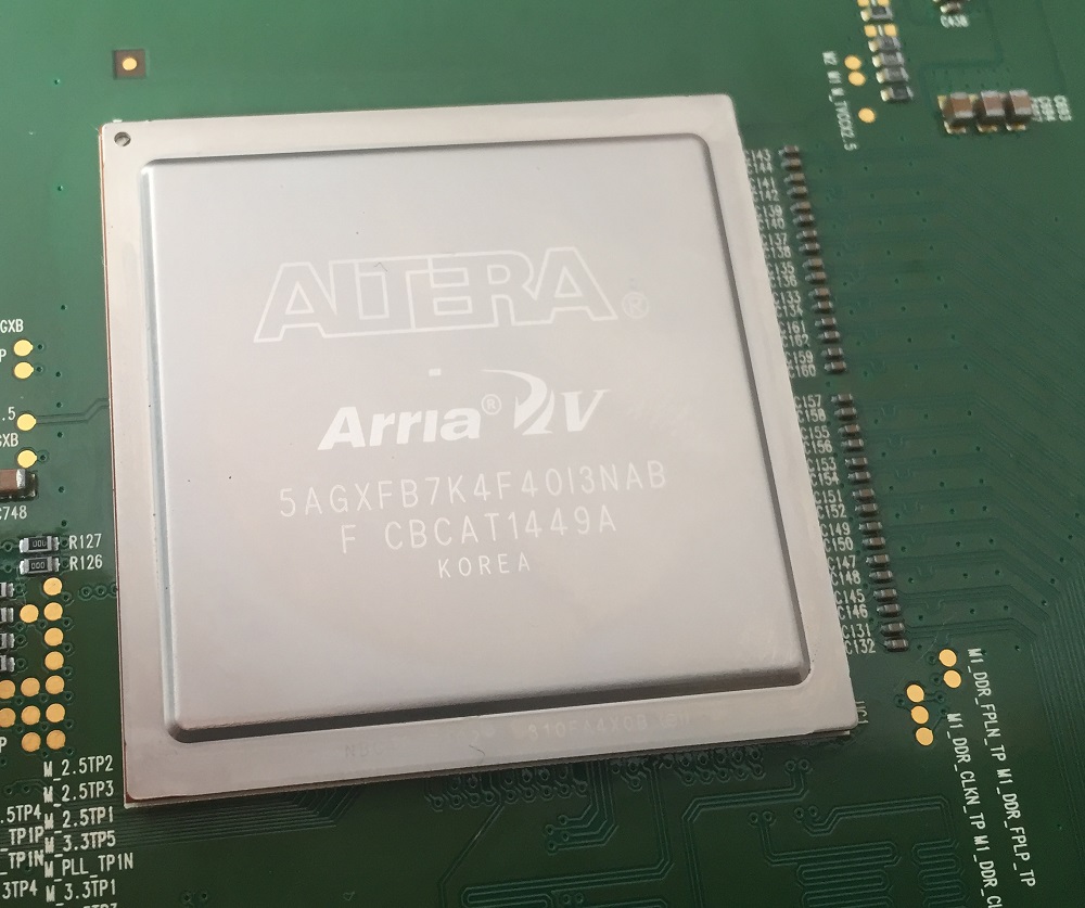

    Of course, power supply has been checked, for voltages not loaded and under load, all OK. Fuses on T-con OK. No difference with panel ribbons connected and unconnected. At further investigation, I've found that one of that two big Altera FPGAs, the left one on photo, isn't working. To be clearly isn't configuring. Left is cold, right gets as suspected warm in some time. Each FPGA has his own configuration memory chip, EPCQ256N. Normally FPGA downloads bitstream from it on power up, and configure itself withing 500ms . It can be watched, as DCLK and DATA pins of EPCQ for right FPGA are transmitting for this short time. Thought that maybe this EPCQ chip for left FPGA is broken or data corrupted, but after changing them in places, chip seems to be ok. it programs right fpga properly.
    Clock generator driving FPGA has two outputs with good 25MHz signal, going to each FPGA.

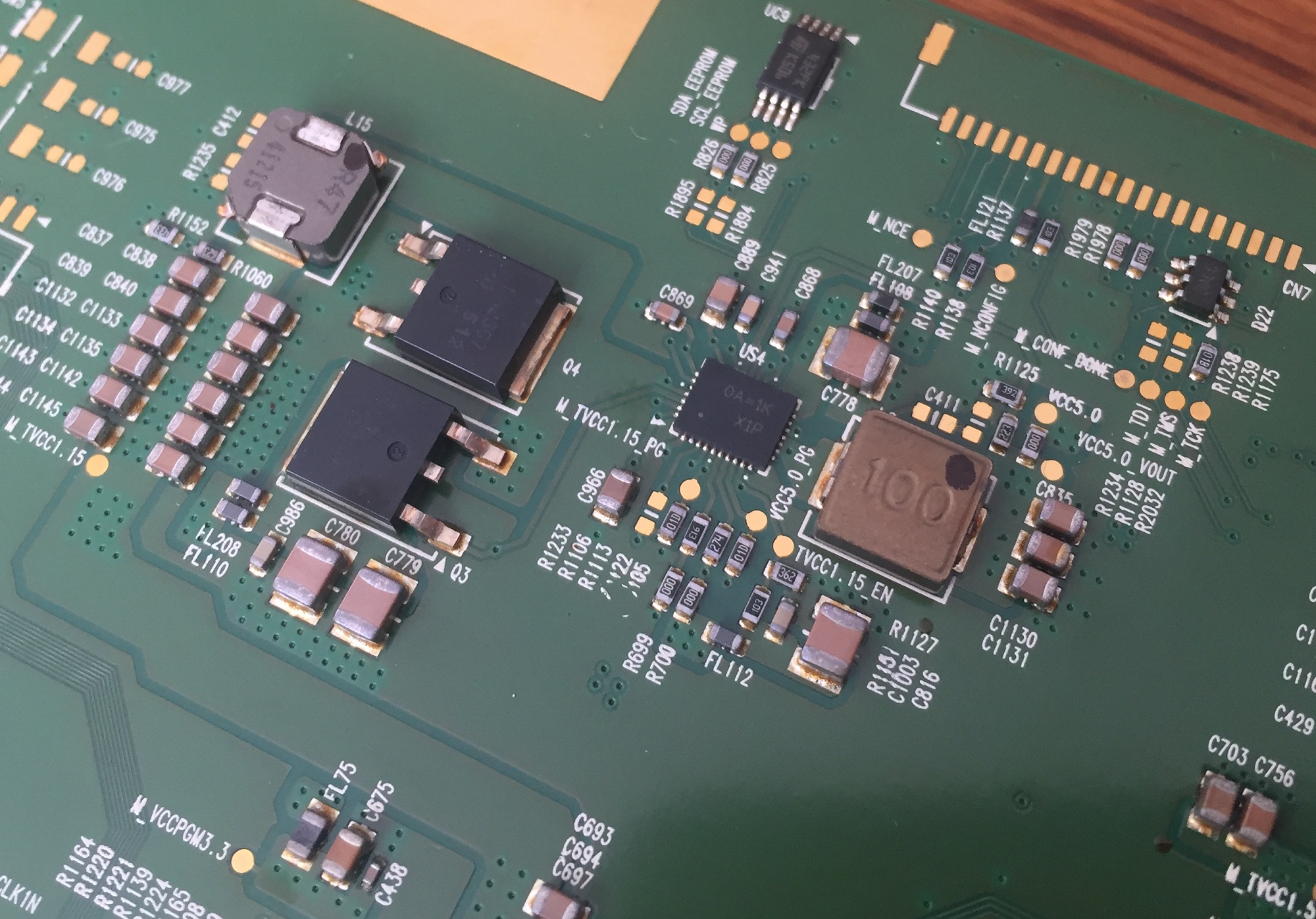

    I've got a clue if one of DCDC converter supplying power to left FPGA has slightly to big voltage, should be 1.15V, but outputs 1.23V. From what I've found in FPGA datasheet, it has build in POR circuit, that will not let to start configure itself until it has this supply voltage within its rating (1.15 +/- 30mV). Suspicious DCDC converter driver is marked 0A=1K X1P or OA=1K X1P. Can you help to decode it's name or/and find datasheet for it?

    did you self who removed L12 at testing ?
      Re: LG 65EC970V 65EC9700 - OLED TCON bad fpga voltage?
      I didn't remove any coils so far. I've also wondering why they are not straight soldered, but I can see the same on other t-con on web, 6870C-0514D and 6870C-0514J also have strangly positioned coils. It looks this must be done so wierd in factory.
      Anyway, L12 should be ok, volgate after it is rock solid 1.802V

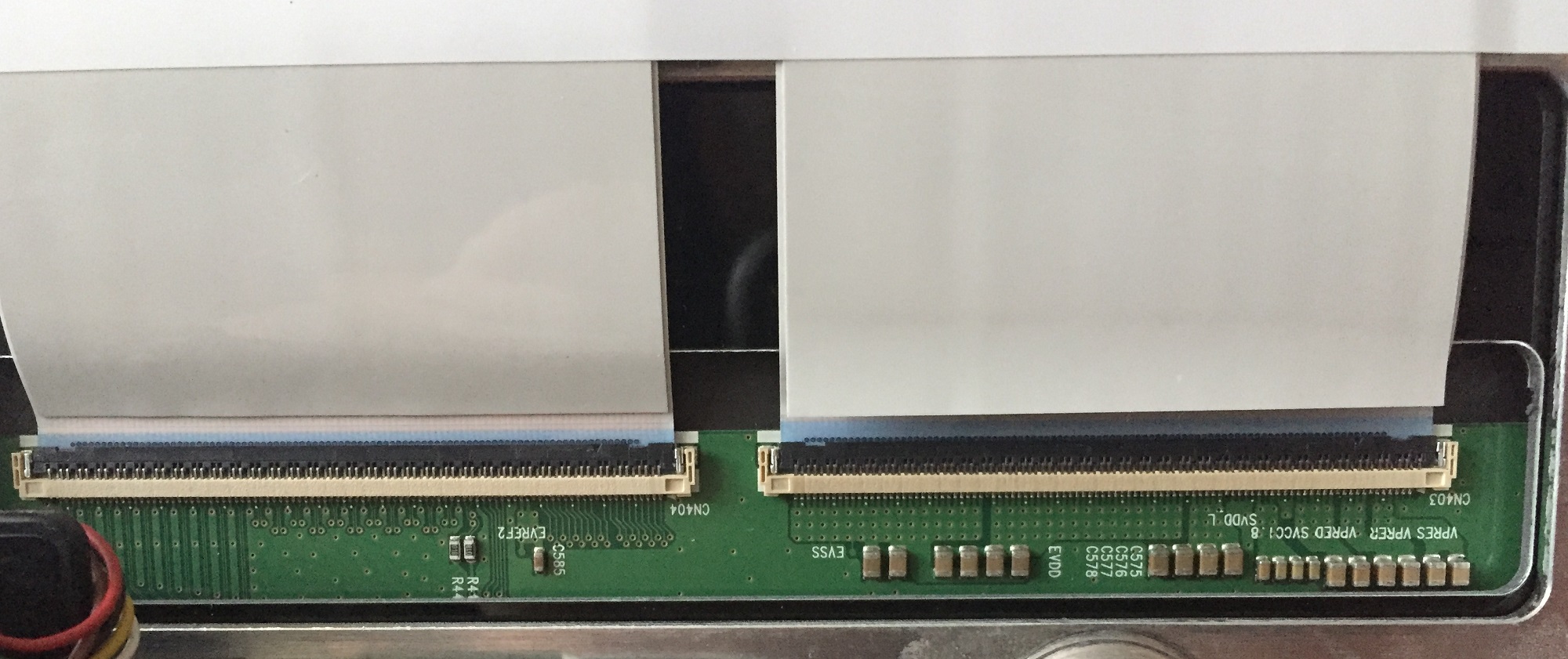

          I measured voltages on connectors on downside of panel. There seems to be no short circuits:
          EVDD = 24.08 V
          SVDD_L = 16.00 V
          SVCC1.8 = 1.79 V
          VPRED = 6.05 V
          VPRER = 0.30 V
          VPRES = 0
          Left side photo attached, right side has the same measurements (altrough SVDD_R = 16.00V)
          After 1 minute power up:
          With panel ribbons connected 34.9 W on power cord
          with panel ribbons disconnected 30.2 W on power cord
          So not driven panel takes some power.. but definitely no shorts circuits.
          How can I examine for cracks on panel? It looks not openable to get to COF without destruction. It's my own TV for some time, panel definetly has not been physically damaged by hit or water; no other people played with it when it stoped working, just me.

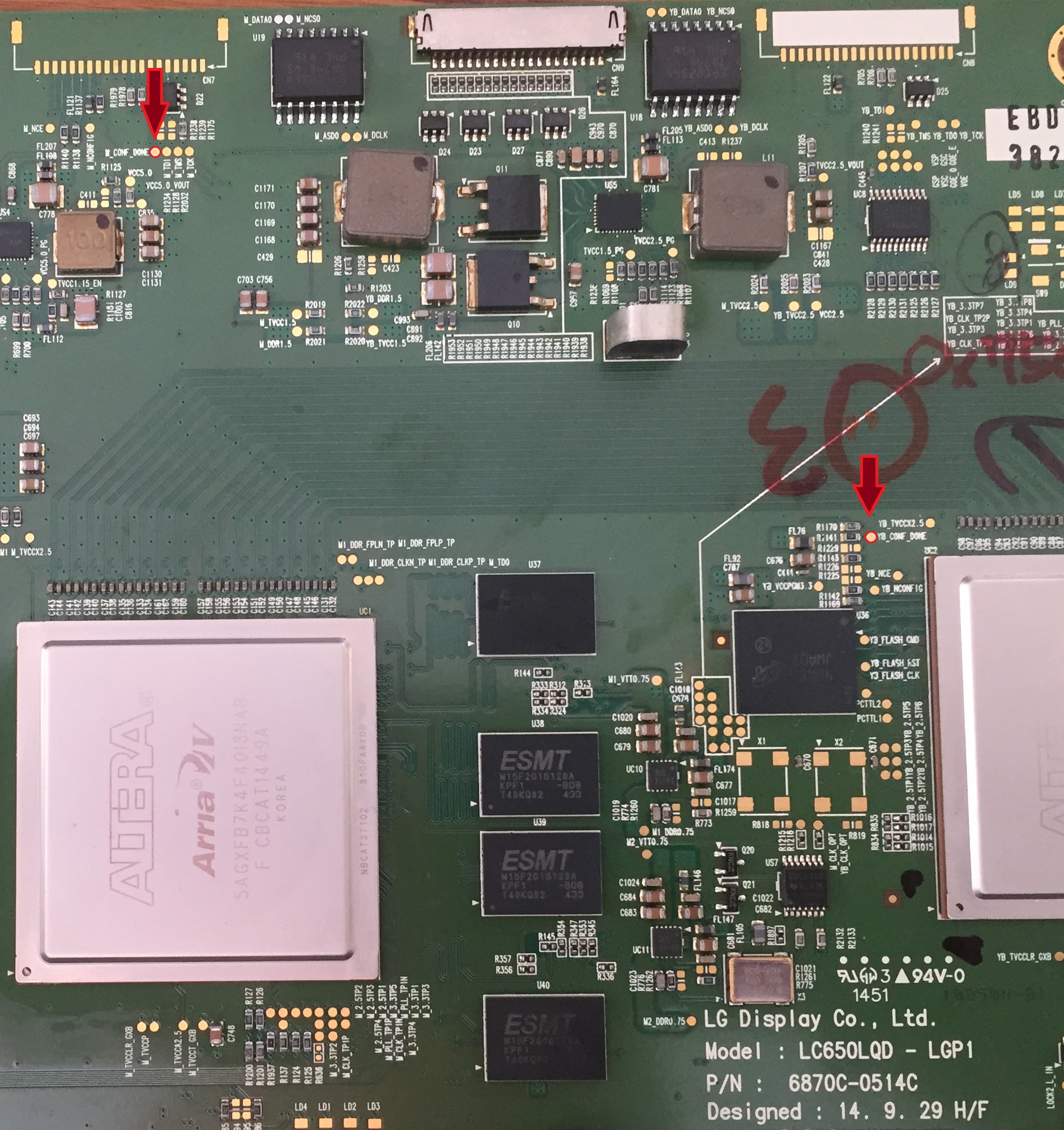

          YB_CONF_DONE testpoint goes high in about 500ms after power up, so UC2 (right ALTERA) indicate to configure properly from serial memory, and goes warm after some time.
          Ideally will be if someone confirm that both Altera IC got warm after while, or better to measure if M_CONF_DONE testpoint goes high too for UC1 (left ALTERA) on similar OLED T-Con. On my T-com it doesn't and don't know if it is normal condition. Maybe I will look after Altera Blaster JTAG to check if FPGAs are alive.. TMS TDO TCK TDI jtag points can be found on board.
          Similar T-Cons with two BIG FPGAs were used in EC, EF and EG series 4k OLEDs; I will be glad if anybody could test it.

                  No picture happened at cold start few days later from last use. I used it for few hours a week. Just only sound from cable tv. TV is normally operable by remote control. Panel was in very good condition, no any burned pixels. Last time I've checked at service menu, UTT was about 1450 hours, so not very much at all. It may have maybe 100 hours more right now, played by me for last half a year.
                  There are two "Lock" (exactly there are three) LEDs on boards, which indicates good LVDS signal between boards (closed loop alike) as I mentioned earlier. Next board is returns confirmation signal to previous board, about good signal and integrity of it. And it works as supposed, when I loose LVDS cable no light from LED. Like in attached drawing.
