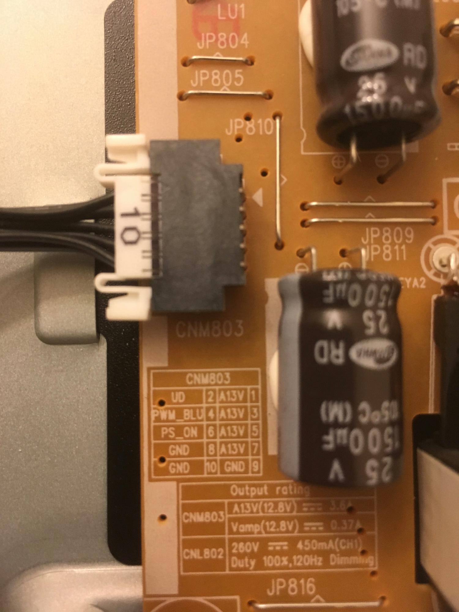

    Test all pins on connector from mainboard to powerbard on powerboard side, all boards connected. Test in standby/plugged in but off, then apply power report both conditions, example: pin 1 bl-on=0 volts standby and 3.3 powered on, report results for every pin. How to video in my signature below.

      Re: Samsung UN55H6350 no image, has sound -Bad T-con or Panel?
      Plugged in, standby
      pin 2-1 10.8 v
      pin 4-3 10.8 v
      pin 6-5 10.8 v
      pin 8-7 10.8 v
      pin 10-9 0v
      Plugged in, Power on
      pin 2-1 12.8 v
      pin 4-3 12.8 v
      pin 6-5 12.8 v
      pin 8-7 12.8 v
      pin 10-9 0v
        Theres 10 pins, you checked 13579 now check 2468.
          How do I do that? if you look at picture of the back of the connector...there's only 5 wires. not 10. I'd have to detach the cable to the main to see all 10 pins and test them unless i'm not understanding what you're saying or there's another approach.
            so anyways I did remove the cable to the main and powered on the board and tested the even pins.
            pin 2 was 2.3 v
            4 was 3.3 v
            6 was 3.9 v
            8 and 10 were 0 volts as expected as both are ground (i'm assuming)
