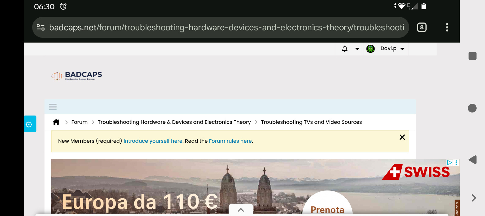

                            I see you are consulting the site with a cellular.. first why not to select from browser menu the "show Desktop site"?
                            on desktip view like the screenshot down, on top of the page, click on the bell icon..
