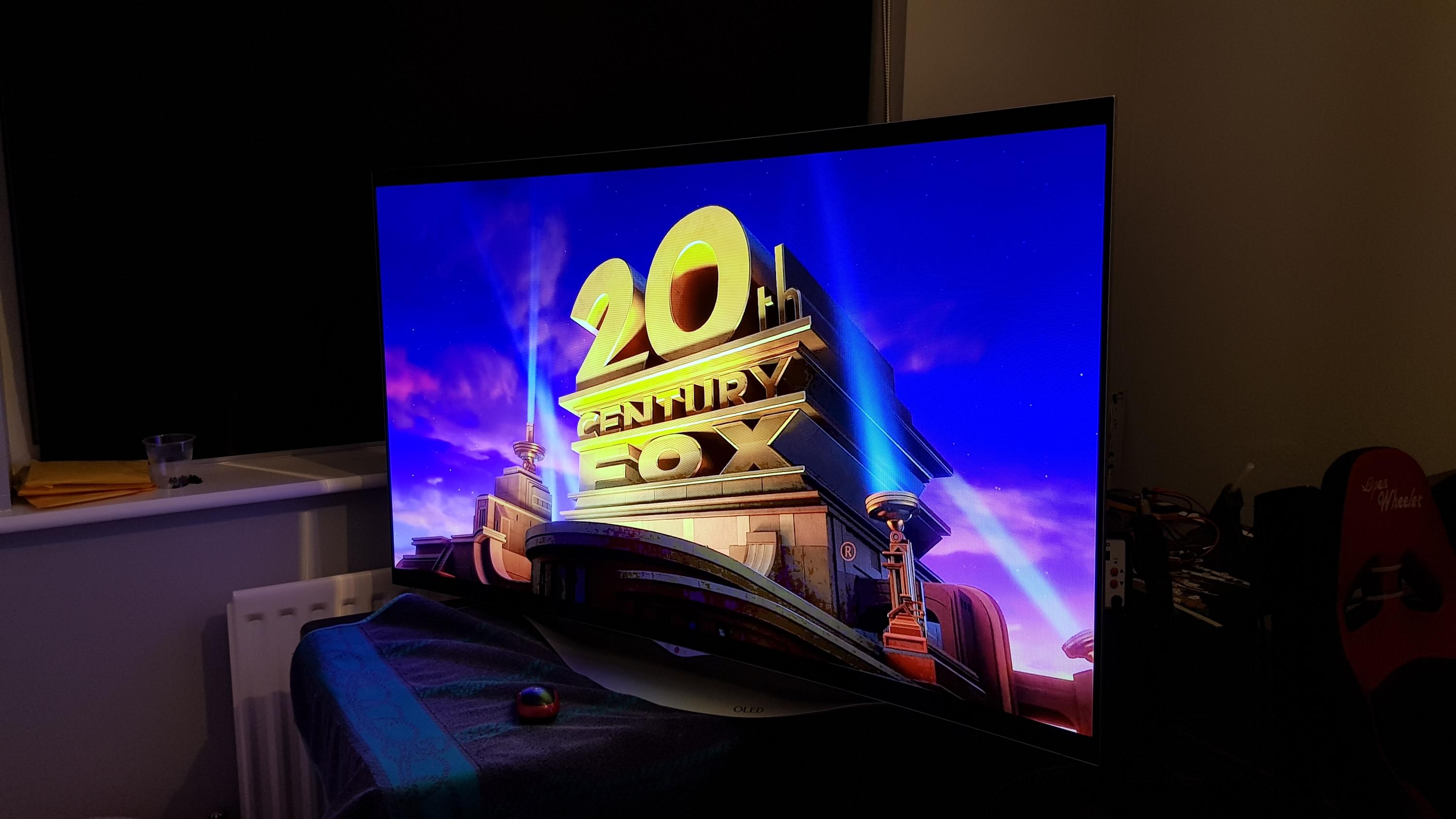

              So I plugged in the usb receiver for my wireless mouse then switched on the TV and its working perfectly! Didn't need to do anything else. It's playing a movie from a memory stick as I type. Do you think the usb triggered something or has it just decided to self calibrate or something?

                #47
                Re: LG 55EC930V OLED - 3 Second Power No Display
                [ATTACH]190445[/ATTACH]
                we still at the test. i cant tell you what i have on my mind.. but its now enough to you know yours TV okay.. but still we have an issue ...
                please do the other test i suggest.
                  The RCoid app I am using already has the EZ-ADJUST and IN_STOP commands.
                  EZ-ADJUST menu comes up without needing a code. I didn't adjust anything, just powered off and on again.
                  IN_STOP flashed up a message momentarily then powered off like you said. When powered on, went through first time installation.
                  So what are you thinking? Could there be a problem still?

                    #49
                    There is some very light vertical banding on the screen.
                    Also quite obvious posterization which I'm hoping I can tweak out via the picture settings.
                          I'm back guys
                          A quick update and a couple of questions. So after a around 5 hours of run time the posterization has gone and now the picture is great.
                          I've only run the set for around 90 mins at a time as the screen is getting hot. Do OLEDs run hot? What screen temperature should I expect? It's currently 41c after 30 mins.
                          The thing I'm most unhappy about is the vertical banding. It's quite obvious sometimes. Is there a way to correct this like a manual pixel refresh/compensation cycle??
                          Pictures to follow
                              OLED Screen specially 65 size above we call it in room winter heating system, at yours 41degree still good. as i guess you have room temperature 22 somethings
                              this effect you have now it will be reduced and away after time use.. it happen now because you removed before the ribbon cable and LVDS. and of sure you didn't brought them each back at its place.. so the reading of LVDS Freq depth has being changed and the set clever enough to adjust this value self.
                              yours main issue was Panel driver didn't load at start up.the air mouse receiver push the driver again to load again as it need display driver at operation
