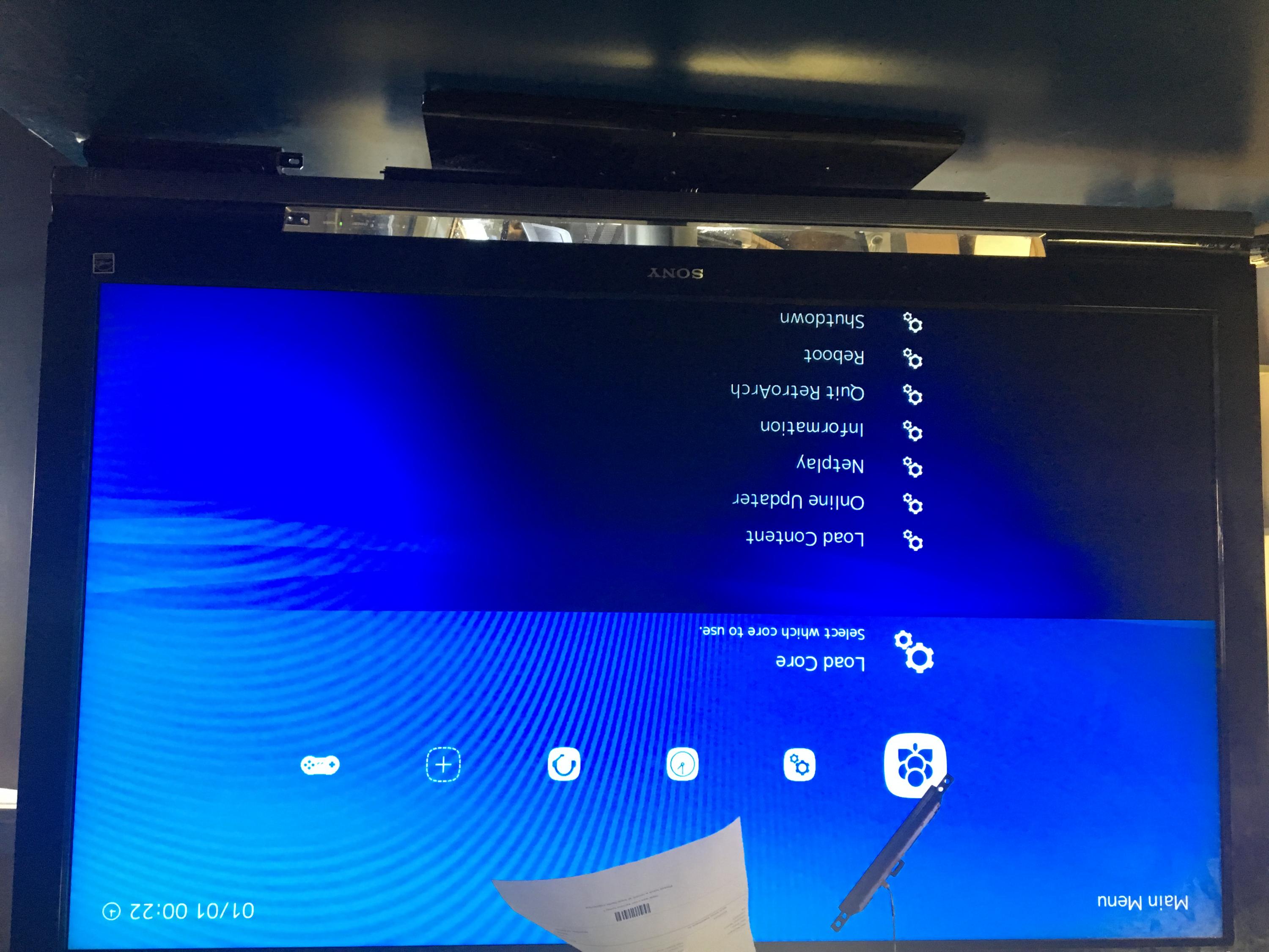

    Sony kdl-52v4100 half screen issue
    See photo
    What do we think on this one. Feels like a tcon or panel to me. Reflowed any relevant chips to tcon to absolutely no change. Ruling out cable issue since it is a horizontal split like that.
  • budwich
    • Jul 2015
    • 3097
    Re: Sony kdl-52v4100 half screen issue
    the set likely has side tabs... from the picture (a little poor) but it looks like the right side has a problem as you can maybe see multiple imaging happening.
    Throw on a good test pattern (color bars) will likely highlight the problem better..
