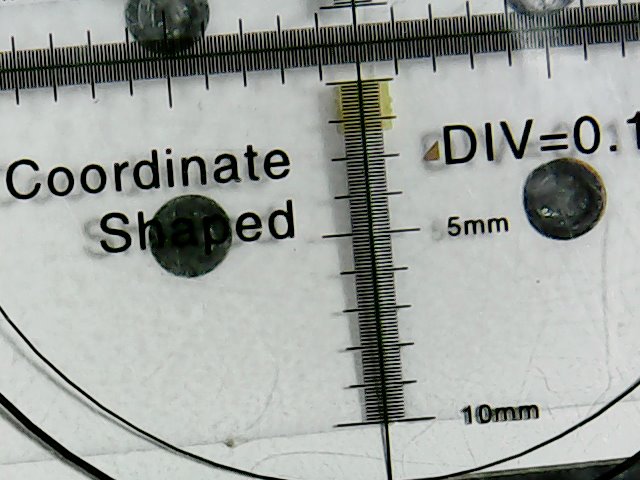

                          #72
                          Re: Sony KD49X8005C Assistance Required Please.
                          Originally posted by Diah
                          are you sure 1.4mm ??? no way
                          This is the size of the LEDs
                          Hope you can see from the scale which is 0.1mm divisions.

                              #74
                              Originally posted by Stevie406
                              Brilliant. Thank you..
                              maybe your set are different..
                              be sure of the size. 1.4mm no such BL LED and you have 49 screen with only 36 LED in total

                                #75
                                Yes, the LEDs are extremely small, and as you said 36 in total for a 49" set doesn't seem a lot.
                                The 2835 ones you mentioned are bigger in size. They are 3.5mm x 2.8mm
                                Just my luck to get a set with odd sized LEDs... And a headache of a repair.
                                Still, I have learned a lot so far, and I am very grateful for all the help and advice I have been given.
