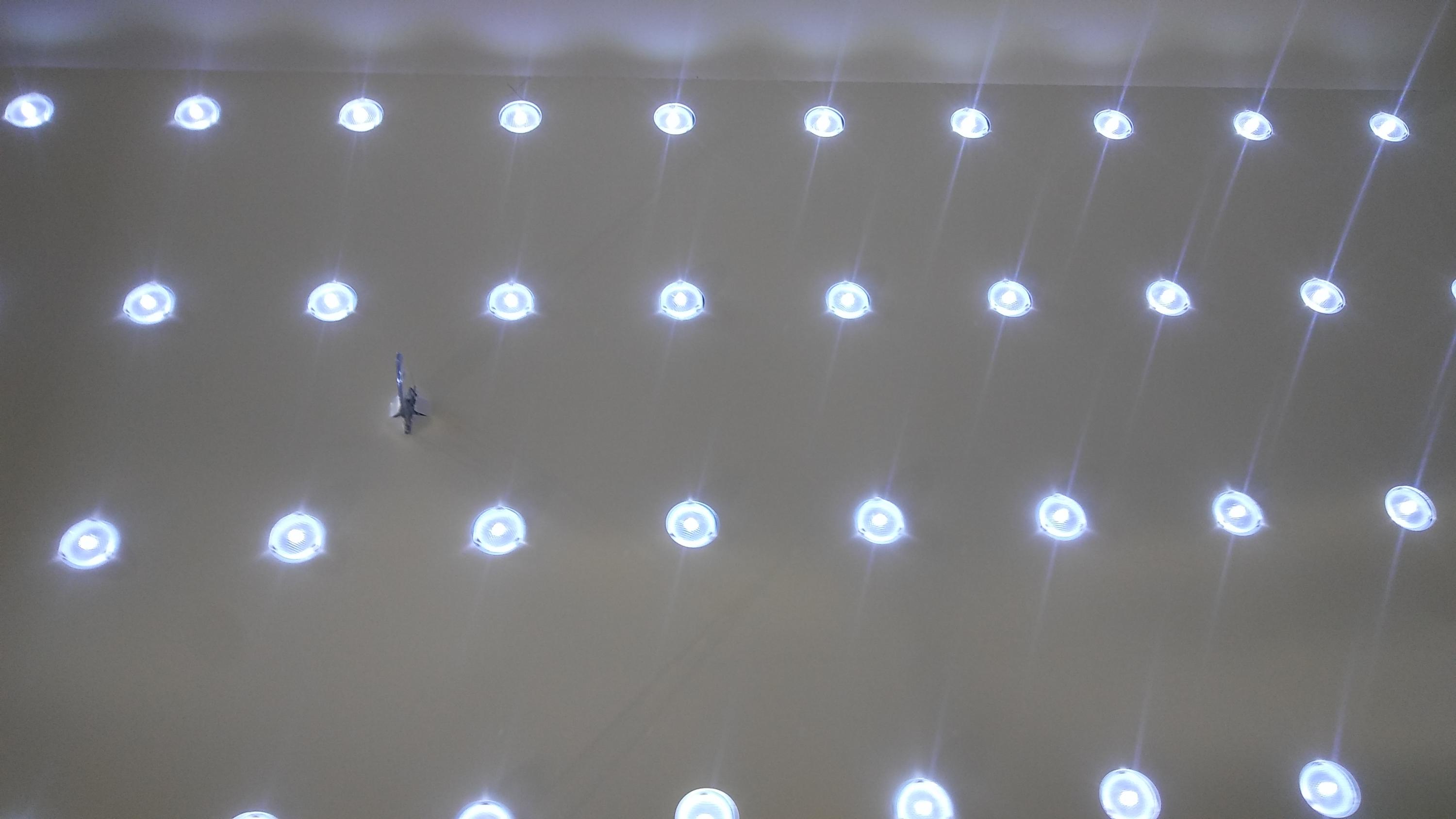

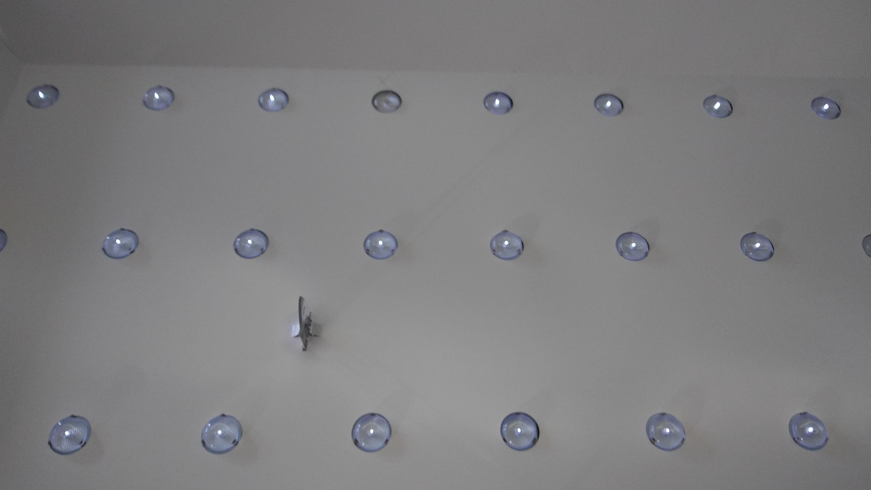

    RCA 65" LED65G55R120Q backlight LEDs were blinking. After I changed four LEDs. TV backlight panel works fine but when I drop the led test current to 1mA. there is one LED (very dim) not works. If I drop led test current down to 0.5mA. There are 5 LEDs no light up.
    Panel No: T650HVN05.502-12V
    My question is ...will low current can test LED Life Expectancy and should I change all the weak LEDs ?
    Is weak PN Junction can be detect by current?

        Re: RCA 65" LED65G55R120Q backlights are blinking.
        Yeah, you can sorta. If you have a string with quite a few LED's out, replace all LED strips. Not worth friggin with. As more LED's fail, the remaining LED's get over volted and they don't like that at all. So always to the backlights down some. If it is just a few LED's you'll get away with it no problem. All in a nutshell, it depends on how many LED's in the string are bad. It also depends of course how big the LED string is.
        Just because there are some LEDs already turning on, while others are not, means not much. It's like FET's. Yes you can get them matched pair or matched how many you like but it cost $$$. Not worth in that application.

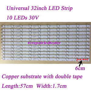

                      Andrew...thank you....the universal LED strips!......this is the first time I've ever known about this universal LED strips.
                      Questions for you.
                      1. How about the lens focus distance? Is there any white spots on the screen?
                      2. LED strips are different lengths might have problems with latitude and longitude to the opening of LED holes.
                      3. Does installing universal LED strips to the case, double tape might cause dissipating heat problems?

                      • Andrew F. Ali
                        • Jan 2014
                        • 2450
                        • Trinidad & Tobago
                        Those are the exact strips I use. Each LED work at 3V each on the strip so I work out the math and place the strips in. They will not match the holes on the reflector paper so I cut new holes. If it is a larger screen I just stager the strips layout. It works for me thus far

                          Mr. Ali thanks for your tips....but is that ganna leave customer could notice marks on the screen?
                          I did one tv change all the different LED strips that is a lot work and screen did has marks. Is the reflector paper can change to white paint?
                          If the aftermarket led strips are in good quality that will be the best way to do like Sharp and LG..... junk model tv sets have more than 20 leds no work. You're right about this.

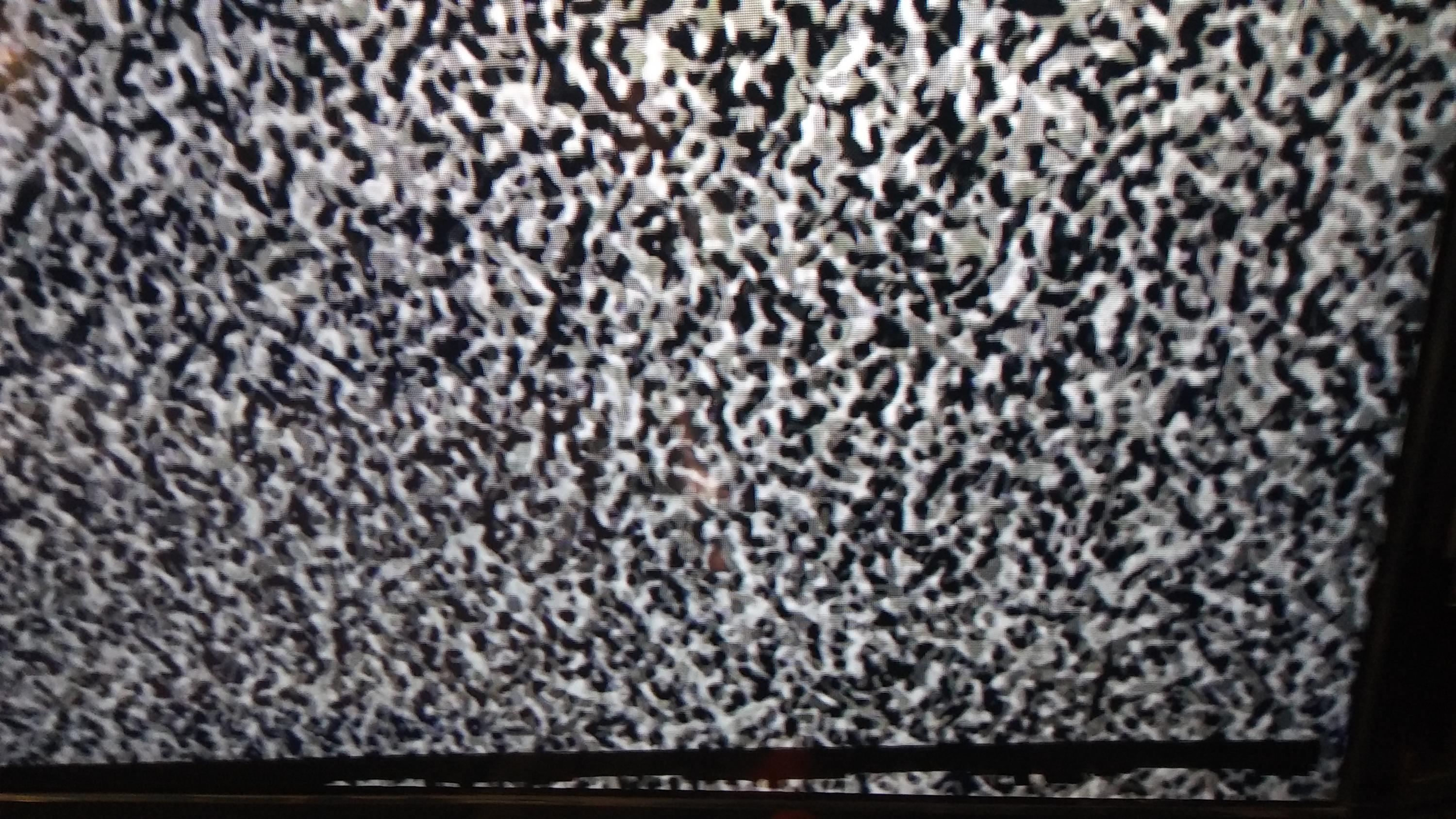

                            Thanks. Finally tv is ready. But look the picture what's wrong with screen st bottom part of tv.
                            • capwizard
                              • Jun 2016
                              • 1991
                              Thanks. Finally tv is ready. But look the picture what's wrong with screen at bottom part of tv.
                              Is my tv screen broken?
                              The TV is getting bigger and bigger. More and more difficult to handle.
                              Does anyone have a better way to deal with this situation?

                                    I found a very useful video. This RCA TV must be laid flat on the desktop to work on, Be very careful and see if there is glue on the screen.
                                    at 4:13
                                    How to troubleshoot and repair RCA LED65G55R120Q not starting
                                    https://www.youtube.com/watch?v=z89Bnev0p7s
