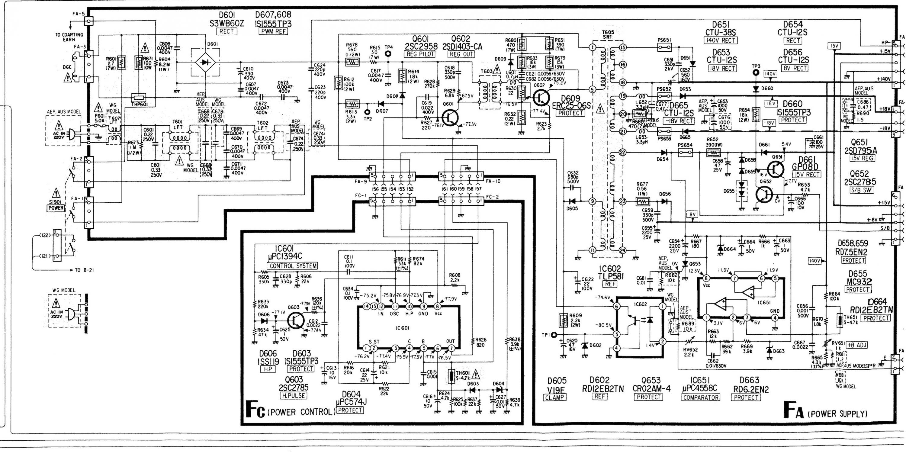

    I'm trying to repair a Sony PVM 2730QM monitor. The picture flickered and I heard a strange electric noise. The source of the noise was the Power Supply board. I started the repair but now I get stuck.
    I dismantled the board and I replaced C621 C682 R679 R683 since there was a burnt on them and C654 C655 R677 since they were faulty. Now I have these voltage values: 8V line 10.5V (not stable), 15V line 15.6V, 140V line 129.7V (it's enough?), +18V line 23.2V, -18V line -22.5V.
    The sound is changed and now it's like a periodic cricket sound. I've read that it could be due to a non working transistor. I've checked them all and they seems to work, but not sure about their dynamic behavior.
    When I attach this PSU to the monitor the tube degauses but it doesn't turn on. I also have a twin working PSU, and attaching it the tube turns on, even though the front panel is still disabled.
    What I've to do to finish the repair? Schematics attached.

              sounds like something is breaking down / leaky. Can you maybe isolate where this noise is coming from (like a wooden cooking spoon etc to your ear)?
              No. D651 and C652 are responsible for HV. C651 is a snubber cap. Swap C651 out and try again. Did you check D660?

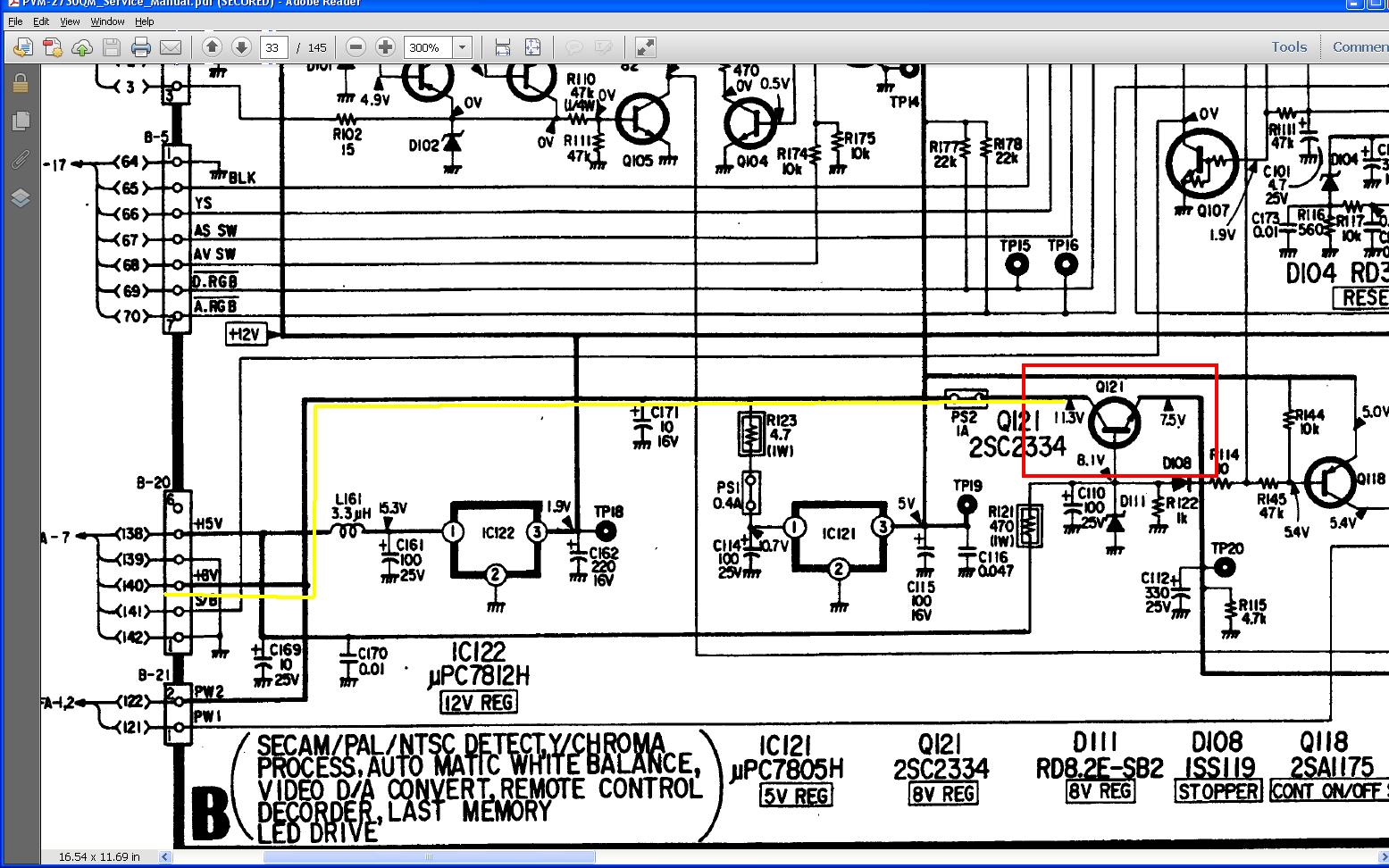

                That 8 volt line should be around 12 volts as it supplies the 8 volt regulator with 11.3 volts on the [B] board Plug B20 (page33)
                Q121 is the regulator transistor, collector = 11.3volts, base=8.1 emitter= 7.5 volts
                That line also supplies ic121 +5 volt regulator ic
                That line could be loading the power supply, thats why R677 opened
                I would check that circuit.

                      What voltage do you have on IC602? Have you tried swaping the Fc boards betwen the power supplies?

                          IC602 is the optocoupler, It only has 6 pins, It is used to couple the signal from the secondary to the primary to control voltage regulation.
                          I don't know what ic you are mesuring for those voltages?
                          The schematic shows all voltage meaured to chassis ground, which is stupid for voltages in the primary.
                          If you can, check the voltage across D602 (12 volt zener), then with the negative probe still on the D602 anode, check the voltage on IC602 pin6.

                              When I touch pin 4 with the multimeter I hear an additional strange buzz.
                              Thats because the meter negative should be on hot ground when checking pins 4,5 or 6.
                              The 1.4 volts on pin 2 seems correct according to the schematic.
                              on the opto's output (schematic) shows a 6 volt difference (you) measured a 8 volt difference. that might explain the lower secondary voltage.
                              Does the 140 volts change if you adjust RV651 (+B adj)
                              It should be safe to swap the fc board from one power supply to the other. there are a few electrolytics on that board that might cause a problem.
