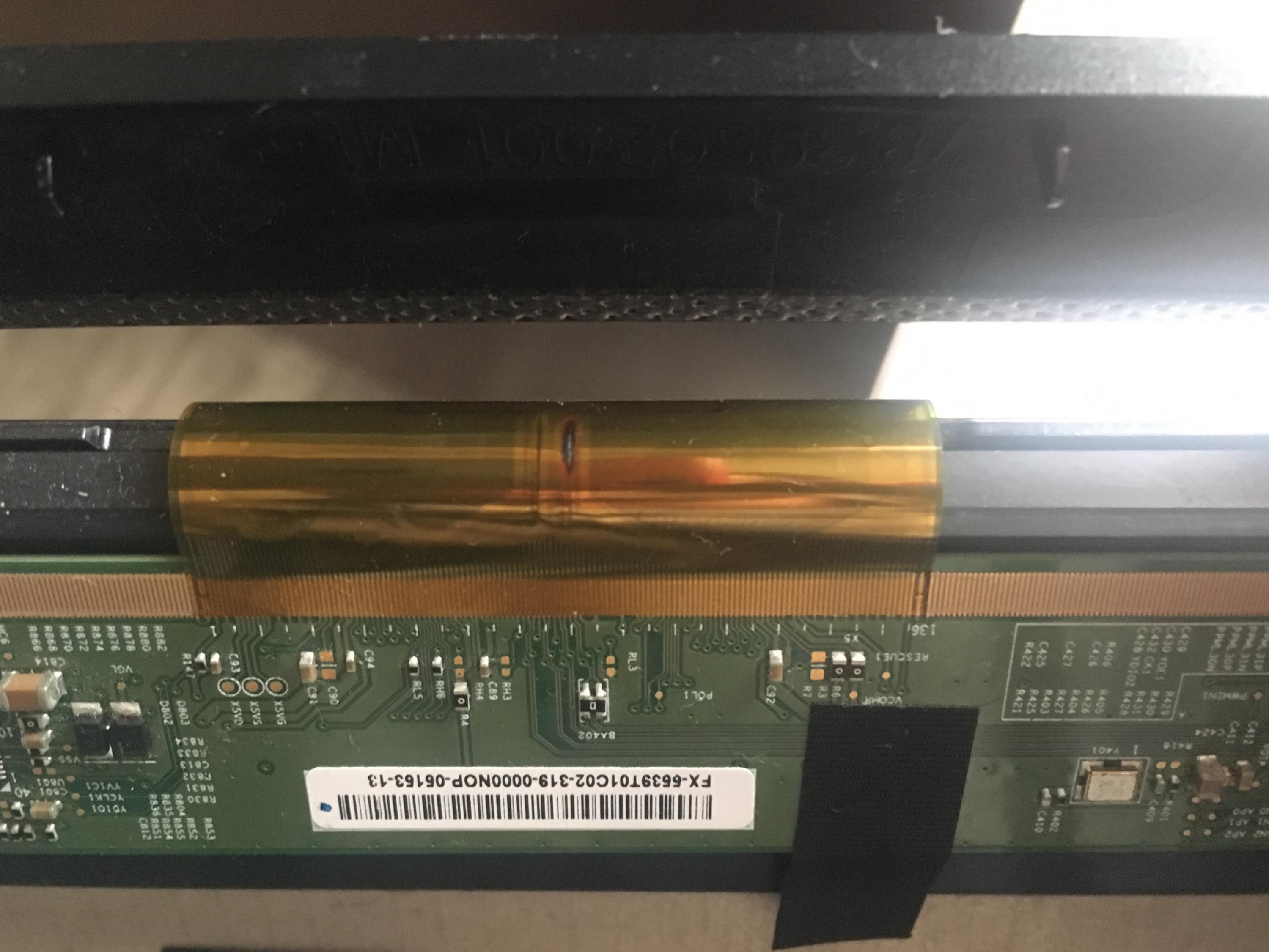

TV starts without showing anything on screen. Backlights work but I have no image.
Sound comes on but after half a minute it goes out. When I press the shut down button on the remote, the sound comes back while the TV shuts down. Turning it back on sound works for a a few seconds.

I found out there is a burnt ribbon going to the panel. I changed one of the ICs on the panel boards seemed shorted and the main fuse of the panel board.
Now my questions:
1) If it was just one of the 6 ribbons going to the panel the problem I should get at least some image right?
2) When I disconnect the LVDS cable I see the sound still does the same. Is it probably a fault of the main board?
I want to at least sell the boards for spare parts but I don't know if the main board is ok.
