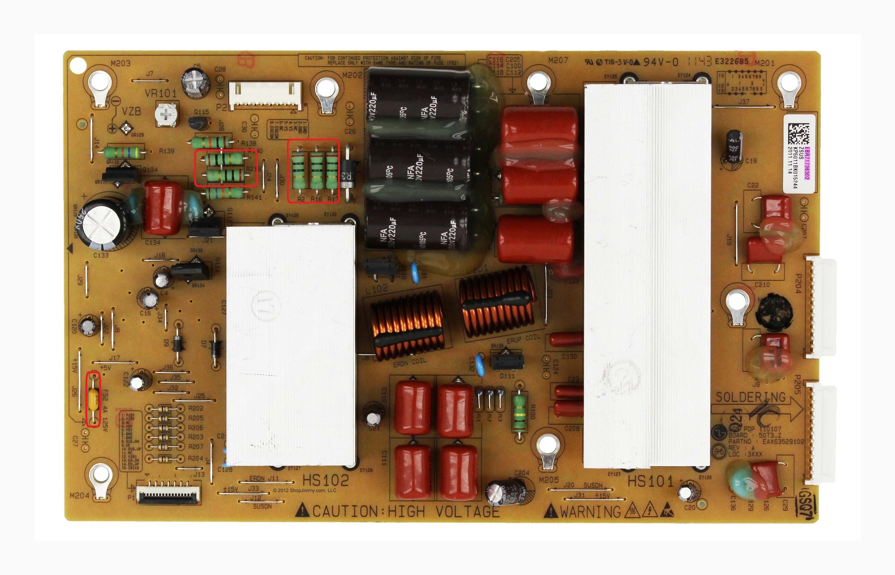

    I have this PLASMA TV on my workbench for repair. When plugged in to the 120Vac I hear the relay click ON then a few seconds later click OFF. The PSU self-test proved the PSU is OK and Vs, Va,M5V, 17V, etc are where they supposed to be at. The Vs goes from the PSU to the Y-sus Bd. and from the Y-sus Bd to the Z-sus Bd. With the Y-s connected and the Z-sus Bd disconnected the Vs is correct at 205Vdc. I deduct that the Z-sus is faulty and pulling down the Vs supply.
    Z-sus Bd.: EAX63529101 EBR71736301
    Y-sus Bd.: EAX62846401 EBR7183E6301
    My question is: With the Z-sus disconnected and the Vs and M5V stable on the Y-sus, should I be getting Vsc produced on the Y-sus or would that only come up with the Z-sus connected and working?

      first thing,check Y-buffer boards for shorts or blown ICs.
      if no problems there,keep Z-SUS disconnected,check Y-SUS VSCAN and -VY,if it does not produce these voltages,logic board may be disarming the set because Z-SUS is not present,then you'll have to remove and check the fuses,IGBTs and 2Watts resistors on Y and Z boards.

        Thanks for the reply Biruslapio. IGBTs OK on Y-sus Bd. Y-buffer has no shorts. Thanks for the reasoning why Vscan not producing, as Z-sus Bd. disconnected Logic Bd. disarming the set.

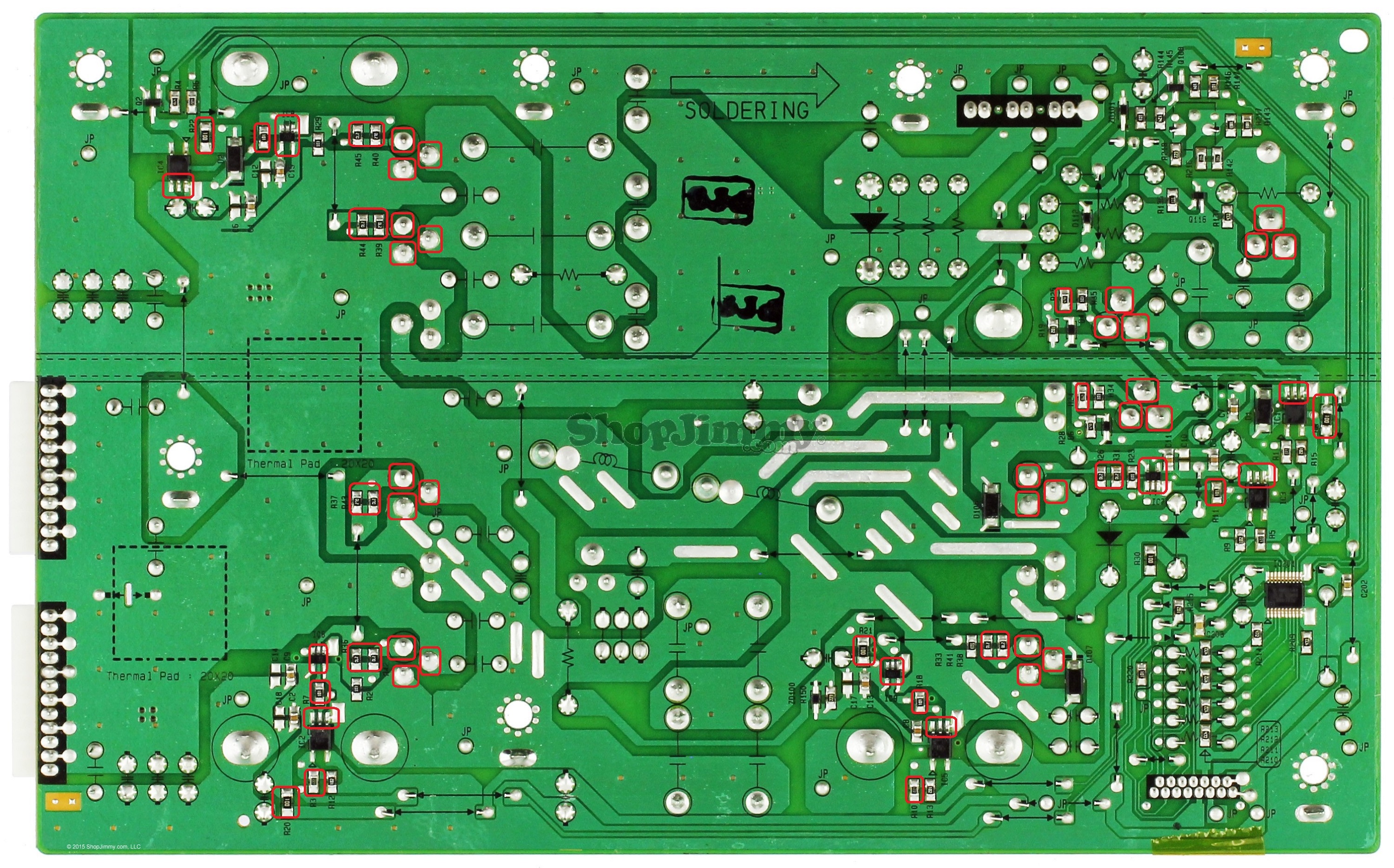

          Take a look at these red circled points on your Z board,if none of the SMD/PTH resistors are open,or any IGBTs reading low resistance between the pins,then do the same to Y board.

              IBGTs on the Z-sus shorting out. I'm surprised they didn't blow the fuse. I can get a used board. I think I'll go ahead and buy it. The Y-sus Bd. seems OK. Thanks for the advice. I'll update when I install the 'new' Z-sus Bd.
