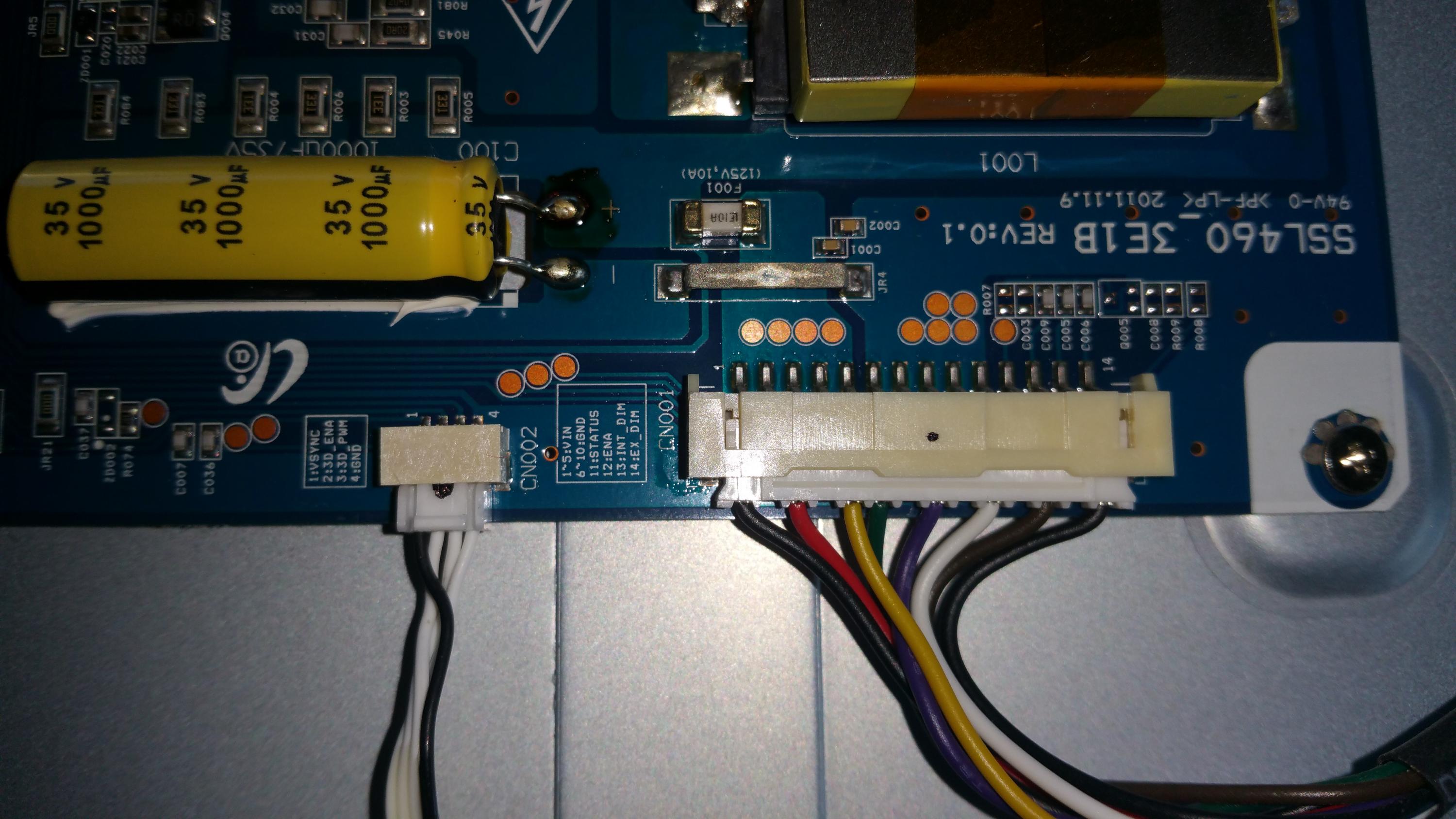

    Originally posted by budm
    It does sound like LED's problem.
    LED driver board: You have 4 LED strings, each LED string Cathode is connected to one of the 4 the PWM controlled MOSFET's (Q101 ~ 401), you can check the Voltage on the big tab of each MOSFET to see if they are all about the same or not, the one with bad LED string should show different result.
    The PWM dimming signals are from the T-CON board via CN002 connector on the LED driver board, there are pin names printed right by the connector.

            Re: Very Nice Toshiba 46L5200U1 Strobe Effect
            It looks like the BL-ON (ENA pin 12 of CN001) signal may have gone away.
            Also check to see what feeding Voltage to CN001 pin 1 ~ 5 is, I expect it to be 24V for feeding the LED driver board.
            https://www.badcaps.net/forum/attach...7&d=1544129624
                So some how the Boost converter circuit goes into shutdown output drop down to 10V even though the ENA (BL-ON) is still present, you just have to look deeper to see of the 24V gets all the way to the boost converter inductor l001/ MOSFET or not, check the solder joints of the inductor legs, C043, DRV test point, etc. and also look up the spec sheet for that LED driver IC.
