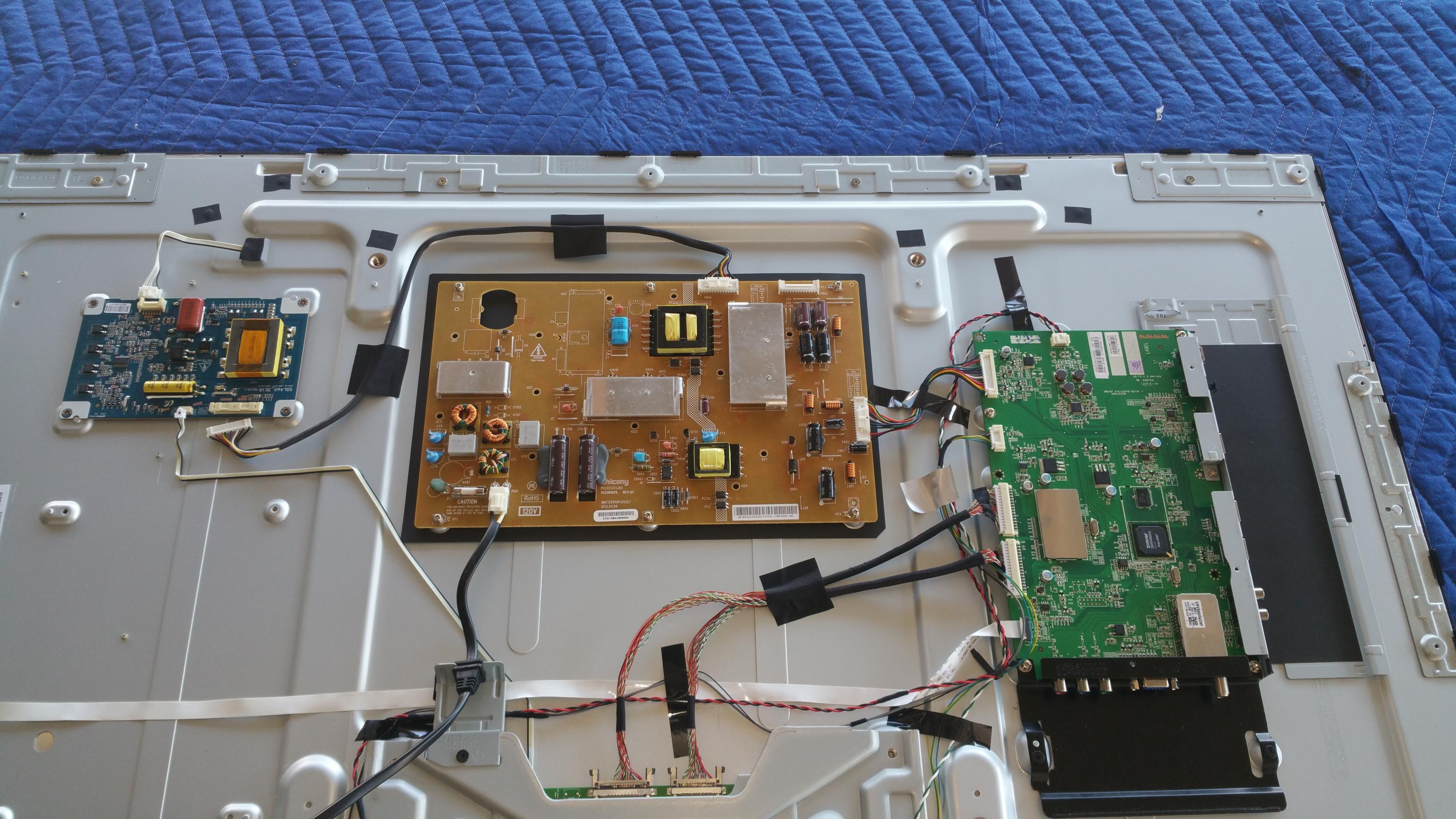

    Got this very nice Toshiba... Works fine for 5-10 mins and then the backlight starts strobing...
    I had one a bit ago, same model, same problem. Broke that one down to the bare LED strip thinking that was the problem... But, after testing it, I am not so sure... Now I can't seem to find that one..
    So, I wanted to eliminate other possibilities before I went that route with this one...
    There are no burned or blowed caps or resistors.. Picture is fine for the few mins it's working...
    Would this likely be an LED strip problem or a component/board issue??

                The Backlights is being controlled via T-CON board for dynamic contrast control (to give you the faked high contrast ratio spec.), what happen if you disconnect that cable between T-CON and the LED driver board, or disable the dynamic Contrast, dyna-lights control in the OSD user menu?

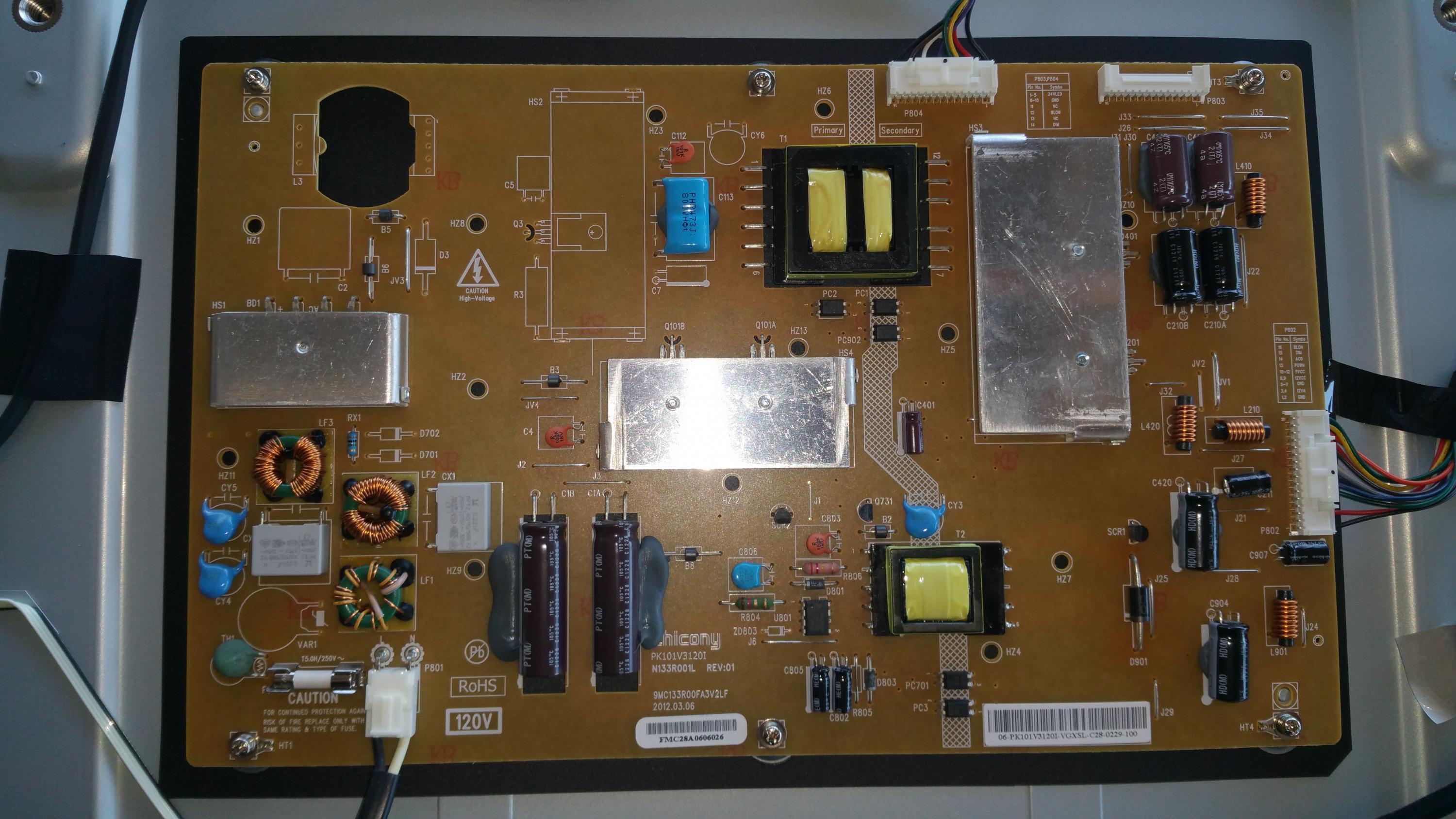

                  I am hoping it's either the power PCB or the inverter board... As LED strips for this are not available outside of China...
                      Pulled the connector between the TCON and Driver board..
                      Same thing.. Strobe effect then backlights shut down..

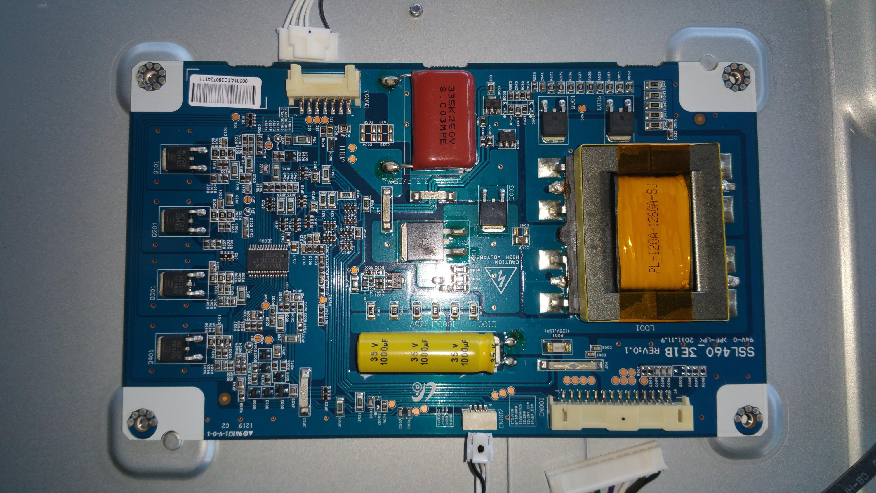

                                  Re: Very Nice Toshiba 46L5200U1 Strobe Effect
                                  OK.. DynaLight to OFF... Brightness and Backlights set to 25.... Dynamic Contrast is off...
                                  Working good..
                                  BLON is at 3.27 and can't find PWM, but there is a DIM pin and it's at 1V
                                  I'll let it ride and check the voltages when/if it screws up..
                                    OK ran it for about 10 mins.. Worked fine..
                                    Slowly started bumping up the BACKLIGHT... Around 70 it started strobing and then after a few secs of strobing, the backlights shut down..
                                    Gonna leave the BACKLIGHT at 50 and run it for a bit...
                                      Still craps out..
                                      Does that support the LED strip being bad??
                                      Or could it be the Driver Board??
                                        It does sound like LED's problem.
                                        LED driver board: You have 4 LED strings, each LED string Cathode is connected to one of the 4 the PWM controlled MOSFET's (Q101 ~ 401), you can check the Voltage on the big tab of each MOSFET to see if they are all about the same or not, the one with bad LED string should show different result.
                                        The PWM dimming signals are from the T-CON board via CN002 connector on the LED driver board, there are pin names printed right by the connector.
