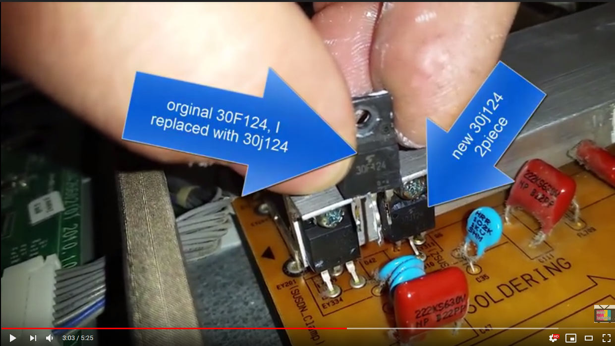

    Hi all, I'm attempting to repair a ebr66607501 Ysus board and have removed the Q12 Q13 sus up and the Q21 Q22 sus down igbts which were shorted and now I cant remember where the 30F124 and the 30J124 go !!! Any help would be appreciated. Thanks

    Searched some old posts and google, some say 30J124 are Q12 Q13 sus up and some say they are the q21 q22 sus down. If any one has a ebr66607501 board handy and can take a quick look that would be much appreciated. Thanks

      The only apparent difference I can see between the 30F124 and 30J124 is the 30F124 is rated at 300v and the 30J124 is rated at 600v. It seems you can replace the 30F124 with a 30J124.
      I found this video that shows the location of the two on a similar model TV (perhaps). https://www.youtube.com/watch?v=ozJ-YEWcJTg

        Thanks for the info, so to be safe I will replace them all with 30J124.
